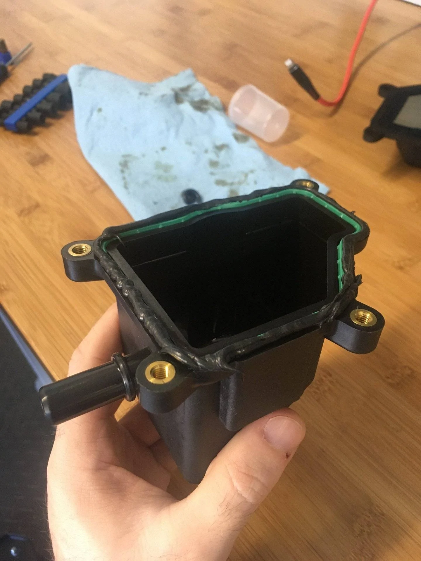

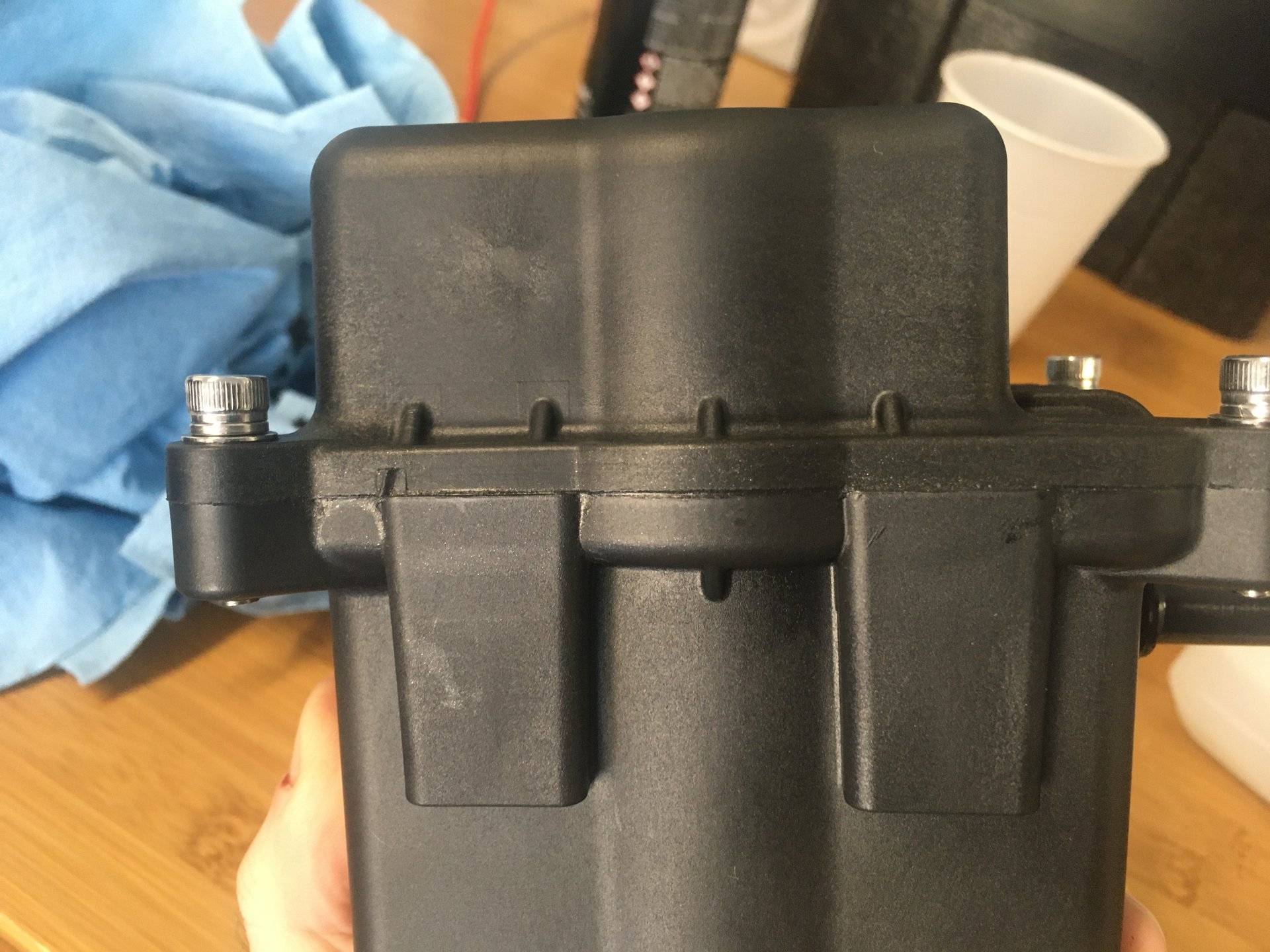

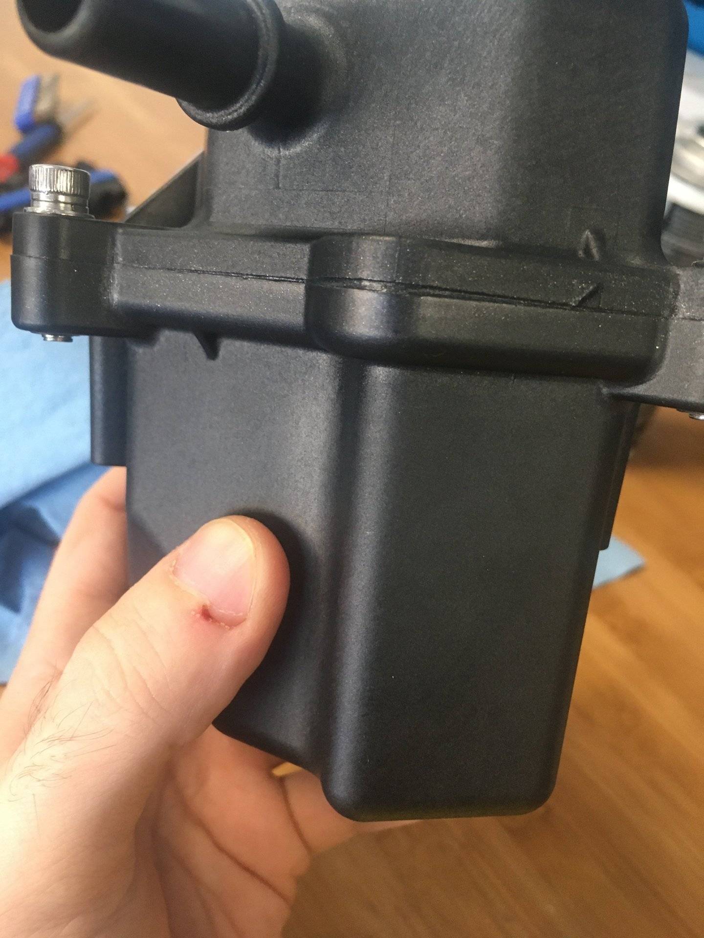

I know its not related, but if anyone ever has blo by with this catch can, I had the ford perf catch cans on my EcoBoost and maybe the EcoBoost has higher pressures (turbo) but to fix it, I simply took the lid from the bottom, put a little bead of the right stuff on it and sealed it up and let it cure for 24hours inside the house since nice and warm I never had a single spec of blow by afterwards. just put it out there for anyone if it ever starts to separate from pressure.
now, I did reduce the amount before I sealed it a bit. but yeah, never had an issue. and to drain the oil, all you do is just tip it anyway and it flows out the spout. you can crack it apart if you really wanted, but I never saw a point. shouldn't have metal shards or anything clogging the filter screen. could always flush it with water or solution and pour it out anyway to clean the screen both sides.
its like the pressure started deforming the case itself, maybe from heat cycles etc.. maybe needed more bolts to help clamping force? unsure. but posting in case ever happens to anyone else. I just wiped away the excess from outside with alcohol and looked perfect when cured.
this happened to two catch cans, ford perf sent me a brand new catch can, and it worked but within 4 months started blow by again. and many other ford perf catch can people experienced same issue. (I would buy it again) and I would reseal it again if it happened again. its a extremely nice catch can, that is remedied (but shouldn't have too) not a big deal though.
Is it sitting over the turbo or exhaust manifold? Mabe the heat is deforming it. Might try some stick-back aluminum heat shield sheet on the bottom? Like this:

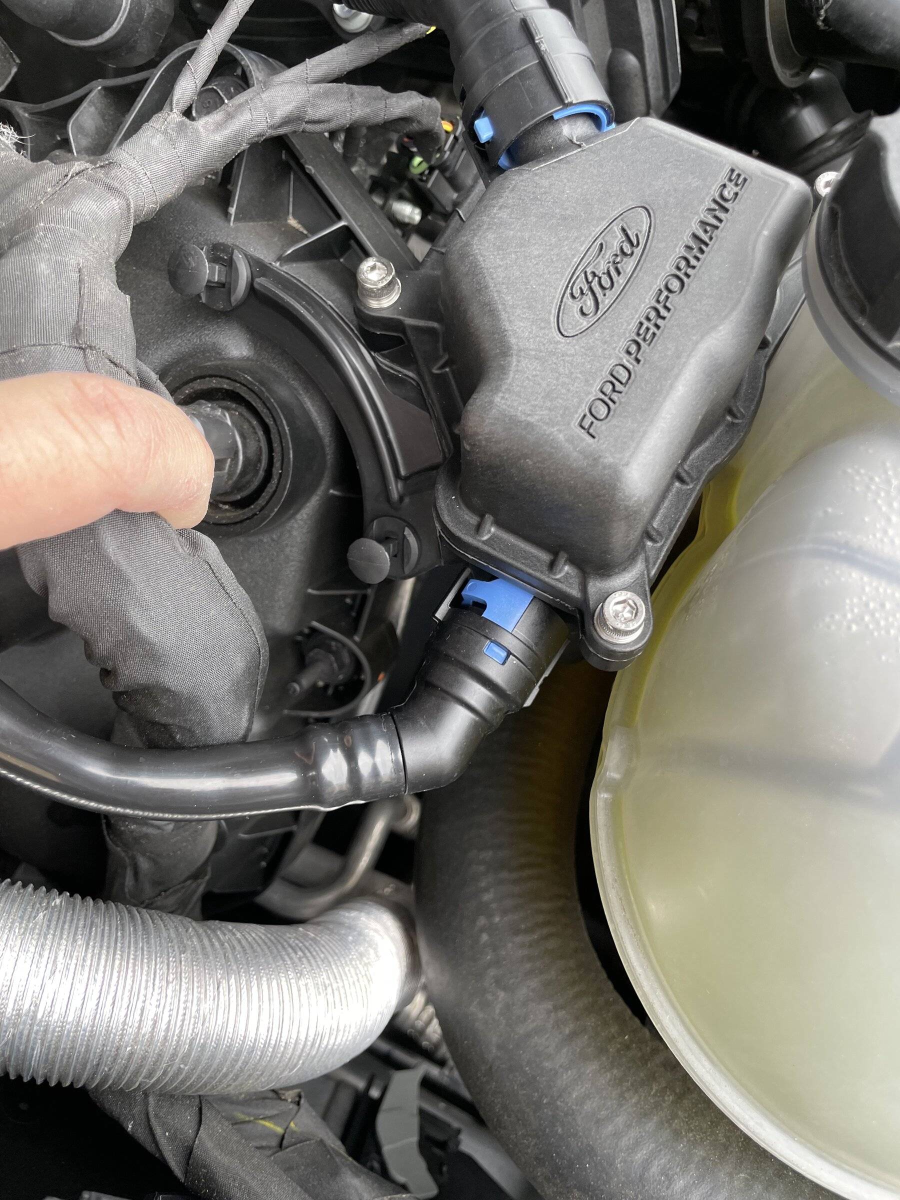

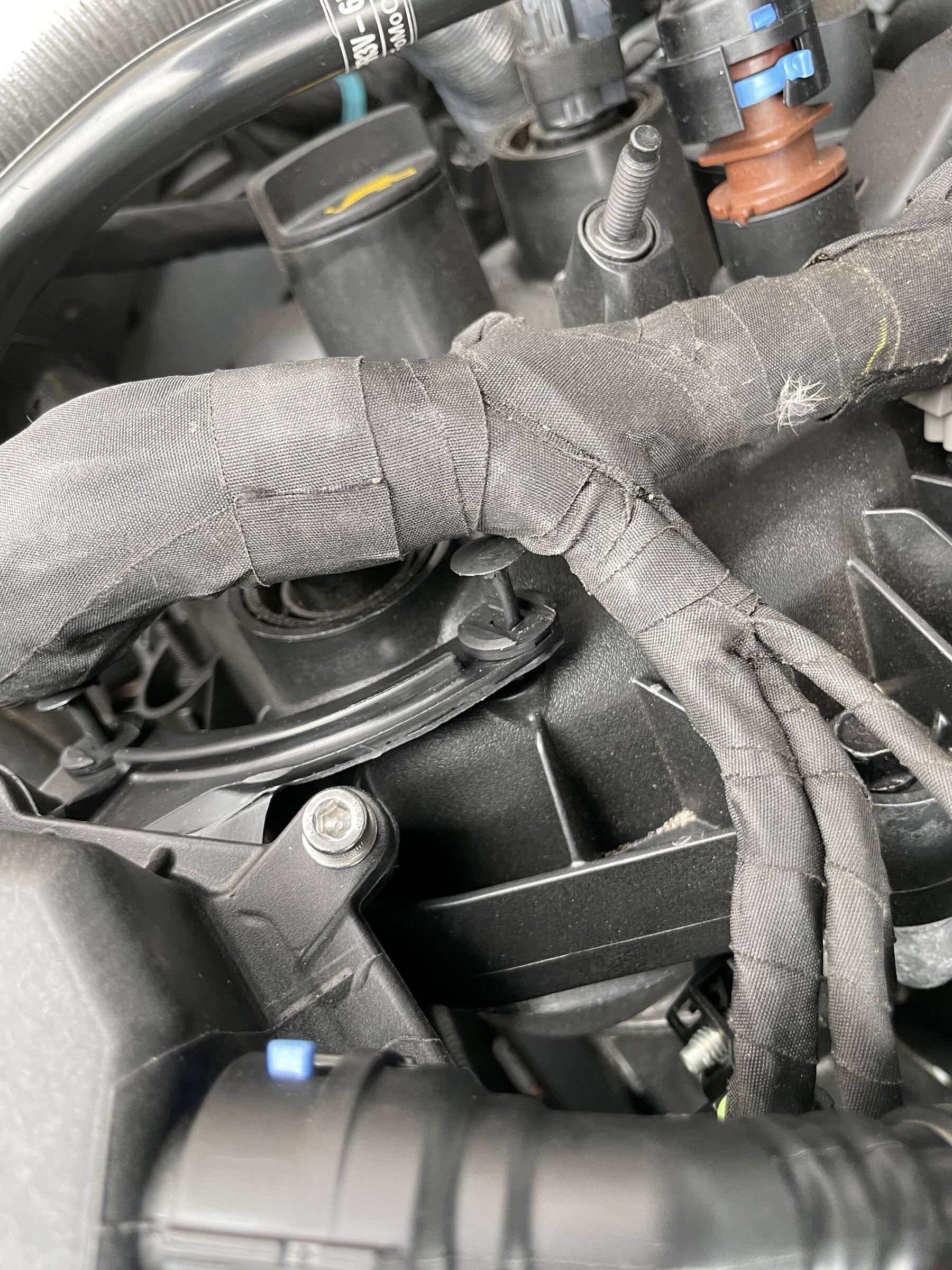

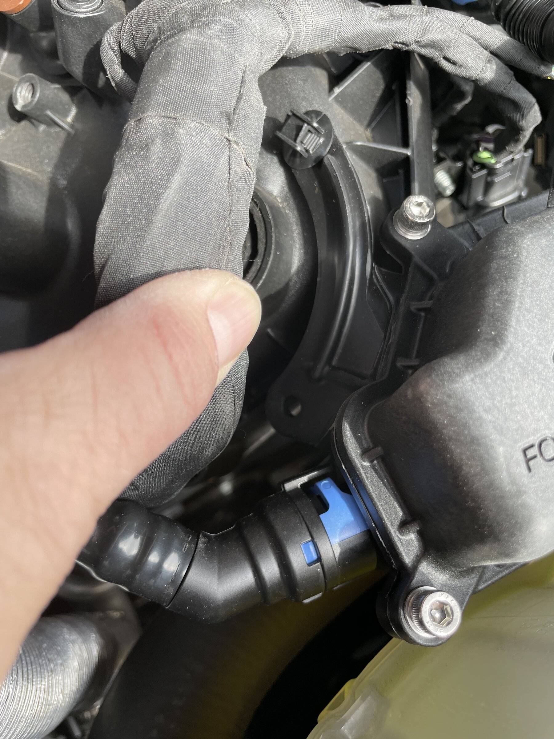

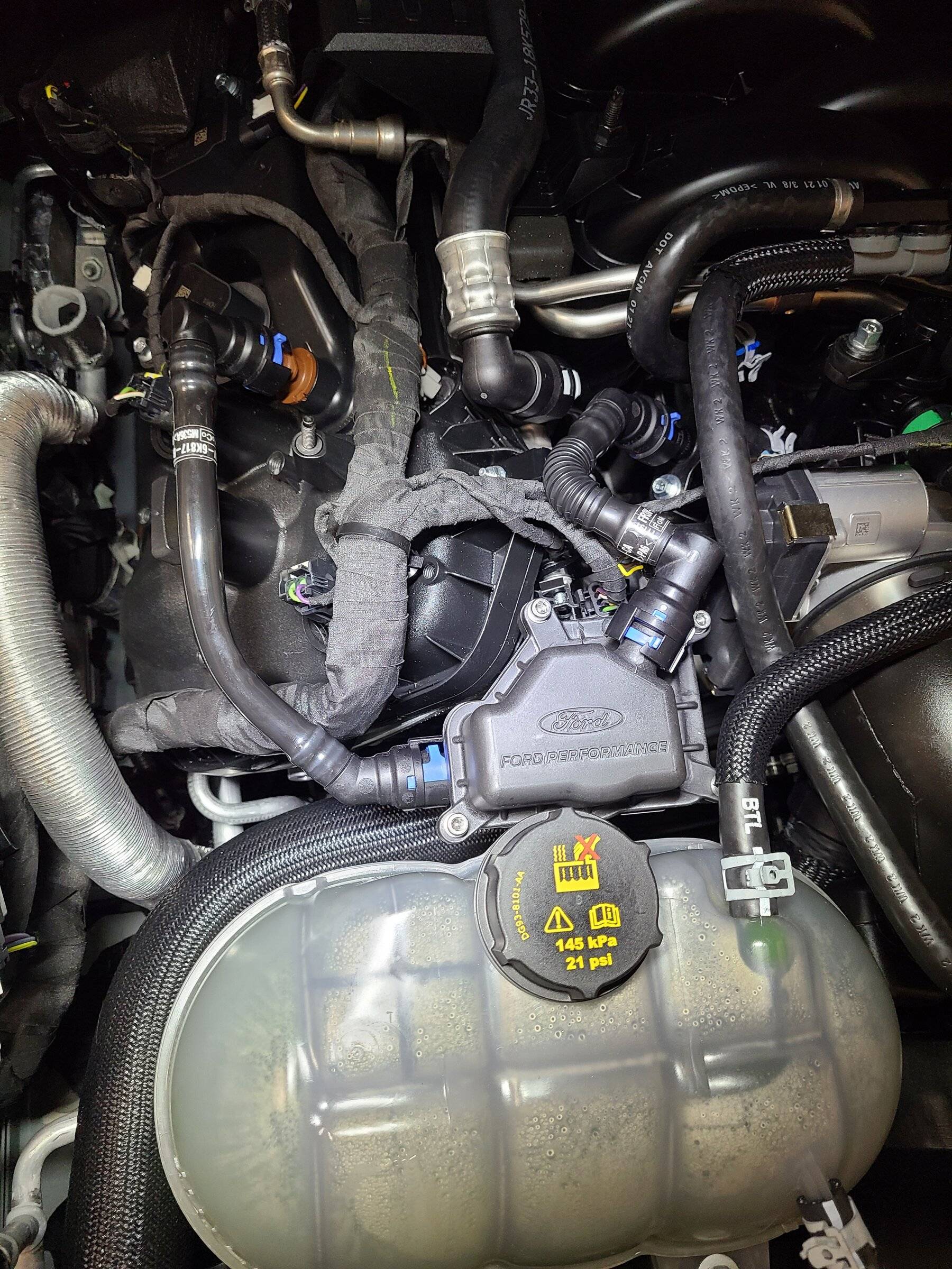

Who here has the Ford performance catch can on their Mach 1 and how was the install? After watching all the videos and reading all I could find on the install (which is very straight forward and simple) I just installed mine. Problem is all the videos out there are on how to install this on a GT350 or a regular GT. The Mach 1 engine though a Coyote is a little different than the GT. There is only one hole for the bracket..you have to remove the rivet holding a wiring harness and use that and there is no hole for the second rivet. So the catch can just hangs there on one side. Also the rivet supplied with the catch can does not fit in the hole...I had to reuse the on from the harness. It all works and seems secure enough but I don't like the idea of one side just hanging out there. If anyone has any info or better yet pics of theirs it would be greatly appreciated. I'll post some pics of mine. Thanks in advance.
S550VIN54
Dec 29, 2015
915
827
Raleigh NC
Stephen
2021 FJG Mach 1 HP
I know what you mean. I had these on my Boss,gt350 and 08 bullitt which worked seamless but this one was a little interesting as far as alignment issues and I had modify the brkt slightly. I was thinking of adding a cable tie as it seems loose on the brkt. I added one to my gt350 just for added security so I may do the same with the mach1.
That isn't the right kit for the Mach1. You need M-6766-A50A for the GT, you got M-6766-A50 for the GT350. The brackets are different.
what part # kit did you get? my install did not use that plastic rivet connecting to the valve cover. i had a thread a few months ago regarding my install. i think there might have been a picture of the finished product in there but i don't remember. it was held on by a nut that connects to a wiring harness bracket. i'm wondering if you got the correct kit for the mach 1? this is passenger side correct?
It is for the passenger side and I bought it directly from Ford. Obviously Ford has no clue about their own products. Part number is OM*6766*A50A. In any case it seems to be in there pretty solidly with the 1 rivet holding it. I will probably replace the rivet with a bolt though. I'll look for your post. Thx

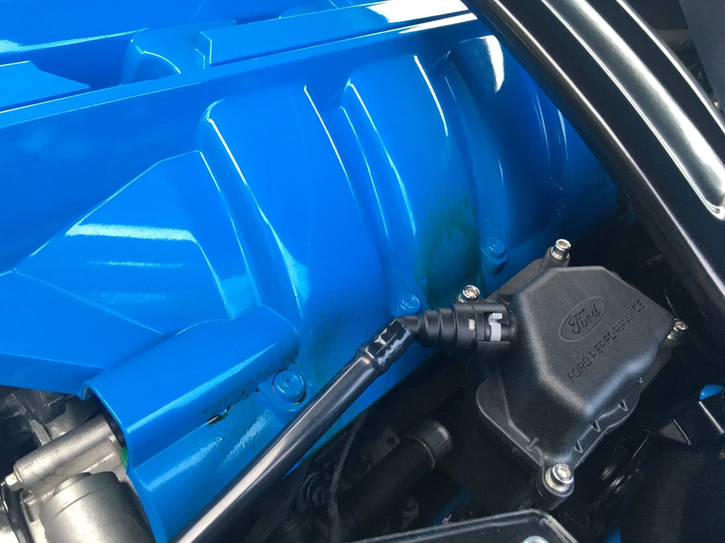

i can take a picture of my kit when i get home tonight if it helps but after seeing one of the posts above someone didn't send you the right kit.
here's the one you want......
frpp oil air separator kit
go through @LevittownFordParts and benny will take care of you!

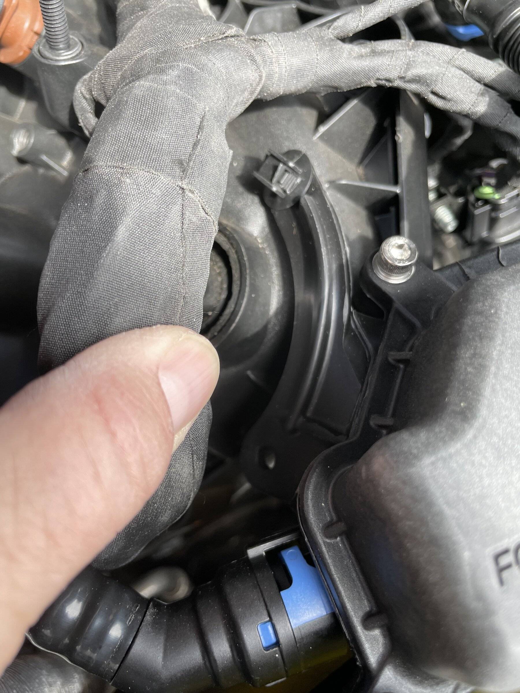

I live right near Levitown Ford and that's where I bought mine from. I actually went there to buy it. From what I can see is that this one has no bracket at all. I may just leave mine as is...like I said it's in there pretty solidly...it is a little annoying though.. Love to see a pic of yours.
Thanks
Just found this on Youtube. 2:45 in this guy installed it exactly like I did.
Also the part numbers on the link you sent me for the correct catch can is the same part number as the one I bought yet they're 2 different catch cans...one with a bracket one without...go figure.
Thanks
Here is mine. Sounds like it was pkg wrong if your p/n M-6766-A50A.
