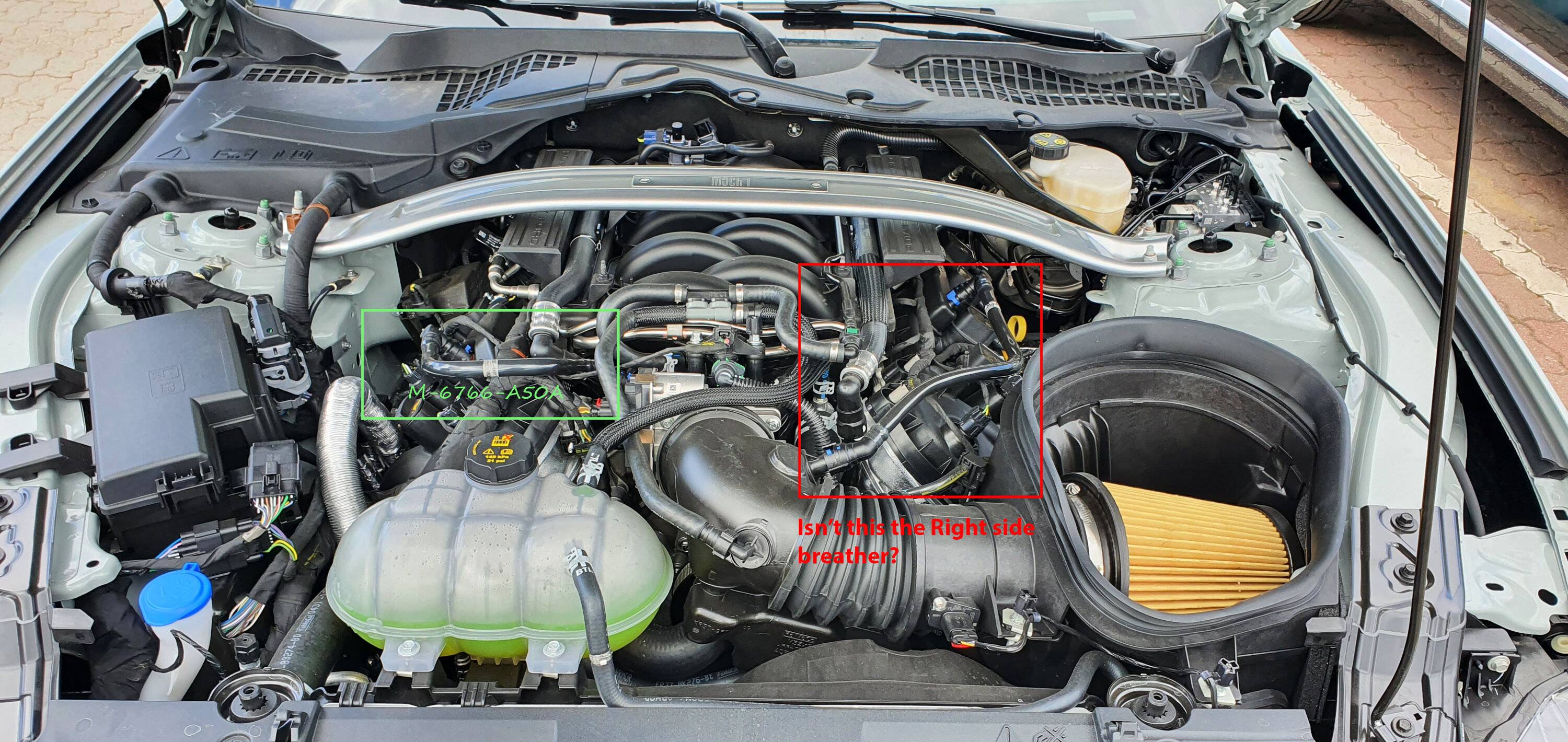

Maybe the engine layout is confusing me, but I see there seem to be 2 breathers, one on the left and one on the right side of the engine.
The passenger side hose seems to be entering behind the manifold valve, and the driver side seems to be entering the cold air suction pipe just like the 350.
This is what I mean.

A general rule I've read here and elsewhere is (correct me if I am wrong): the oil separator to purchase and install is associated with the PCV valve or hose. Buy the kit for that side.
In a M1, you need passenger side only.
If an EcoBoost, purchase and install driver side.
If you have a V8 engine and track often, some like to have both installed.

How's that?
Think about it for a second. The passenger side is behind the throttle body so it seems engine vacuum which is really negative compared to the valve cover/crankcase. The driver's side sees very little vacuum being in front of the throttle body-even wide open. You're drawing a lot more crankcase vapor through the passenger side due to higher delta p.

Only get driver's side if you're boosted. Otherwise it's an expensive looking piece of plastic.

Some info on ford catch can for v8 mustang and Shelby ( except gt500)
If you track the car and do NOT have the 500 aluminum valves covers, you need both the driver and passenger side for sure
If you have the aluminum valves covers, just a bit of oil will be sucked on the driver side. without them. A lot
On street car, passenger is good enough
