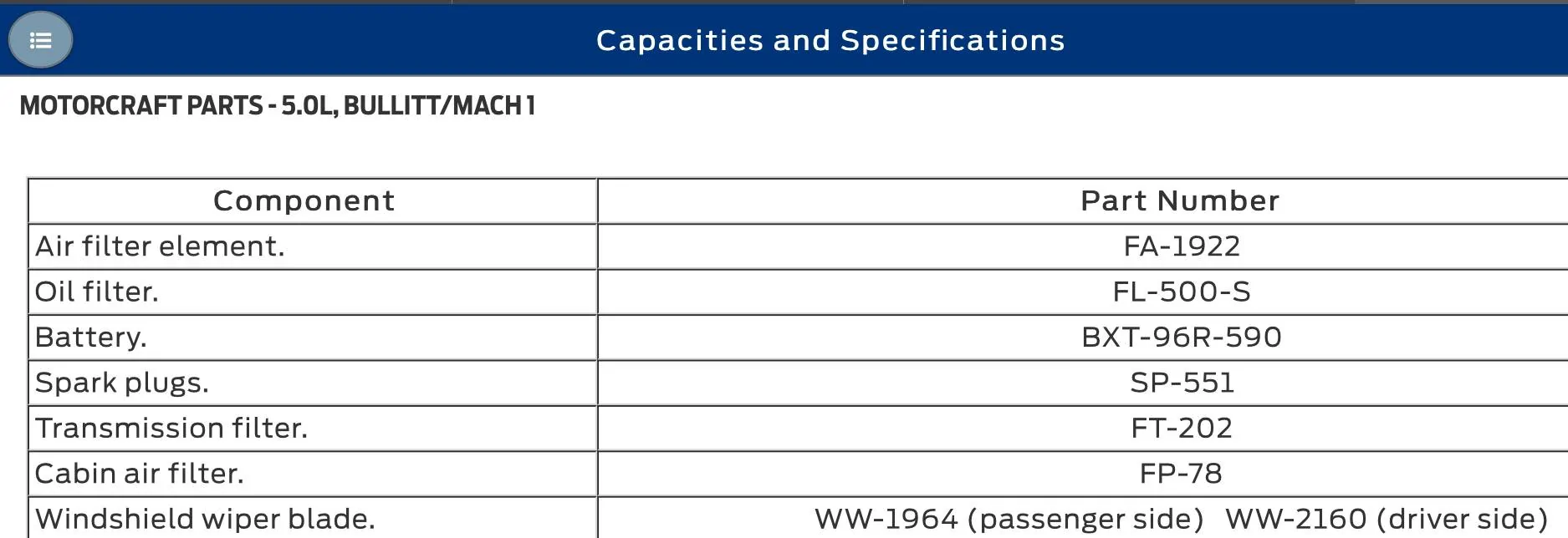

What is the Motorcraft part # for the oil filter on the MACH 1? My supplement book says FL500S same as my 2018 GT. Some say it is the GT350 filter. Has anyone actually changed the filter and knows for sure?

Same trap door and FL 500S filter.

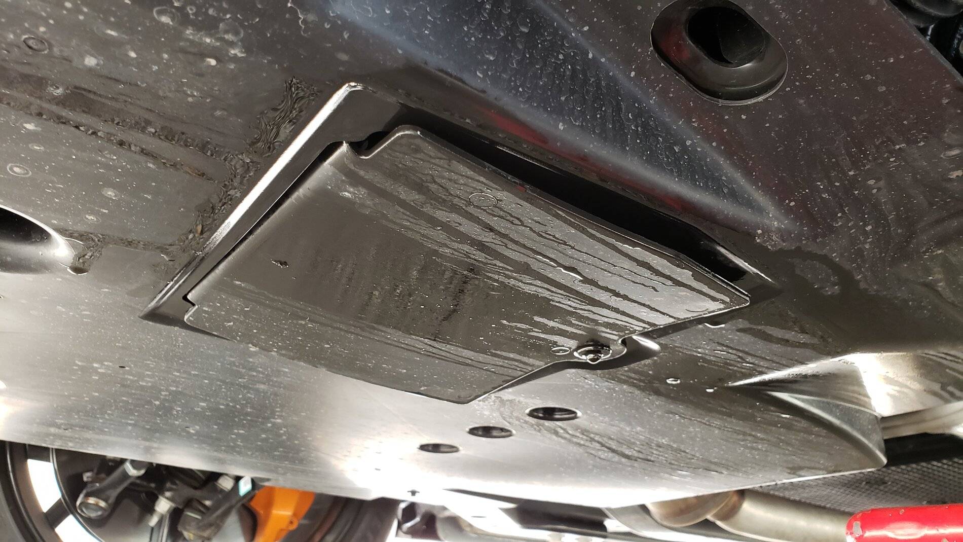

The engine has a much larger cover under it extending to the back of the oil pan. I haven't jacked up the car but by looking underneath I did not spot the trap door, you have seen it?

Yes, drivers side 1/4 way back. has a single bolt keeping it on.

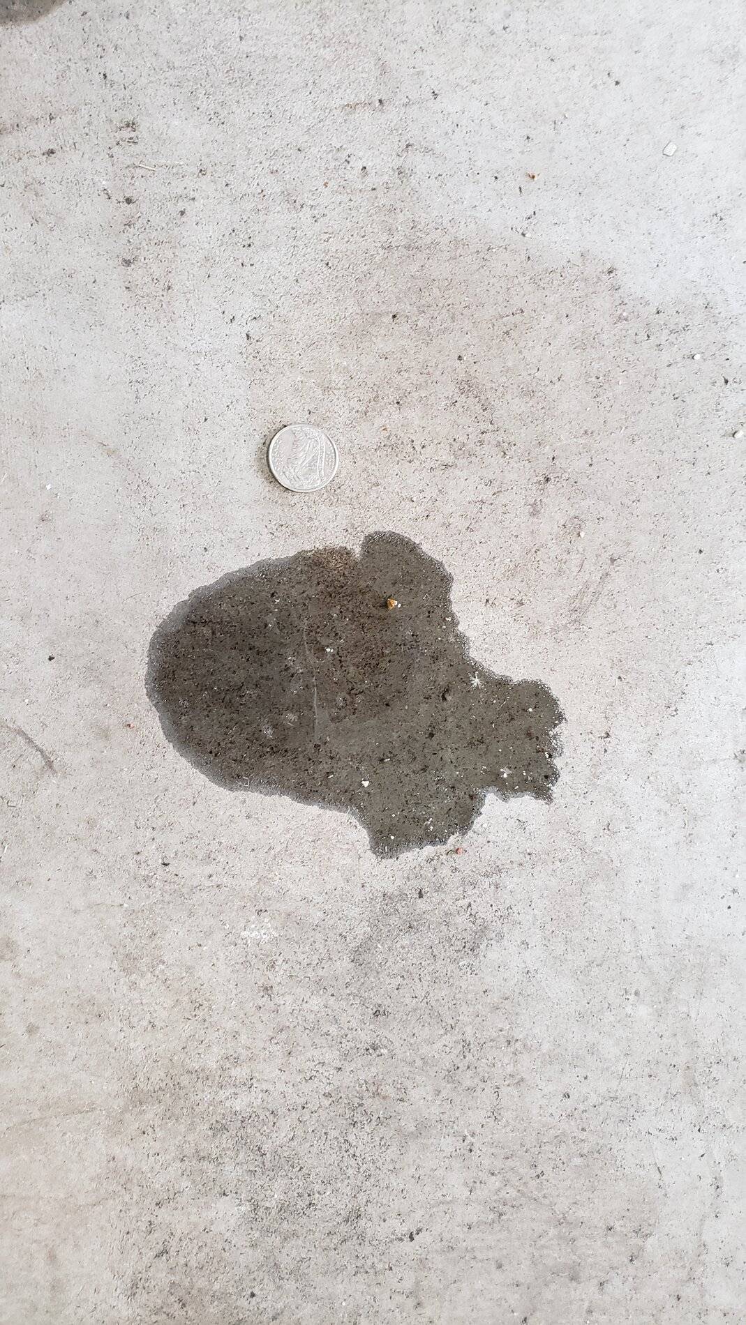

This is my trap door covered in oil. I think it is from the filter change. The drain plug and filter are dry. I washed out the cover best that I could I will see.

Thanks for the photo to help locate the door.
Is the filter still at an almost 45 degree angle making oil changes messy?

My Dealer changed the oil. I think the oil from the filter must have all been caught by the belly pan and now leaks out. At least I hope that's what is leaking.
