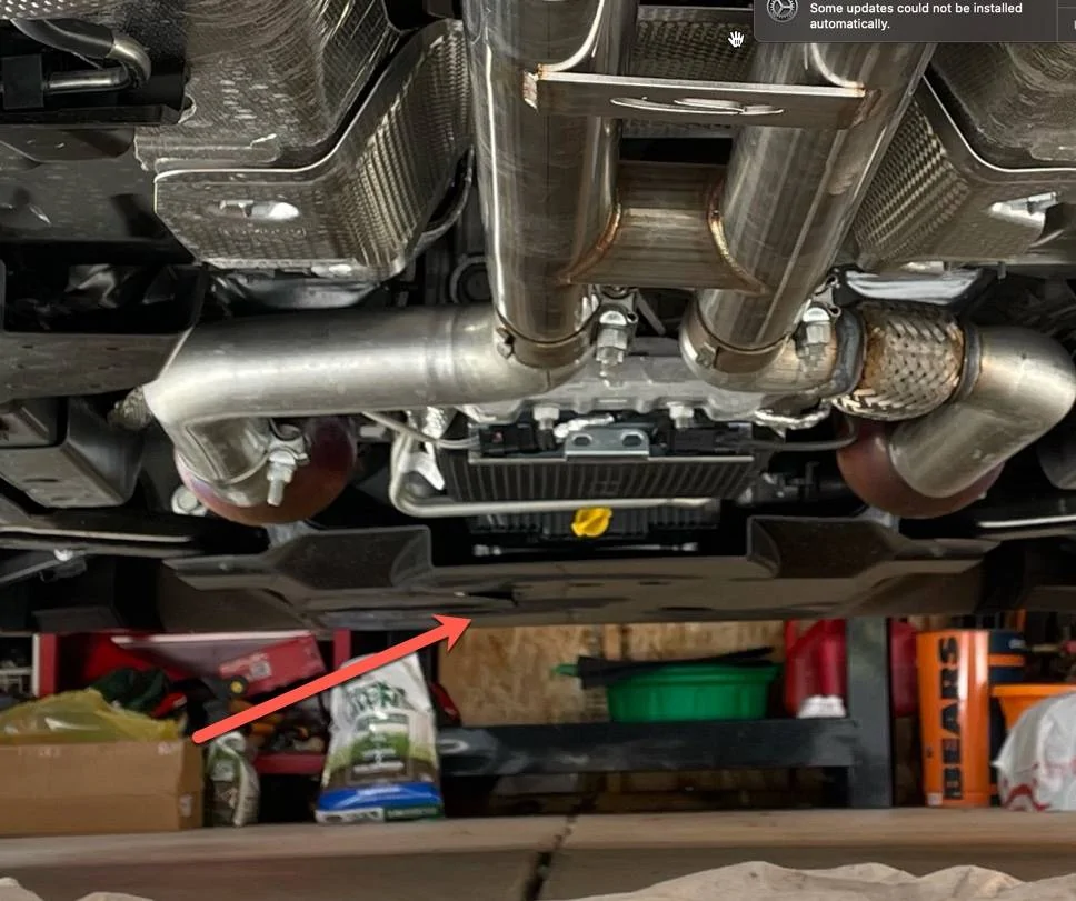

My Dealer changed the oil. I think the oil from the filter must have all been caught by the belly pan and now leaks out.
Your dealer was supposed to make sure that area is clean before it vacates.
melwff
Oct 4, 2016
916
326
Danbury,CT
2021 Mach 1 M2486
My Dealer changed the oil. I think the oil from the filter must have all been caught by the belly pan and now leaks out. At least I hope that's what is leaking.
Lee
Bring it back and tell them to check and clean it.

80 mikes back to dealer. I used a spray bottle with Simple Green, I think it is clean. hard to tell with the car on a floor jack and jack stand. I will watch for drips. That belly pan holds a lot of oil and the filter drains right into it.
Lee
kz
Oct 26, 2014
4,626
2,943
West Chester, OH
Mustangs & F150
Thanks for the photo to help locate the door.
Is the filter still at an almost 45 degree angle making oil changes messy?
Yes, it is - like on every other GT out there. There was someone selling 3D printed plastic things that would direct oil off the filter - I bought it and it is quite effective to keep it clean.

Anyone ever try the ziplock bag around the oil filter while taking it off ? I saw this and it looked like it worked nicely.
ChitownStang
Mar 9, 2015
81
3,259
4,198
Chicago, North Shore
2021 Mach 1
You know what else is weird from your picture is that it looks like the trap door doesn't close all the way. I looked under my car today and noticed the same thing on mine.
Yes, that is what I do and it works out very well, not much mess at all.
Madtel4
Madtel4
Dec 17, 2017
423
275
Kansas
Lee
21 MACH 1, HP 1064, 20 Ranger XLT & 20 Explorer ST
Yes a very poor fit.
