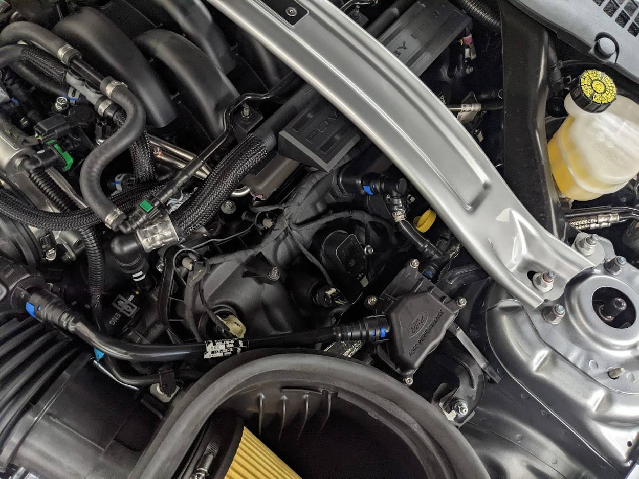

FWIW - I looked at several options and ultimately went with the Ford Performance - mainly for the OEM look. Some of the others don't really mount that I could tell, they just kind of hang there by the hoses, which I'm sure will be fine, but... The Ford ones won't be as easy to empty, but I'll use a small syringe and a rag and it'll work. The bracket on the PS was a little odd, but thankfully I didn't have the issues you did with the harness clip. I added the GT350 DS catch can as well. mounted the same and the hose to the intake worked just fine, but he hose to the valve cover had to be modified. I just cut the hose, warmed it with a heat gun and re-inserted the fitting.
Just for reference -
PS - FMS-M-6766-A50A
DS - FMS-M-6766-A50S (intended for GT350 5.2L)

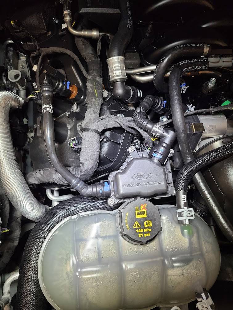

Here is a pic of the GT350 setup with the hose reworked. The rear hose is short and flexed a bit. I'll keep an eye on it and if needed I'll cut up my factory hose, heat it and re-shape it to fit.
Here is a gratuitous pic of the PS - Looks the same as all others I'm sure (I know the rear hose isn't connected all the way - I think I took the pic when I was mocking it up

I remember I had to flip the hoses to make it fit correctly when I had the gt350. And as far as blow by the passenger side was the only issue. Are you seeing it on the driver's side too?

My car only has 500 miles on it - like 50 since installing these. Haven't had it to the track yet, but I'll keep you posted (probably be Spring time - getting cold in Indiana). I figured it didn't hurt to have them both. If I'm thinking about it correctly - It makes sense that you'd get more in the PS since that is the side that will pull a vacuum when the throttle closes - connected to the intake manifold. The DS is pulling filtered air from the air intake between the filter and TB which would typically be at atmospheric pressure (maybe slight vacuum at WOT if the intake can't serve up enough air, but it doesn't seem too restrictive). I think the issue would be under hard sustained cornering you could get some.

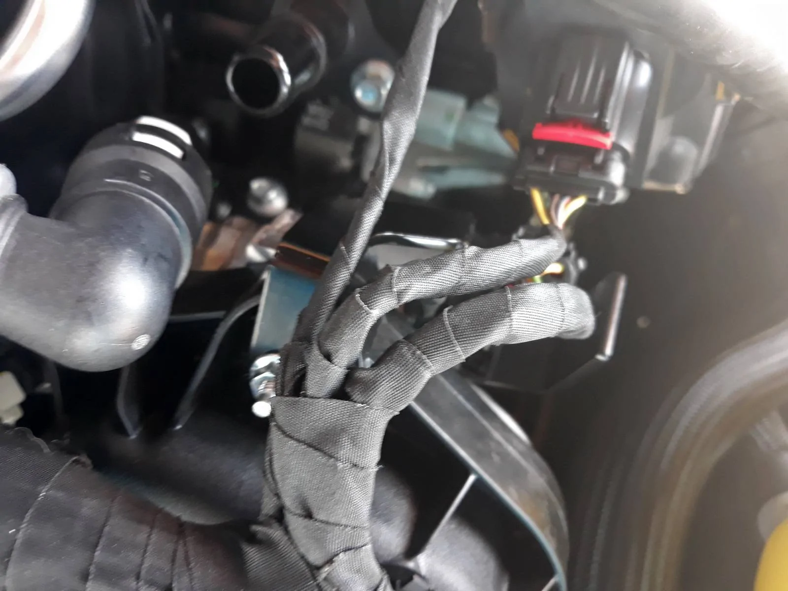

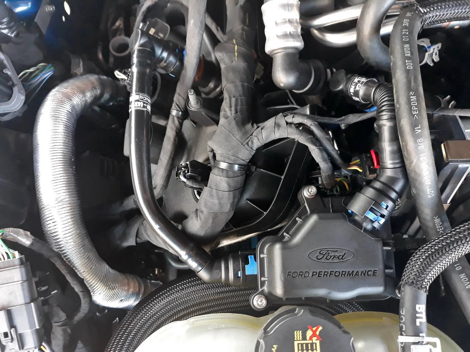

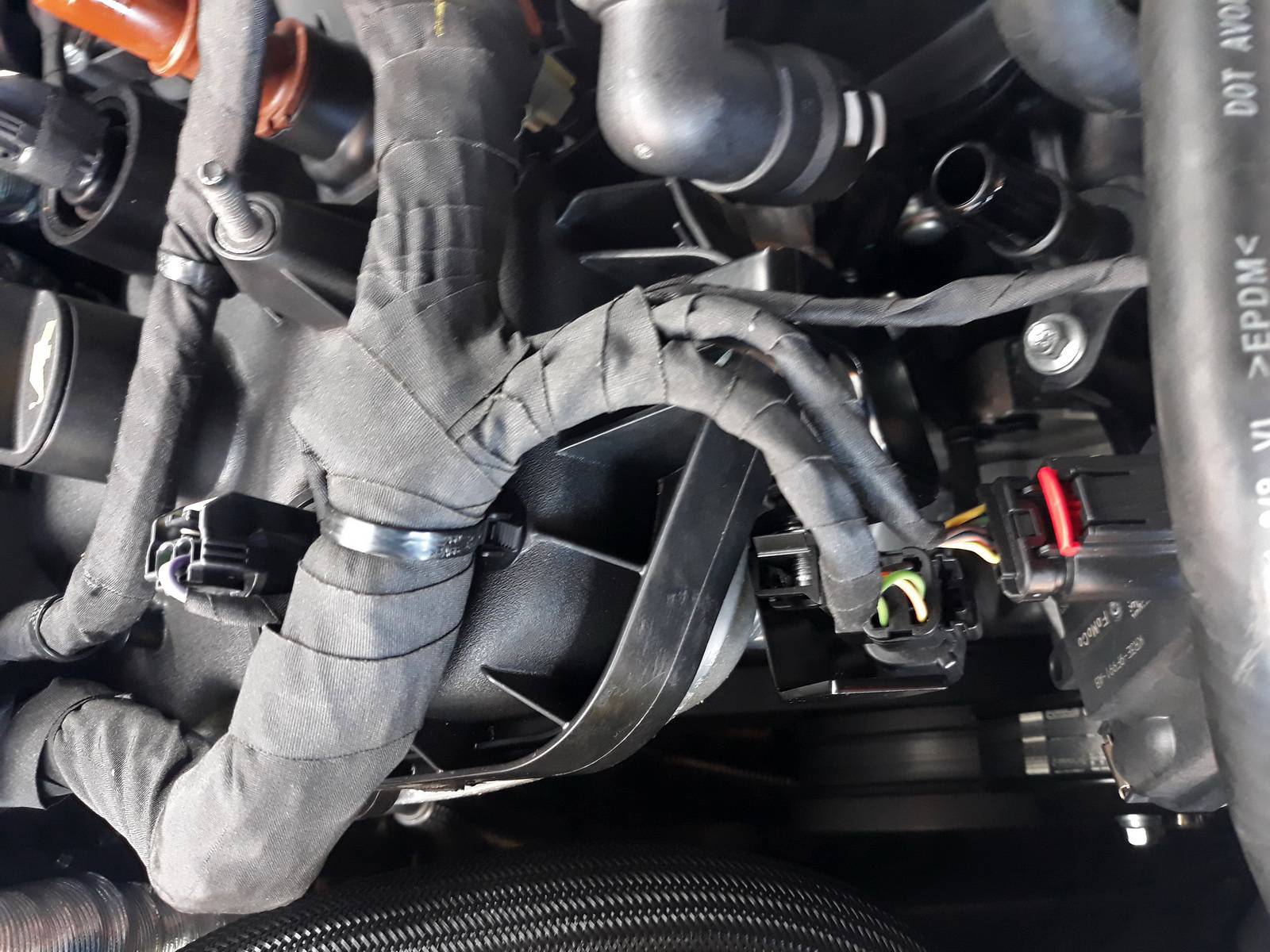

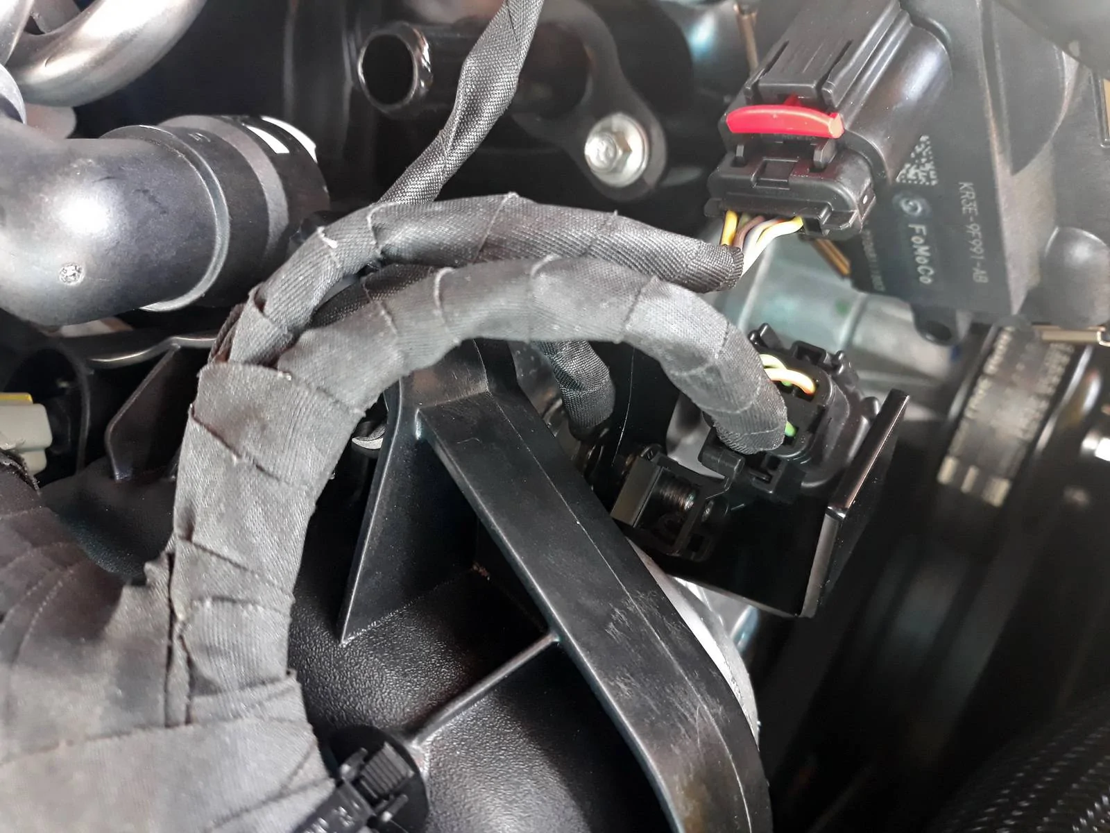

I installed catch can today and I gotta agree with others, the install went smoothly and easily. Make sure to get the proper part M-6766-A50A.
https://www.levittownfordparts.com/sku/m-6766-a50a.html
1 bolt replaced with stud, loosening the electrical harness clamp required pushing with flat screwdriver so it would come off the bolt's thread (and I didn't break it).
I like the bracket design with firm seating and the catch can itself has really nice OEM look, like it's meant to be there. Emptying is a matter of disconnecting two quick connectors of the tubes and pouring oil out, fast and simple.
Took some pics with the bracket, haven't seen many of those around.

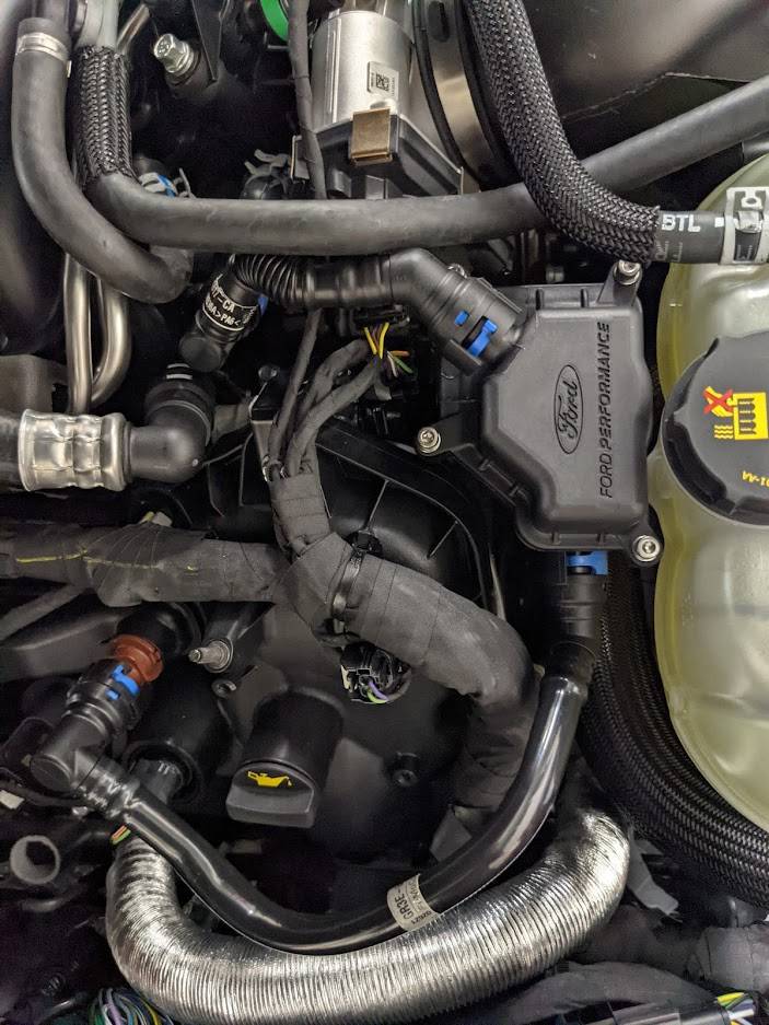

I wish I could say the same. It just goes to show you how different these can be and consider this is the 4th install I have done. note: 12 Boss, 17 gt350, 19 Bullitt
I had a time getting the cam cover bolt off but only took some pulling. Next, the bracket that holds the catch can had to be bent upwards slightly to get it over the cam cover threads before I could add the 2nd 8mm nut. The only thing I may consider is adding a cable tie to hold the catch can in place. I feel there is a bit of travel up and down where the bracket slides under the catch can but there really isn't anywhere it can go considering it is held by the hoses. :)

I have JLT one waiting to install...I am paranoid about unhooking that wiring harness with the red clip though. Don't want to break it...wish someone had a video showing how that part goes. It definitely won't route under it unfortunately.

That was my least concern when I installed mine. In fact, I never needed to remove it as the bracket slid right underneath it. What was the issue as I mentioned it earlier was getting the cam cover bolt out. The washer underneath the bolt was quite snug so it was just a matter of pulling harder and the bracket had to be modified slightly to fit under the cam cover bolt.
