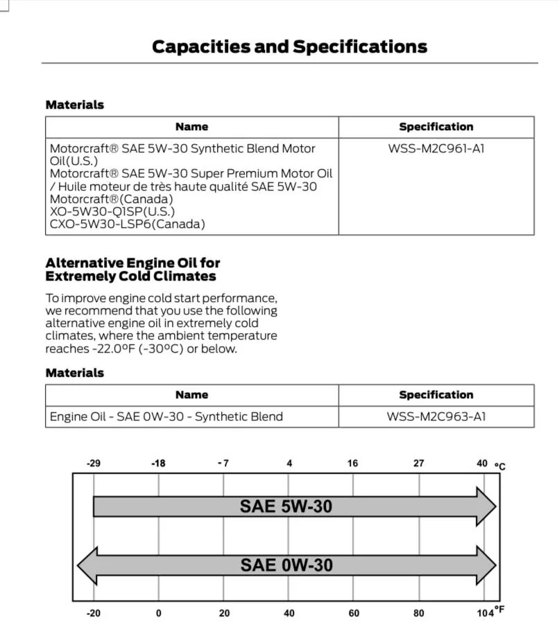

Hi all I picked up my mach a couple of days ago while I was there I went to the parts shop to get a litre of oil and some coolant, anyway I was given 5w-20 ? I looked on oil cap on engine it says 5w-30 now I am sure I heard on here fords changed to 5w-30 a while back didn't they ? if you look in hand book it says 0w-30 ? can you guys put me straight it is 5w-30 isn't it.

yes 5w 30 for mach 1
Which brand did you use? Because Euro spec cars have GPFs installed and they require oil that meets C2 spec (low sulphur)
Right now it’s seams only Miller oils have one type of 5w-30 that meets this requirement. Castrol A5 doesn’t meet the C2 grade.
After speaking to Ford UK on the phone and confirming the new Mach 1s switched to 5W-30 to help prevent (engine ticking) they also confirmed A5 doesn’t meet the spec required in this engine and would in fact void warranty.
Personally I think Castrol 5W-30 A5 is most likely better than Ford spec but above is what I’ve been told by the manufacturer. 🤷🏻‍♂️
