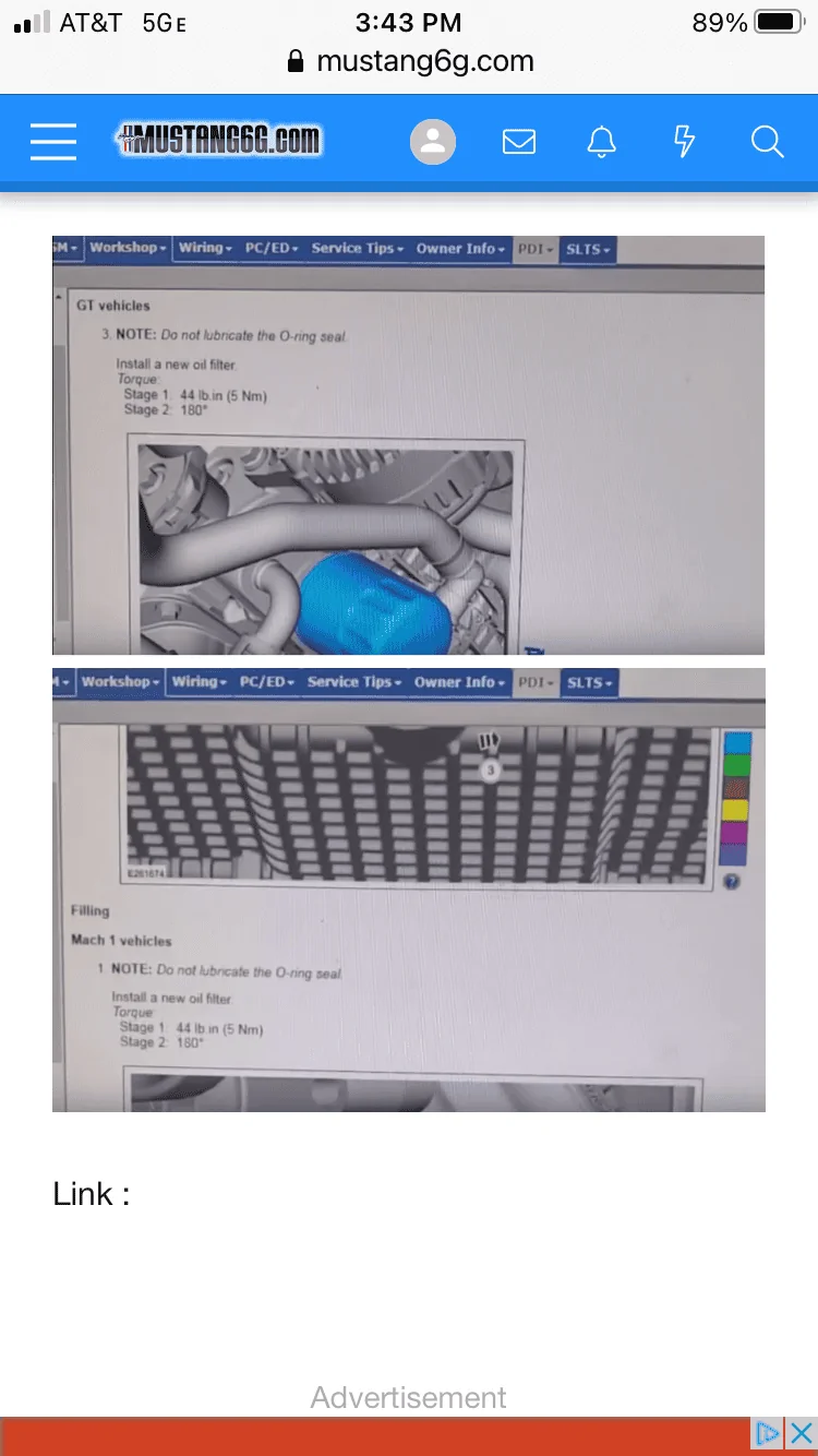

1. The Oil Filter is to be replaced WITHOUT placing any oil on the new filters O-ring, which goes against everything a Mechanic ever learned.
(see below photo on Oil Changes, as someone posted the Ford Tech instructions previously) Not saying this is your problem but just be aware.
