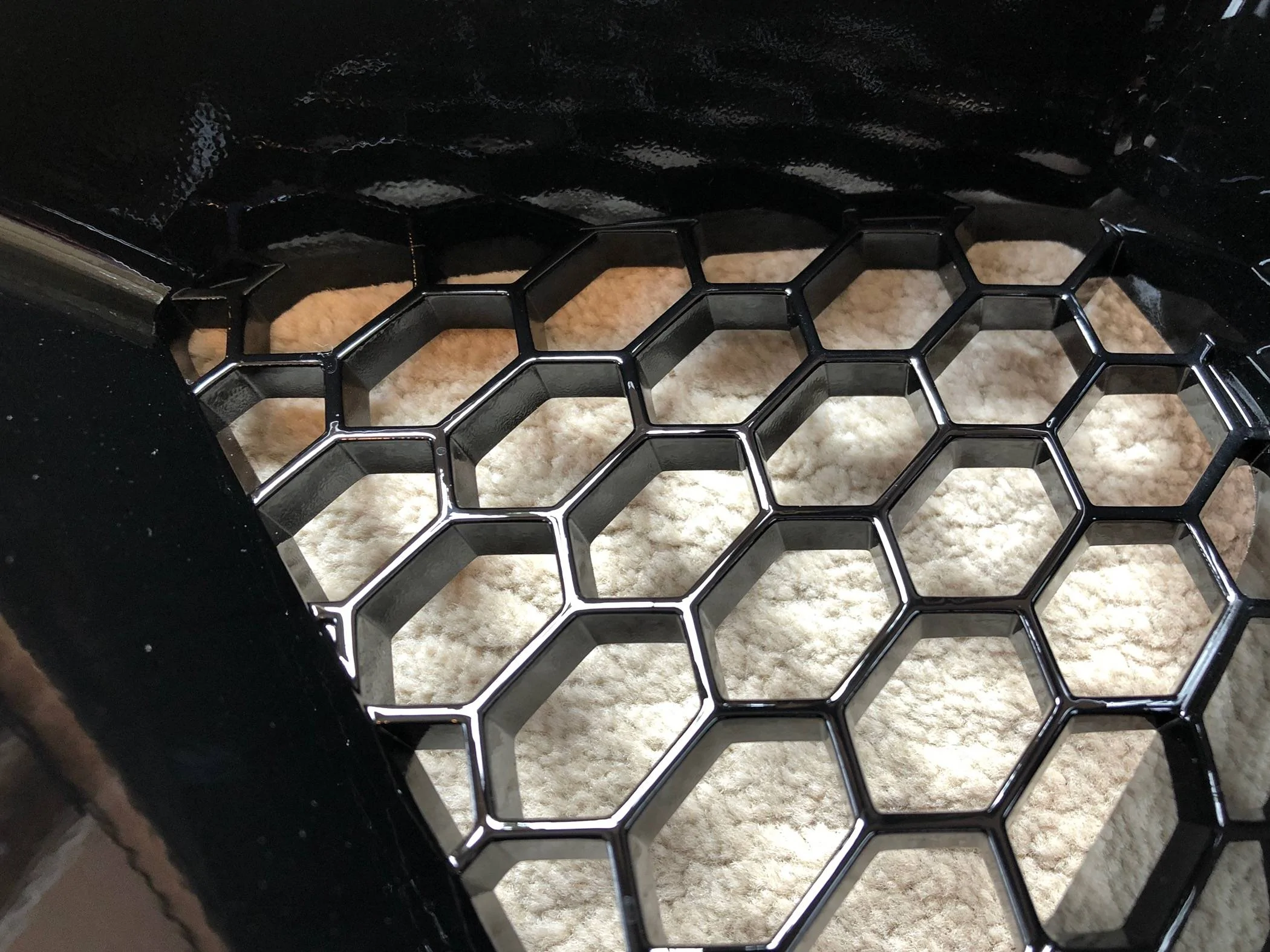

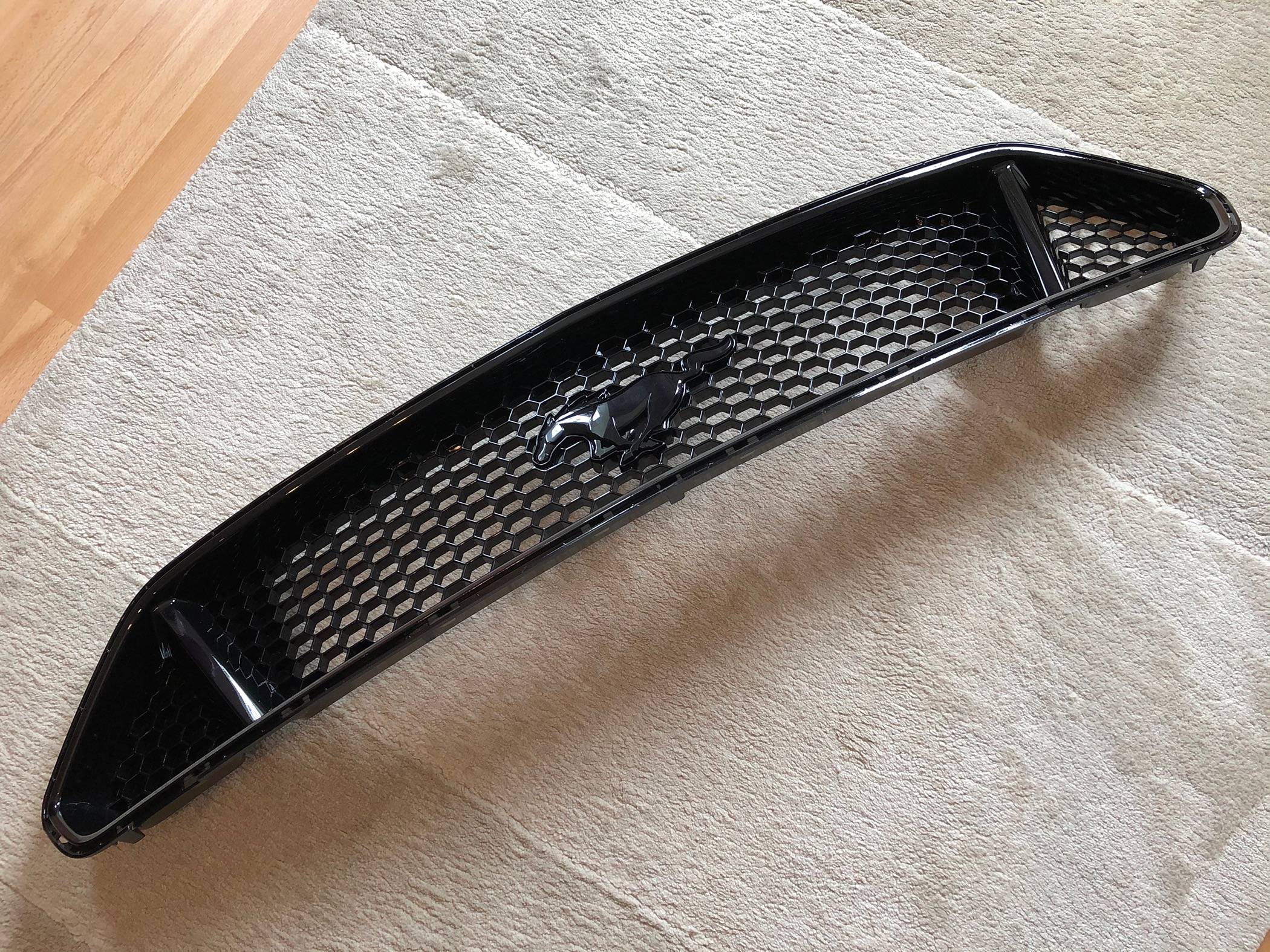

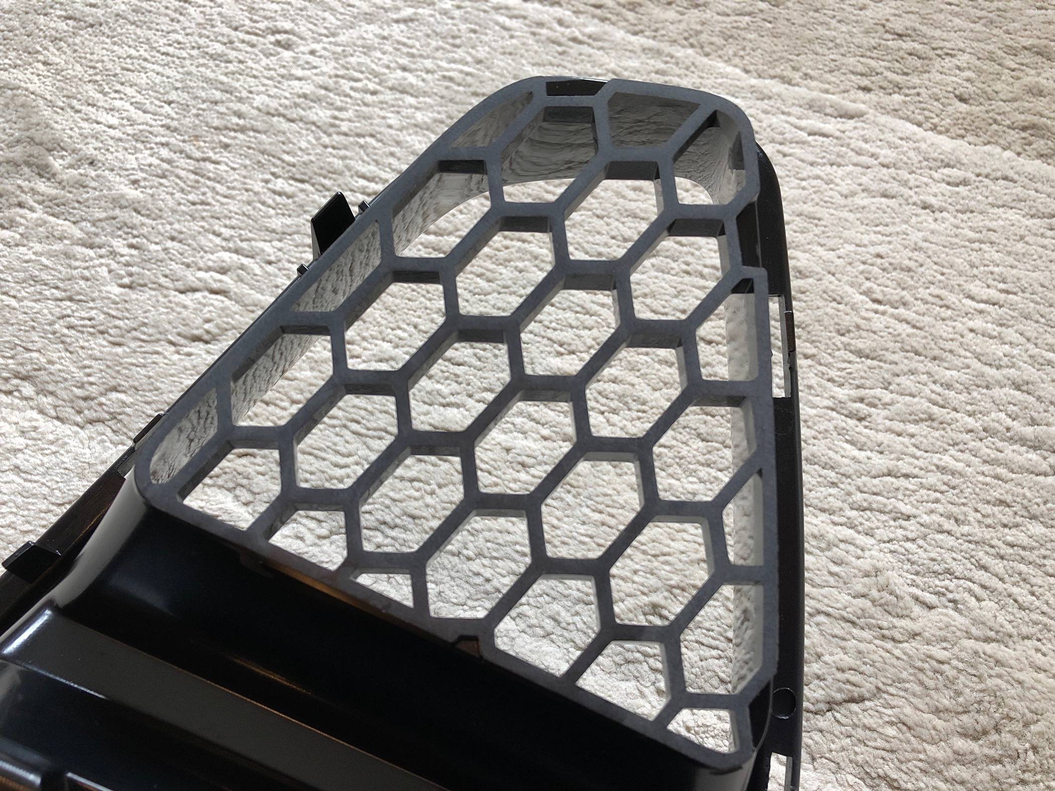

I was unlucky / lucky that the front end had to come off before delivery, so I took the opportunity to work with the body shop, collecting the grill to sand the back off it and swap the badge, before giving it back to them with the big mouth.
I just watched LMR’s video on removing the upper grille. I didn’t know the whole front bumper needed to be removed in order to remove the grille. If I were to do this, I would want to do it the way WD Pro did his (sanding the back of the grille). It also make sense to me to add a lightweight bumper support while right there.
I will take the front end off again as I have that lightweight bumper bar to go in, and I want to add the Ford Performance gloss back bullitt lower grill.
My inlet route is sanded grill - big mouth - 18+ air box with the (older smaller) carbon trap removed - AEM dry filter.

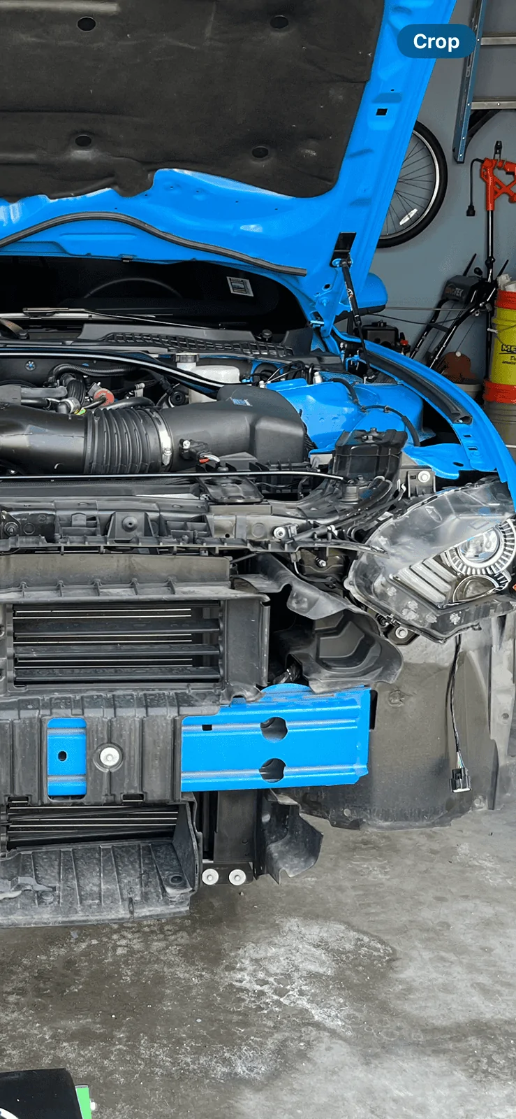

You have to remove the bumper, and the front grill is a bit of a pain to take off (if you're replacing it not just sanding it down which doesn't require removal).
Overall it's not hard to do, just time consuming.

As EFI said, it’s not hard, just time consuming. The grille and bumper support can be a bit of a pain to get out but I found it fairly easy once the first few clips were popped out. CJPP has a really good video too (YouTube search the FP Bullitt Style grille CJ Pony Parts Install, Bill does a really good job showing all the steps).

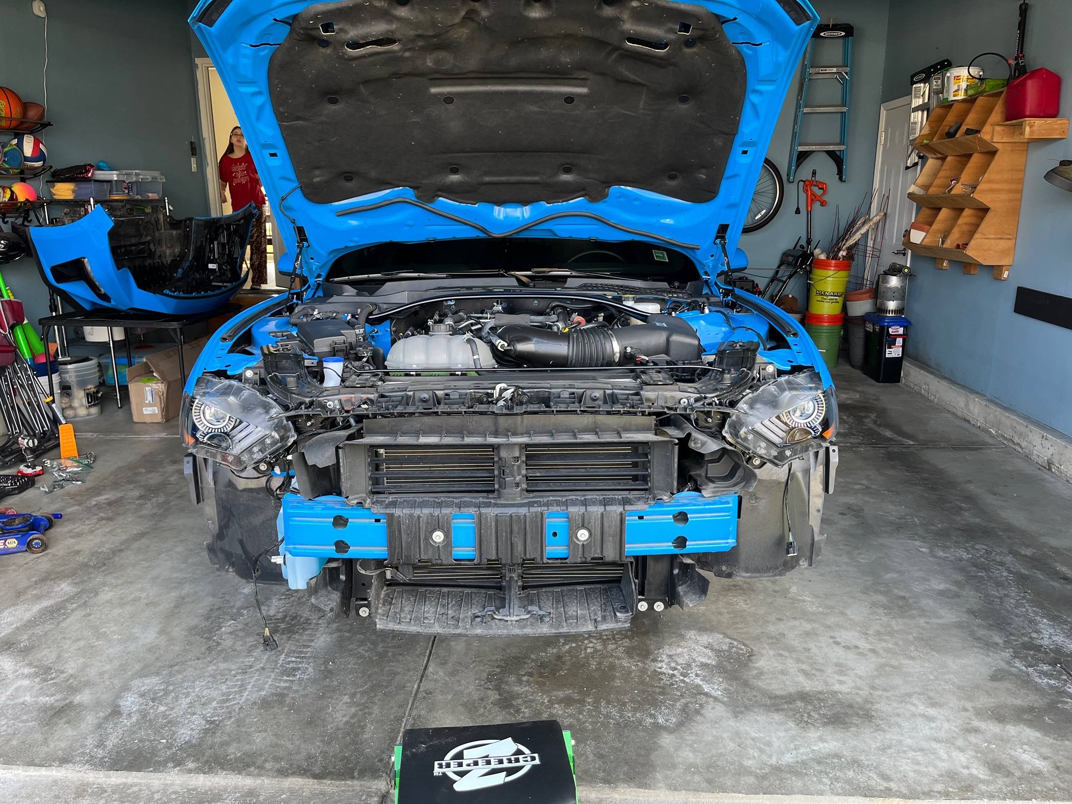

Front end is super easy to take off. I did it myself in my driveway to replace my grille.

Use a thin flathead screwdriver. You just need to create enough space for the clips to release (they’re the tabbed clips and are actually fairly robust). They are bit stiff so I could see one snapping if you get too aggressive with it. Once I got 3 or 4 of the tabs popped, I was able to just use my thumbs to separate the rest. Just make sure when you pop the grille back in that all the tabs click back in. The curvature of the grille makes some of them difficult to pop back in, just requires a little extra oomph.

Using a dremel with a router bit was much easier than removing the grill. The grill is not weakened at all and cleanup easy with a shop vac. You need a steady hand. But pretty simple really.
