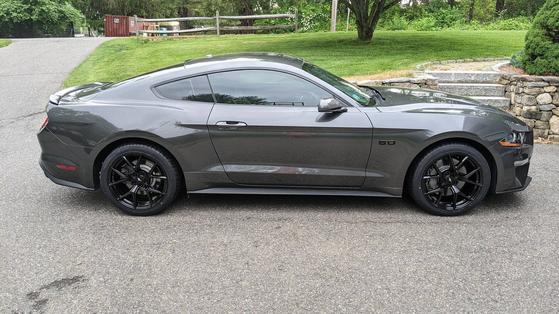

I have a 2019 GT Premium, no PP, no Magneride, on 19x10 SVE wheels. I've been highly considering the Steeda Progressive lowering springs to drop the car 1". From the install videos I've watched, cutting the bump stocks is the only additional step. There wasn't mention of alignment or camber plates. I'm just trying to reduce the wheel gap, and not completely ruin the ride. I am in the Northeast, so yeah, the roads aren't great, but it is what it is. Will the spring-only upgrade do what I want, possibly with an alignment after?
Here's my car currently:

Its a question of what camber do you want to run. Apparently the rear can be adjusted by a mustang knowledgable guy, to the right spec, the front will probably need a camber bolt
Or you can run higher negative camber and be fine, the car will be better in turns but the tire will wear badly, but ride quality will be better not worse by most other springs than oem

Whenever we install lowering springs on a Mustang at our Valdosta, GA facility, we require the Steeda 555-8139 Mustang Camber Plates (2015-2024) to ensure proper alignment.
➡ Why? The factory strut mounts do not allow for camber adjustment.
➡ Lowering your Mustang naturally increases negative camber, leading to uneven tire wear.
➡ Our Steeda 555-8139 Camber Plates correct this issue on street-driven Mustangs, preventing premature wear on the inside edge of your tires.
Protect your investment and get it done right the first time with Steeda Camber Plates! You can do it at the same time of install & will pay dividends down the road.

Do it! I had just the lowered springs using factory struts and shocks- no uneven tyre wear after six years- no alignment necessary. Looks excellent but the rear hammers over bumps :(. easy to cut half or one coil off the standard rear springs-fronts cant be cut due to their tapering

It wont wear THAT badly, but it will wear worse than the correct camber. Bad camber isnt the worst for bad wearing, toe is most important for eating tires
id also say just do it and if it becomes a problem you can add the tophats or camber bolts later

If you lower a car, the alignment does change, not just the obvious camber change bit the toe on all four corners will shift, and if you disassemble the rear and front to put those lowering springs in there, that can also shift the alignment.
Basically budget for an alignment after lowering. Your tires will last longer.
Im not saying you have to correct the camber effects from lowering, but at least fix the toe after you drop it. If you cant afford the alignment, idk man, dont lower it.
