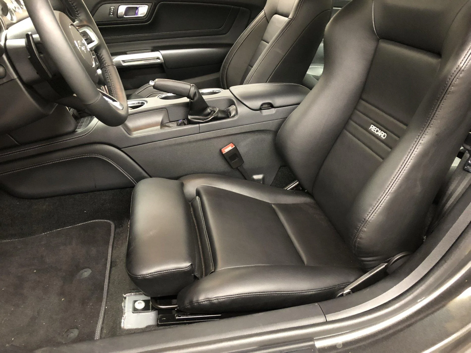

Ordered them from Griffin Motorwerke West in BerkleyWhich mounts?
Planted mounts only got me ~1" lower. Had to go to custom fabricated mounts to get ~2.5" lower with my seats (Evo 8 Recaros).
Need to throw some flat black paint on your floor pan exposed when the big square footers on the stock mounts were removed.
With 3" or more seat lowering, have you also lowered or considered lowering the steering column? Having it aimed anywhere from eye-level up to the top of your head hardly sounds like a good idea from an ergonomic standpoint.I ended up pulling out the factory seat and putting in a Recaro seat, no heating, no cooling, no power anything. It ended dropping the seat 3-4 inches and still have seat track adjustment. Just needs to add resistors for air bags fault. I can now wear a helmet with no issues, now my eyeliner is below the rearview mirror which helps. Only did the driver side or you need to add the sensor for the passenger.
