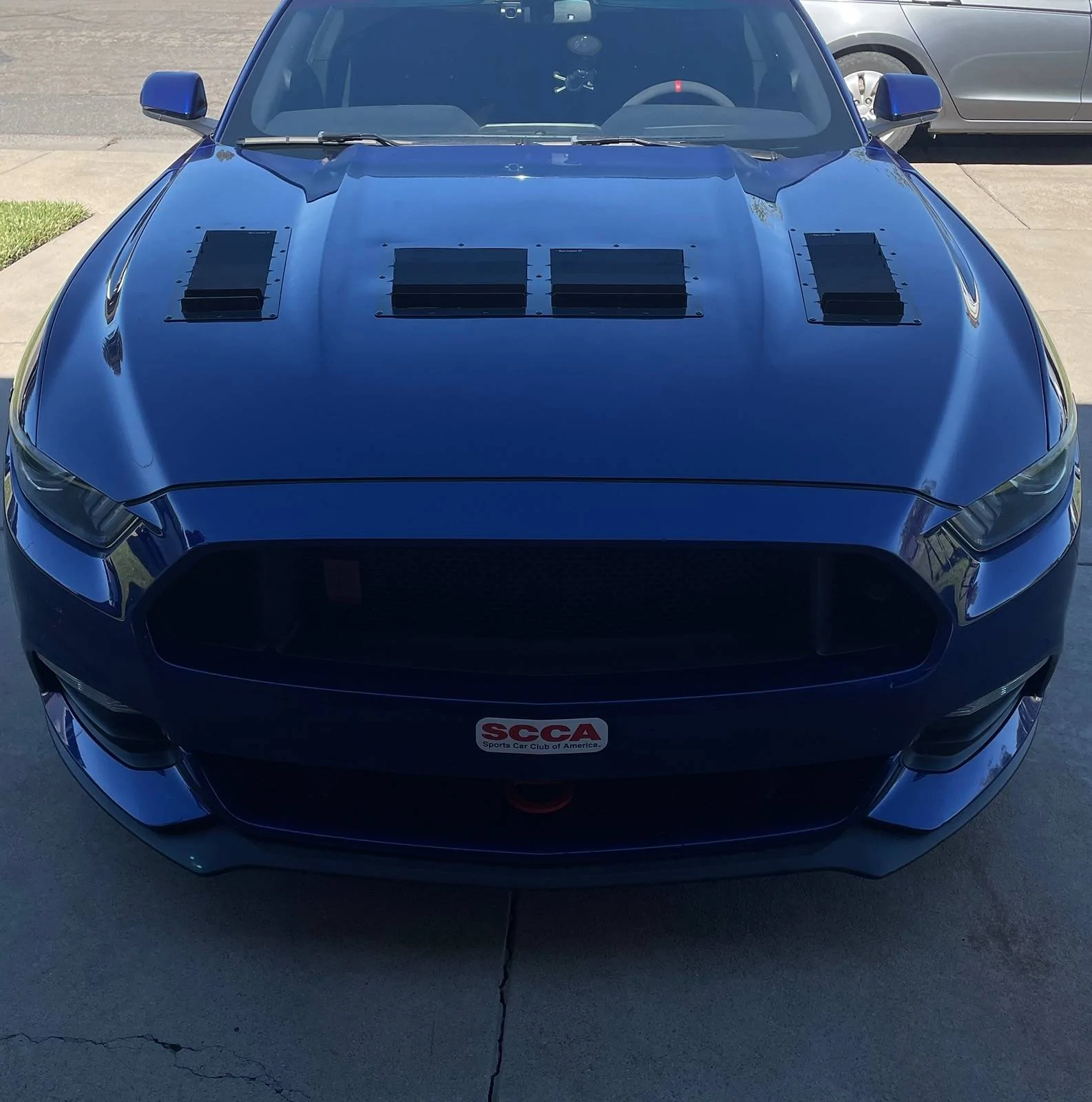

Vent the hood to help with engine compartment heat soak.
Yep got it planned. Just haven’t found the time. Got 100 things going right now and my fiance would kick me out if I run the grinder at 11pm when I finally get time to work on my car.

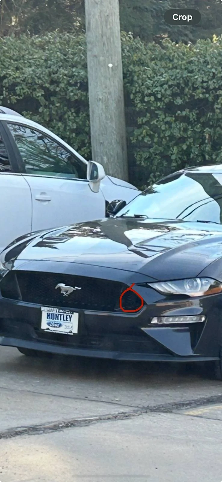

Do you have a pic that shows the area you're talking about?

Pretty much this area next to the fang on the drivers side.

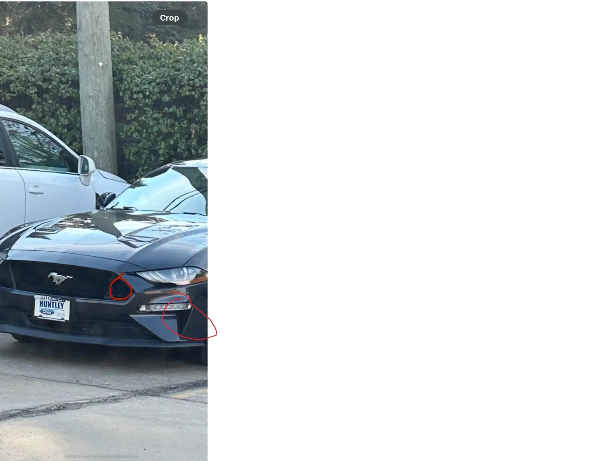

What about this area? Any benefit to opening up?
No not unless you have a fenderwell intake.
The upper grill section is huge to open up. You have a big snorkel going directly to the airbox and it's supposed to breathe through 1/4 the opening. By opening that part of the grill all the way it matches the size of the snorkel.
