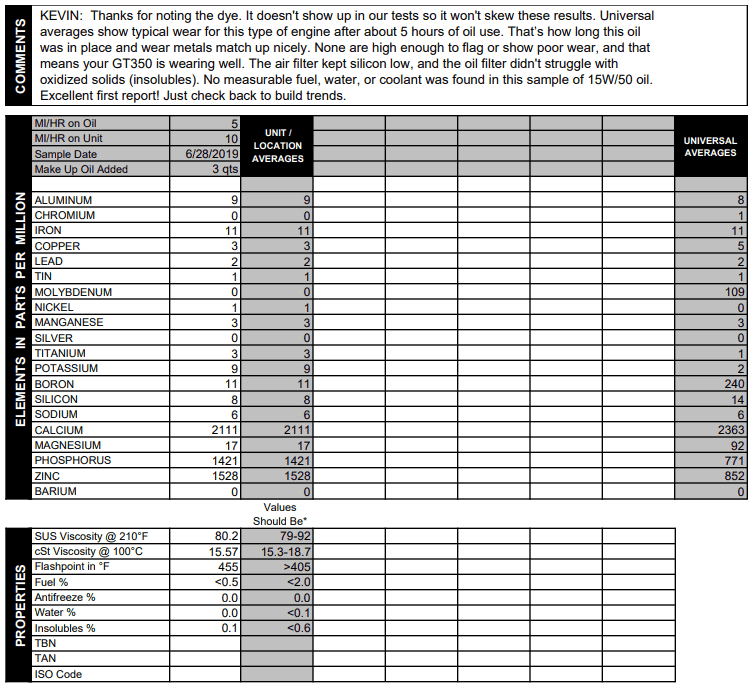

Got the oil analysis back from Blackstone and all is looking good. This was from the VIR and Road Atlanta trip. Will be sending the next one in after my next weekend at COTA in October.
Regarding dye, there was some left in the motor/accusump from when I was trying to source the oil pan leak.
