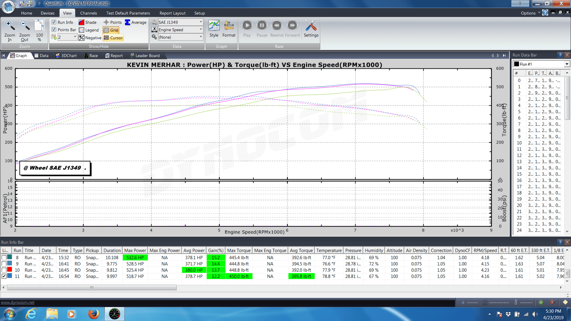

I'll have more to share, but here are the numbers. Very conservative road race tune and on a mustang dyno.
Never thought I'd say this to a man, but damn those are some nice curves
