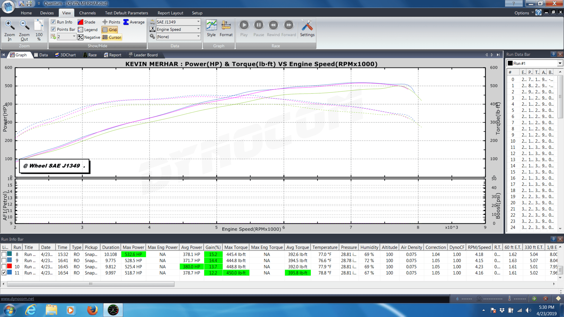

Nice list, thanks for sharing. How much power are you making? Got a dyno sheet? (If that's too personal because you are racing, I understand.)
The engine makes ~540whp on e85 on a conservative tune (it never goes above 28* of timing). We have tunes for E85, 100 octane, and 93. Run E85% over 90% of the time since it's cheap and burns so clean. Really just put 100 in when I want to "clear it" of moisture.
Here's a couple dyno graphs from break-in day.

What I find amazing is how you were able to get that awful torque dip in the 3000RPM range out of the torque curve and it's so smooth.
You definitely feel it. Worth it for sure. Motor is buttery smooth and ultra responsive. Perfect for track use.

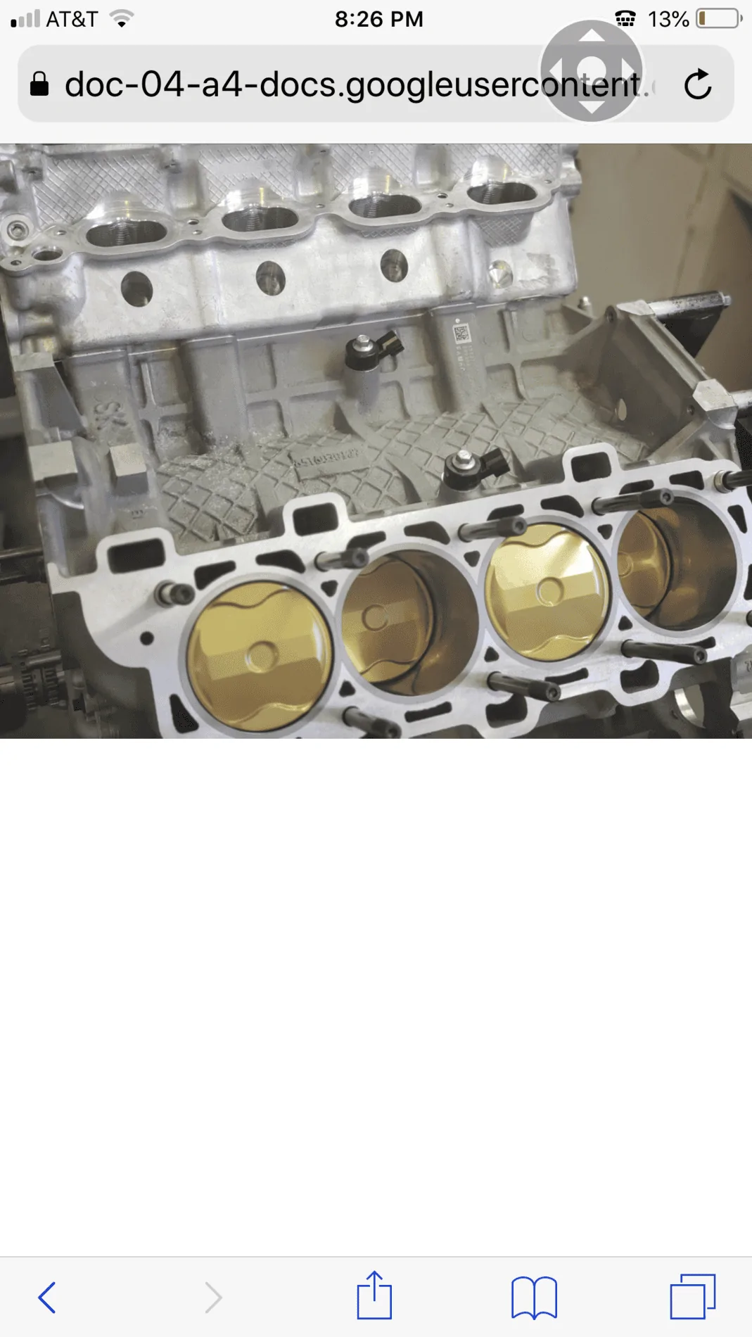

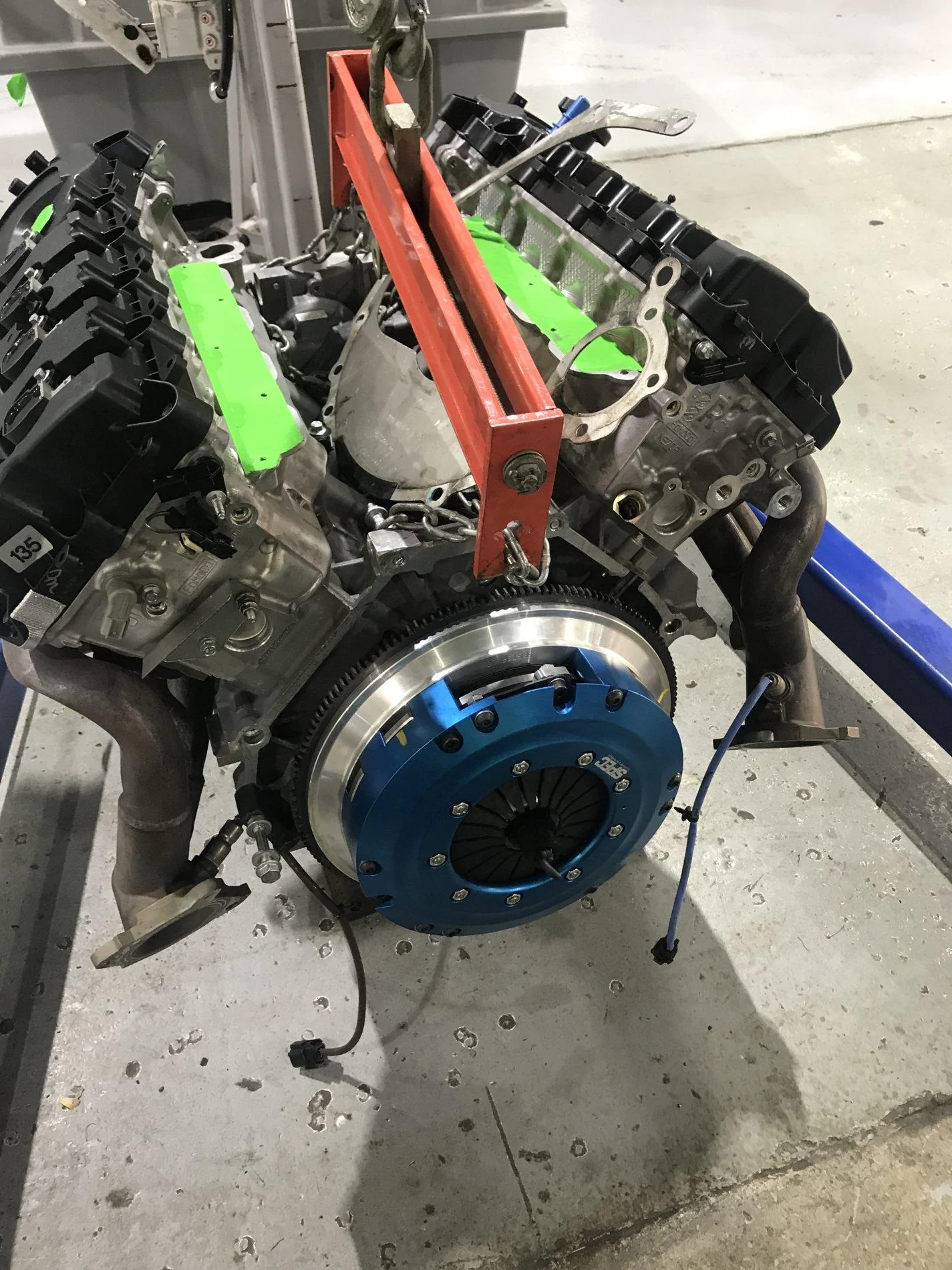

@honeybadger . Thanks again for being such a pioneer . I have screen shot for future reference .
If you are planning to go FI I would suggest at least upgrading the rods .Even though are a “forged” I did bend a couple running a Gen 5 whipple and 3.5 pulley . I know others have not had issues at higher boost levels but might as well since no additional labor and the Voodoo specific Manley rods (rated at >750 hp with 2000 bolts ) are cheap .
Also note Ford changed the design of the pistons for 2019 and the stock pistons now cost a lot more .....so much you might as well upgrade .
Rings are also no longer available for the older version pistons .
I sent Will @ RPG Tunning my long block and its going back into the car as we speak with upgraded clutch .
Block had to be sleeved and was rebuild with diamond pistons and Manley rods.
Heads have New valves , upgraded PAC springs and ARP head studs
Engine already had upgraded OPG/CS .
Total cost a lot less than you would think .

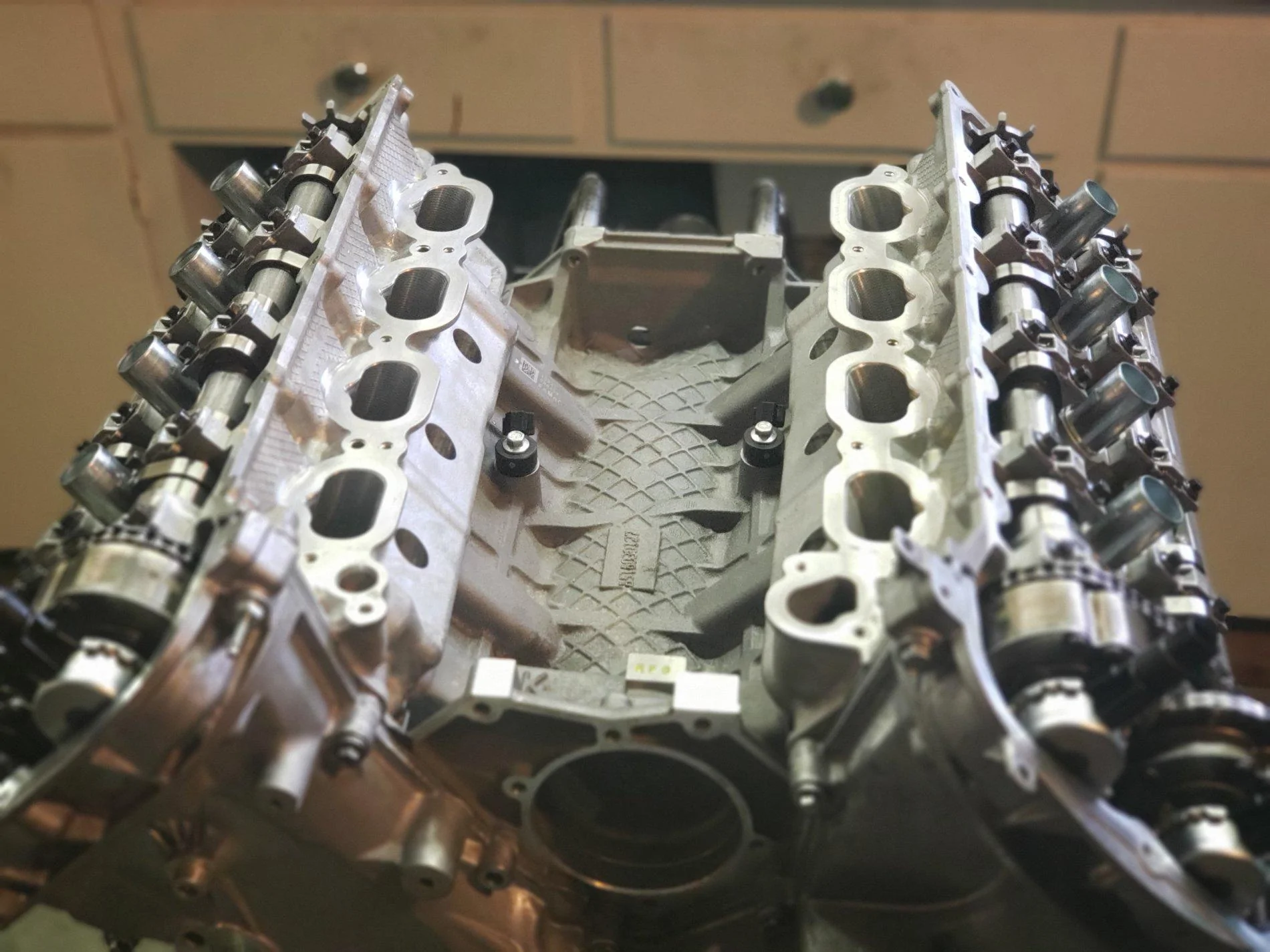

I am also in the process of planning a “spare” build .
I got a quote for $3K sending a “spare “ complete engine I have for a rod upgrade but I would also at least upgrade the springs
I also have a rotating assembly ./crank/heads/cams I may send to assemble into a long block (with upgraded rods -( may be I will do the ultralight rods in that one )
I want to use new predator block as starting platform since it has all the upgrades for the GT500/Boost .
I would have liked to also use the Gen 2 heads but have to draw the line somewhere . Lol
