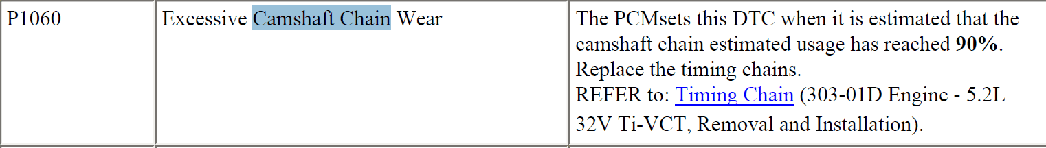

I'd be curious what parameter they are using to determine that the chains are done?
I'd like to know as well. There's even an engine code for when the chains reach 90% wear.

Then there's this, from the 2018 Owner's Supplement:
"Timing Chain
If you use your vehicle extensively at a race track or at high rpm, it is possible to exceed the service life of the engine timing chain. A wrench indicator light will illuminate when it is time for you to replace your chain. See an authorized dealer."

The PCM learns the adapted values of the timing chain from the camshaft sensors and crankshaft position sensors and when the chain stretches it will retard the cam timing and the crankshaft and camshaft position sensors will be implausible and will set the fault. It will have a preprogramed amount of tolerance built in if it exceeds the tolerance the wrench will illuminate. I am sure this will take a lot before this happens but if the engine is apart you are smart to change them now and will probably never need to worry about them again.
