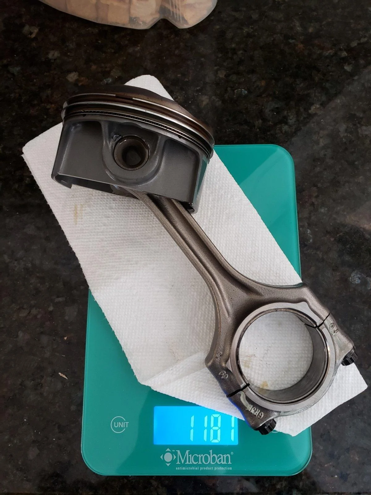

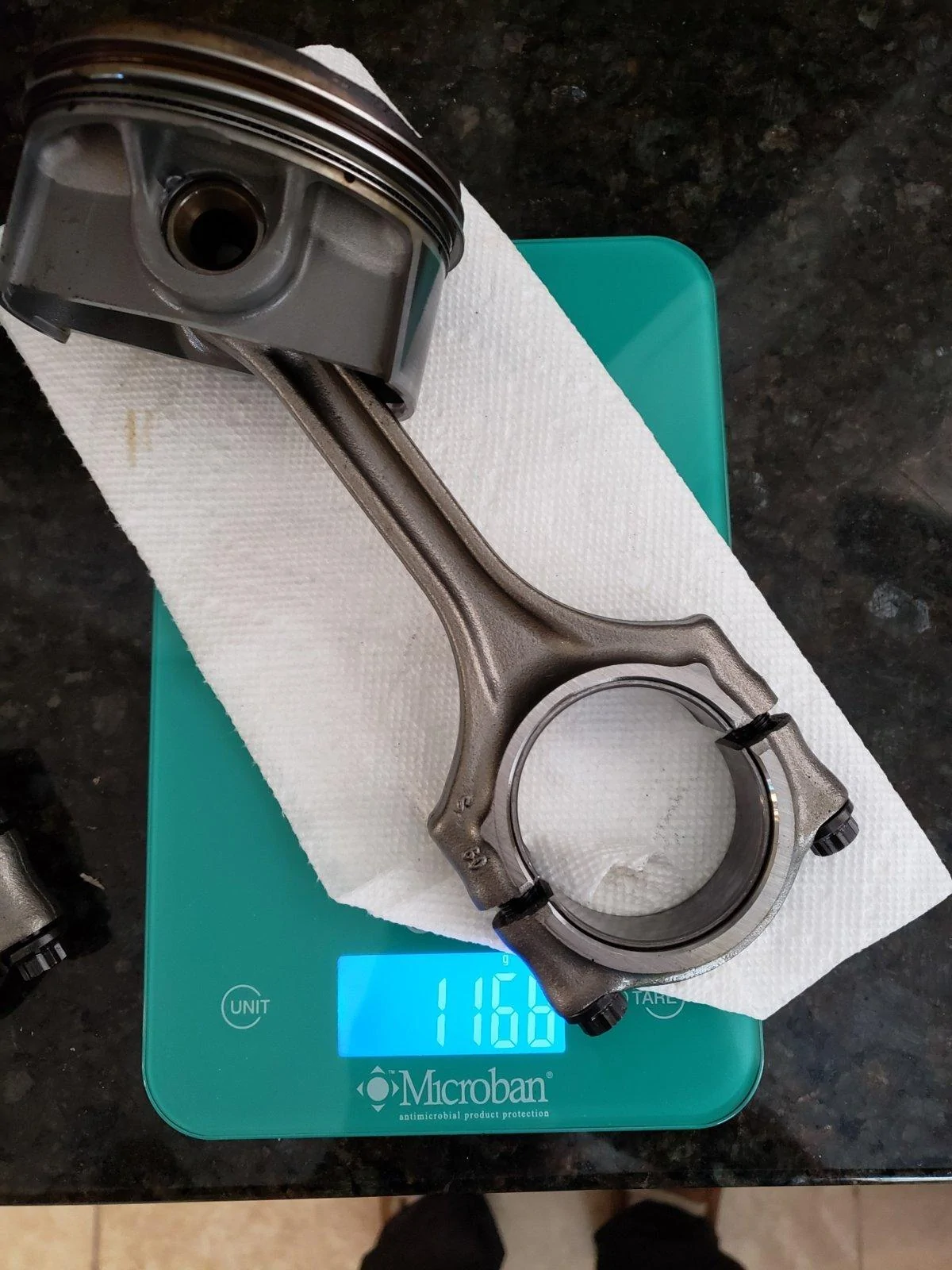

Thanks for all the responses guys. Appreciating the responses and conversations. This morning I realized I should weigh the pistons, pins, rods, bearings, etc. and see how much variation there is from the factory. Interesting results. Over 15 grams of variation.
My measured weights were:
#1 1166
#2 1168
#3 1177
#4 1181
#5 1180
#6 1178
#7 1179
#8 1178
#1 1166
#2 1168
#3 1177
#4 1181
#5 1180
#6 1178
#7 1179
#8 1178
Here's a better way to look at it.... only 1/2 ounce of difference! :) I have some comments on my first set of rods, but I need to run. post more later.
#1 1166
#2 1168
#3 1177
#4 1181
#5 1180
#6 1178
#7 1179
#8 1178
Is the crank ..... drilled? to offset the weight differences? I dont know t
#1 1166
#2 1168
#3 1177
#4 1181
#5 1180
#6 1178
#7 1179
#8 1178
OK, so let's think about these numbers. First, the Voodoo has a flat crank configured UDUD. So, if we look at each journal, we have the following pairings:
First UD journal pair:
UP #1 - #5: 1166 and 1180 for a total of 2346 going up
DN #2 - #6: 1168 and 1178 for a total of 2346 going down
Then the second pair:
UP #3 - #5: 1177 and 1179 for a total of 2356 going up
DN #4 - #8: 1181 and 1178 for a total of 2359 going down
It sounds pretty balanced to me - am I missing something? There's a 10g imbalance pair to pair and one pair is perfect while the second one is 3g off.
