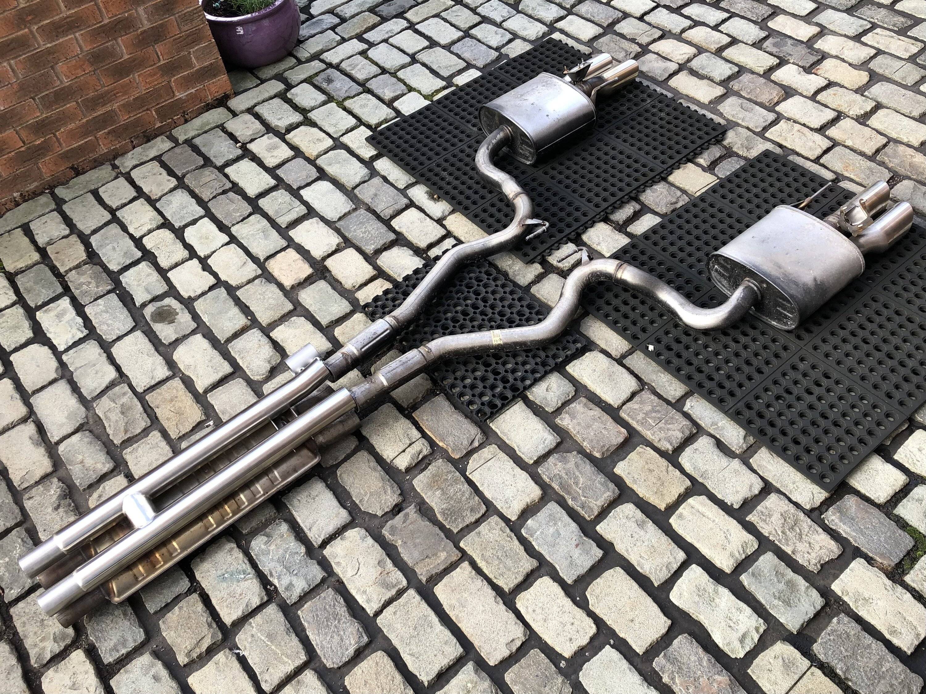

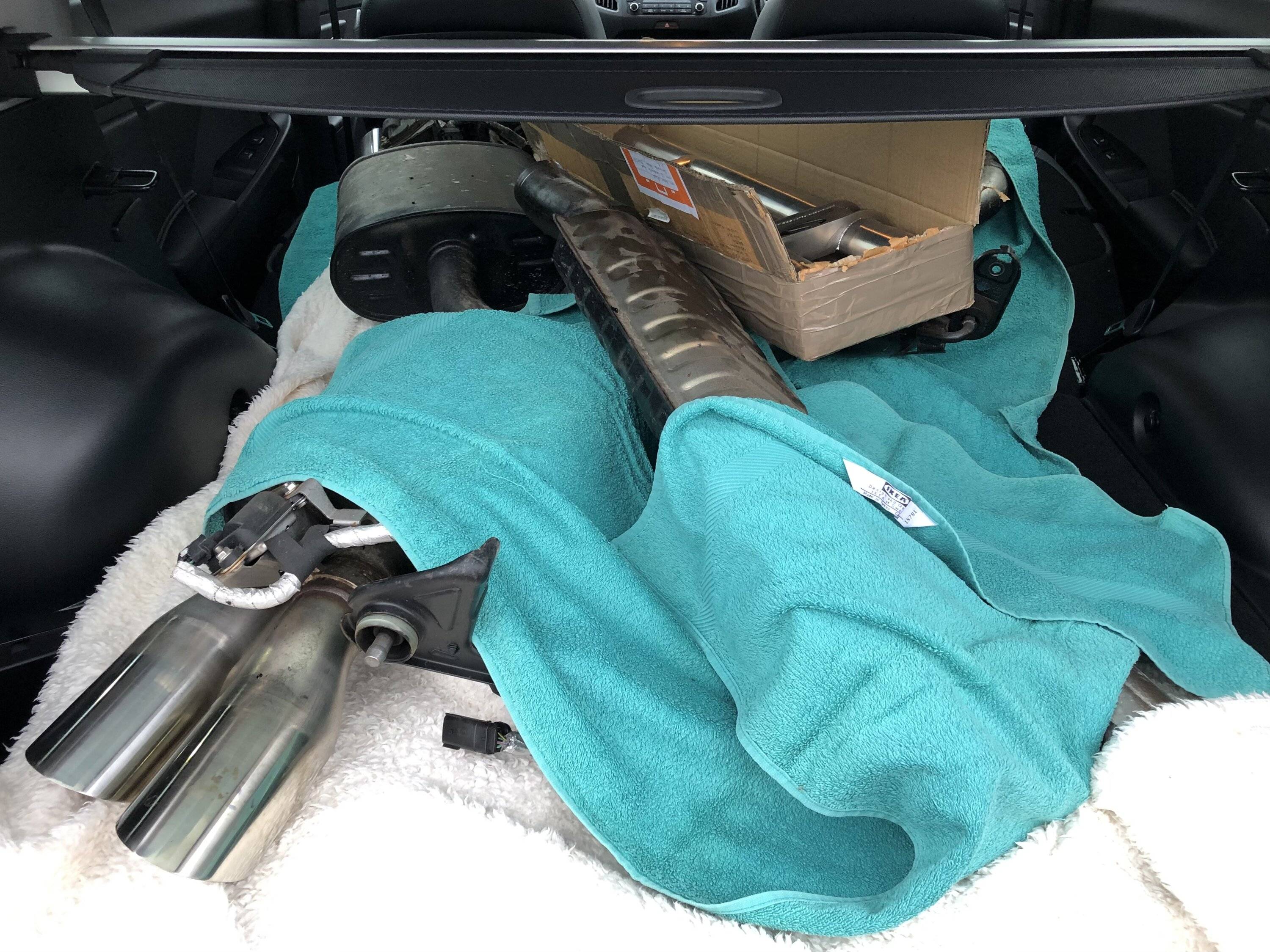

Anyhow, back in the world of mustangs :
Nice one Ford …

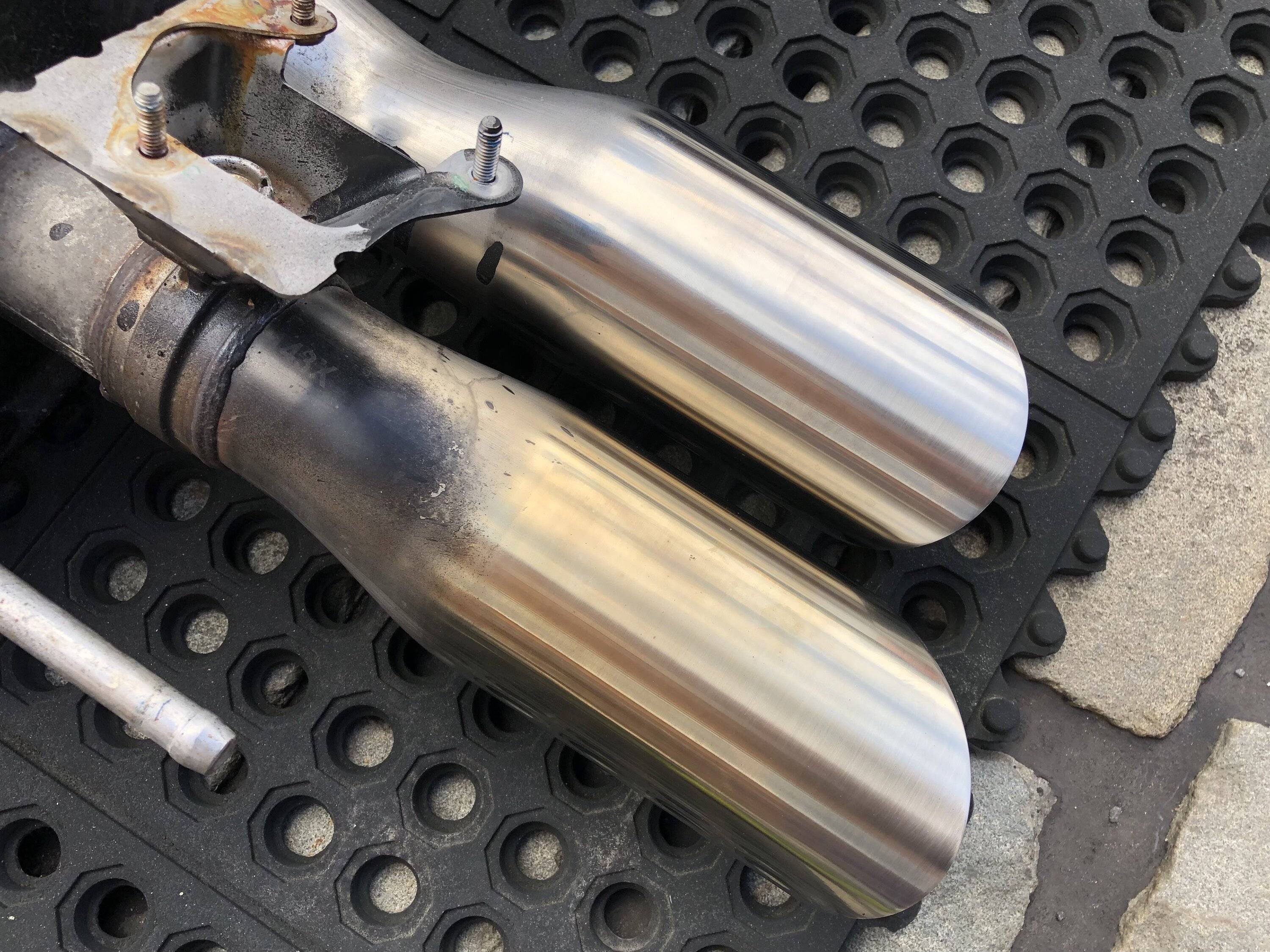

Something about that uneven discolouration says ‘I like track mode’ lol :

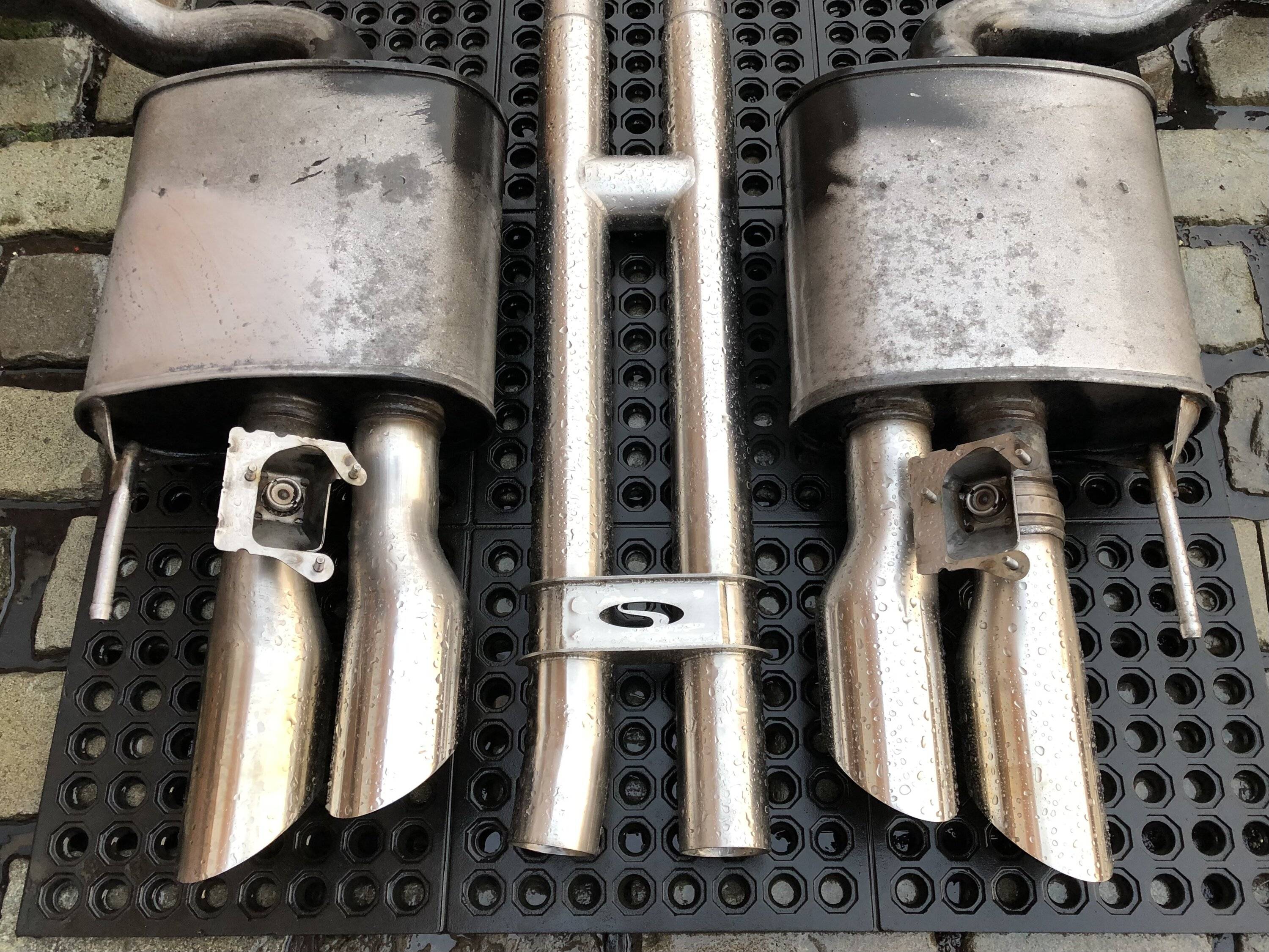

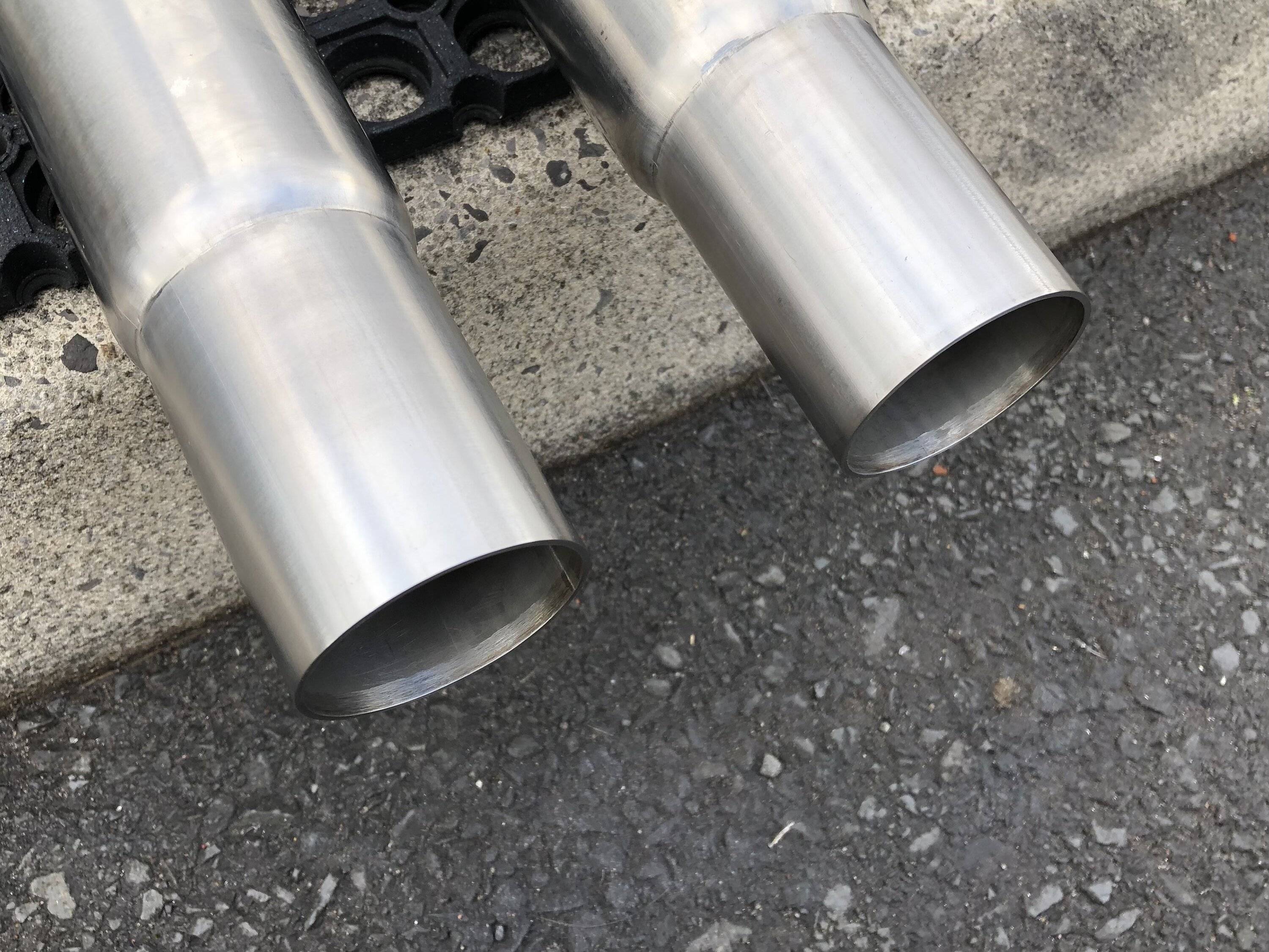

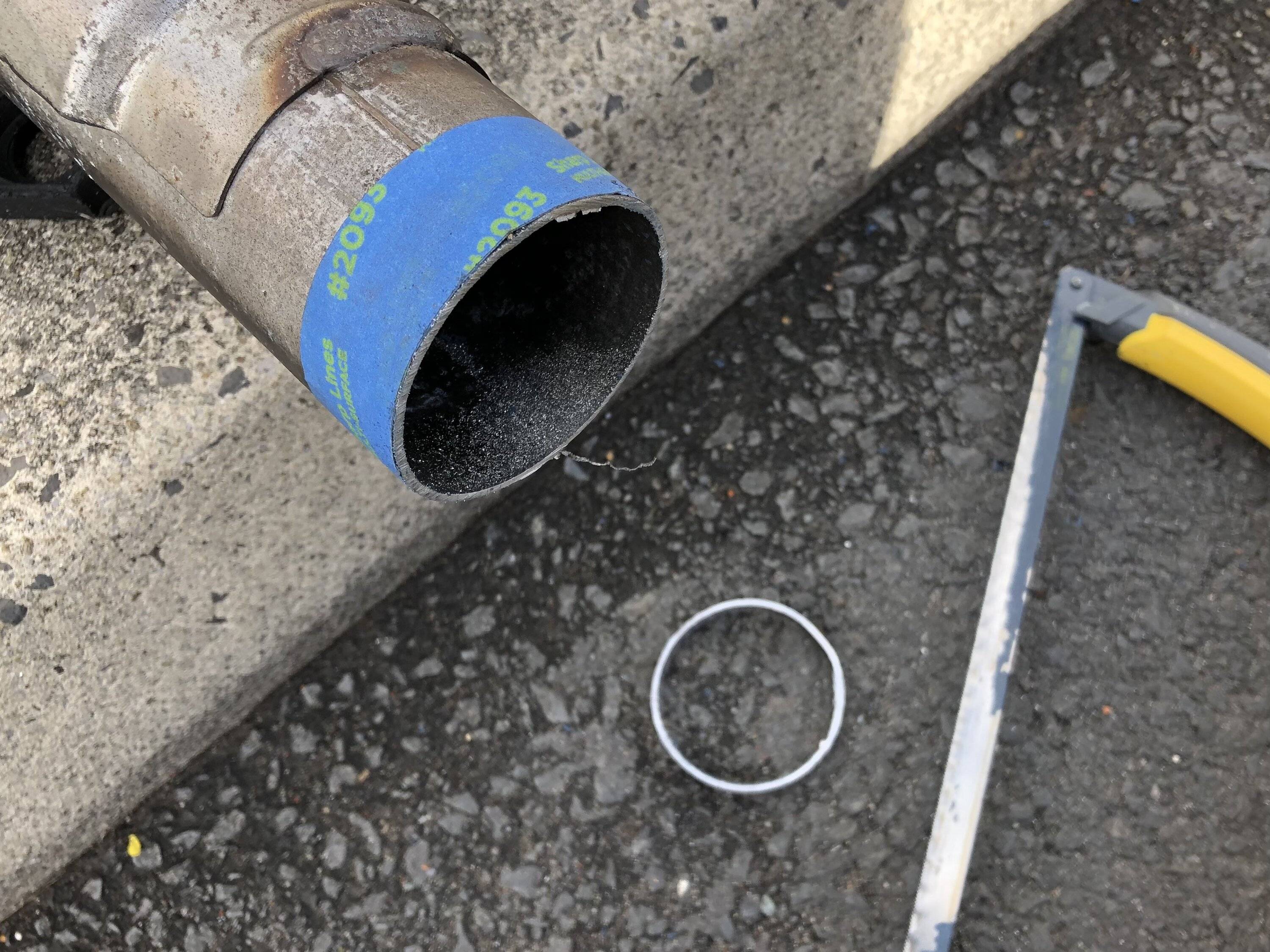

An extra 8mm taken from here :
Quite pleased for a hand cut :

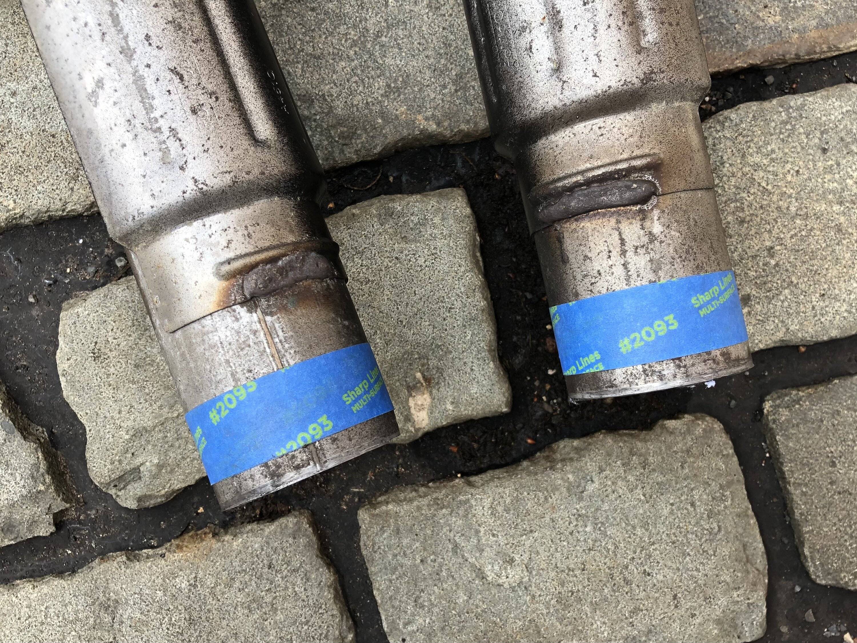

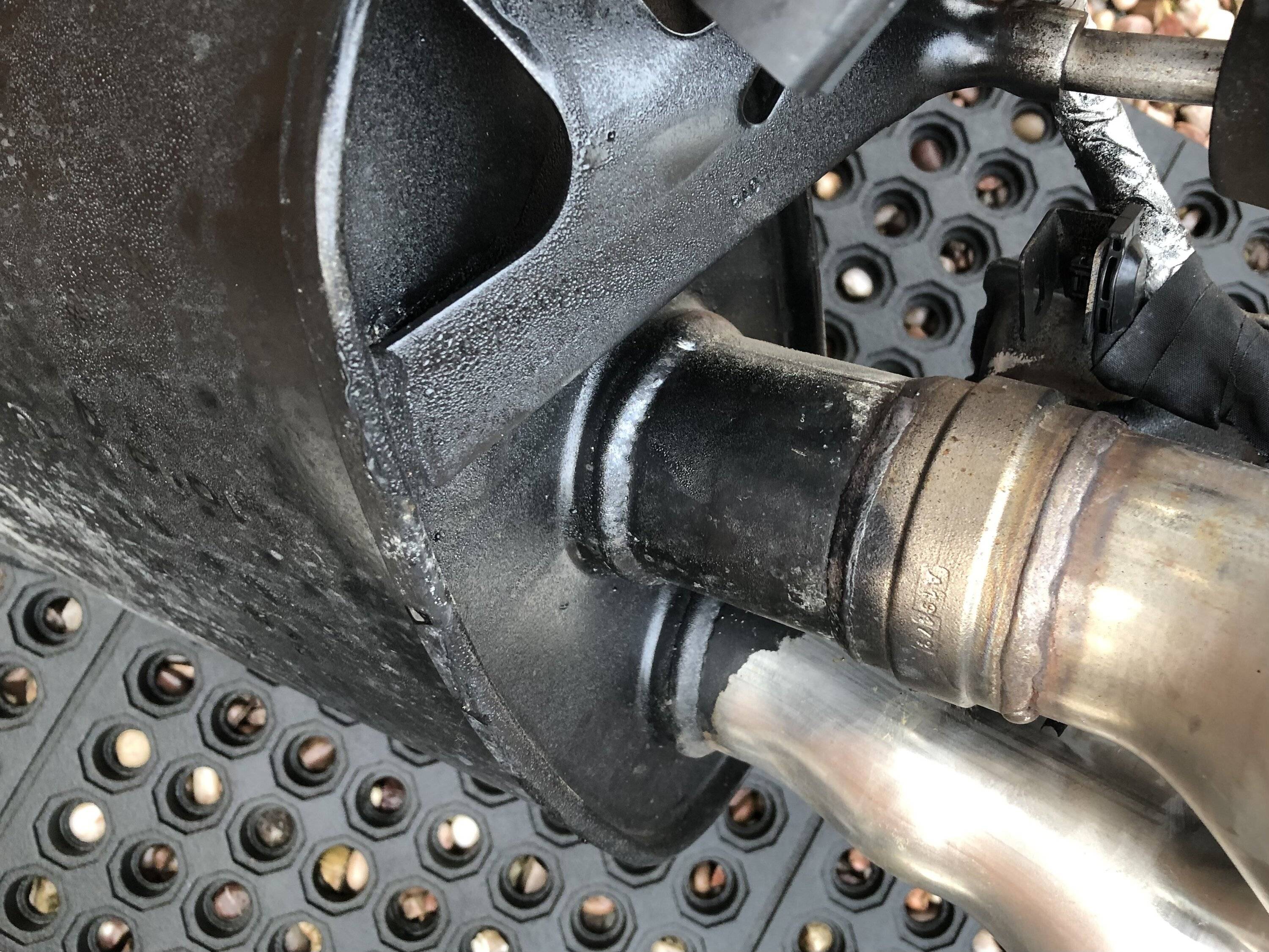

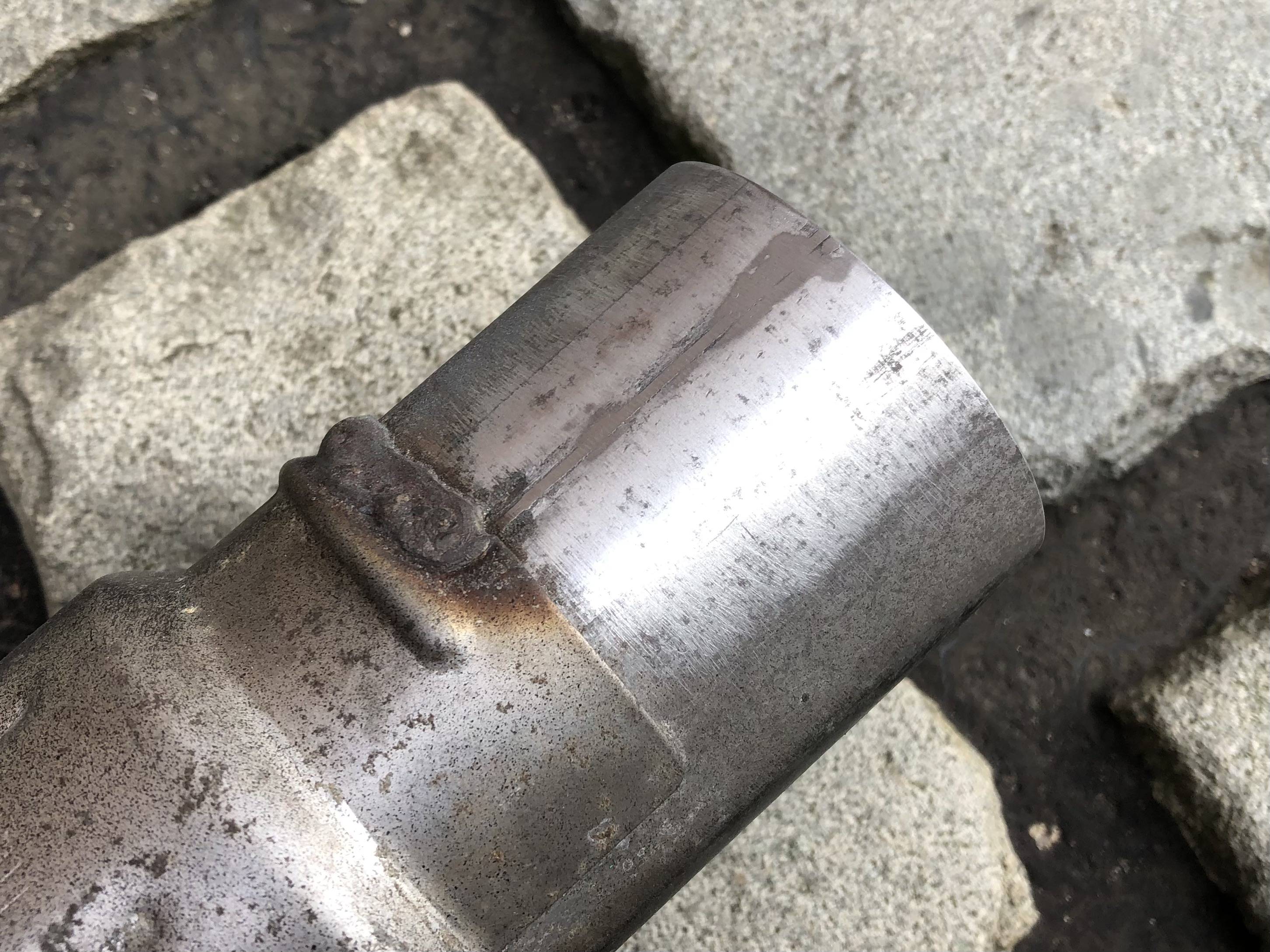

The seams were very proud on my exhaust, I guess that’s not good for the sleeve clamps :

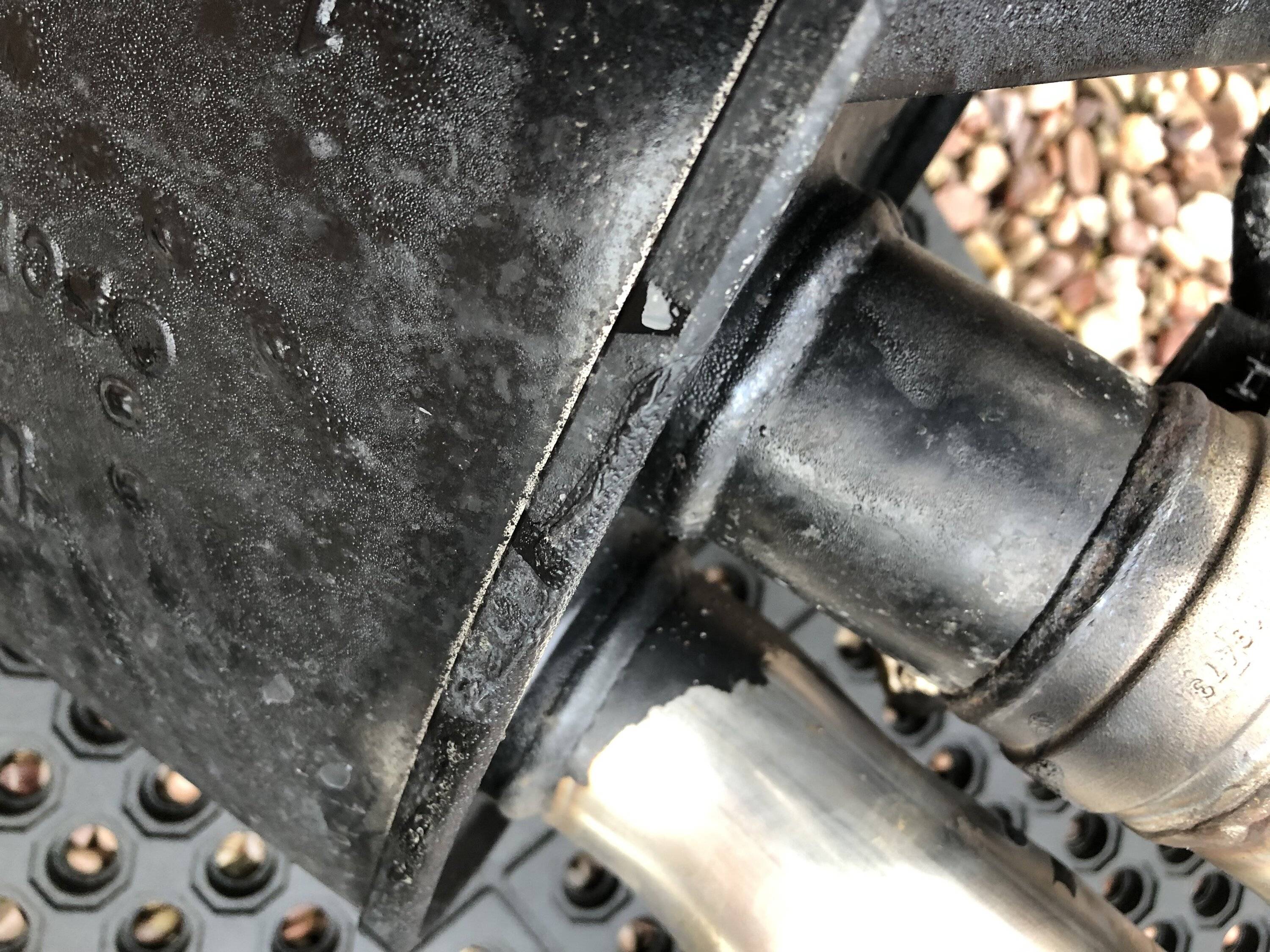

Another 8mm off the front of the H pipe :
That should be enough to keep the exhaust loom off the frame rail

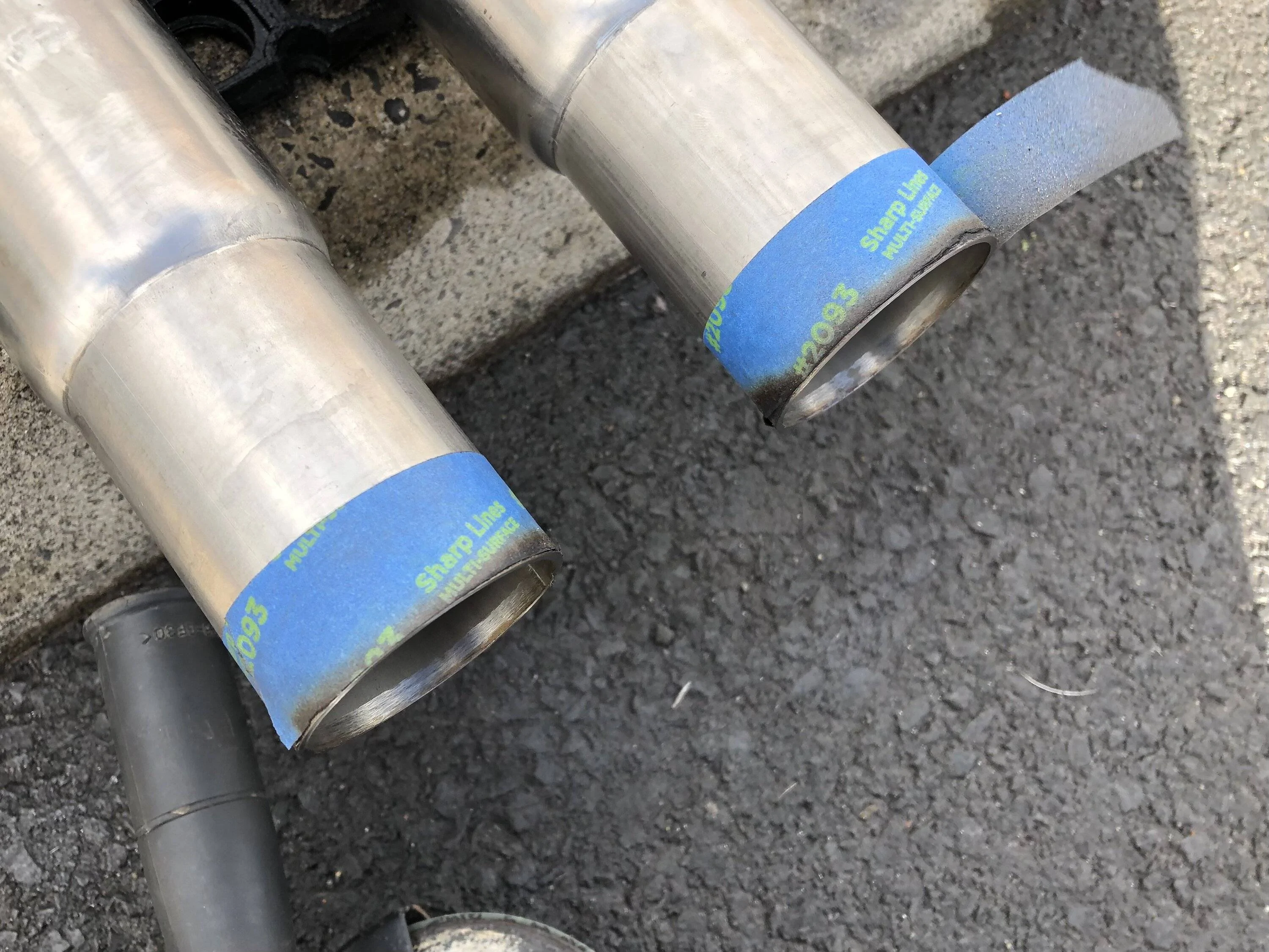

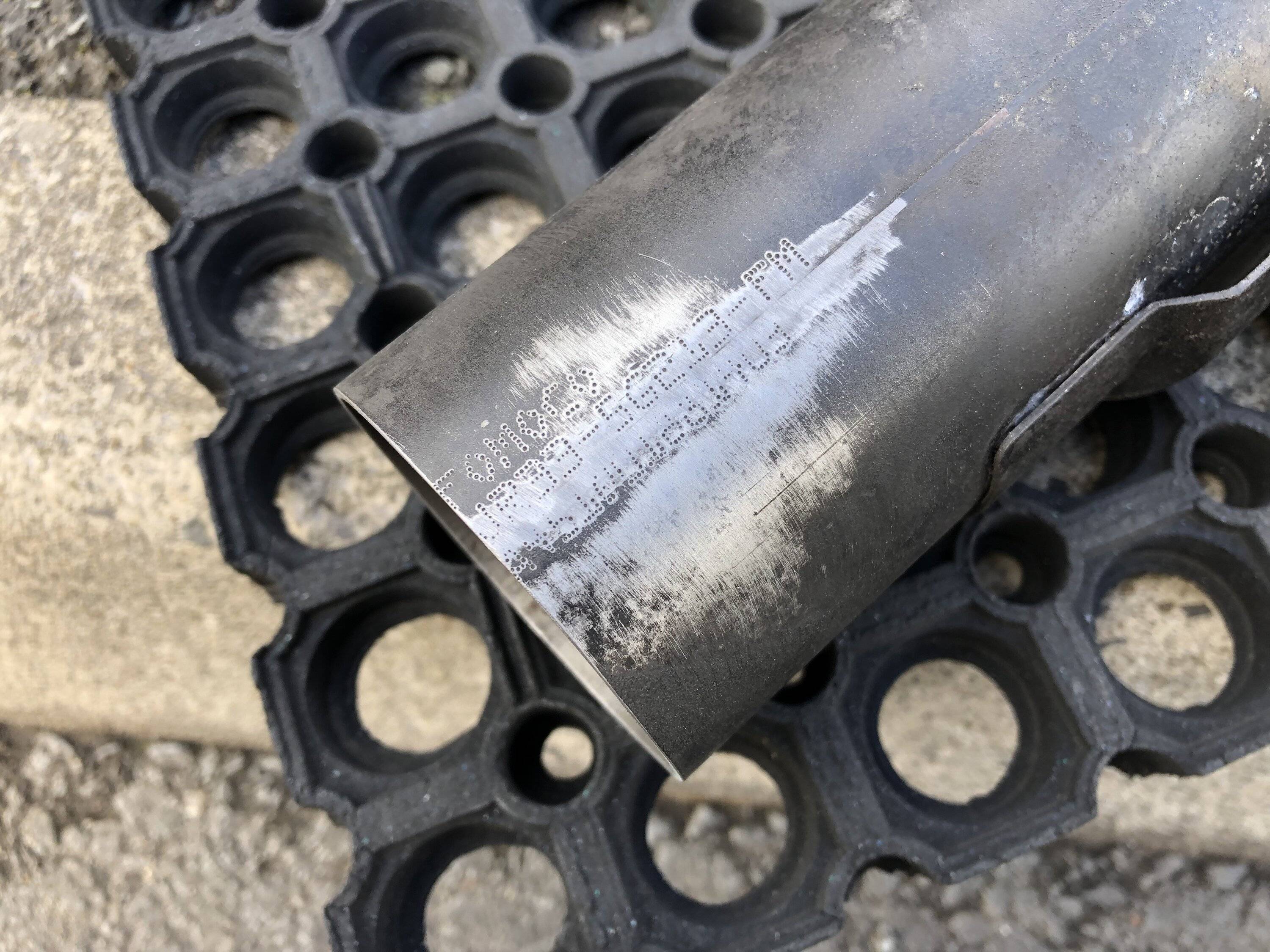

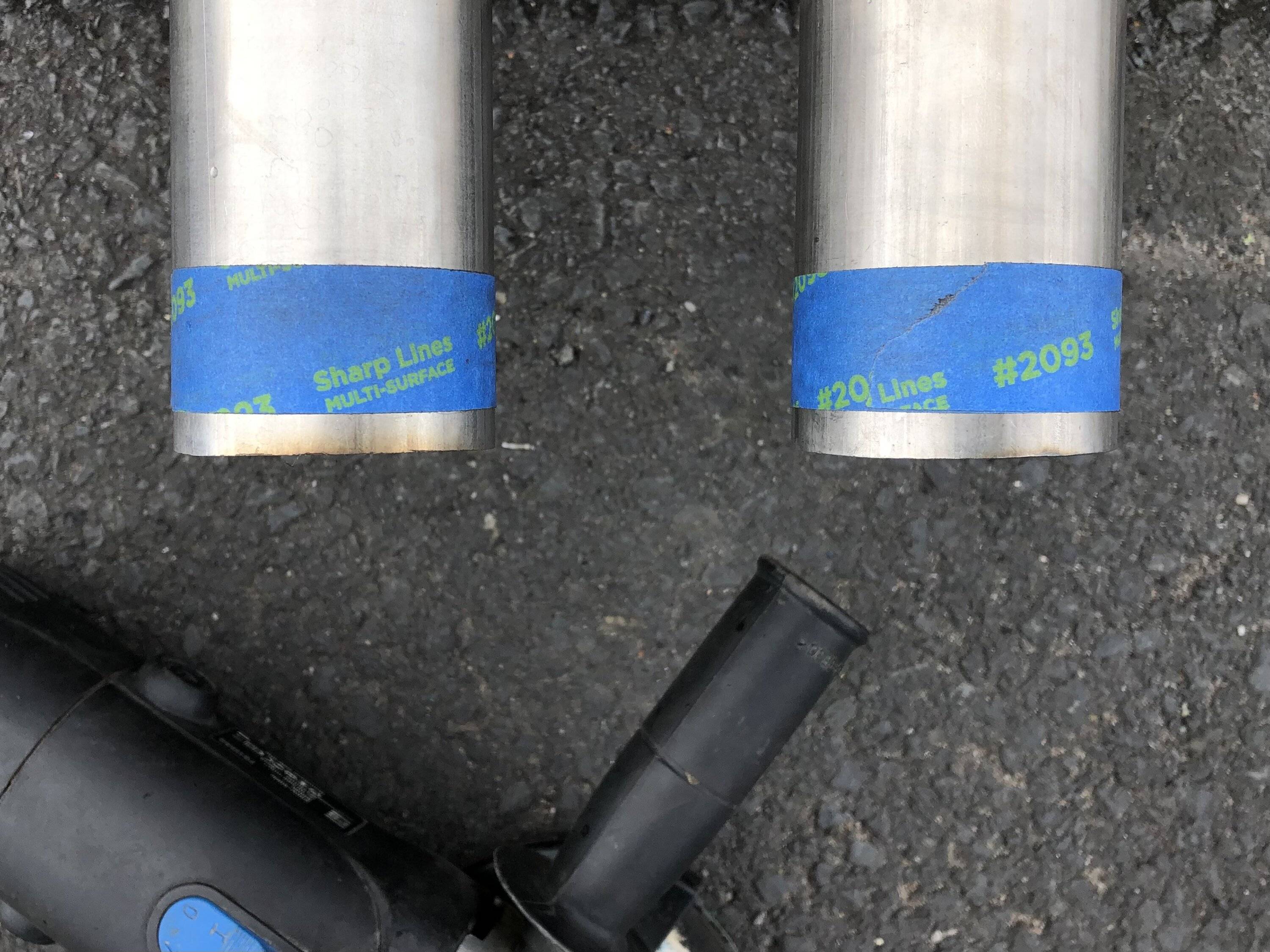

Lots of thinners (and time) later, things are starting to look a little better :

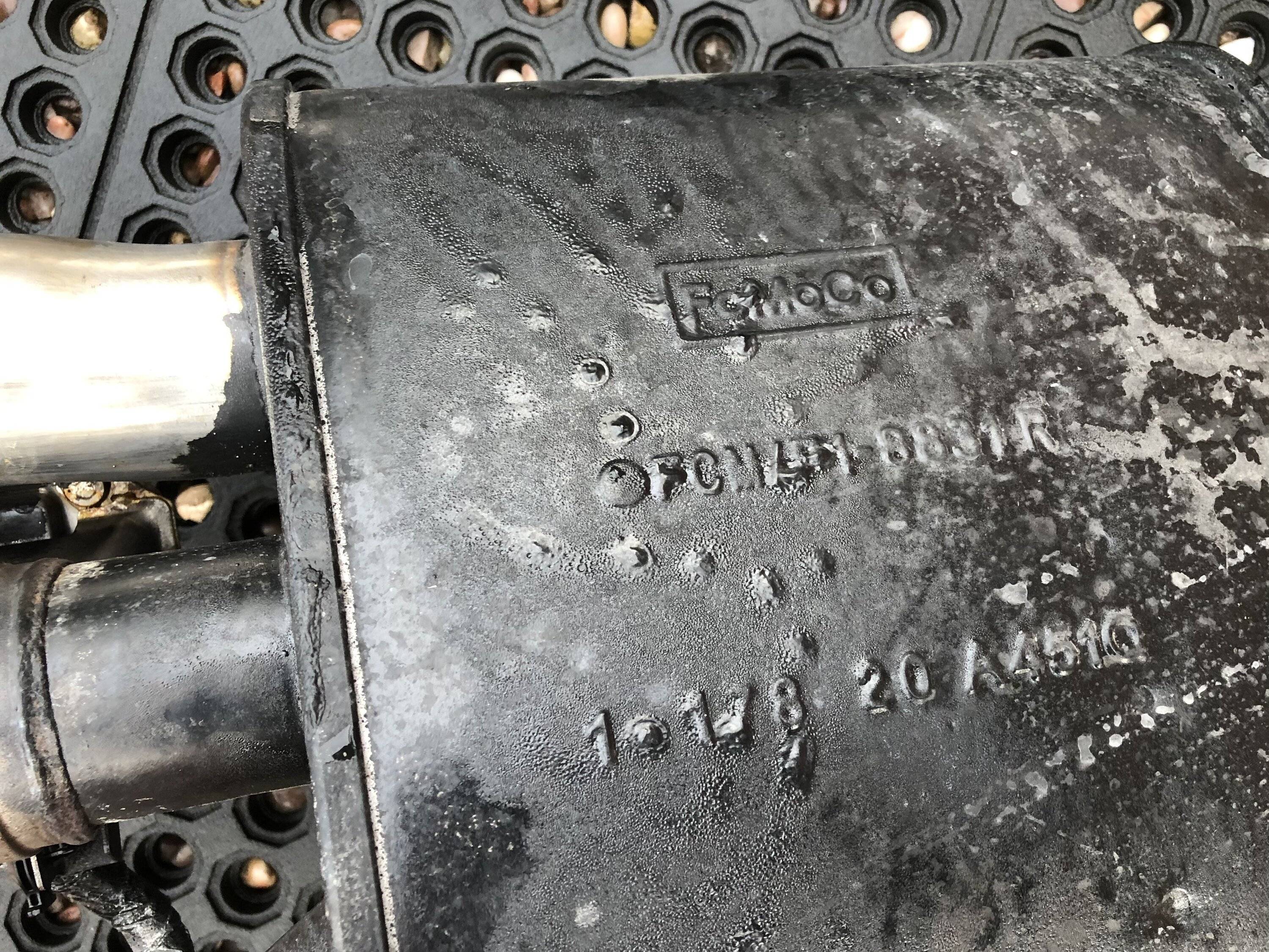

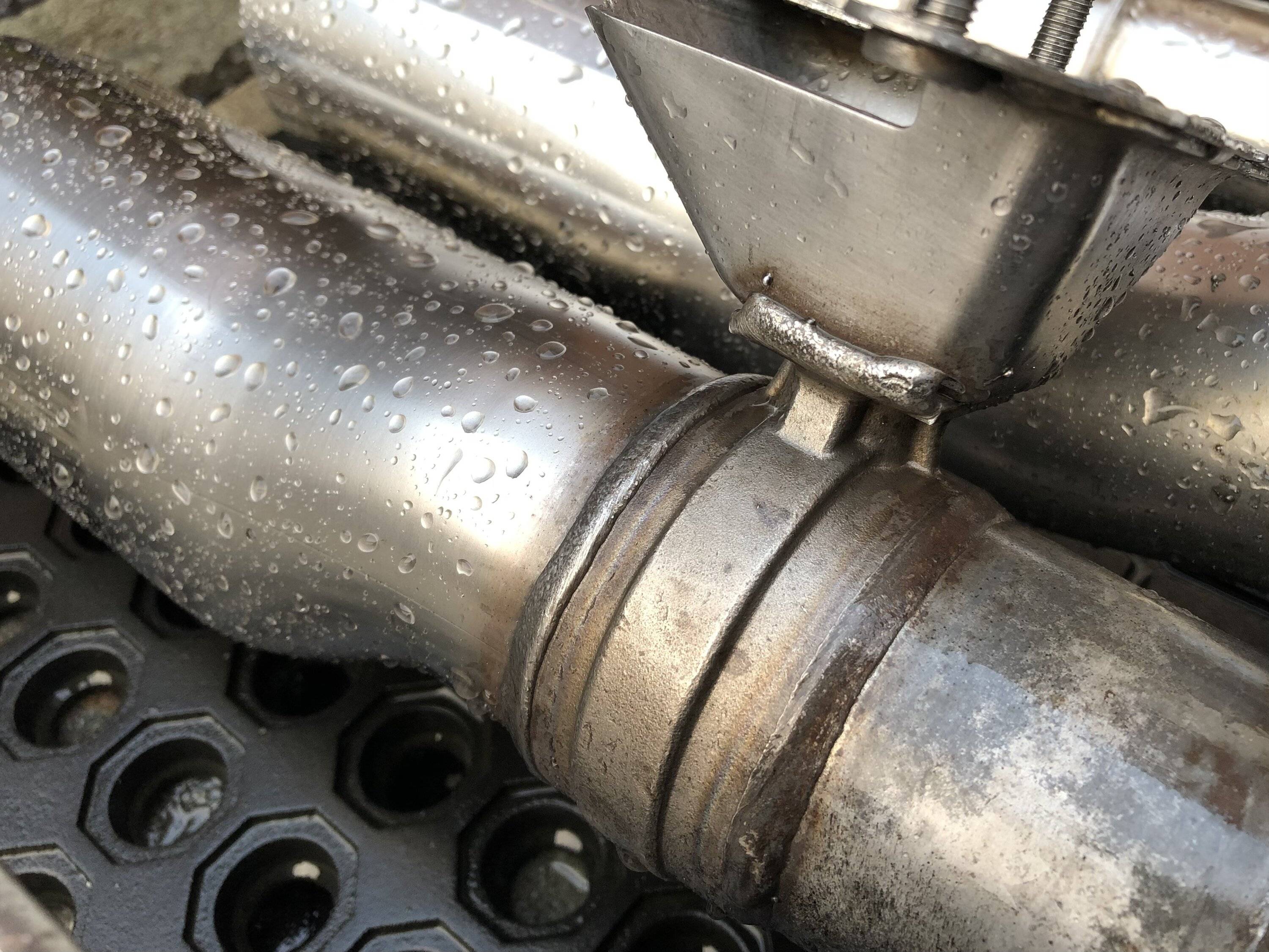

Tried a little bit of glass bead blasting on the centre resonator - I think the tailpipes will get masked off and the rest of the system will get blasted
