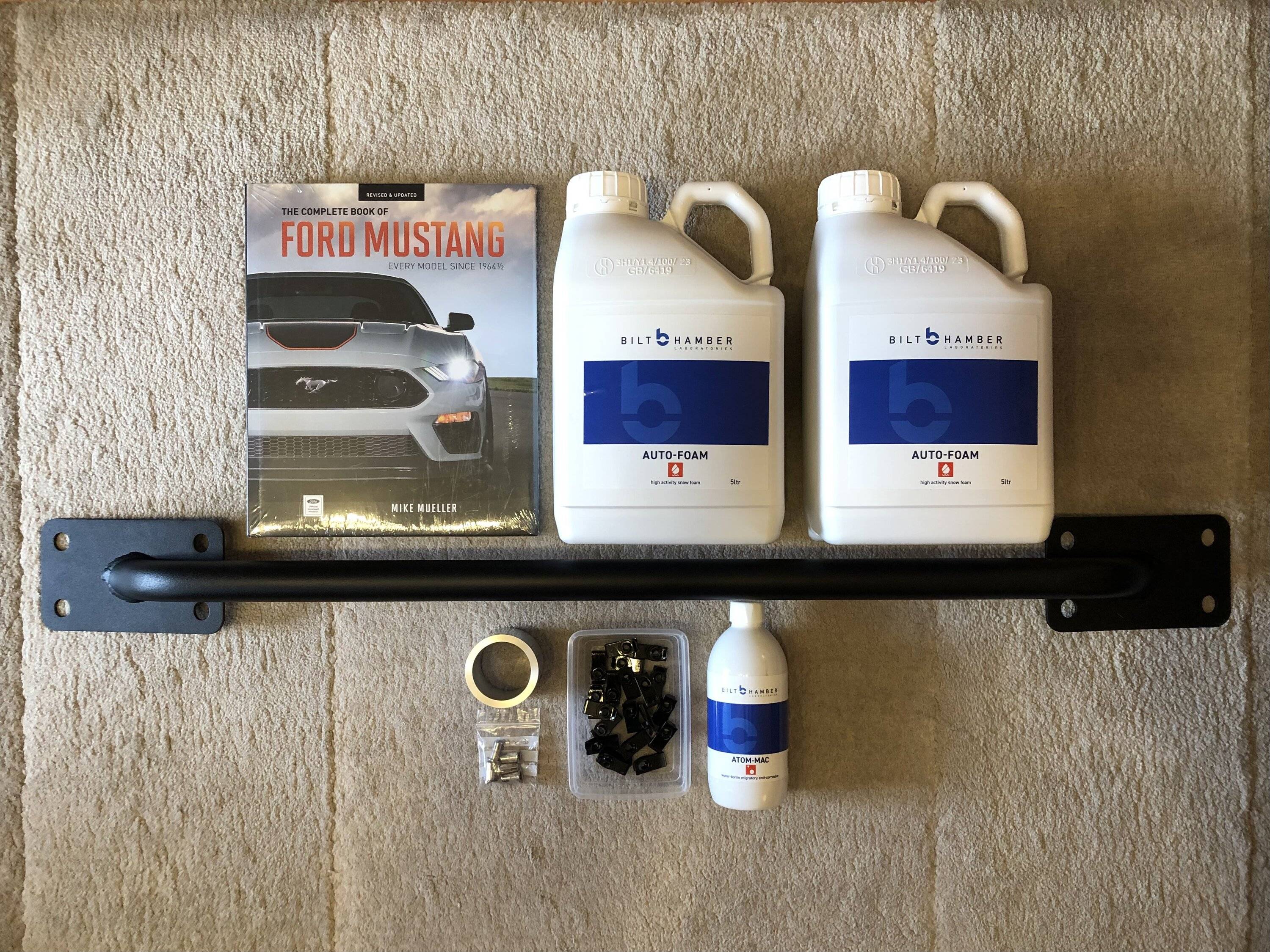

The next piece of the long term front end project is done :like:
As supplied by Santa (with my other car related Christmas presents) :
I wanted this piece as in order of priority :
  • My front crash bar is corroding which is A) visible through the grill on the 2018 facelift and B) is highlighted by the light paint colour.
  • Remove a bit of color / add a bit of blackness behind the grill.
  • Save a little weight.

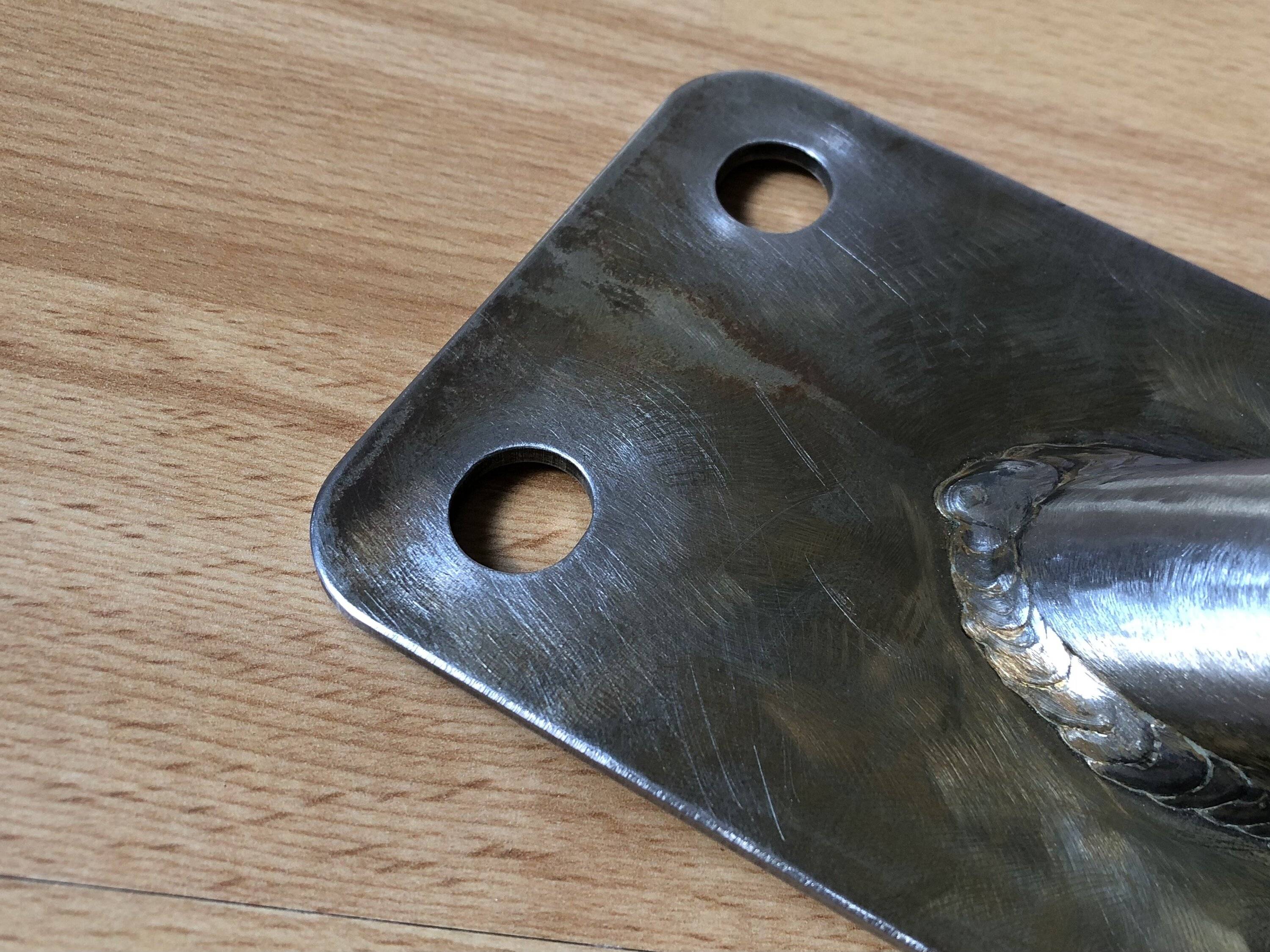

The textured powder coat on this item was actually pretty good (way better than the grey on the IRS braces and the black on the front 2 point brace), but it was being stripped anyway as I didn't want to simply cable tie the front wiring loom onto it.

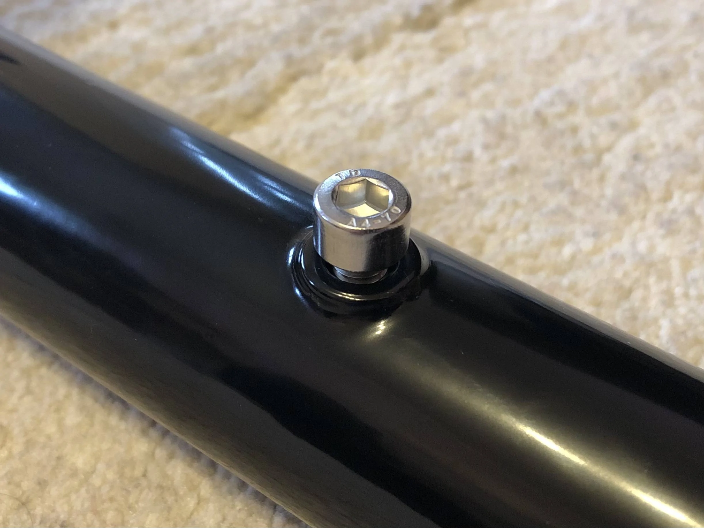

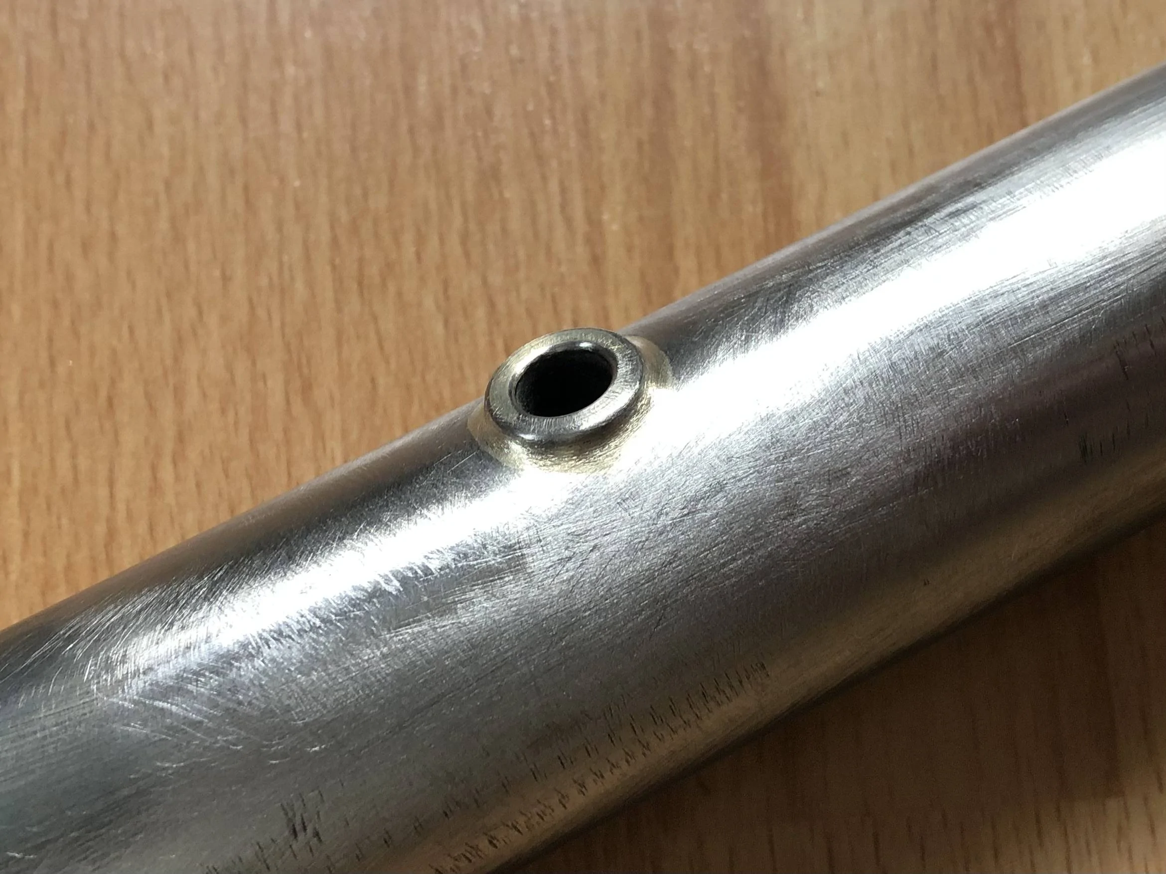

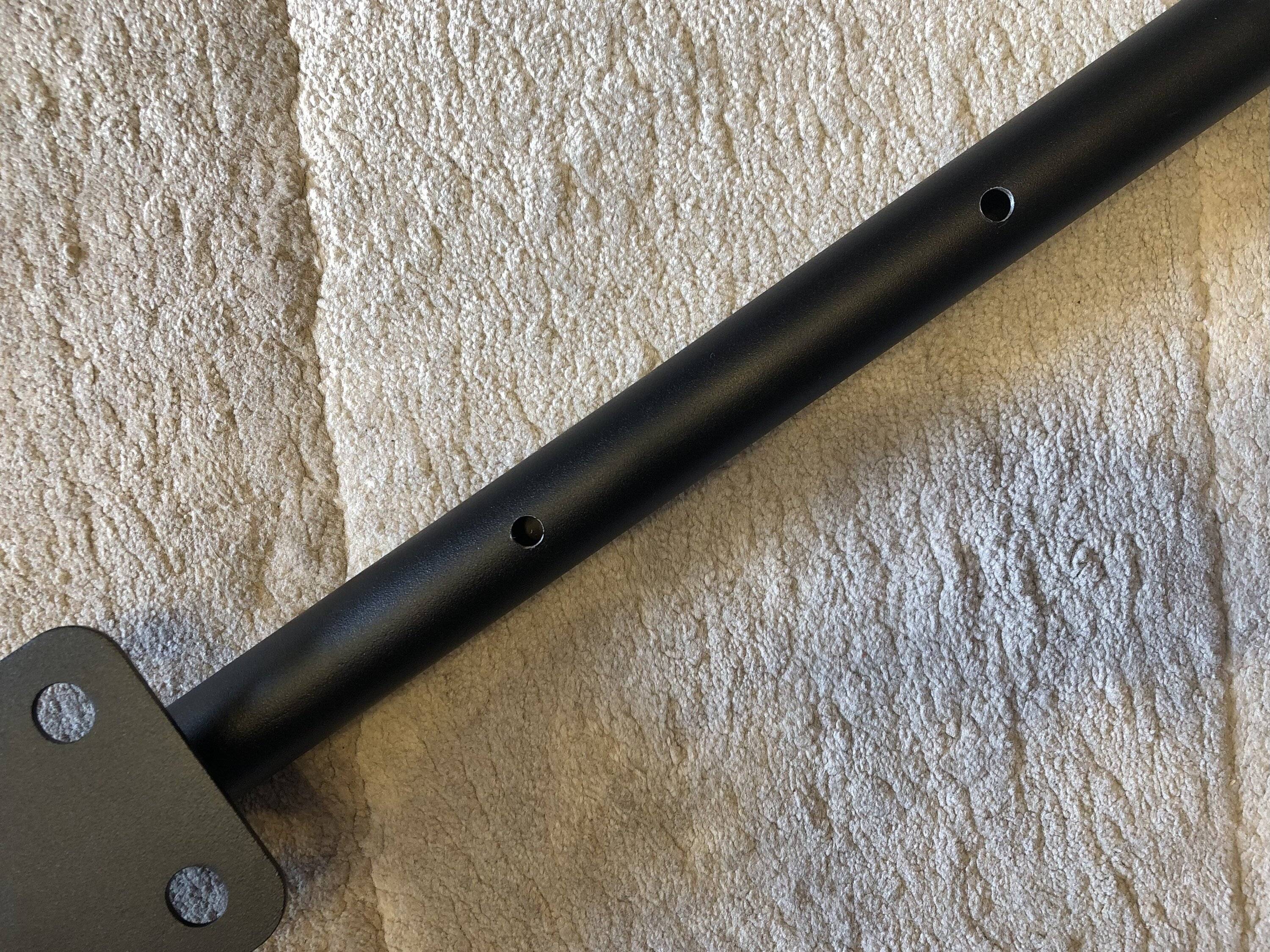

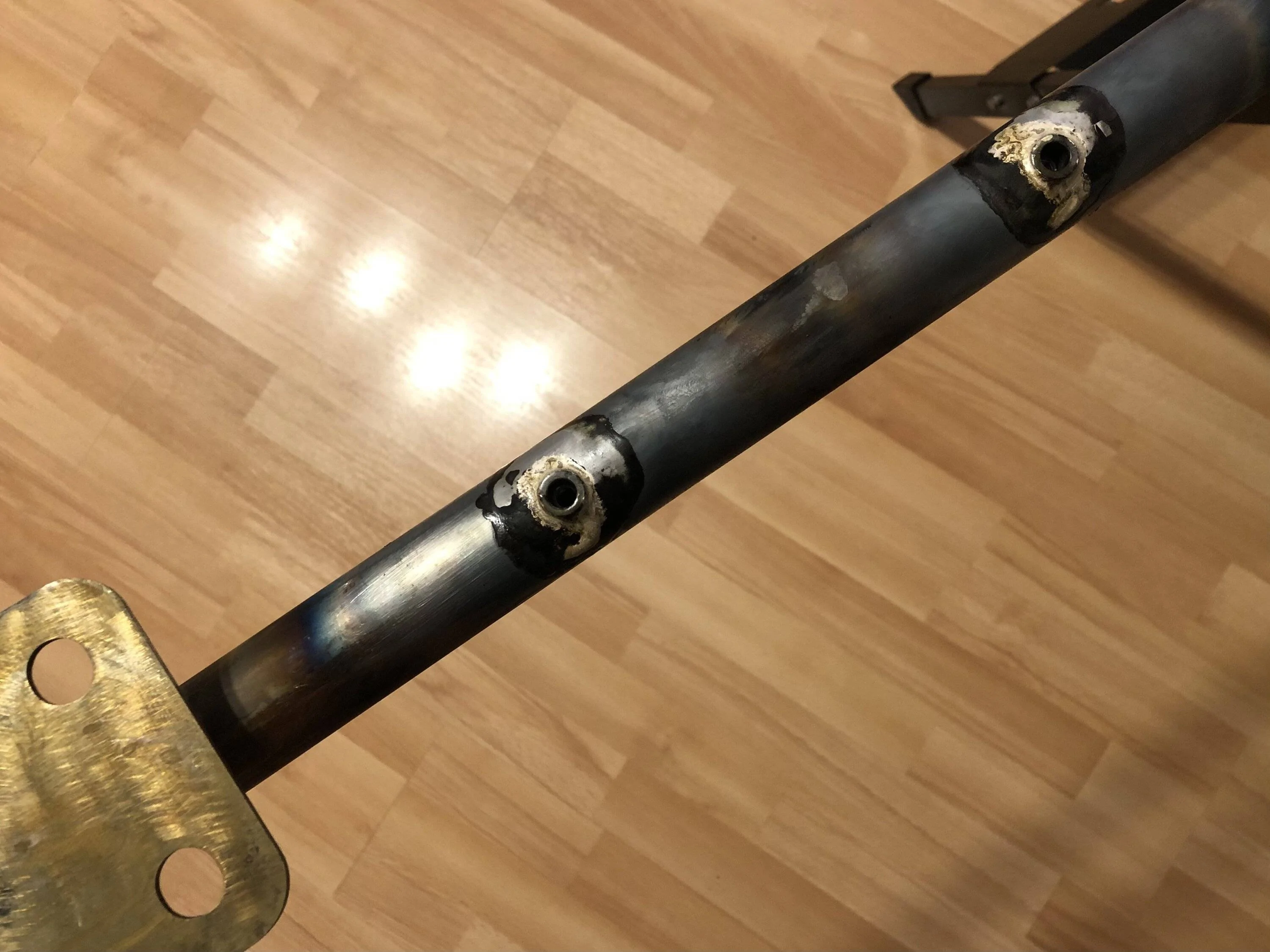

The front loom secures to the standard crash bar with four clips, so I used that spacing and drilled some holes (assisted by my eldest daughter) :

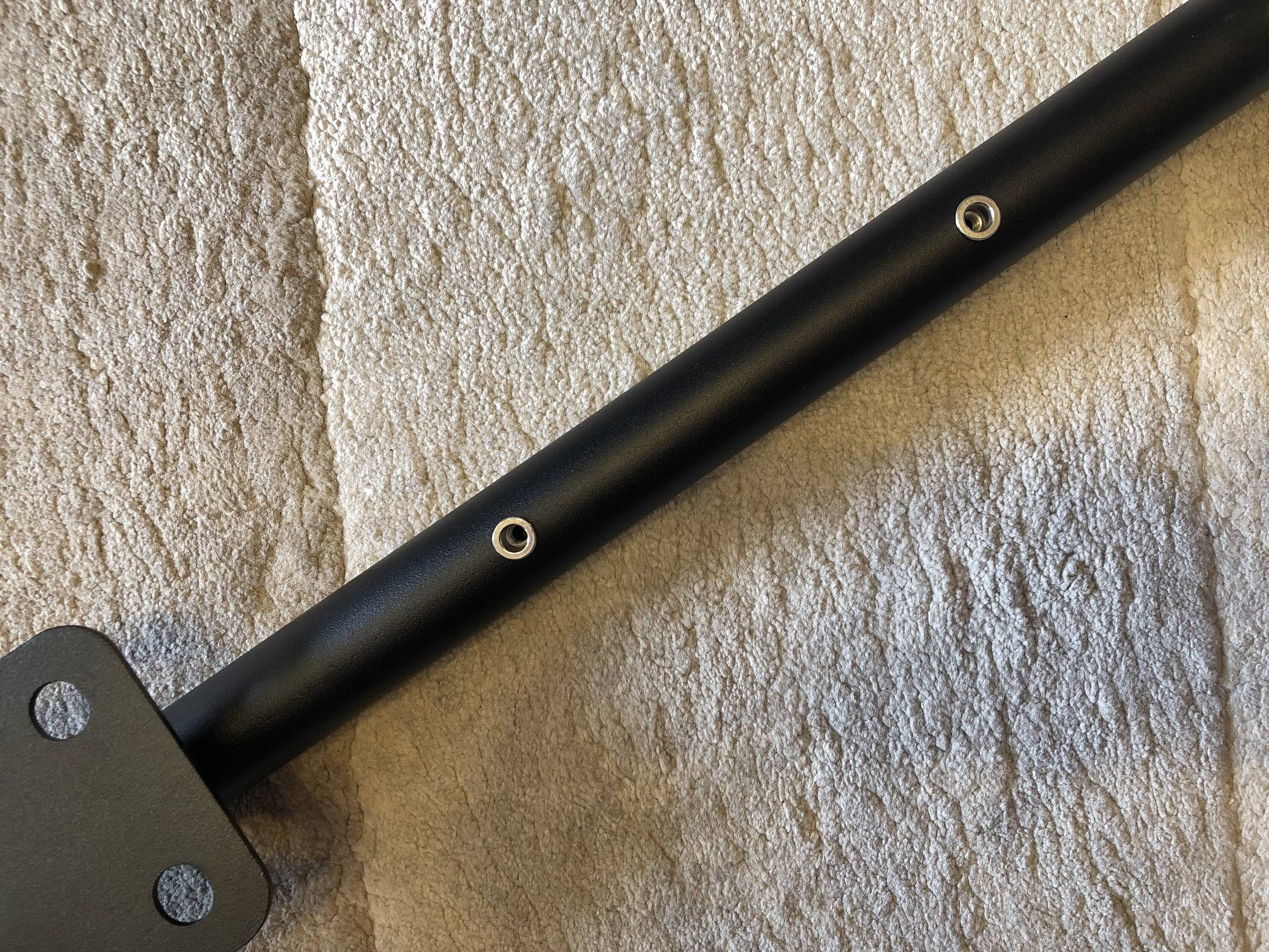

The holes will have stainless threaded inserts added :

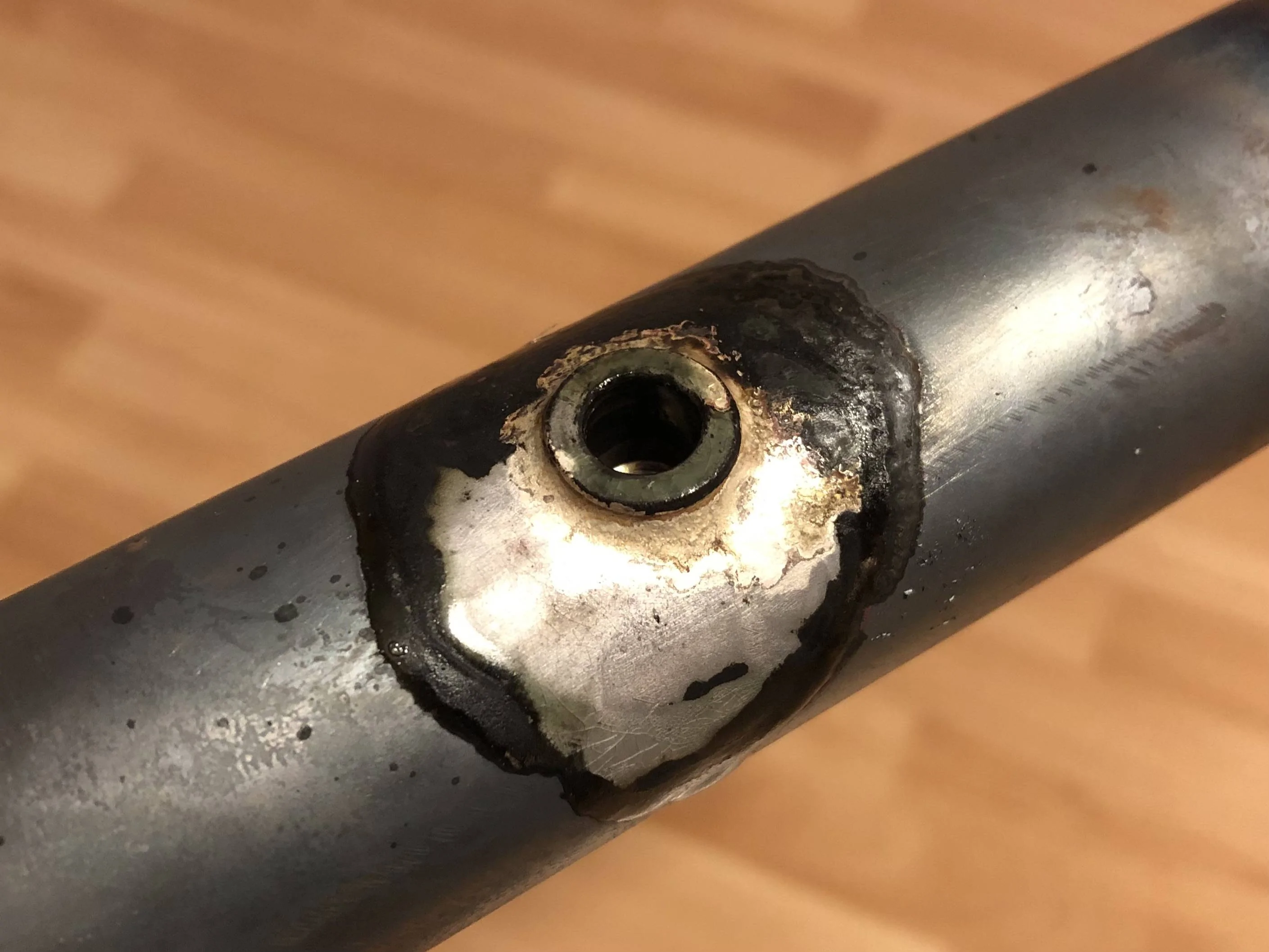

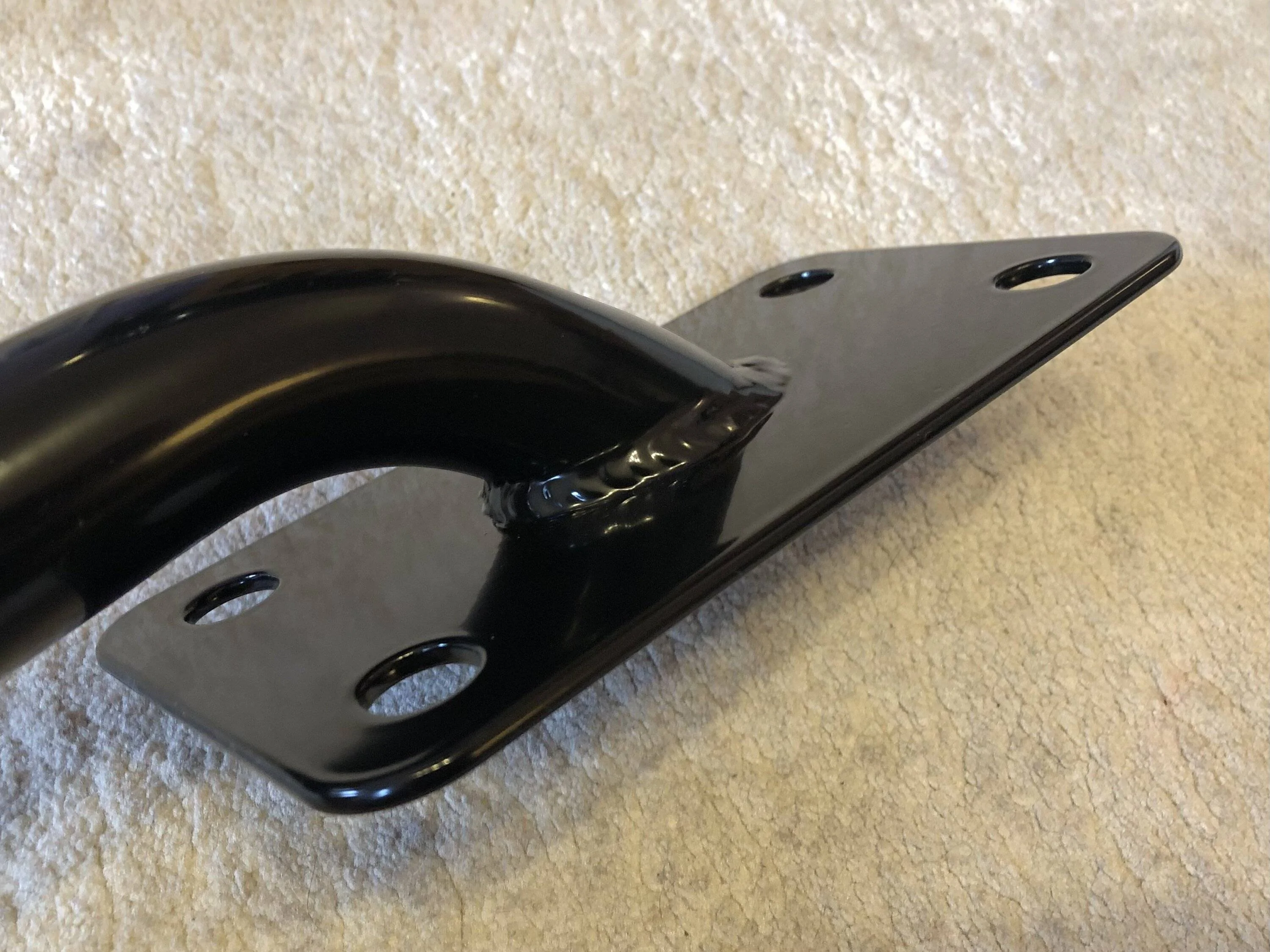

It then went off for fresh powder, but I interrupted the process after the acid bath so we (with my daughter assisting) could do some brazing :
After dressing up the braze :

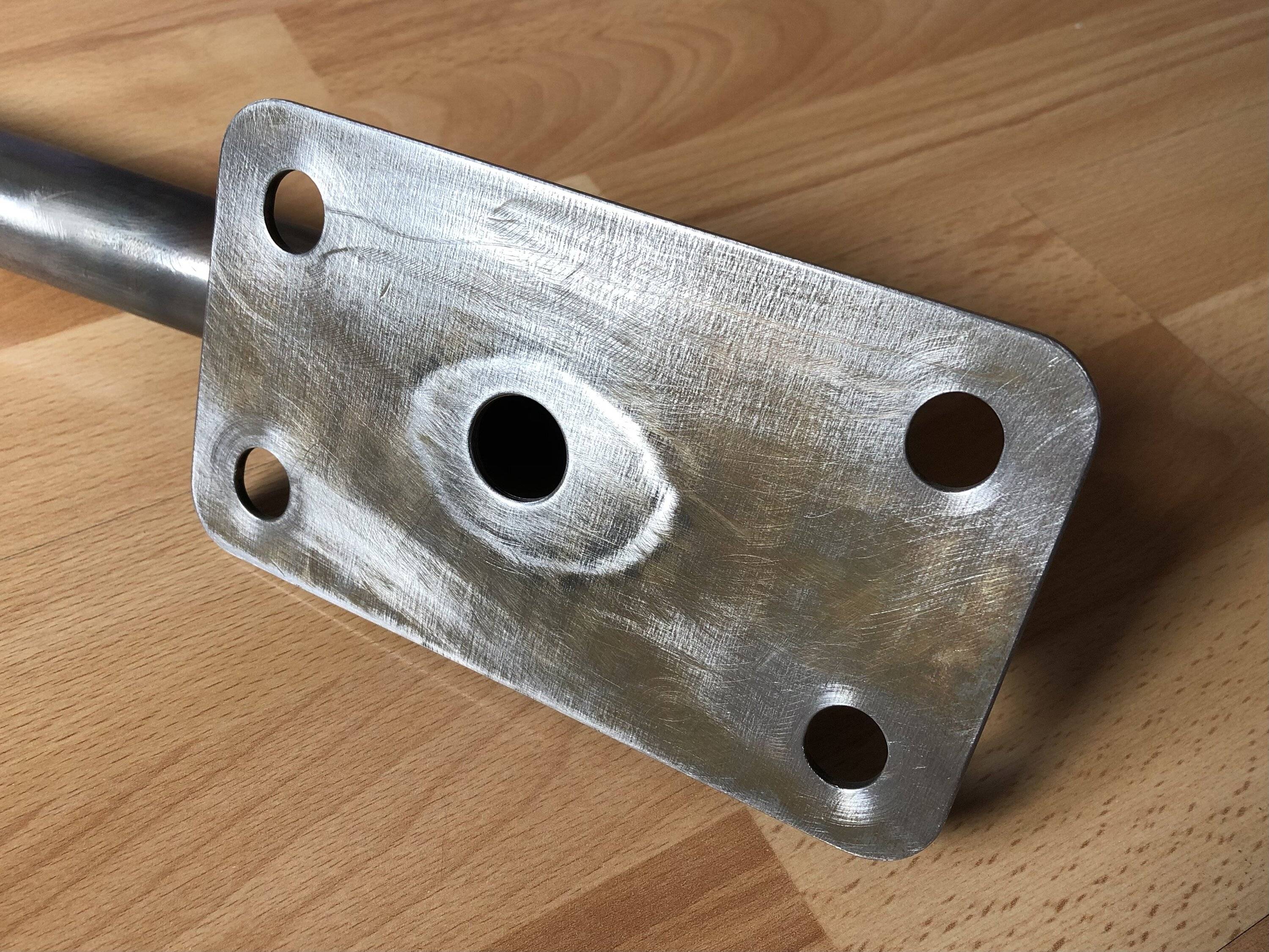

Smoothing all the sharp edges (to help the new powder flow and avoid thin edges) :
We also drilled a 20mm hole in the back to get debris out of it, so it can be hung from the hole for processing, and so I can easily shoot some cavity wax in there before fitting :
I'm not sure yet if I should let the hole vent (it's protected once fitted) or if I should plug it after adding the wax ?

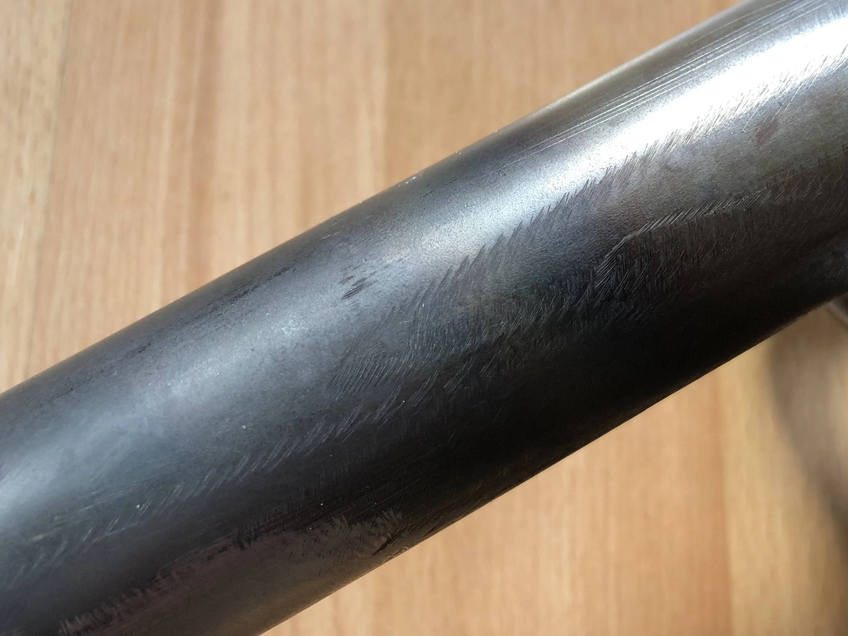

Ref my comment above about this being the best powder coat I have had on any of my Steeda's parts - well it's still a little lacking a little with regards to surface prep ...
There is just the occasional track mark from where the grinder / sander has been run up and down it :

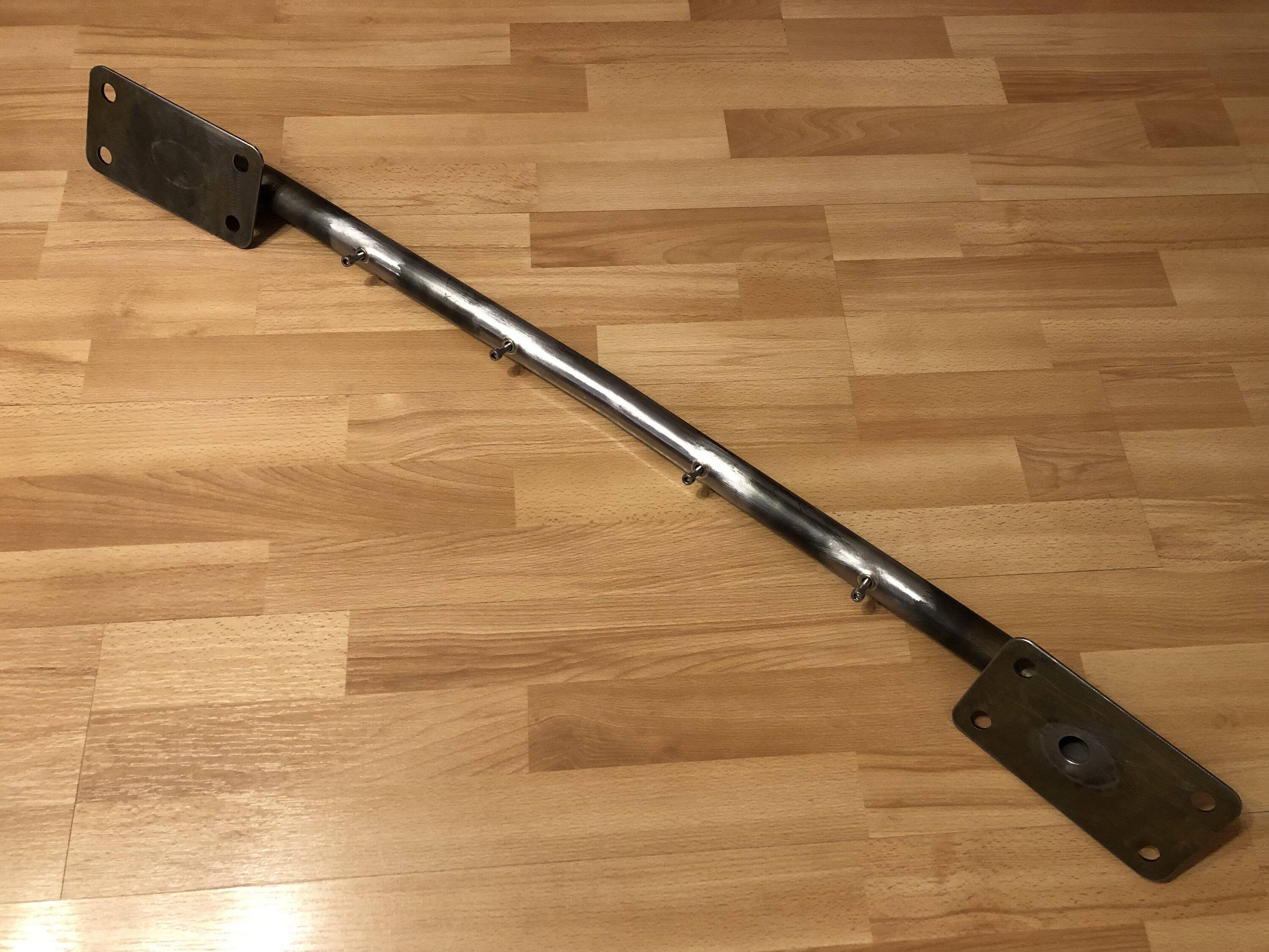

Ready for aqua blasting and coating :
Back from the powdercoaters :

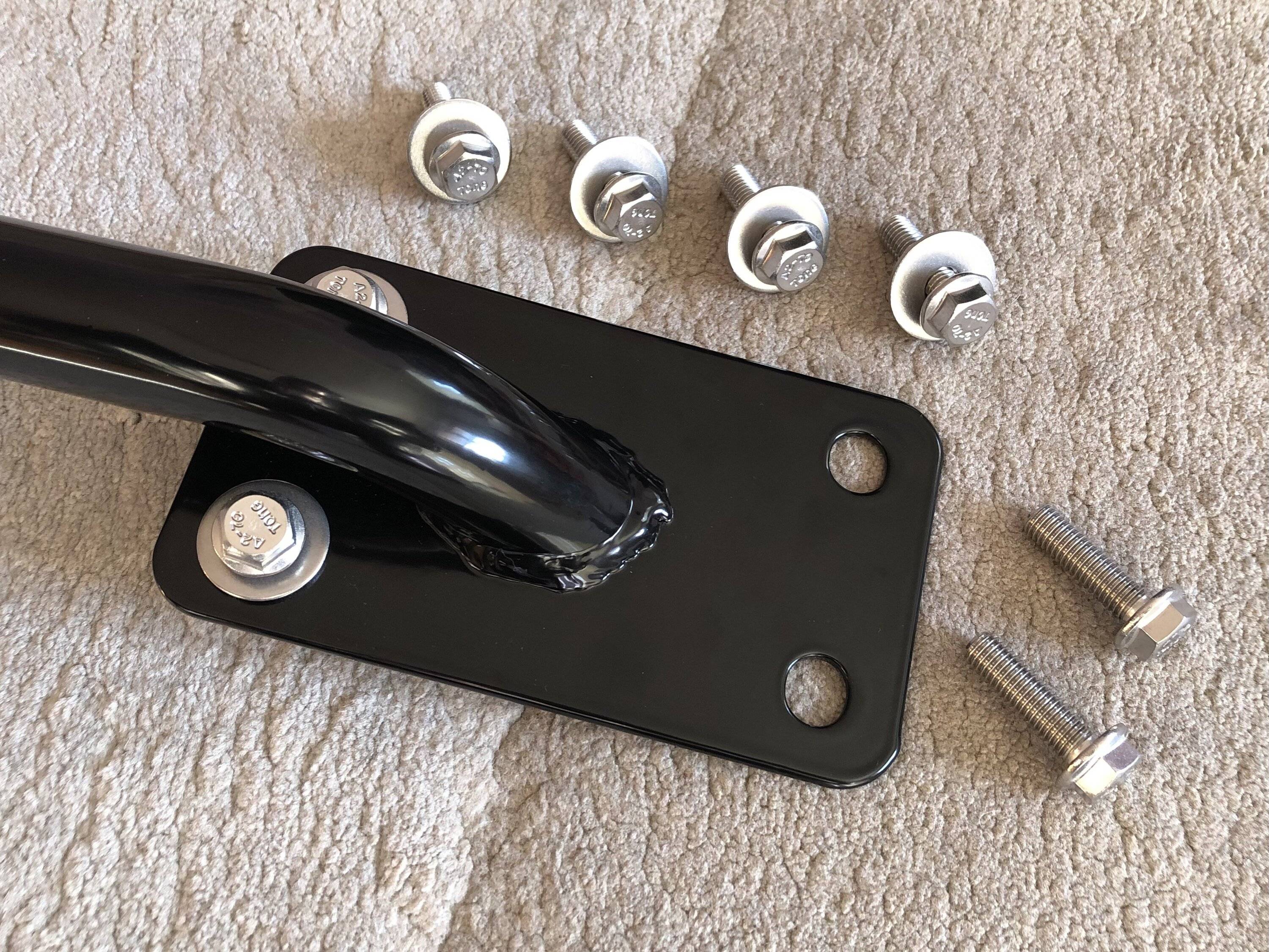

As it will be fitted, with stainless hardware (left over from the rear diff cover) - loom dimension / P clip size courtesy of @Biggsy :like: :

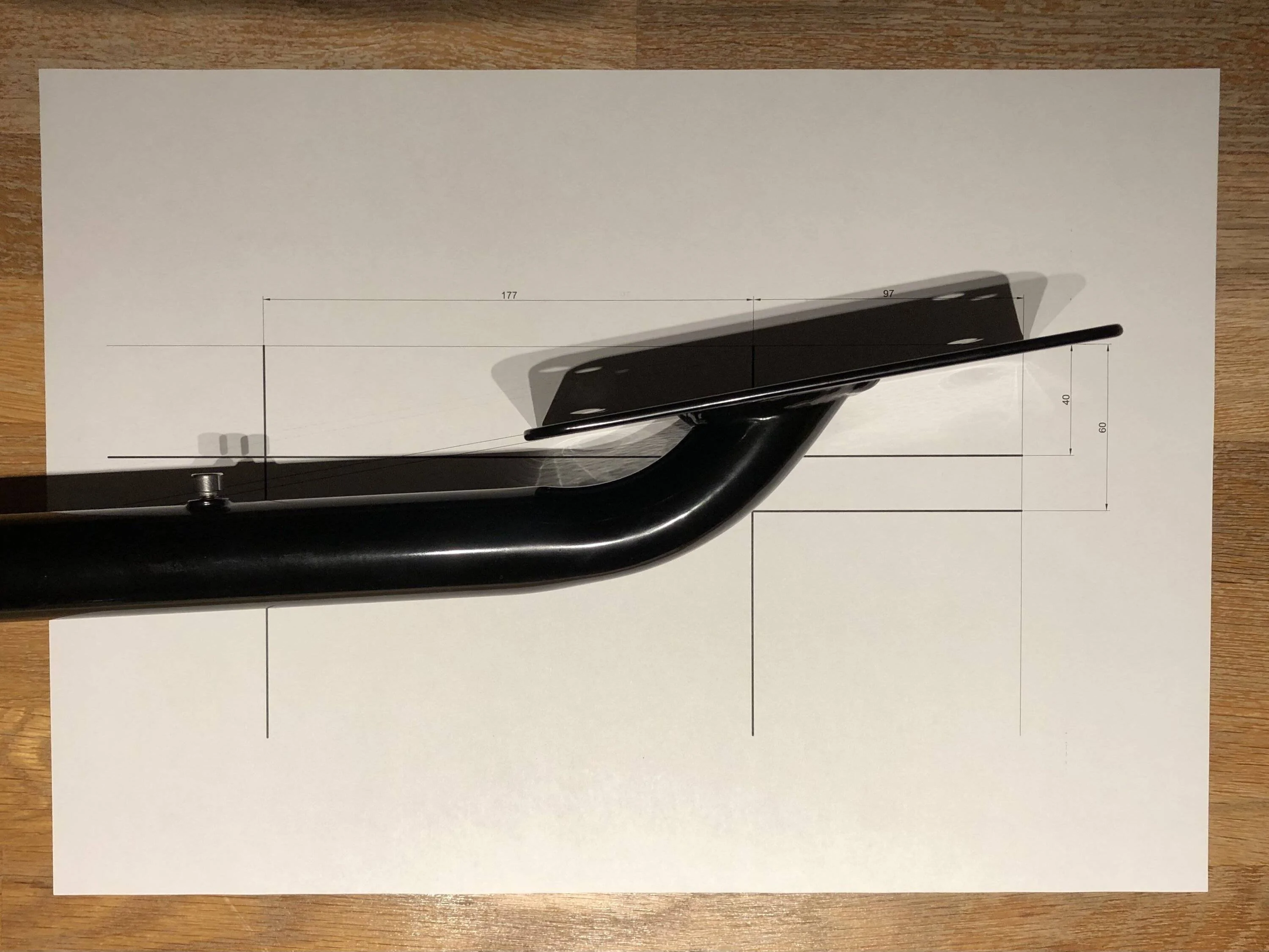

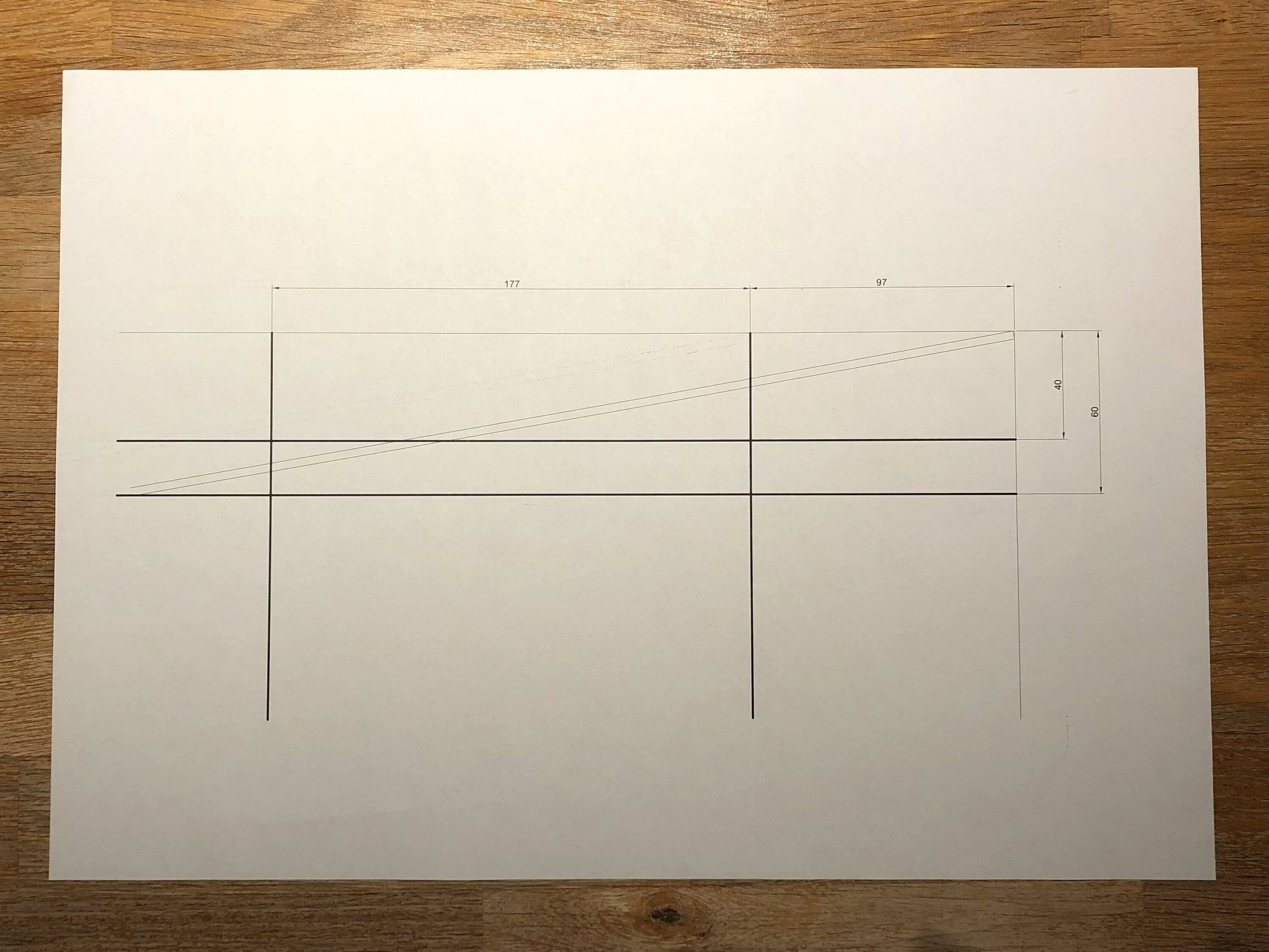

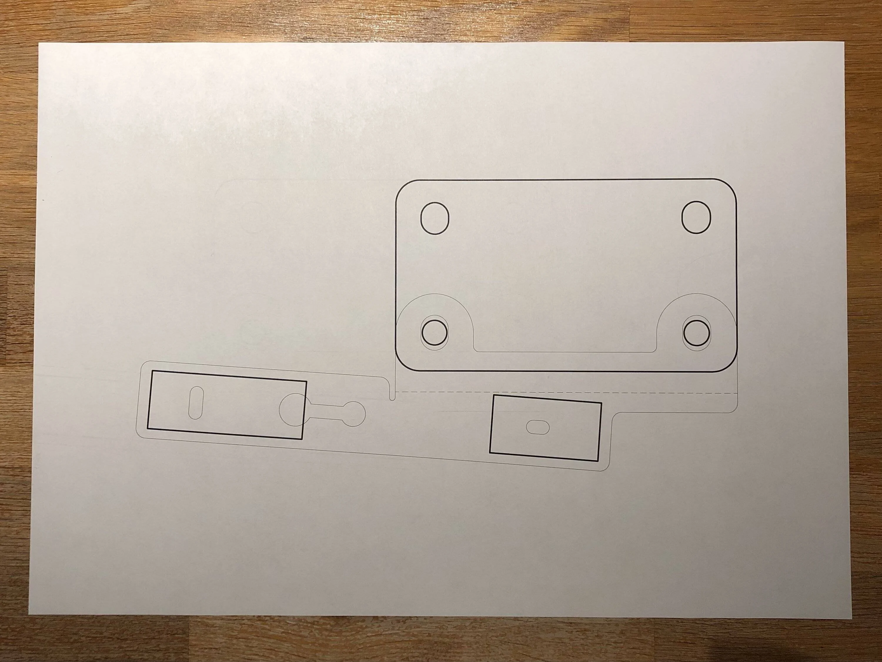

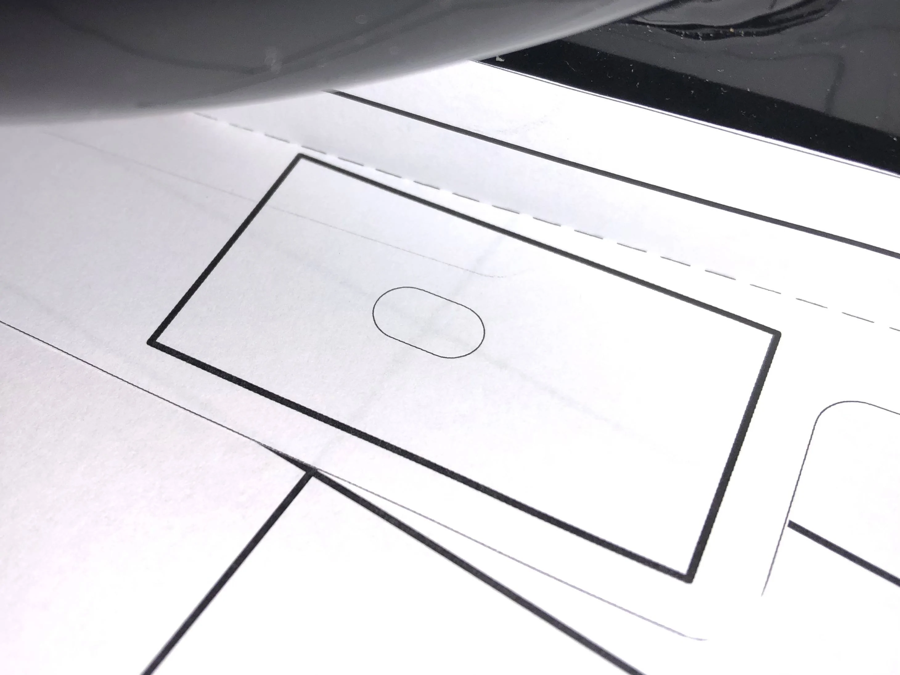

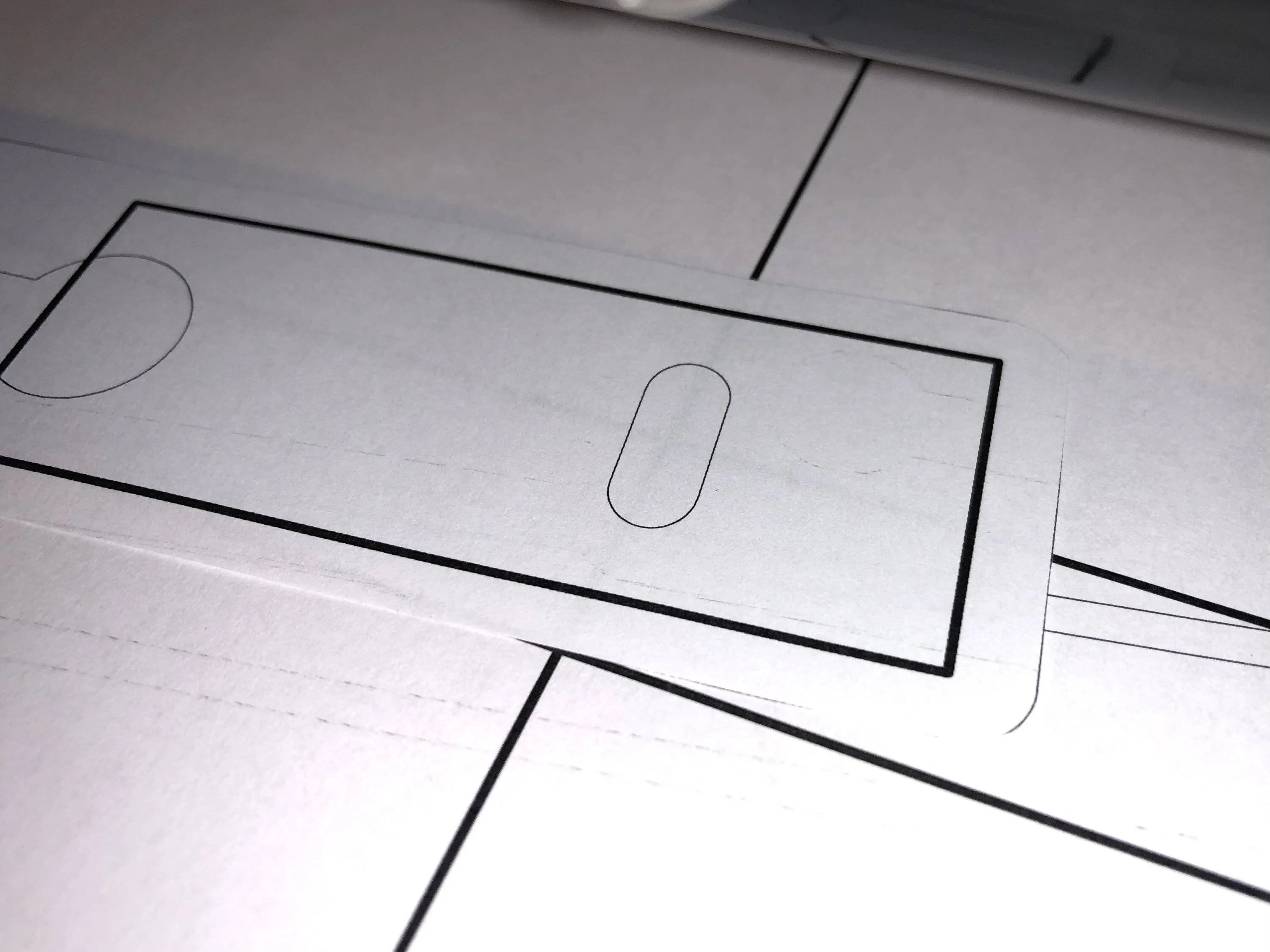

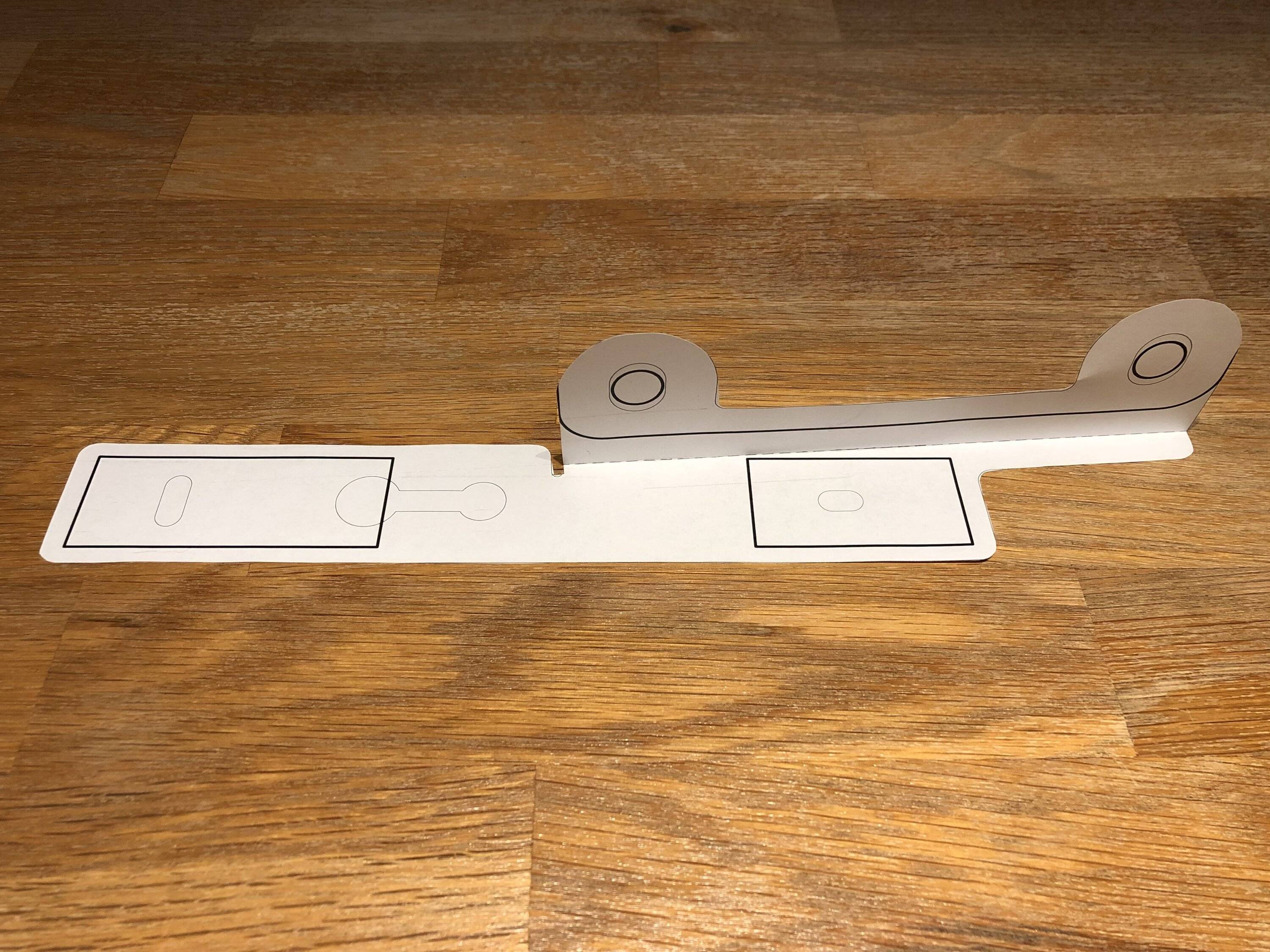

After I provided some high quality (not … :giggle:) hand sketches, Warren provided some missing dimensions that I requested, then using them and the Steeda crash bar, I came up with this paper design :
Folded template :
Plan view of the target bolt locations :
Brace in position (ignore the perspective and strange shadows) :
Then with the paper template in position, the outermost / rearmost mounting target sits right in the middle of the adjustment slot :
As does the innermost / forward most target :
I’ve slotted the mount holes so I can allow for a little tolerance with :

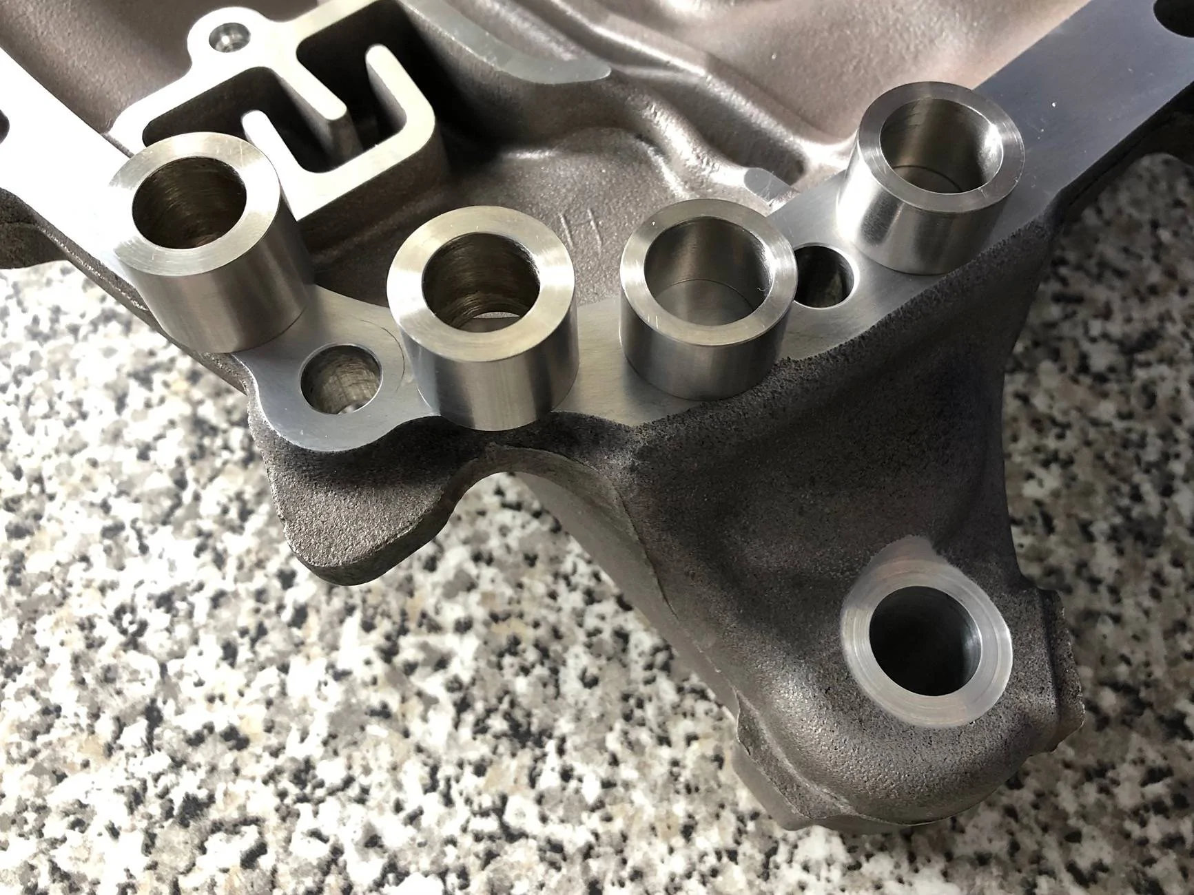

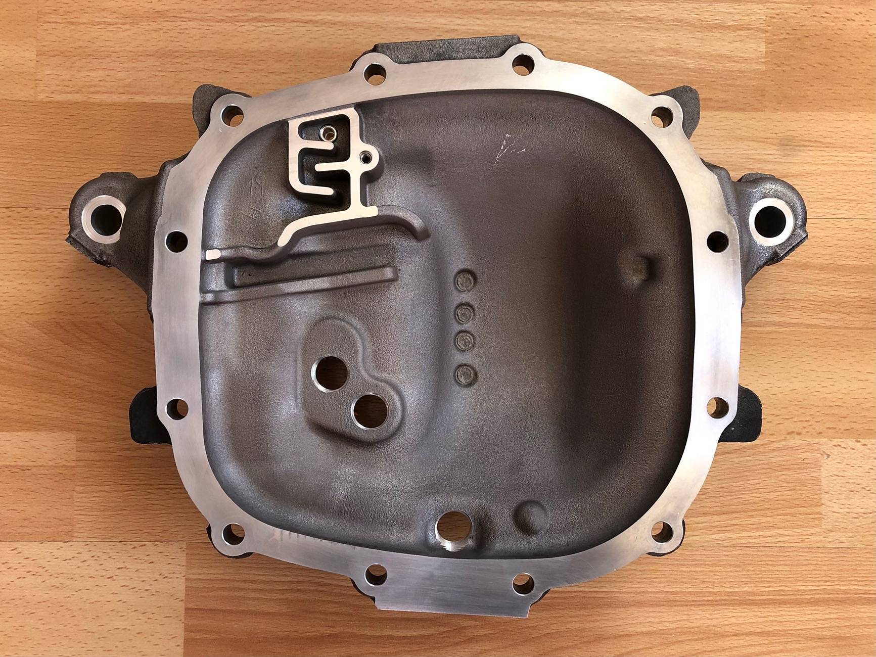

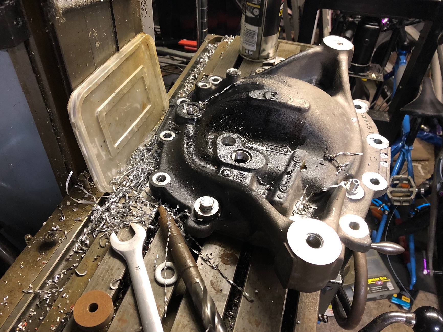

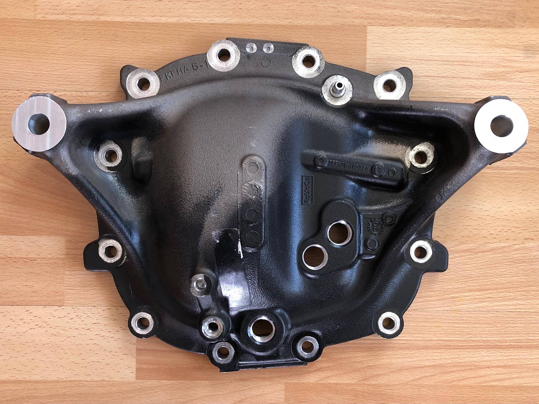

I went to see an old friend who’s got a few machines in his garage, so I could start work on the broken diff cover.

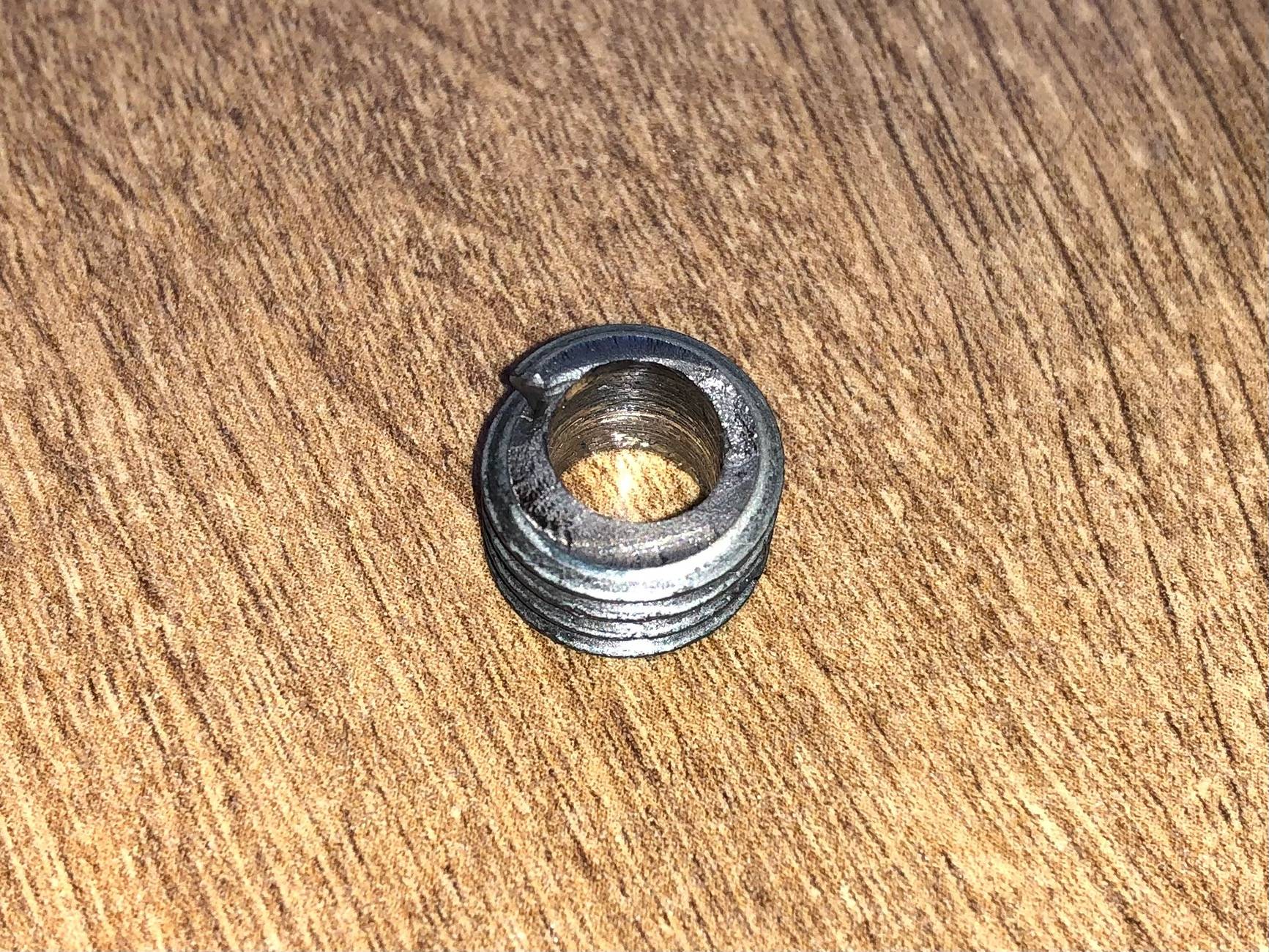

On the table, oil return port was first :
Then the broken bolt was machined out from the back, the drill wouldn’t budge it, and it still clung in there until the last four threads, even hitting it with a four flute end mill :
Shame on Ford for loading that bolt in shear on the minor diameter (if the joint is loose / loses clamping force) :surprised:

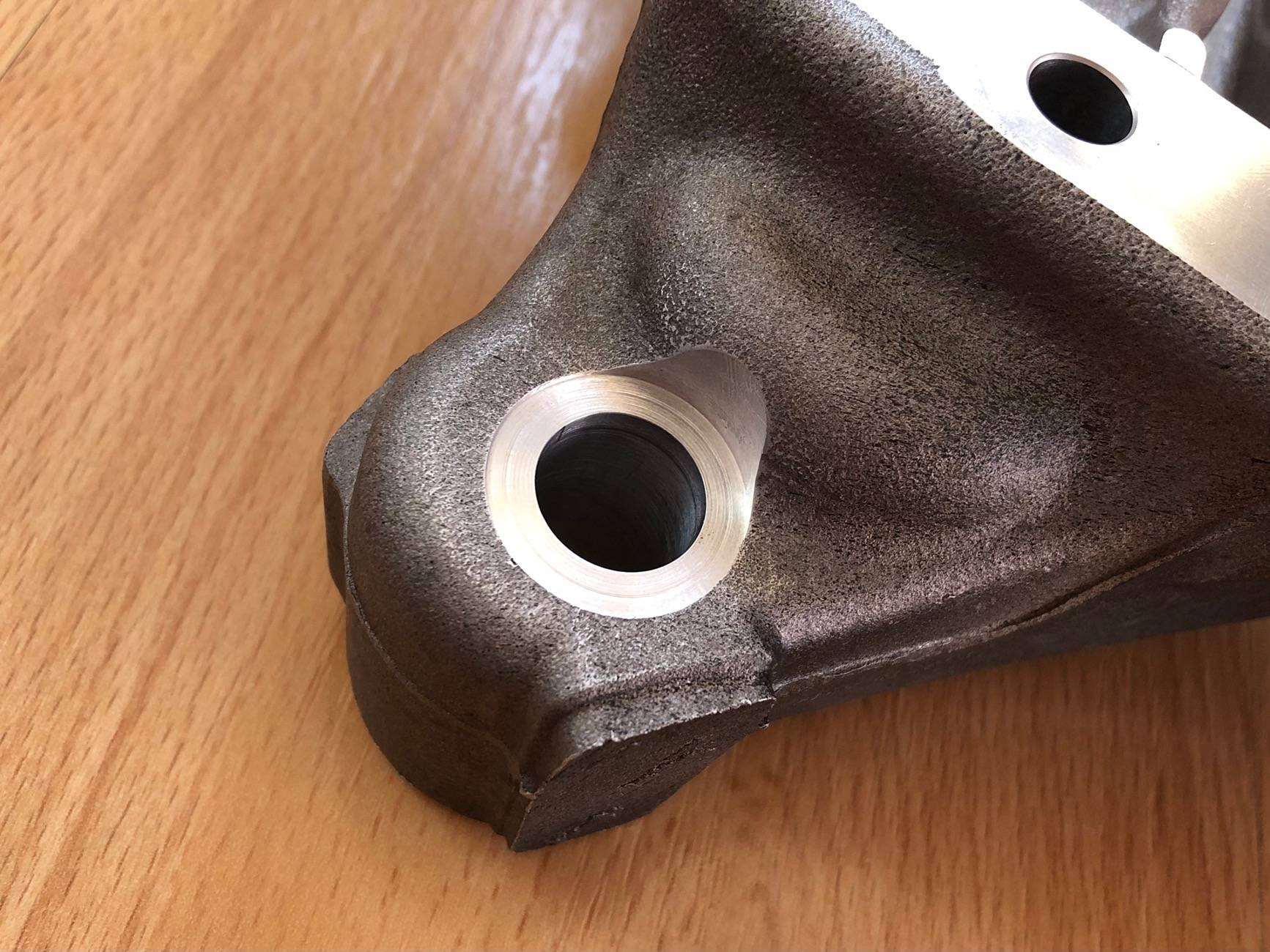

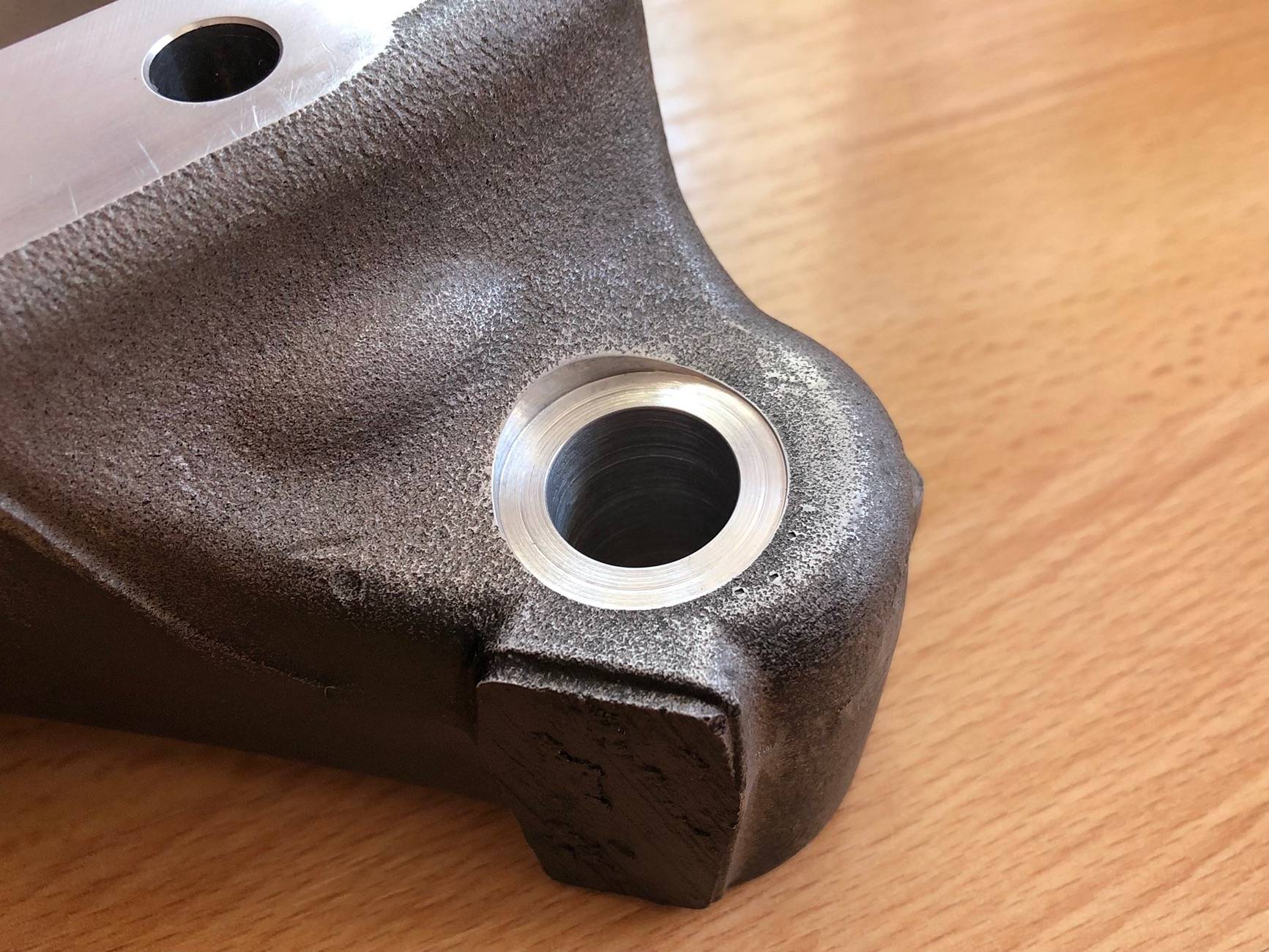

Then the ears got taken out to M16 clearance, faced up (0.5mm) to clean up the scuffed face, and then counterbored on the back (25.4mm) to accept the M16 cap head (24.0mm).
All done :
The counterbores :

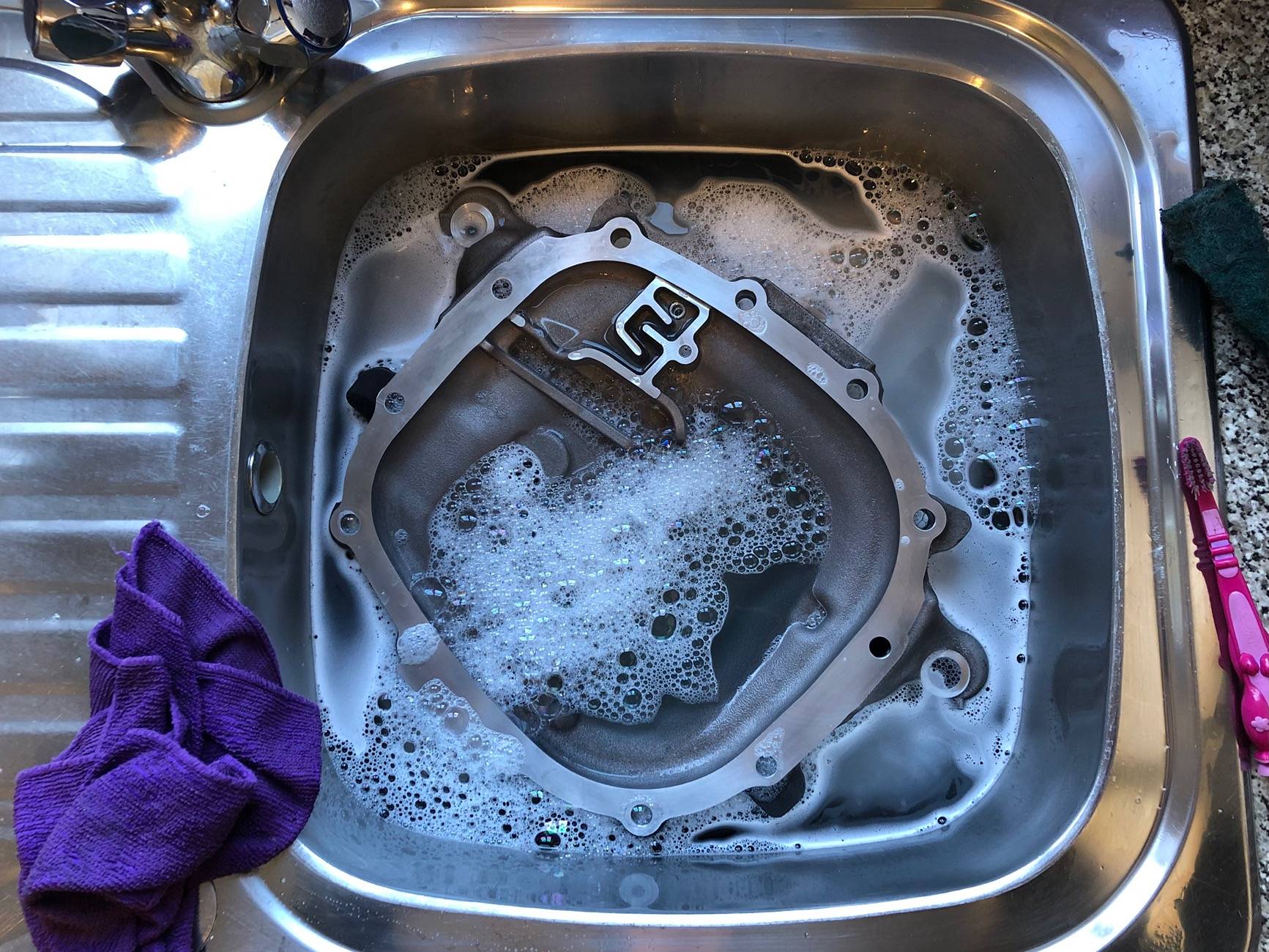

Doing the dishes :

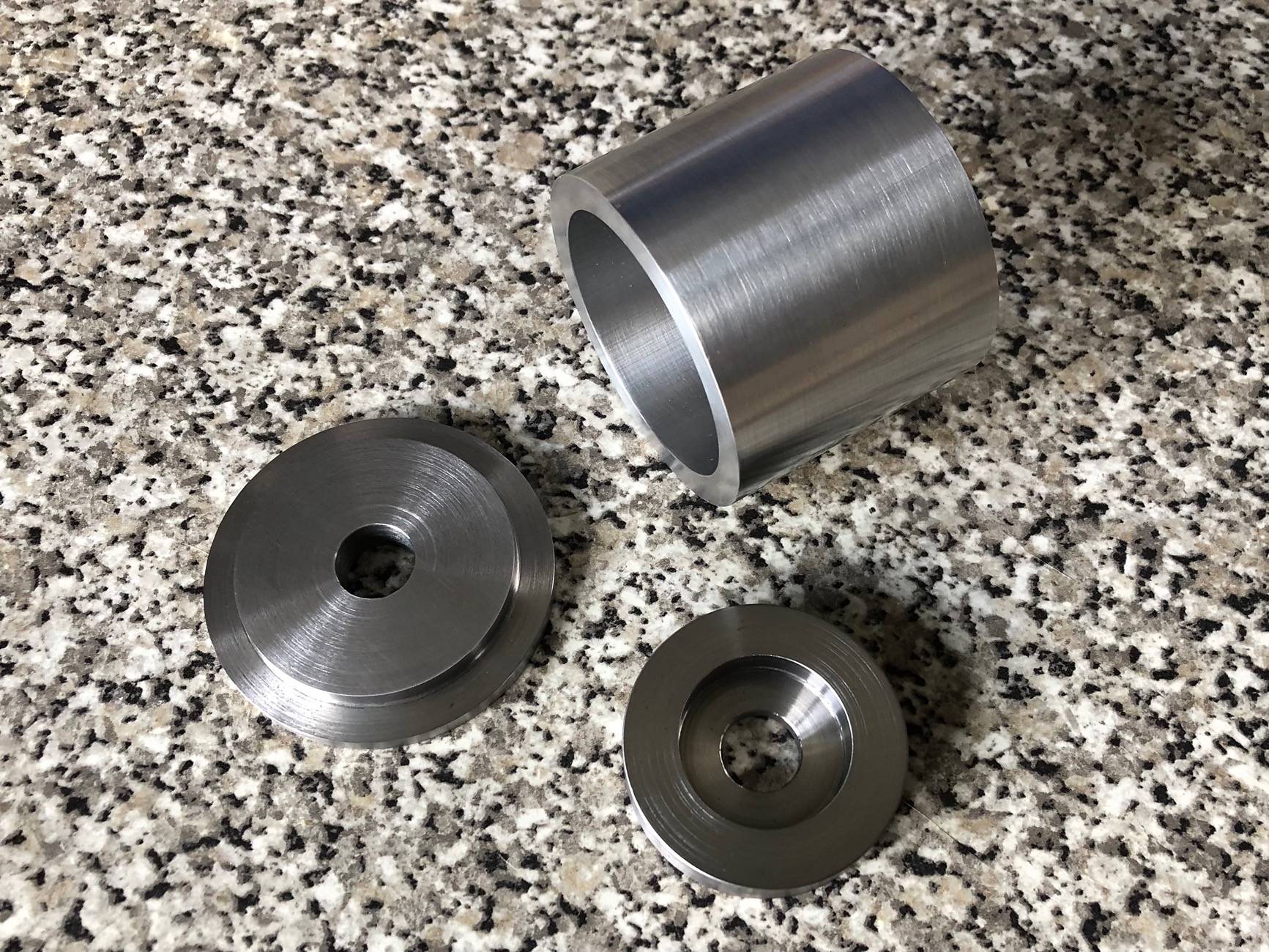

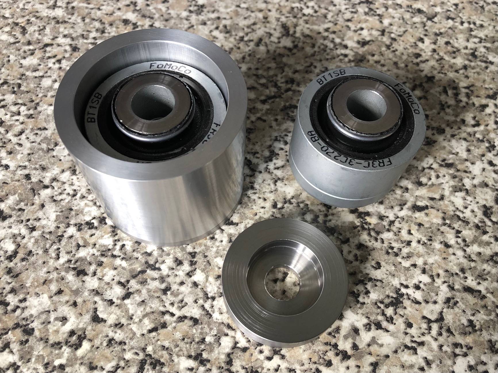

Same guy made me new stainless spacers for the Steeda diff bush inserts, with the rears sized up to suit the M16 conversion :

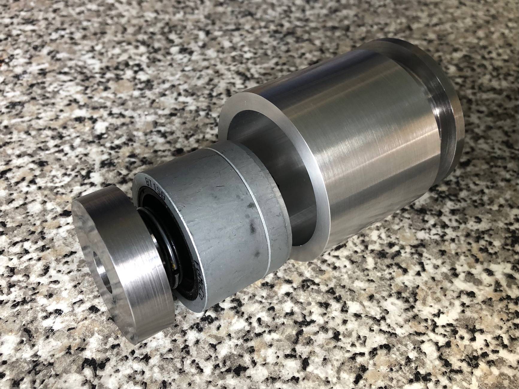

And finally, the two steel pieces for the toe link bush removal / installation tool :

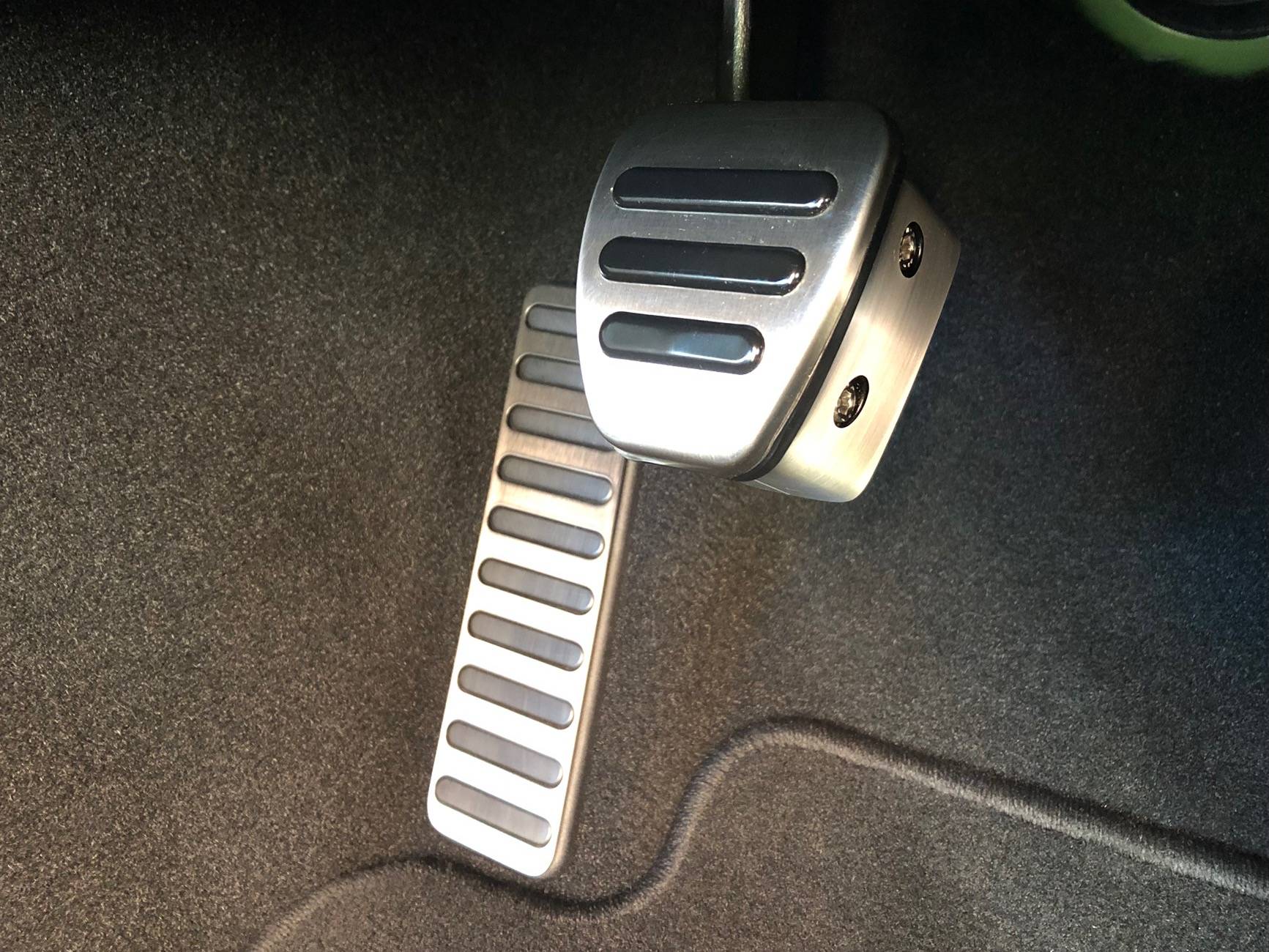

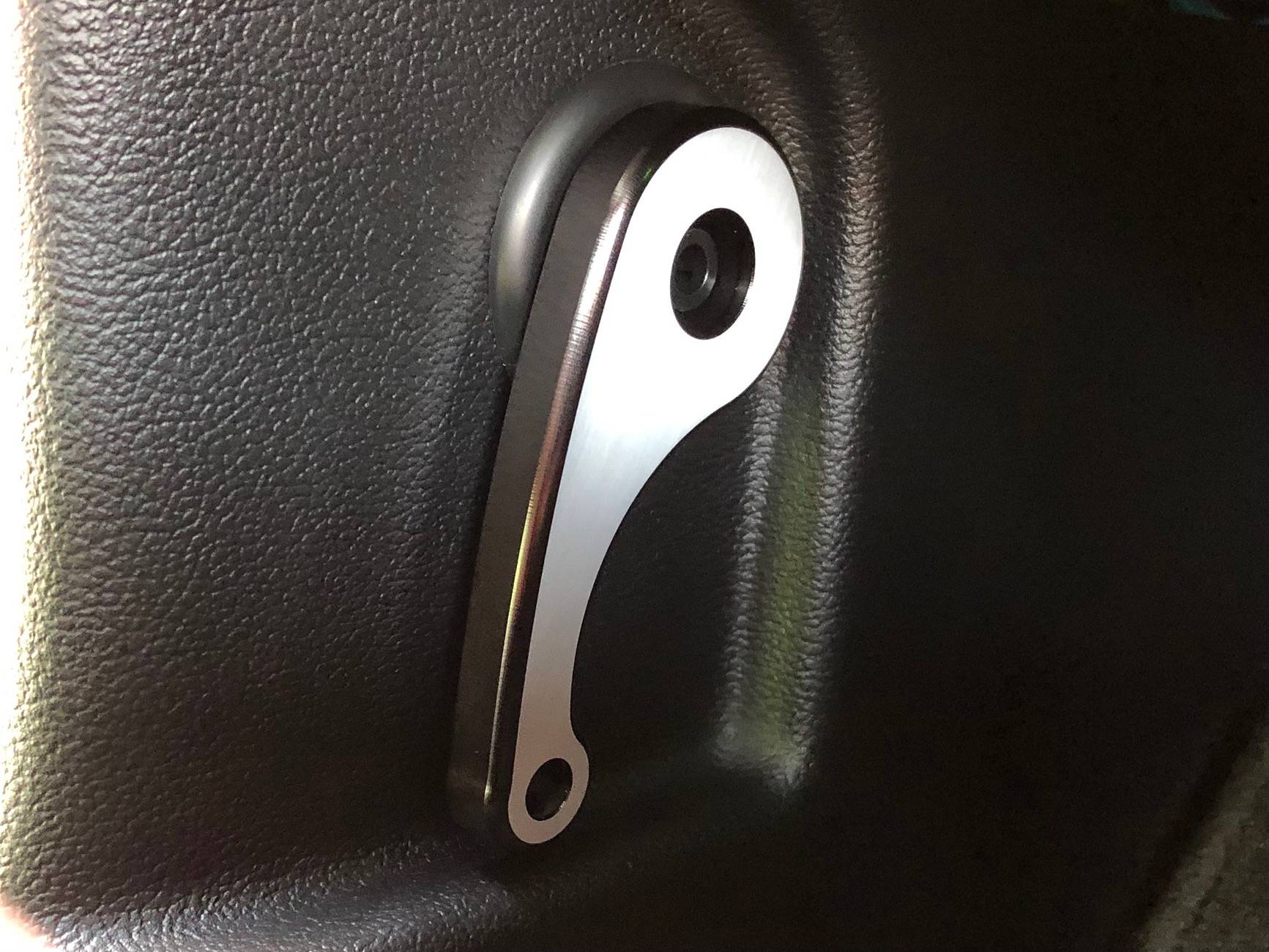

I finally managed to get my hands on a clutch pedal extender in the U.K. (thanks @Corporate_Rebel) :sunglasses:
I removed the anodising and added a brushed finish, and as it’s going on a RHD (so the bolt heads are now on show rather than hidden), I also replaced the black steel bolts with some stainless bolts that I polished up, and spaced the top bolt out as it was hidden down the bore.
Fitted :
It matches the existing pedals quite well, along with the aftermarket foot rest, and the other anodised bits that I had previously done in two tone :
I really like the new driving position. I’ve been able to move my seat 40mm further back whilst still being able to bottom the clutch. The other pedals and wheel position are perfect for me.
Pushing the seat further back allows me to get in and out without touching the Recaro bolster (I can’t open the door past the first notch due to where I park) :like:

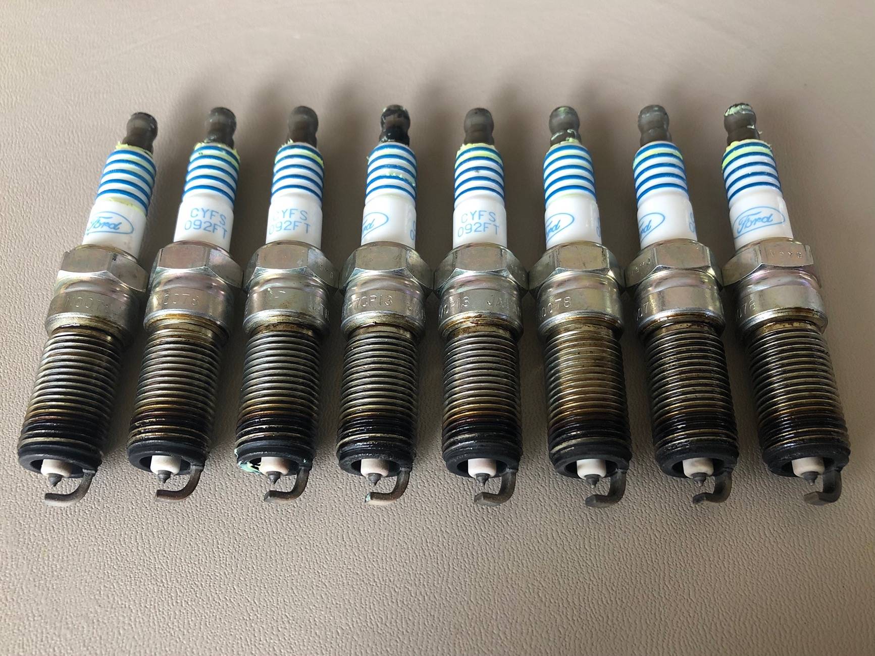

Service & MOT time again ...

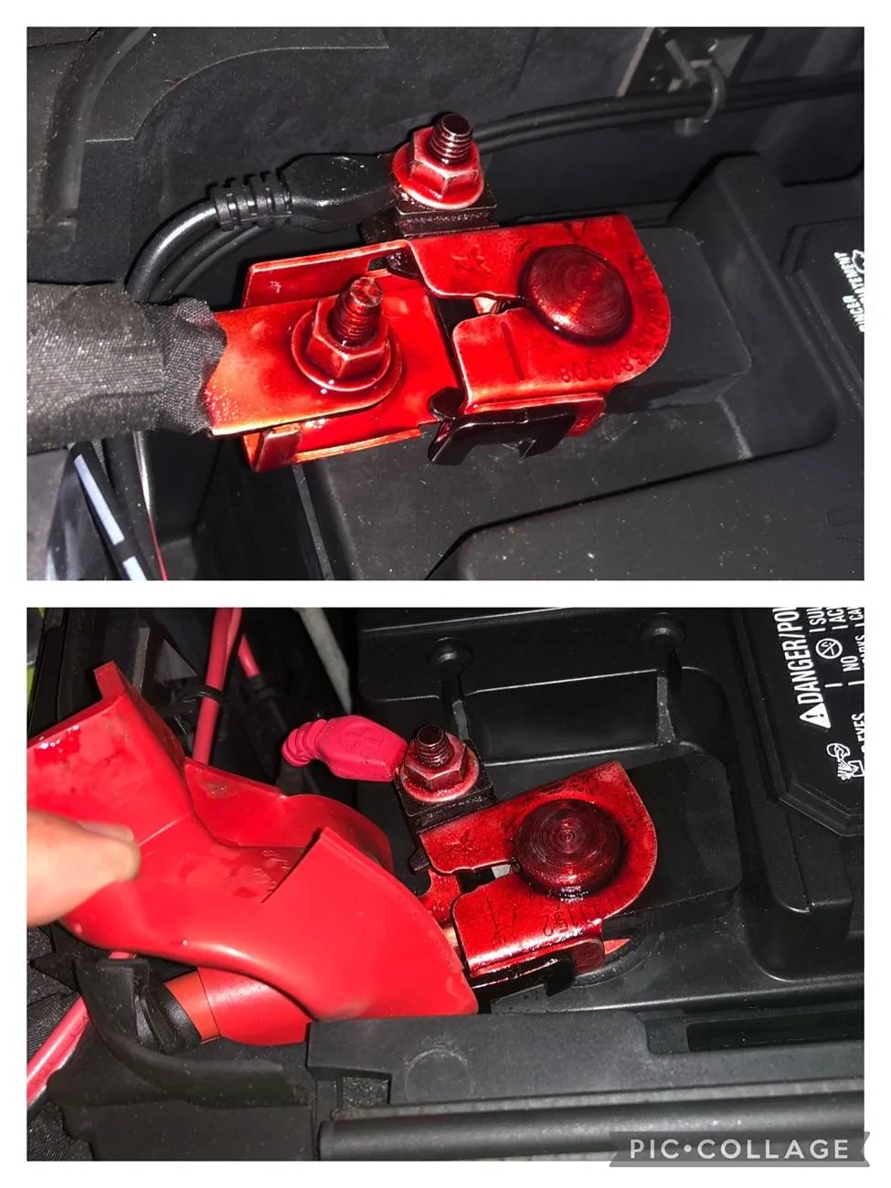

To save my tech a bit of work, I removed the strut brace and battery cover, which allowed me to inspect the battery terminals (as there are numerous rumours about terminal corrosion).
  • 4.5 year old OE battery ✅
  • Noco grease ✅
  • Outside kept ✅
  • Sporadic usage ✅
  • Tender (CTEK) usage ✅
  • Tender ‘wrongly’ connected ✅
  • Zero BMS issues ✅
Drop off :
Who stuck that on the front ?
Well damn, it’s fallen off again already …
All done, with a clean bill of health, and another 12 months ticket :like:
Lets not get into discussions (again) about Fords recommendation for plug replacement at four years ... lol

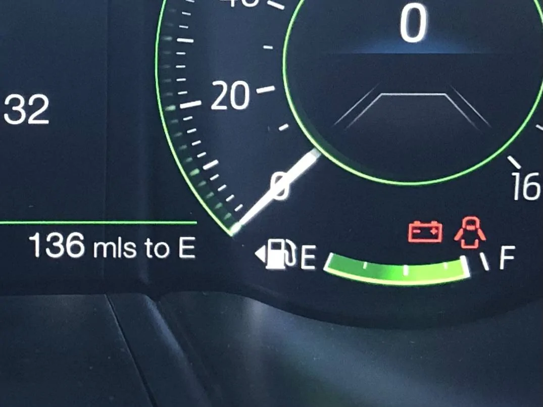

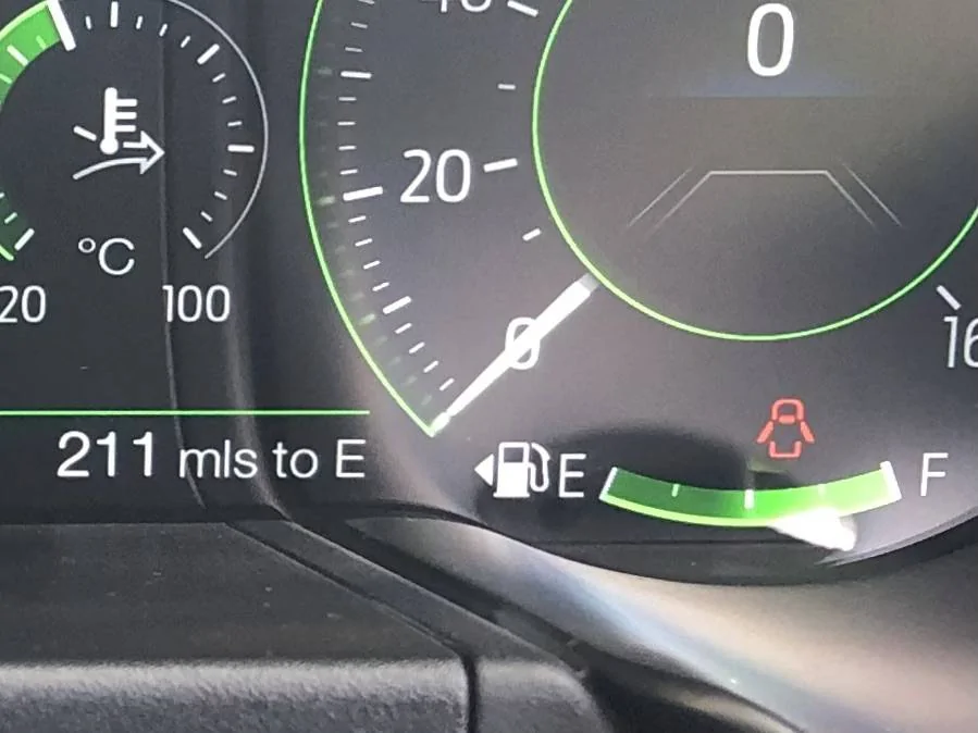

Interestingly I filled it up just after it’s service and the range to empty jumped to an all time high (even though the calculated mpg for that tank was 11.25) :
I think the battery disconnect / KAM reset must mess with the calculation as 28 miles later, normal service resumed :

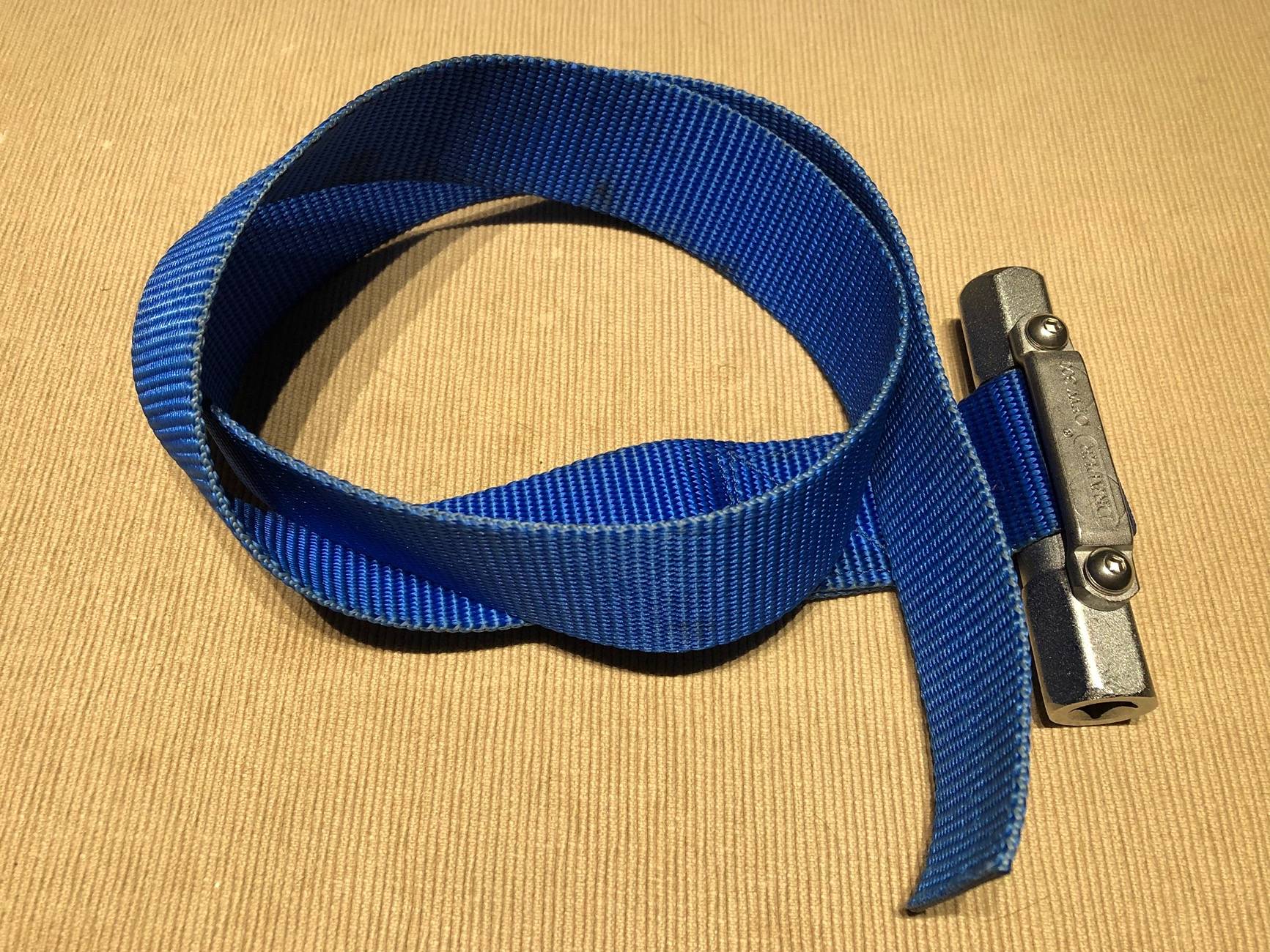

First time (Ford knob) was tight, but it was possible to remove it by hand.
Second time, I got a full turn or so and then it locked up solid. I had to resort to wrapping it in a latex glove, and then this to get it off :
I genuinely thought I was going to destroy the knob, or at least pull the brass insert out of it.
