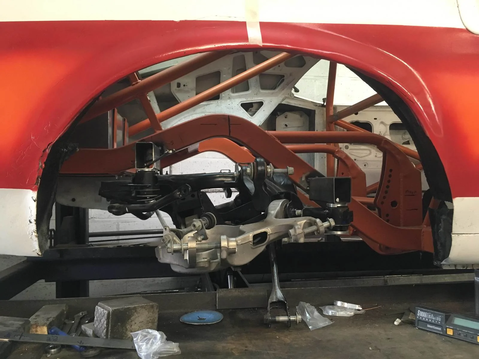

Update! I know it's been ages, but at last we're moving on the chassis. The old Thunderjet engine and C6 transmission has been pulled, bunged on eBay and the rear end is out, so we had a chance to figure out how the hell the IRS assembly was going to fit and work.
Two days were spent measuring and thinking and working back from the fixed dimensions of the IRS, the size of our dream wheels and the body / desired ride height. Which originally was 4" but now, on close inspection of the chassis, needs to be more like 5".
The car is mounted on 5" rear and 4.75" front stands which gives it this kind of look:

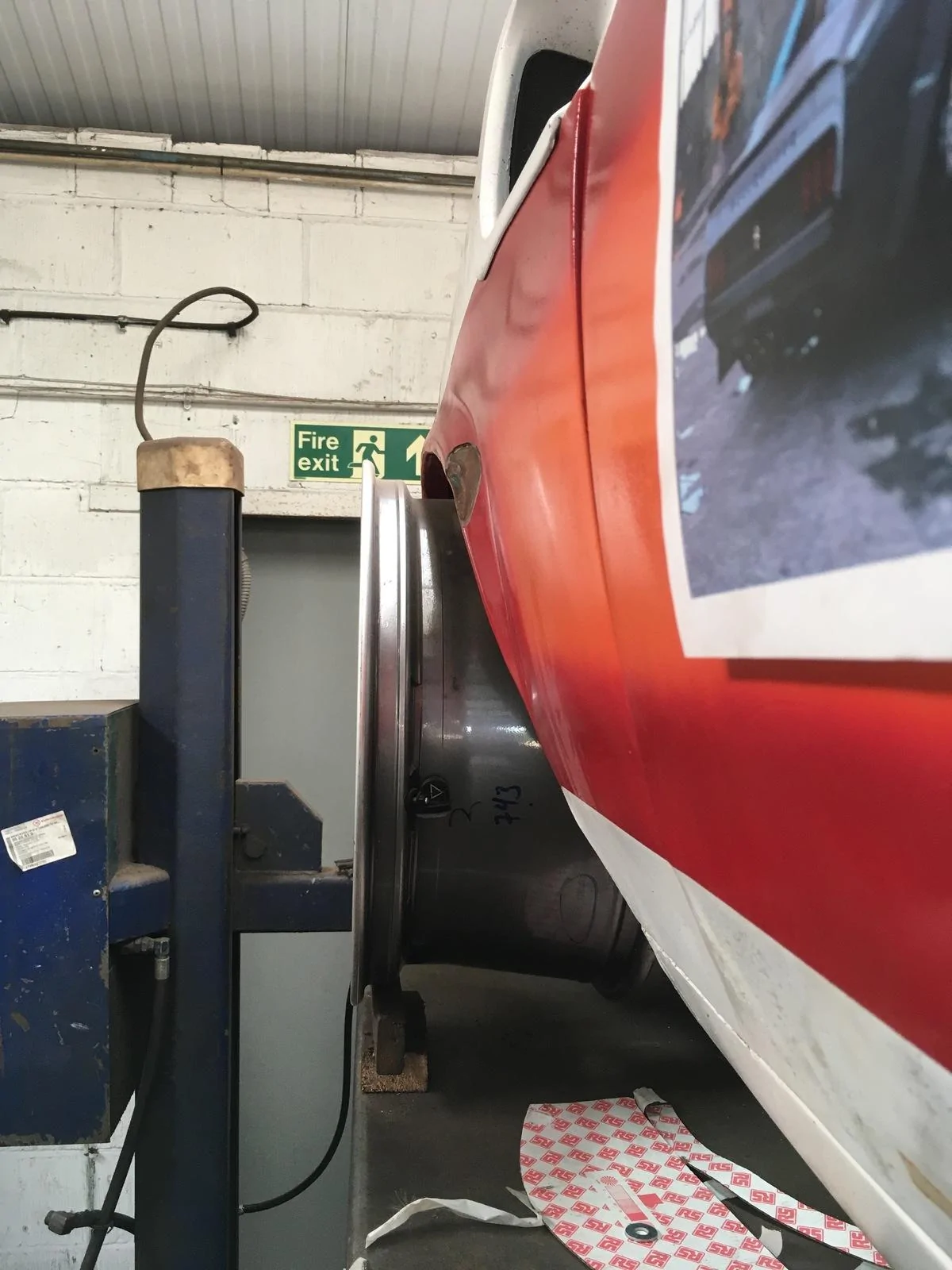

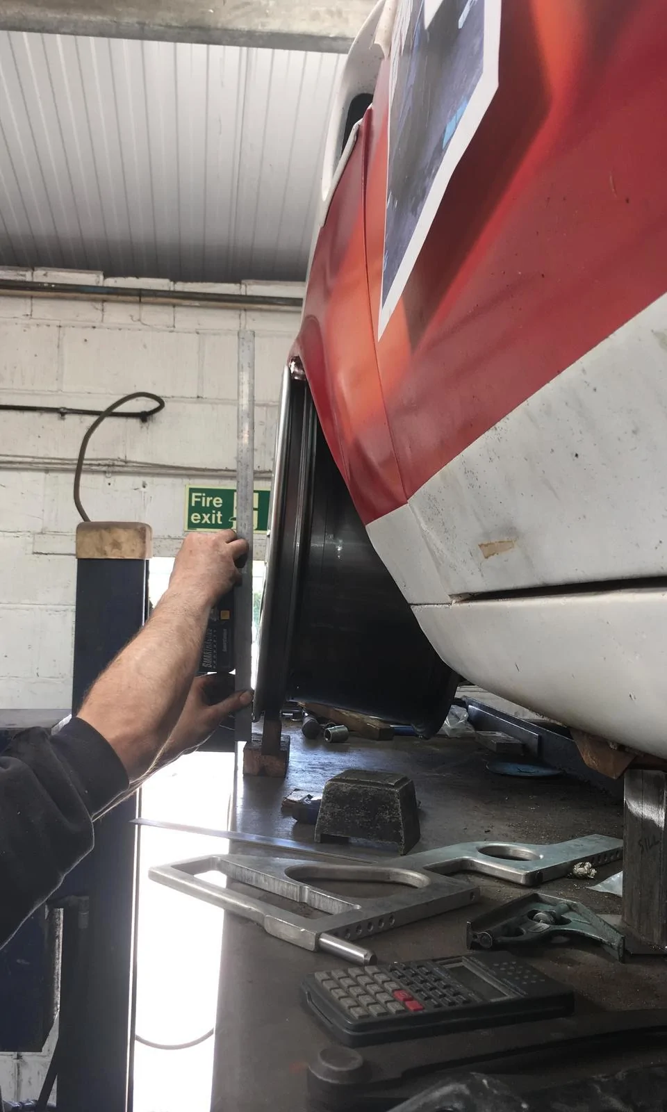

I swang by the secret workshop this afternoon. The IRS subframe is tacked in place, which makes me very happy.
And. looking at the position of the hub, an idea of how far a 12" wheel with virtually zero offset will stick out of the body. :)

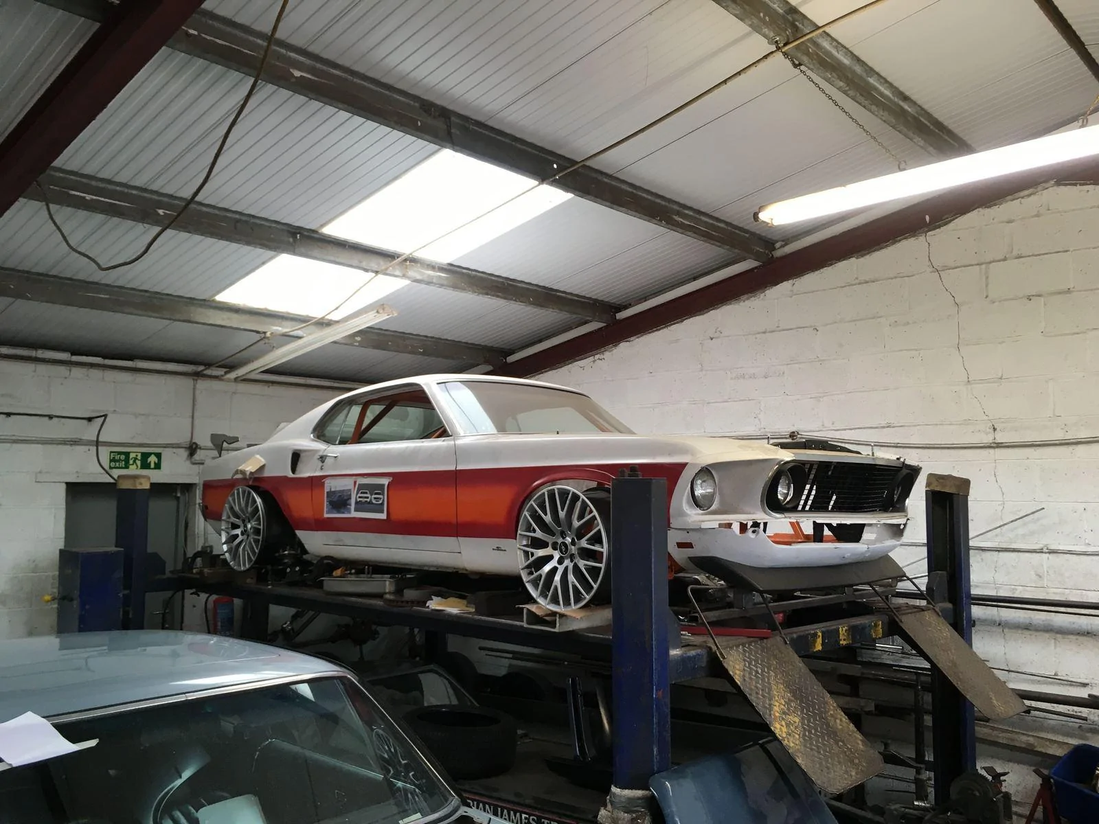

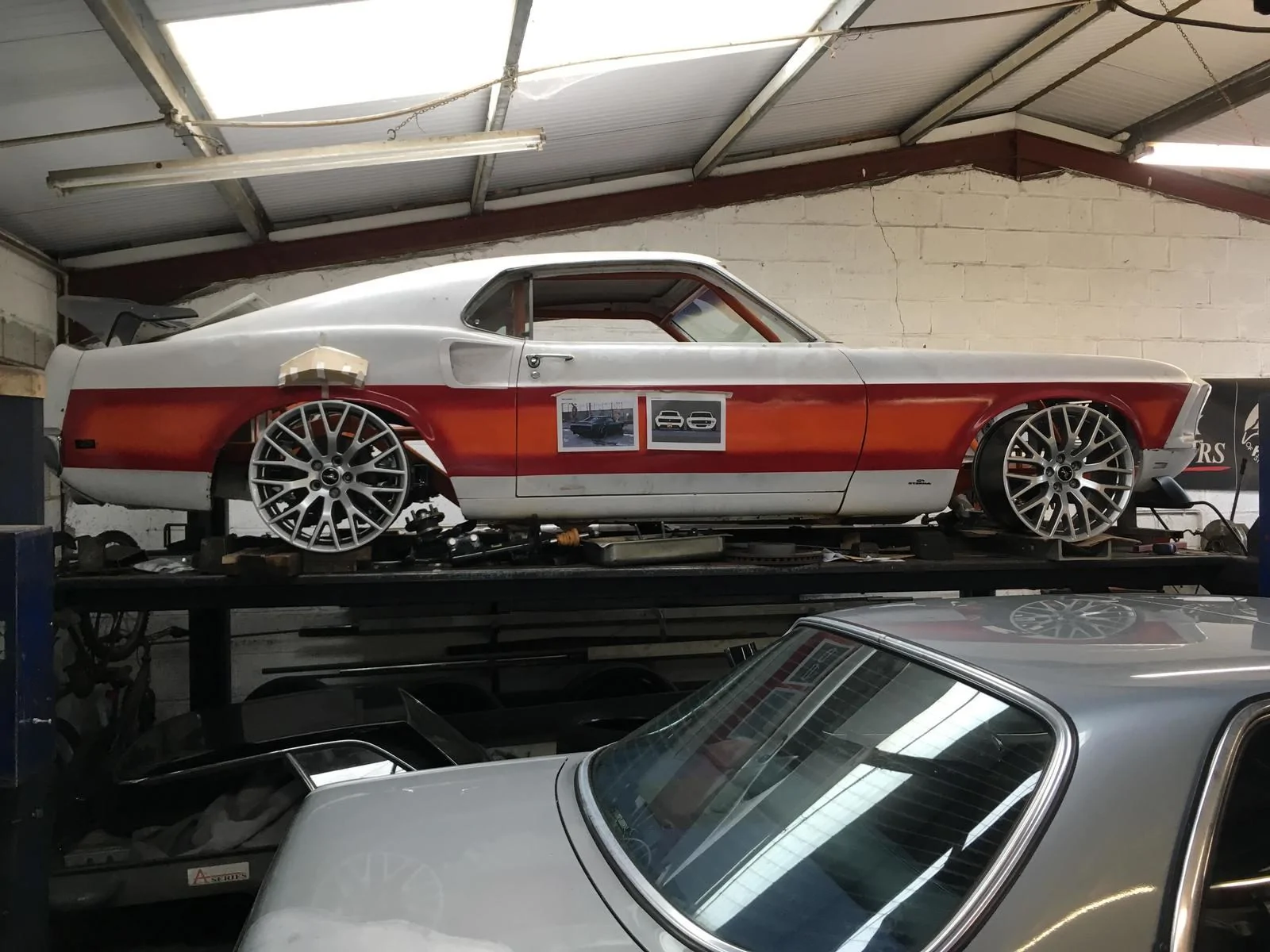

Some further progress. Wheels in position. Not the actual wheels, these are cati's 19"s, but in place for mock up purposes and to get dims for the suspension and clearance etc... We're hoping to go with Forgelines eventually.

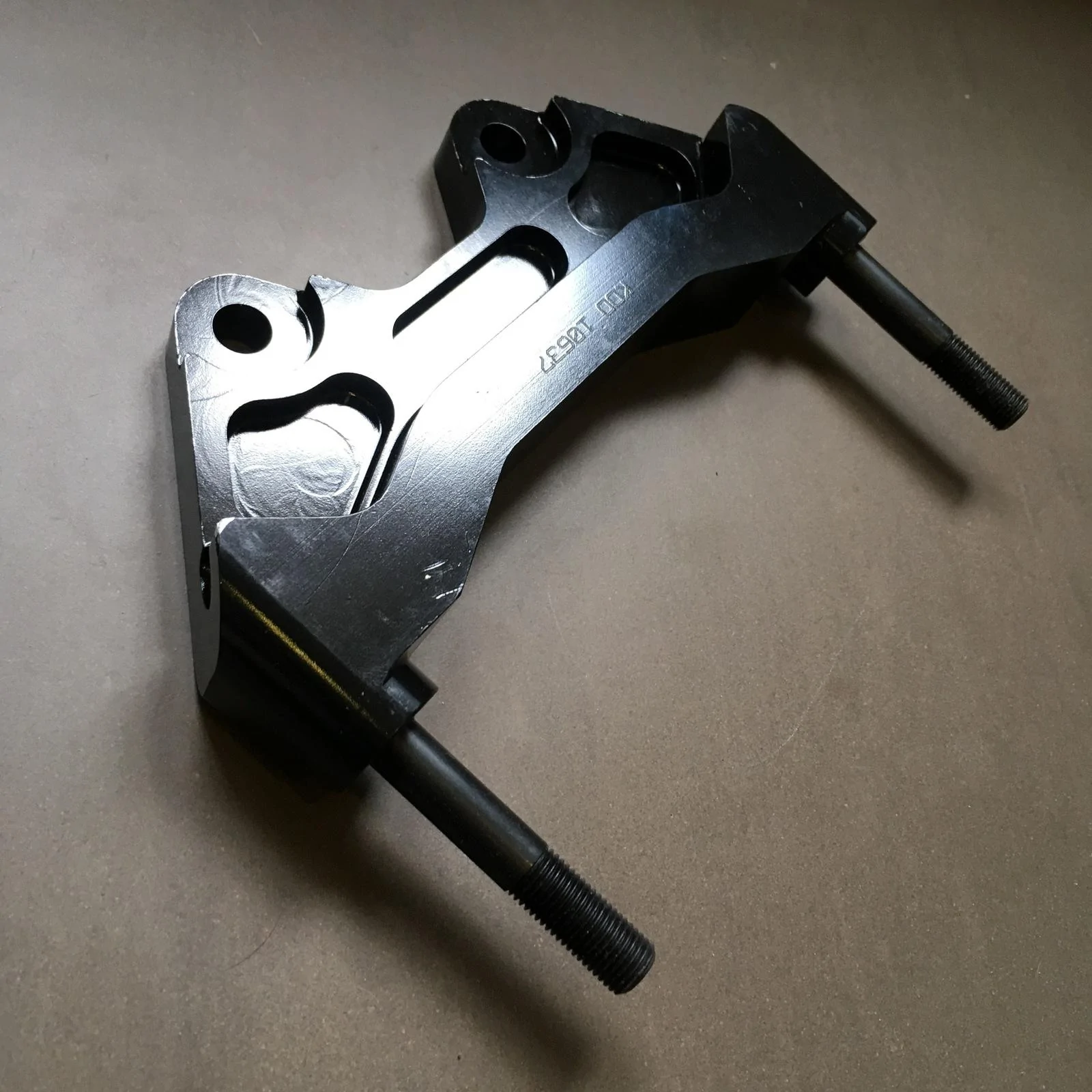

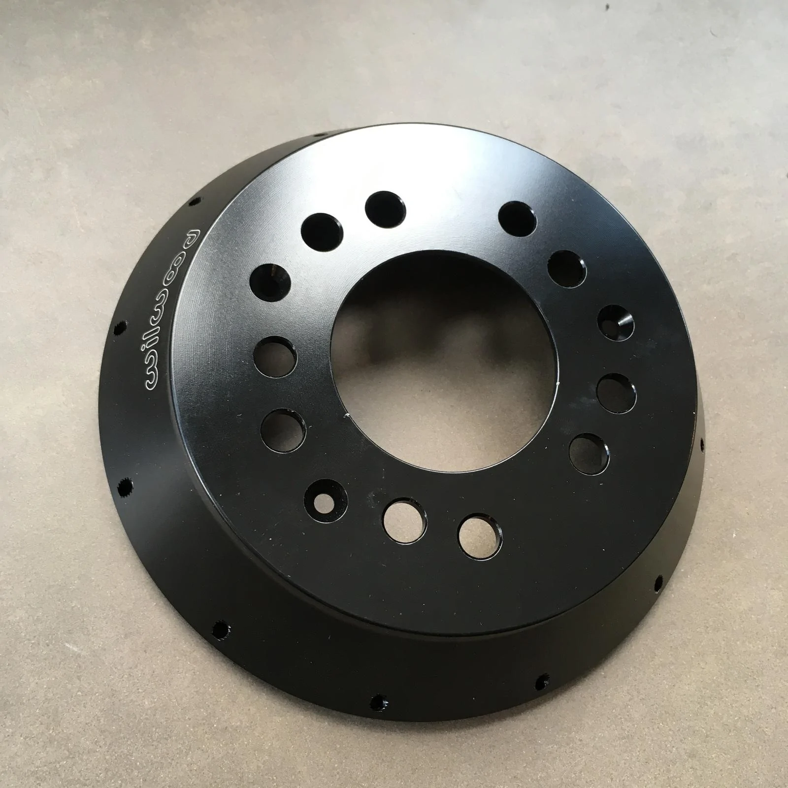

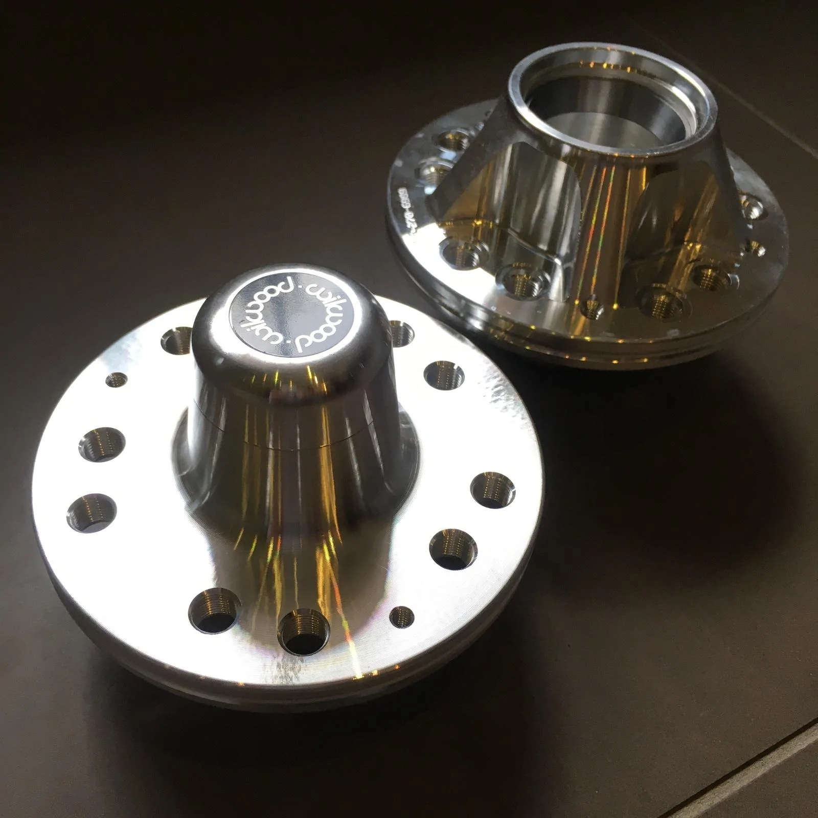

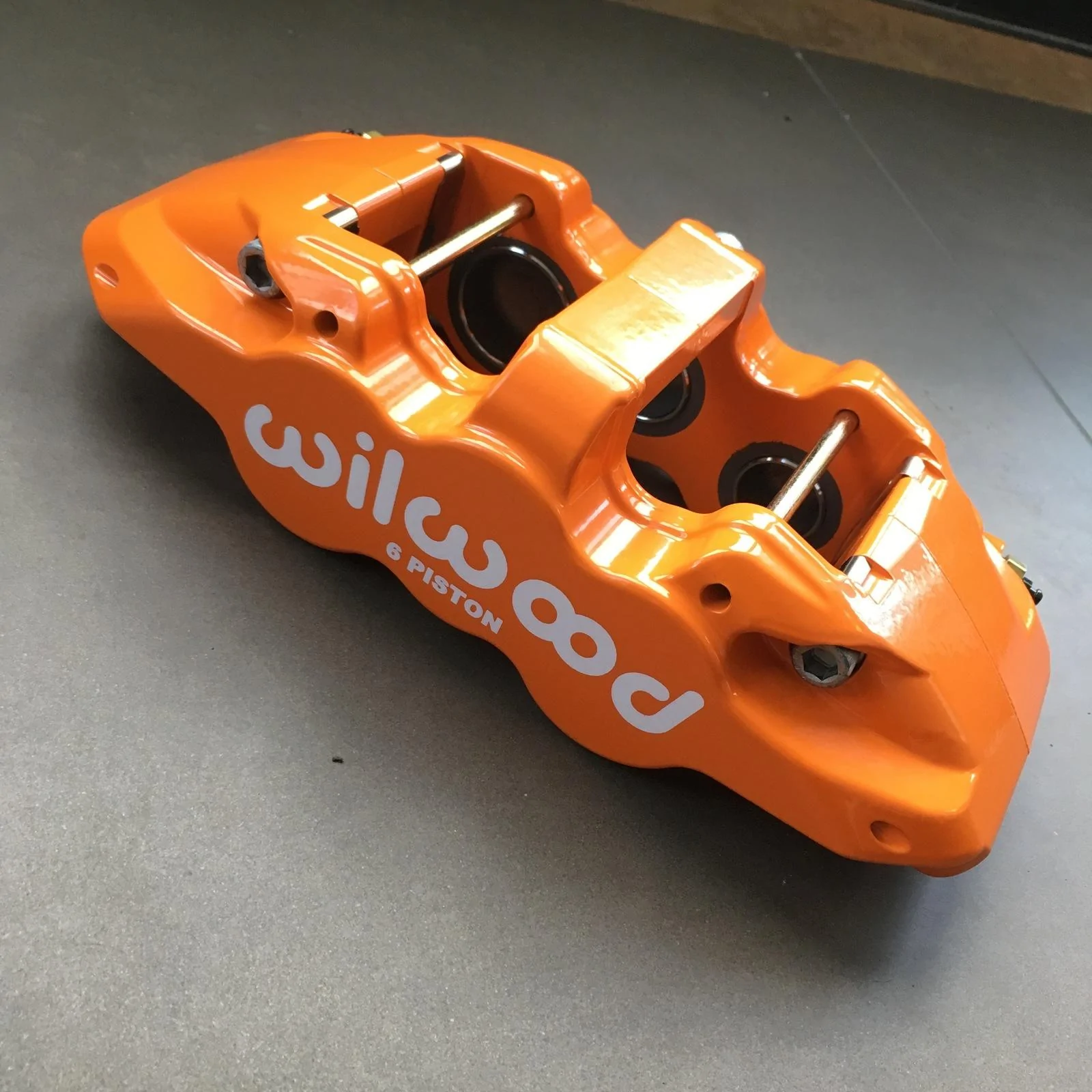

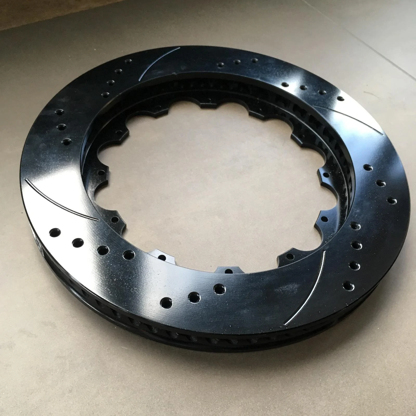

Well its been bloody ages I know, but things have been going mad the last few weeks. You can catch up with much more detail on MFUK (http://mustangforum.uk/viewtopic.php?f=3&t=8289) or the our Facebook and DriveTribe pages. But basically we've been getting packages from the States and chopping stuff up:
It all arrived yesterday. Snuck it in the house while Mrs. Badhand was out to unbox and inspect it all. Gotta say I'm so impressed with the Competition Orange callipers. Can't wait to get these behind the Forgelines.

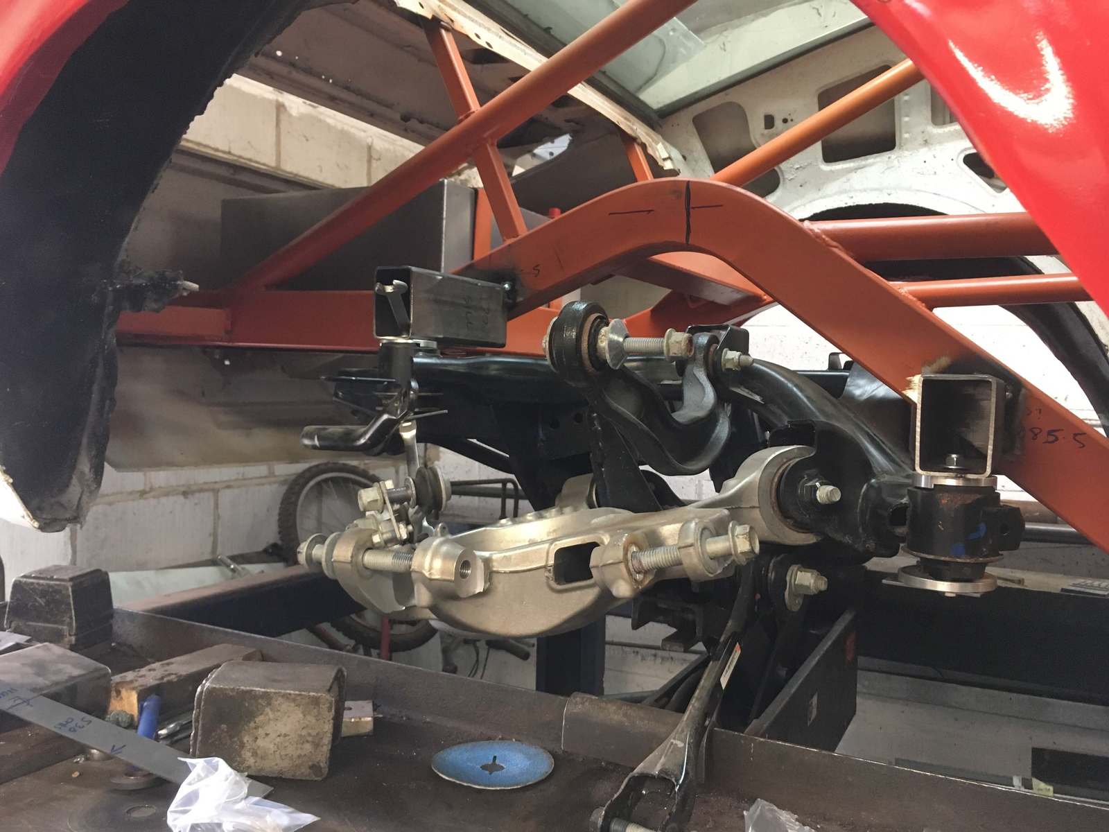

I'll transfer these to the workshop on Monday and we can, at last, start taking measurements for the double wishbones... Back on track

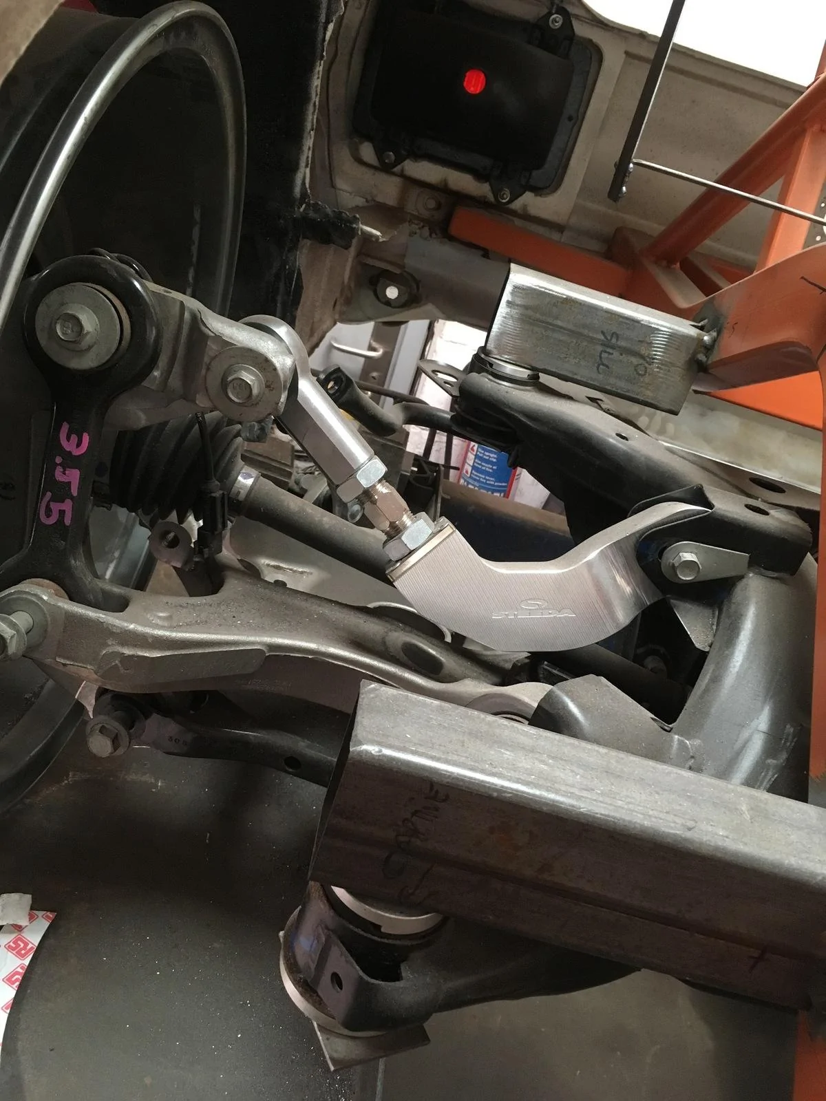

Steeda adjustable camber arms fitted:
And camber adjusted:
Pretty good. :D
