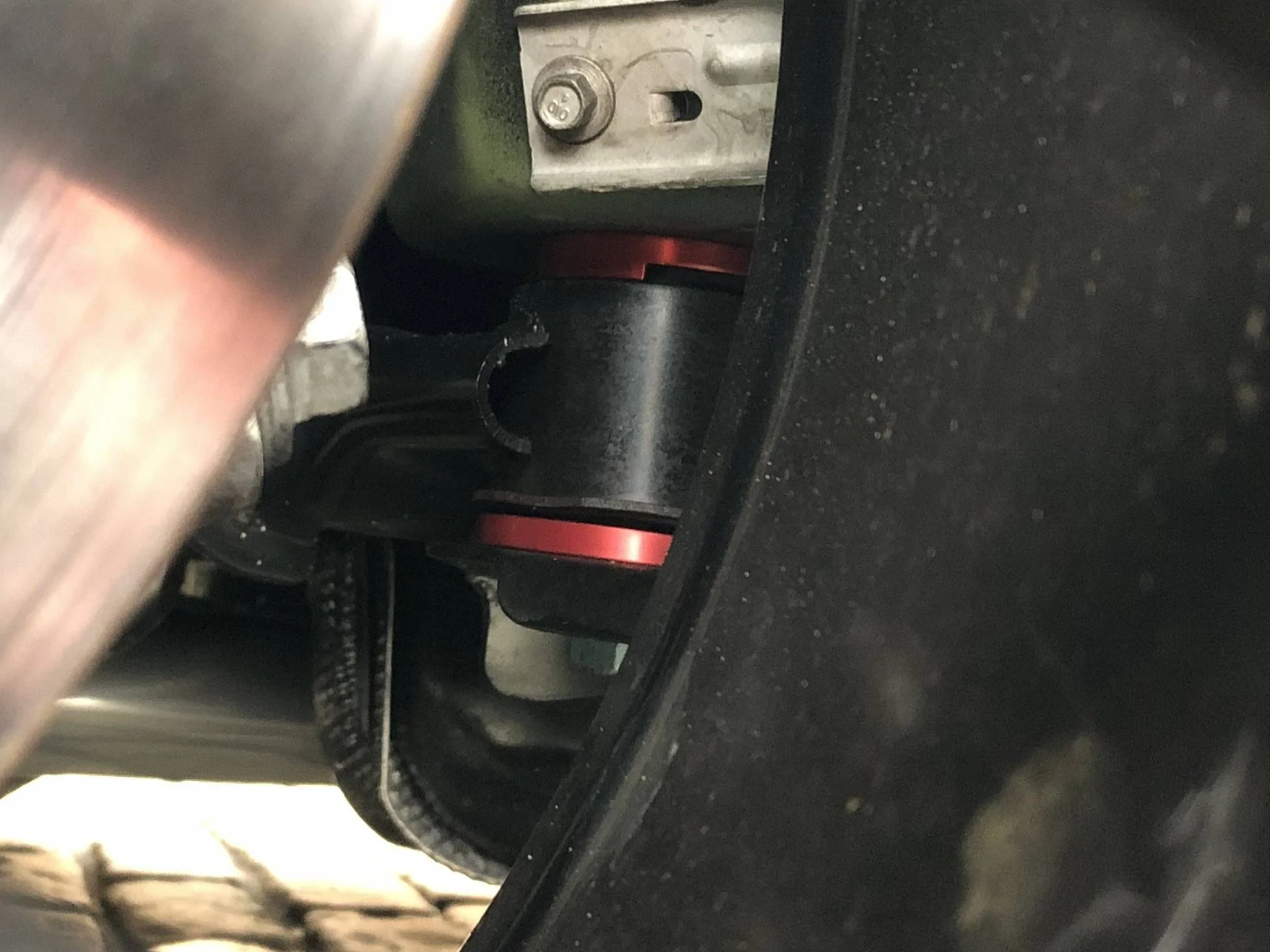

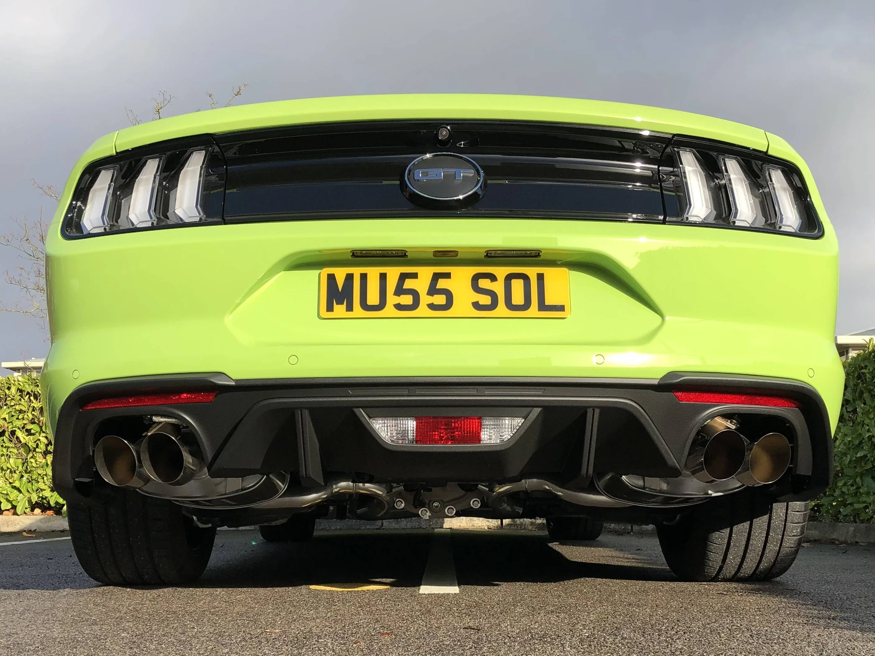

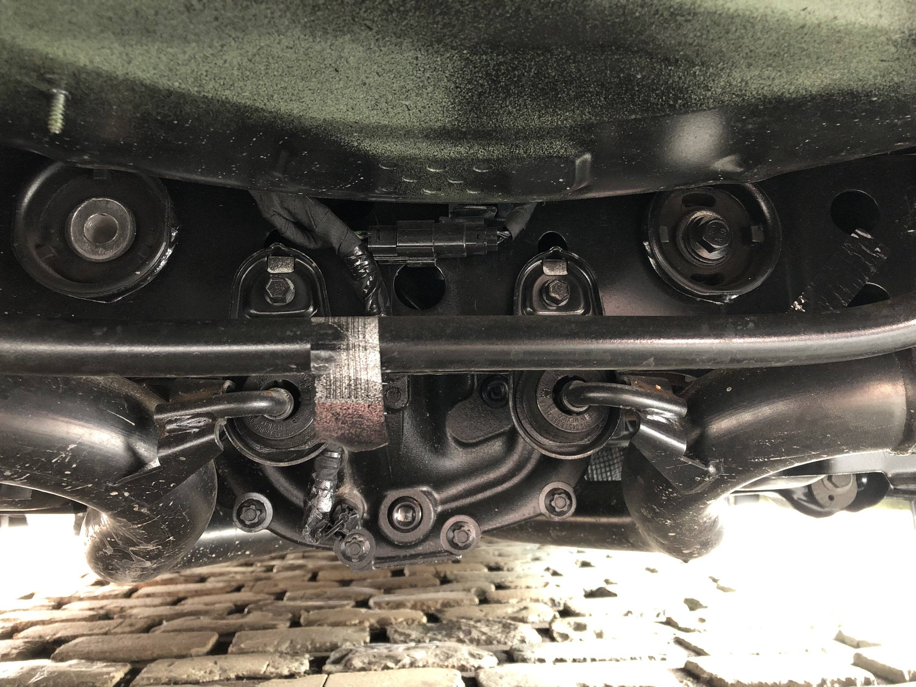

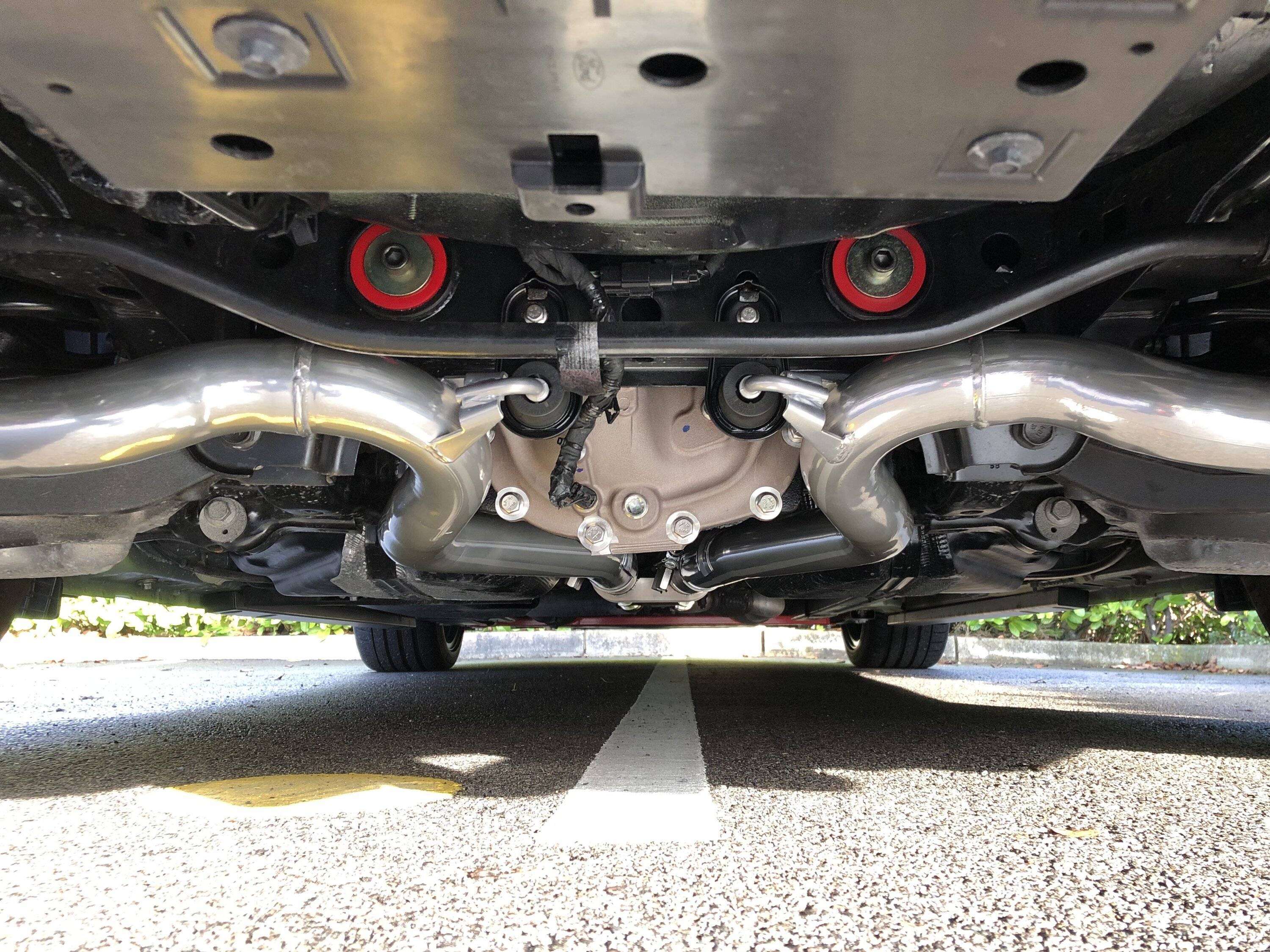

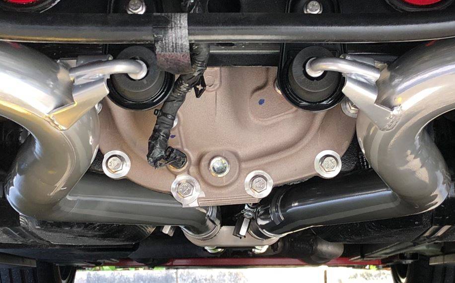

It's back (on Friday) ... ! :sunglasses:

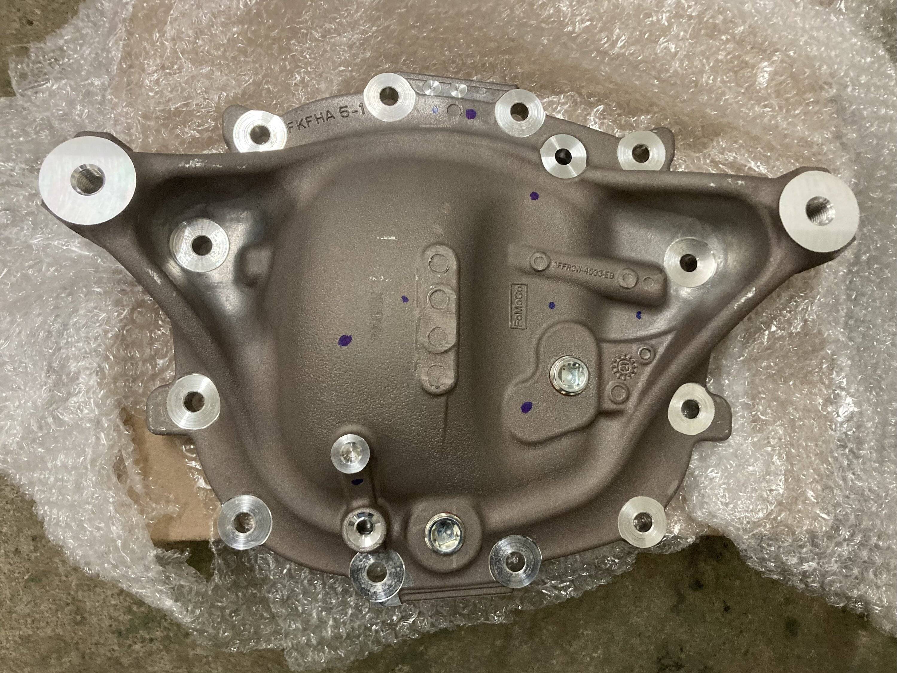

This post will mostly be made of posts from various other threads on the forum :like:
It started with a broken diff bolt and ended up with :
  • New diff cover (+ stainless hardware).
  • Steeda diff bushings.
  • 12.9 diff hardware.
  • Stainless diff bolt sleeves.
  • Steeda subframe dowels.
  • Steeda subframe support bushings (slightly modified, anodised red and stainless hardware).
  • J&M rear camber adjusters.
  • Ceramic metallic coated exhaust.
  • Steeda H pipe (slightly modified + heavy duty clamps).
  • All exhaust brackets repainted (+ stainless hardware).
Its nice to finally see the exhaust and diff etc without it being covered in the euro black crap ... :curse:
From this :
To this :

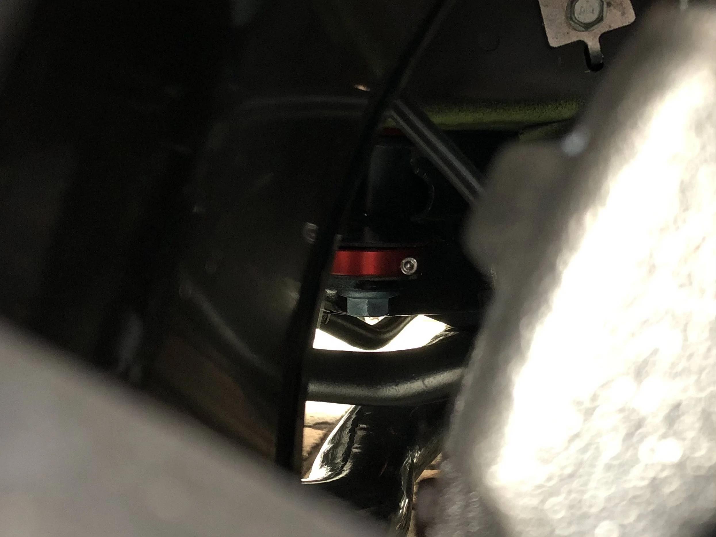

My tech confirmed these were very tight and there was some talk on the forum that they wouldn't go in without marking them, but he managed it without a mark (and I have checked closely) :like:
I think (know) my through holes and extended bolts helped :like:

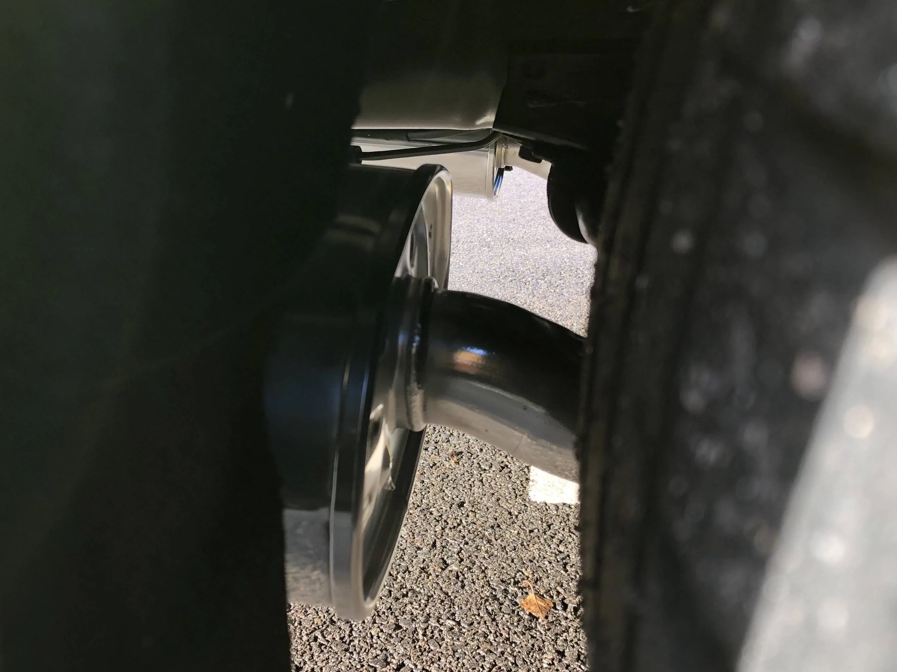

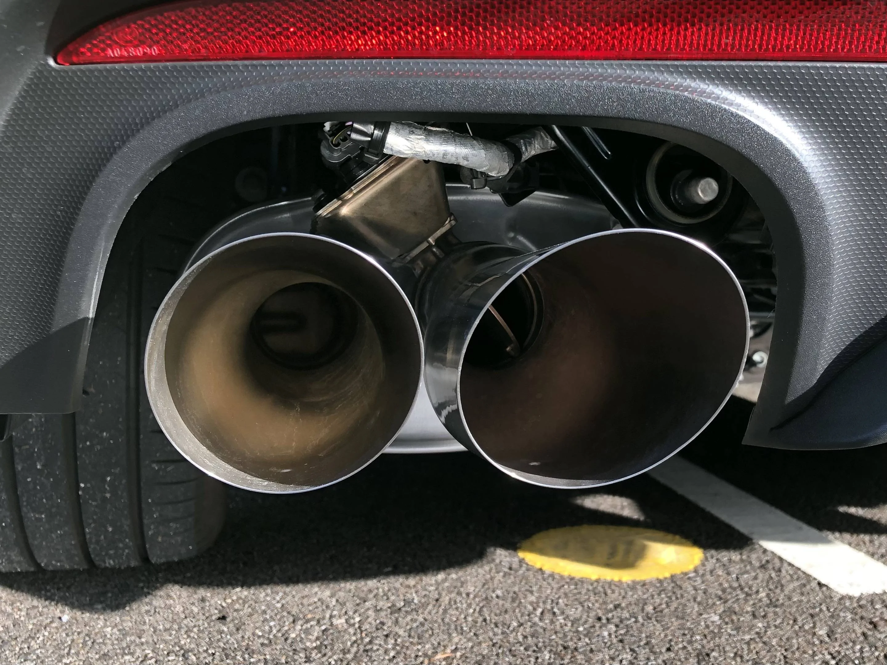

Ref the fitment of the H pipe and Fords ongoing problem with chaffing the AE loom on the UK (drivers) side, here were my mods in an attempt to fix the problem :
A) Shorten the cut line.
B) Shorten the end of the H / X pipe where it mates to the original system.
C) Ensure everything is pushed fully home on reassembly.
Mine had loads of clearance when cold, but it must expand and move around a lot when hot and under torque.
Mine had just started to rub the heat tape :
Repaired with a bit of sacrificial protection :
Rough cut in the right place, then a bit of a reduction and a neatening :
H pipe reduction
That should give approximately 15mm of extra clearance at the back end :like:
So here it is fitted after those two mods - not the easiest of things to capture on a photo … lol
I believe this to be a much better option than the other method of relieving (i.e. cutting away or hammering out of the way) the frame in that area :shock:
Loads of clearance now and the wiring in that photo is very relaxed, it could easily be encouraged to be a little more forward if required.
Tailpipe fit is in my option is perfect, the cut angles fit with the flow of the rear valance perfectly :
i.e. I don’t think shortening the cut point and h pipe compromised the rear fit - and maybe even improved it … :like:
Although the standard pipes have some aesthetic weaknesses, the fit and how they flow with the valance is in my opinion very good and better than a lot of the aftermarket offerings, they just need to look a little 'cooler' - I've not totally given up on some form of tail trim just yet ...
With regards to the sound of the H, it’s the same but different if that makes sense lol ?
From inside the car it’s a bit louder (in a good way), but quiet mode seems little different (which is also good). Defo a few more pops and burbles on the overrun. Rev matching sounds wicked when driving enthusiastically on the blips that take the rpm up to 5k+, it kind of makes the engine sound more responsive / more free revving (I know it not, it just sounds that way) :like:
From outside the car (all judged by my daughter who was in her room doing homework), it louder and smoother if that makes sense ? She said I thought you were home, then it got a bit louder, then some more, then I got home … lol
Cold starts are ‘really’ nice, although defo not the best option for getting a true representation (standard iPhone X microphone and whatever spears you are listening on) :
I’ve not found any drone at any rpm in track mode - I've not bothered checking the other modes yet.
Way more noticeable on larger more open wheels, but one of the reasons I went red (viewed through a standard PP1 wheel :
I am very pleased with all these mods and the service from my local Ford dealer (driven by an excellent tech) has been absolutely outstanding. They have been very accommodating with regards to the warranty repair and then the mods that I threw at them to fit during the rebuild :sunglasses:
I know its took a while to get the broken part :
But that's not my dealers fault. My tech took receipt of the keys from me, took it straight into the workshop and its lived up in the air until he dropped it the day before I collected it. It sat inside the workshop and he drove it out to me when I turned up to collect :sunglasses:
I'm not going to talk about the individual mods, but if you have a specific question just ask - I'm pretty much going to mirror the majority opinion of them on here i.e. defo worth doing and I wish I would have done them sooner ! :like:
Alignment next (although its good from Ford - for a standard setup) and then I will bolt on the IRS braces.

For anyone interested, here's a picture of the diff cover push pin location and the exhaust clamp orientation he was keen to tell me about (additional H pipe bracing and red Steeda front brace can be seen in the background) :
