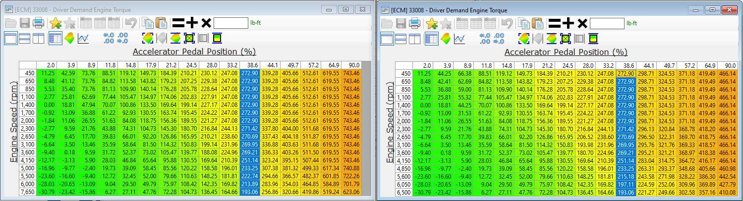

A tuner "can" set the throttle response up to be however you want. You can even give a PD blower the same boost curve as a centrif if you like. Just for fun, on the left is a stock 2020 GT500 and the right is a stock 2019 GT.
Identical up to 39% pedal. If you want the entire table except for 90% to be like a stock GT, you can. I just don't like the "switch" effect that has, which takes away your ability to pedal it at high torques. I prefer the engine to act like it has 700 cid when driving at part throttle, but that's just me.
Now, whether or not your tuner "will" set this up to your preference is a different story.
