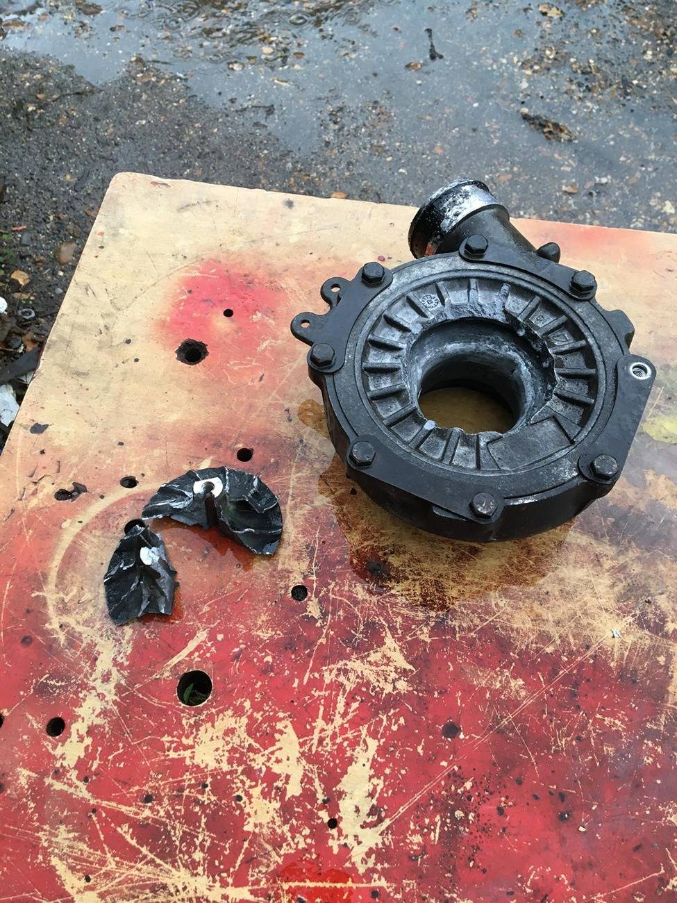

So you want to "get into boost quicker" when there is zero demand for boost.
That's what your setup would have been like that you said you had with no bov! Always trying to produce boost, if you wanted it or not. You'd end up plunging the compressor in to deep surge every time you let off the throttle and you'd break the impeller eventually, like this photo.

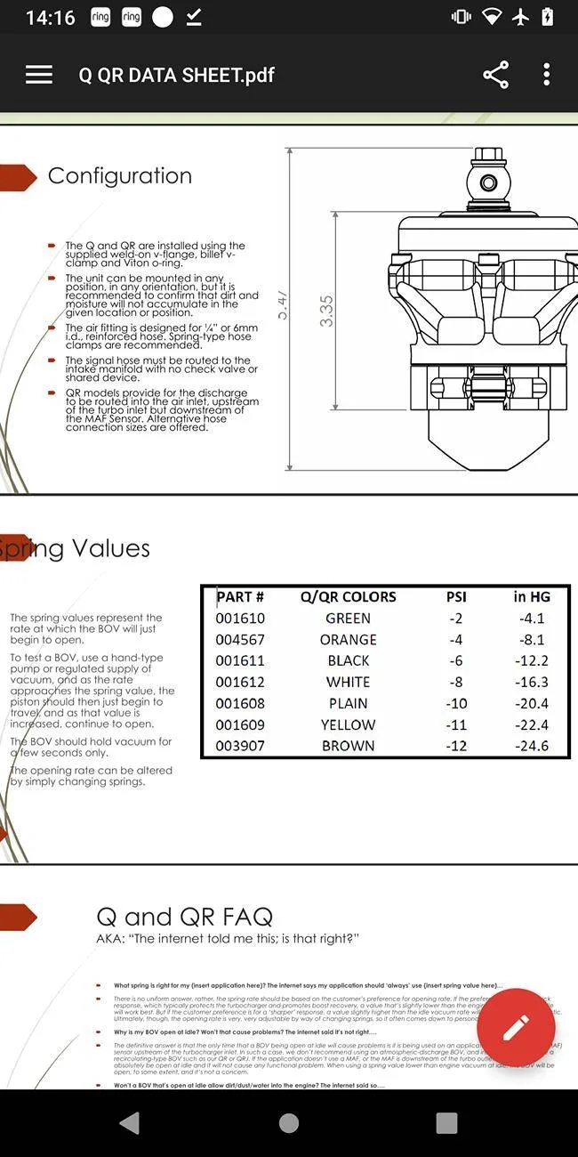

RPM controls the boost
You *can* put a wastegate after the centrifugal if you really want to overspin it and bleed off the excess in a futile effort to gain some lower rpm power
If you're (trying to) do anything with the bypass valve other than letting out air when you close the throttle, you're doing it wrong
Here you are, straight from Tial. Feel free to take it up with them.
"The spring rate should be based on the customer’s preference for opening rate".
ā€œTial doesnt have a engineering degree so this has no evidenceā€ or something along those lines šŸ˜‚
