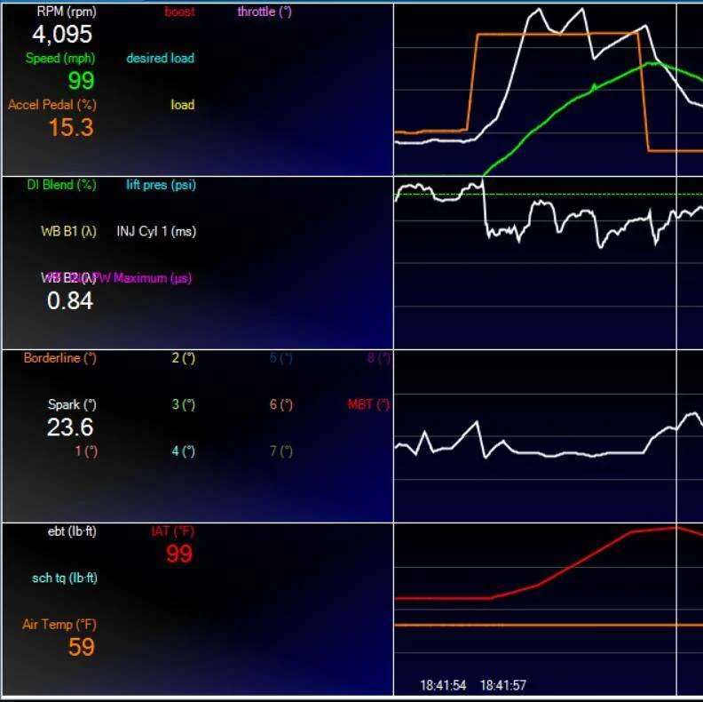

Just some rando posted log on the hpt site. 2015 mustang, procharger D1SC at 10 psi, air/air, 28 deg rise in 8 seconds at 59 deg ambient. All the air/airs act basically the same.
That's actually pretty good IMO. I've never seen a rise that low. But then again I've never ran so little boost pressure.

In this thread actual real world data is thrown out for internet myths. Data that is repeatable, measurable, and quantifiable. Then because of some accolades we must just dismiss basic physics, like water is a better heat transfer medium than air (this is extremely basic thermo, but aero thermo usually makes everything ideal gas and assume pretty much everything else doesn't exist).

BTW on my centri blower I have meth and nitrous to combat the IAT rise, and I generally only have the pedal to the mat for 9 seconds, hopefully 7 soon
