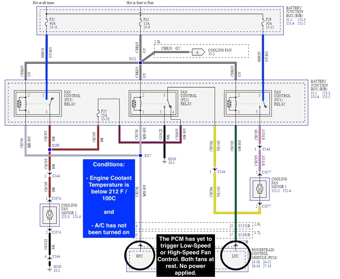

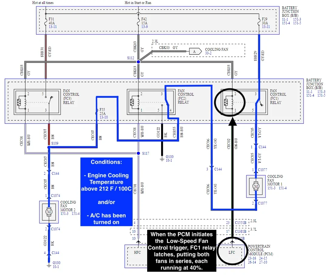

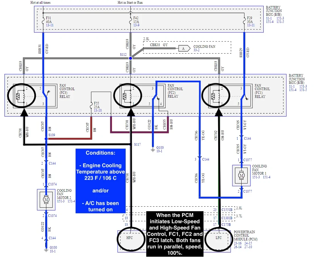

Several variables affecting: a new to the OP car, the state of GA in the Summer, a tune, aftermarket radiator and interior electrical problems.
I'd at least do a good review of all electrical connections, starting at the battery. Just confirm the cable ends are good and secure at the battery, the chassis ground near the strut tower, then do a general review everywhere.
The Sync system rebooting, lights being intermittent and seats not working, those could be their own issues, a system-wide electrical problem or signs of a water-damaged salvage car. Could be anything. The only guidance I can provide is focus on one problem and work towards correcting that. Along the way, you might find more things to resolve or a root cause to all of them.
Specific to the Body Control Module, one thing you can do is remove the cover and physically inspect it. Take a look at the floor, cables and connectors. There are areas in the S550s that leak. Seals in the cowl and door areas. Water in/around the BCM could have an impact on virtually anything.
If the battery is more than three years old, I'd get it checked. In-light of the electrical issues, it might be a good idea to evaluate the battery and charging system, to clear that. You might not know the history of the car. You live in GA, where strains will be higher on the batt and system throughout Summer.
I'd also review the tune with the tuner. Ask if there is anything unique to this tune that other drivers normally don't do. Who is the tuner BTW?

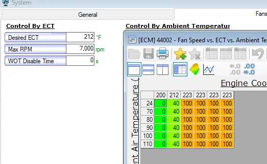

With respect to the temperatures, what you're seeing with the scanner is normal.
What's seen on a scanner and what's seen on a dash gauge are two different readings. That you're seeing a cooler temperature with the scanner is OK. That you're seeing a spread between the two readings is common.

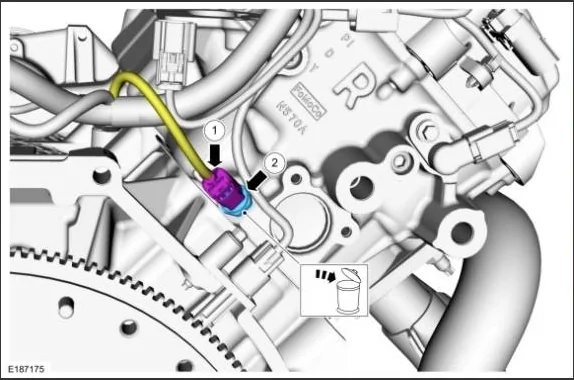

The Coyote engine does not have an Engine Coolant Temperature sensor. There is not an ECT sensor in a coolant passageway. However, ECT is a derived reading present in the Powertrain Control Module. It's my belief ECT is a snapshot, one reference point, of temperature. ECT is generally cooler than CHT, sometimes by several degrees.
In contrast, Cylinder Head Temperature is derived from a sensor in the cylinder head. The sensor is a thermistor, which changes resistance with temperature. CHT is the reading which is displayed in the dash gauge. CHT is a measure of temperature, engine load, RPM, etc. CHT is something of a composite displayed reading. CHT is sometimes equal to, but most often always hotter, than ECT.
If driving normally with a properly operating cooling system, an in-dash display of 245 F / 118 C is toasty. Both fans should have already been running at 100% (starting at 223F) in an effort to cool the engine down. Airflow while driving should keep temps lower. Fans at idle should keep temps cooler.
In contrast, the highest temp I register on a stock car is 220 F or so, the most strenuous being sitting at a light with the A/C on in Summer. Moving and driving normally, temps are in the 190s.
I'd confirm the fans are operating as expected. T-shooting the fans could uncover more electrical issues.. T-shooting the existing electrical problems could identify impacts to the fans. I see powertrain cooling as more important and could focus on the fans first.
There's an aftermarket radiator installed. It's at least the same size as the original or larger, yes?
What happened to the factory electric fans (2)? And the shroud? They are still there, yes? What is their operating logic with the tune? Is it the same as before? Different?
With the aftermarket radiator, how did its installation affect the airflow around it? Through it? Are there a lot of gaps between the radiator body and the rest of the car? That could limit the airflow through the core of the radiator itself.
There's a new thermostat installed. Is it the same temperature as previous?
Is there a proper mix of coolant/water in the system? Too much coolant or too much water can have an effect. Air in the system could certainly have an affect.
Just some thoughts.

There's a chance the CHT sensor itself is faulty. But before considering that, I'd evaluate the other areas first.
