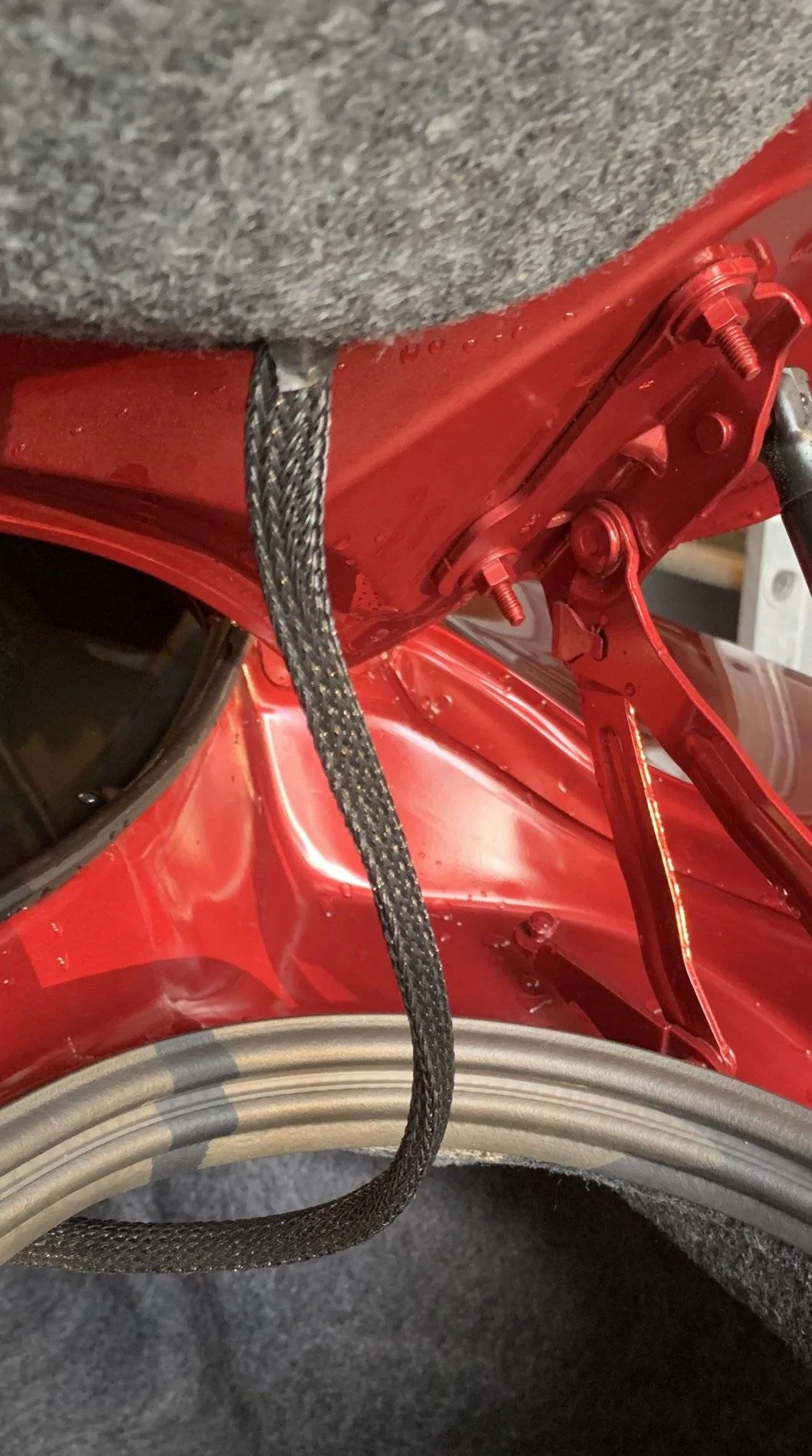

The trunk of my 2015 just started leaking. Figured out it was the cable running from the cabin to the trunk lid/tail lights. Not sure how it’s getting underneath the sheathing but it’s letting in a lot of water. Will try fixing it this weekend cuz I know dealerships won’t be any help and will probably just screw something else up.

The issue I see is that the harness on your trunk lid appears to be folding over onto the gasket when the trunk lid is closed.
Due to that harness being compressed in between the trunk lid and the gasket, it has left what appears to be a permanent impression into the gasket. The indented impression is leaving a void between the trunk lid and the gasket. When the car is traveling in the rain, the water coming down off the rear glass is being forced into the openings between the trunk lid and gasket which is allowing water into the trunk.
The same would be true if the car is sitting parked outside in a heavy rain storm. The water flows off the glass and into the gap of the trunk lid and follows the path of least resistance...
The harness is not supposed lay over the gasket, it has to fold under the ledge of the trunk.
Another issue that will eventually occur is that I can already see your harness conduit is being kinked which will eventually damage the wires within it. Damaged wires will cause loss of rear camera, loss of trunk lid lock/unlock function and a few other interruptions.
I’ve attached a pic of the same area on my car so you can see the difference between yours and mine.
I would attack the issue in this manner if you’re not taking it to a Dealer or if out of warranty:
1) Fold down rear seat backs; using a flashlight lay in back seat area looking up into trunk toward the direction of the problem.
2) Have someone open and close the trunk lid slowly so you can see what is causing the harness to be trapped in between the lid and the gasket.
3) If the harness is too long, pull it back a little at the area under the rear package shelf. Don’t pull it too tight because you don’t want the trunk lid causing any binding when opened.
The trunk gasket should be replaced because it’s never going to rebound back to normal since it’s been damaged from compression.

I think you were right. It did appear to be closing on the harness. I pulled on the harness so it wouldn't get stuck on the seal and it doesn't seem to be letting in anymore water but ill keep an eye on that deformed seal. Thanks for the help
