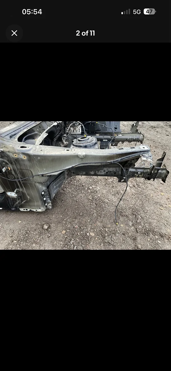

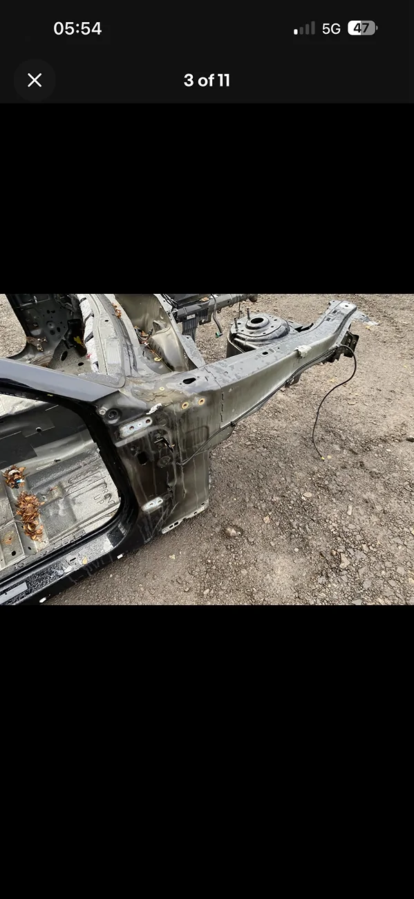

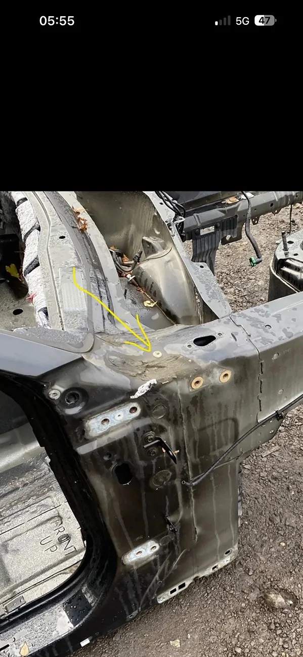

May have answered my own question after scouring the internet for a picture with the scuttle removed. 😅Could only find a deceased one on eBay… seems like there certainly is a raised plug or a grommet that should be in there!
If someone could clarify if it’s just completely plugged or if it’s supposed to be a raised grommet instead it’d be appreciated :)
I’ll attach the images I’ve found anyway

The area you highlighted looks pretty well-covered. As you pointed out, Ford leaves several holes and access ports open throughout assembly. For this specific area, I can't remember anyone writing in to plug that port. But I've got an easy fix though: a Band-Aid, like the kind you use when you nick (as in to cut, not steal :giggle:) yourself shaving.
Clean the area as best you can with alchohol. Ensure it is dry. Affix a Band-Aid. You could also use a small piece of duct tape or something of the sort. If that fixes it, great. You can later go back and use a rubber plug from the hardware store or silicone sealer. Something more permanent.

The area in the OP’s above image, I would not think would be of concern and I’m not even sure if that specific area has any cabin intrusion. To me, that specific area looks like it would follow a path to drain within the inner fender structure outside of the vehicle under the front fender (when fender is mounted).
A-pillar water intrusion will be the areas in the Ford TSB or it’s going to be a breach under the windshield - either by a bad body weld (which has been found by a few M6G members) or poor sealing of the windshield to the body.

Yeah poured water in the hole and it comes out inside the car, seems to just be filling up the door pillar then leaking through a cable push fit clip, same pillar that the door jam stickers fail on and leak through. In fact when you pour water in the hole you can see it drip on the door cable grommet within the body.
Taped it up for now but wondering what that area looks like on someone else’s dry car to confirm :)

The door pillar should not fill with water. My WAG is there's a drain or passage at the bottom that has clogged with debris. Perhaps look from underneath the car to see if there's dampness in the area. Just guessing but plug or not there should be a way for water to pass out.
