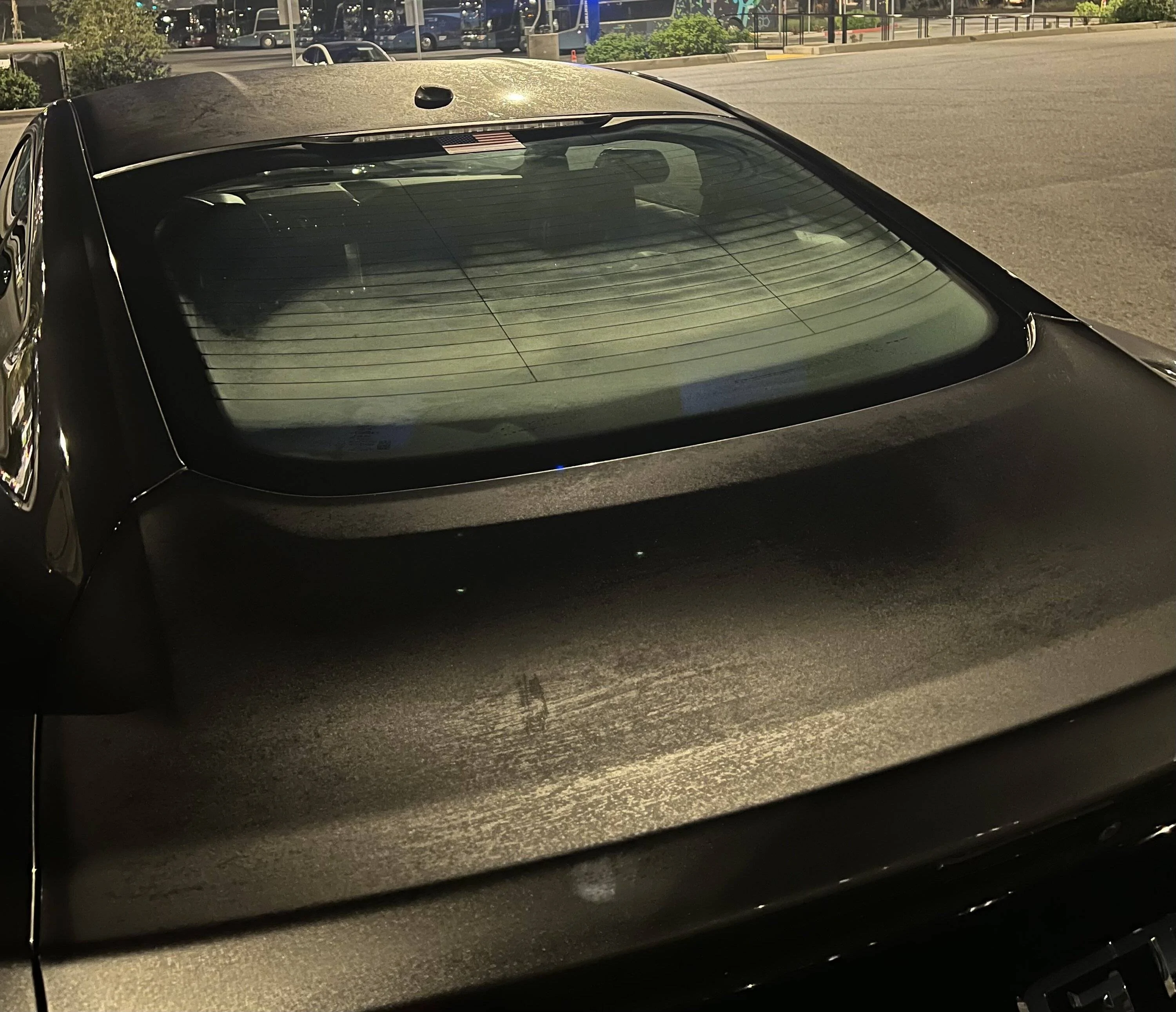

I have a 2017 mustang non convertible and there is always condensation inside the car on the rear and front windows when the temperature drops below 60 degrees outside. It’s only there at night when there’s no sunlight out. The inside is dry, floor is dry and I have a bottle of damp rid inside the try and absorb any excess moisture inside the car. I attached a photo for reference.
Few things to note, I do vape inside the car but I wipe down the windows with windex once a month. I always drive it with the A/C to dry the air inside the car. What are things I need to look for?

That there's condensation consistently entering the car shows an air gap or opening of some kind.
First, establish some kind of baseline:
- Stop vaping in the car
- Use the A/C, heat, fans and vents as-needed
- Get rid of the Damp-rid; it's potentially masking the root cause
- Get rid of the Windex. Stoner's Invisible Glass is readily available and works better
- Do a good, general cleaning of the car inside an out. You might notice something
Once that is done, open the hood, doors and trunk
- Inspect the rubber seals and how the panels close and fit
- See how the windows close, how well the glass seals against the gasket
- Look at the front and rear windows all-around, to see if there are any small openings, gaps, changes in the seam. There have instances of body seams cracking near the window corners
If you have access to water and a hose, sometimes using one in an area of interest can highlight a problem. Low pressure spraying, rain-like or mist. You're not trying to blast the surface.

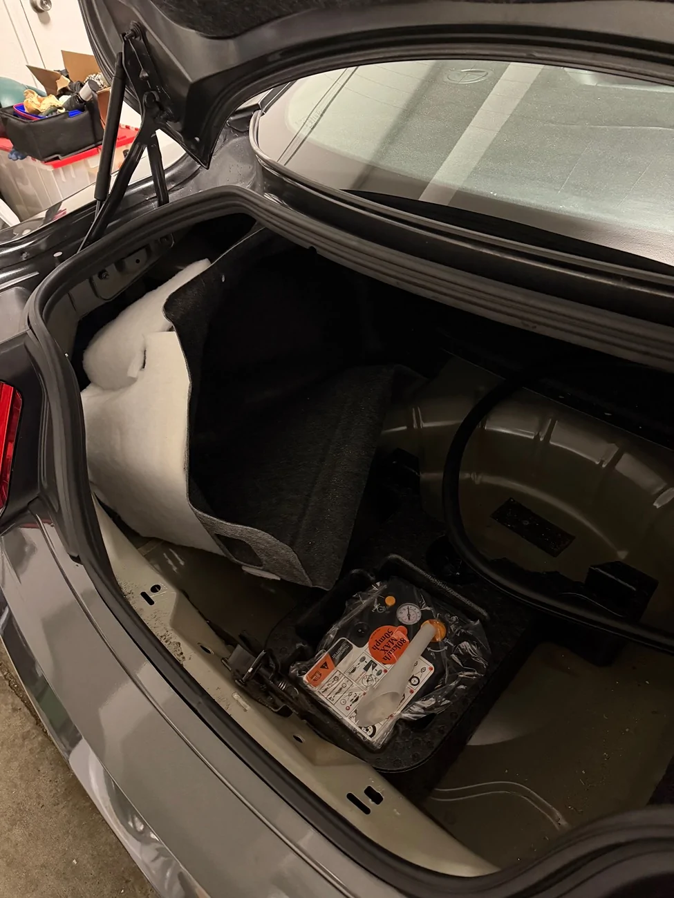

Starting December 2025, I noticed moisture inside the rear window only and decided to diagnose the issue again. I felt like there has to be something in the trunk that is allowing moisture to get in since there is no water inside at all.

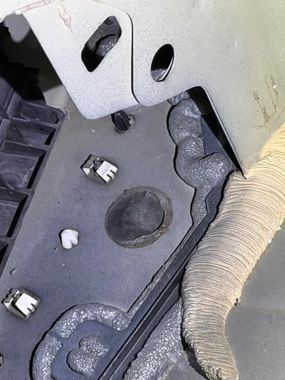

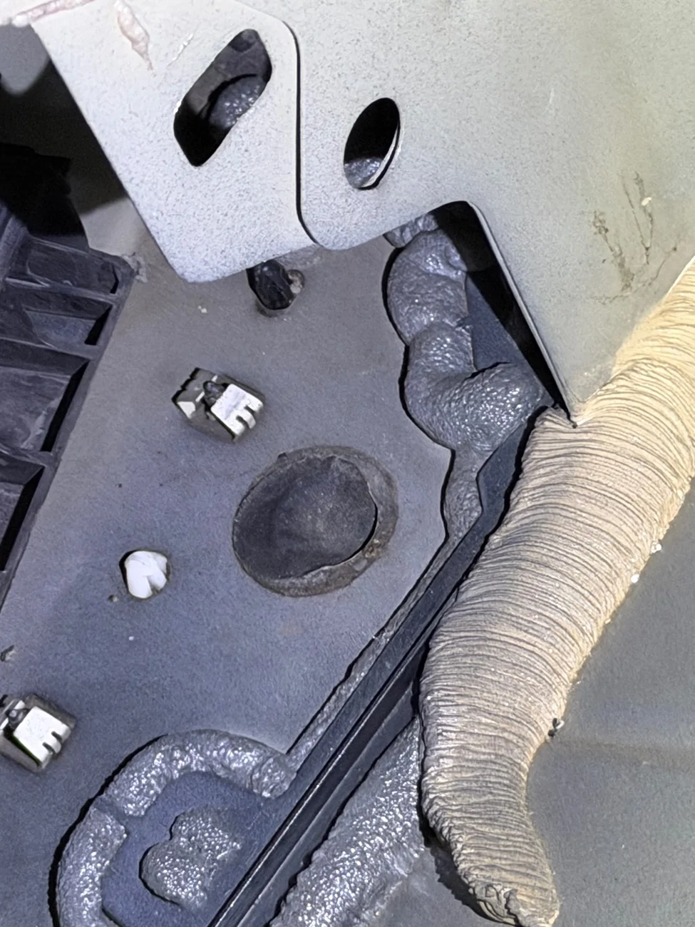

I took apart the panels inside the trunk and found a similar tape covering a hole on the floor of the trunk.
Hopefully after replacing the “tape” with rubber plugs, the issue is resolved. Since I’m already in there, I replaced the trunk seal.
