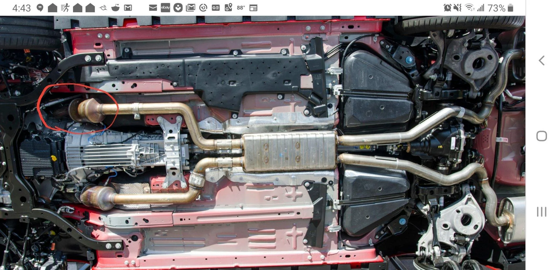

I circled the underbody where I was looking around, and then the second(close) pic is the photo of my actual car.

Are you looking under the pax side?

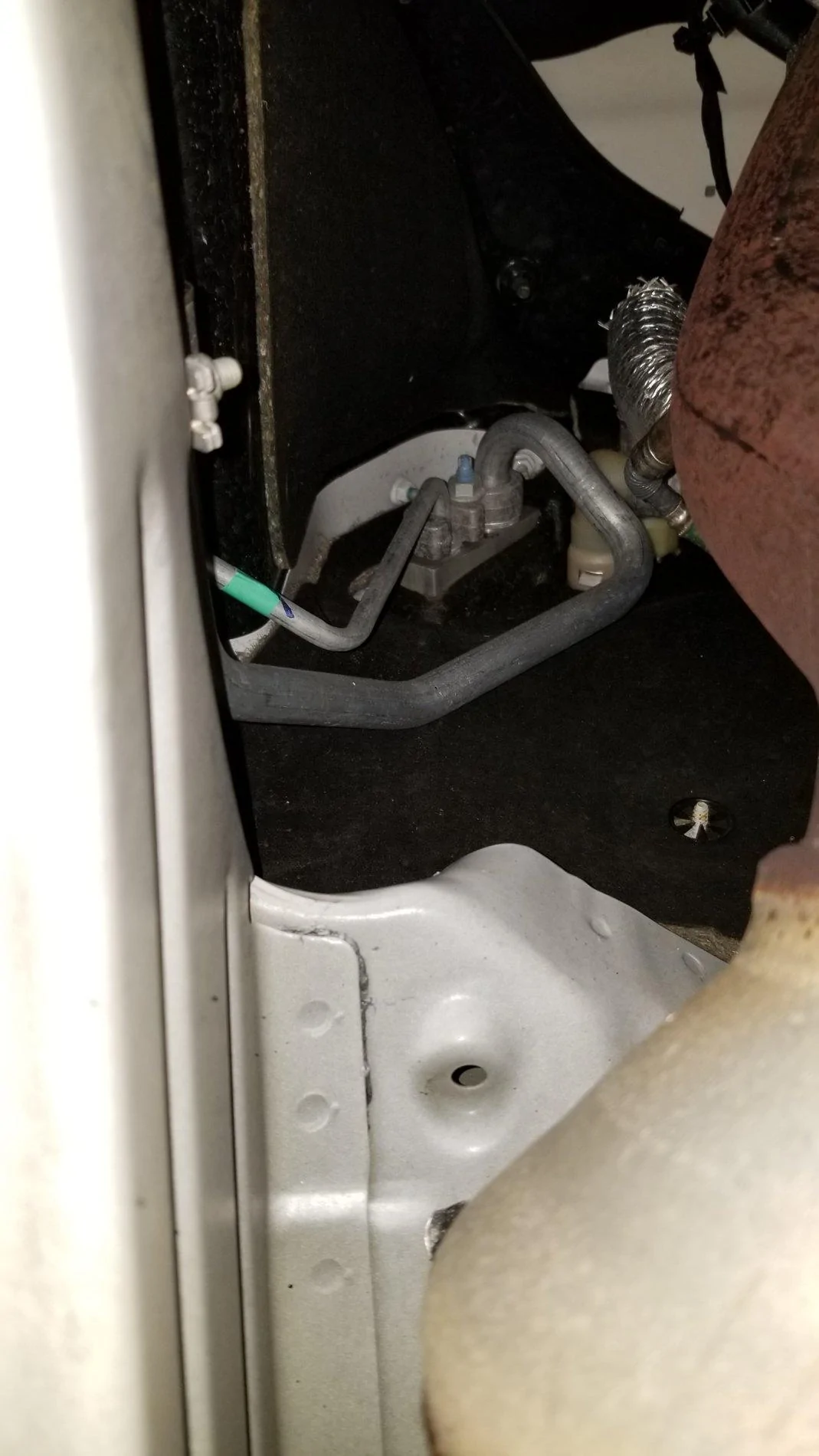

Pax? I am looking under the passenger side,
I can see the AC refrigerant line in/out of firewall, but no tubes. On my '15, it was draining water so I easily found it, but my 17 is none dry, because ac tube is clogged.

The circle you drew looks like the driver's side from the picture.

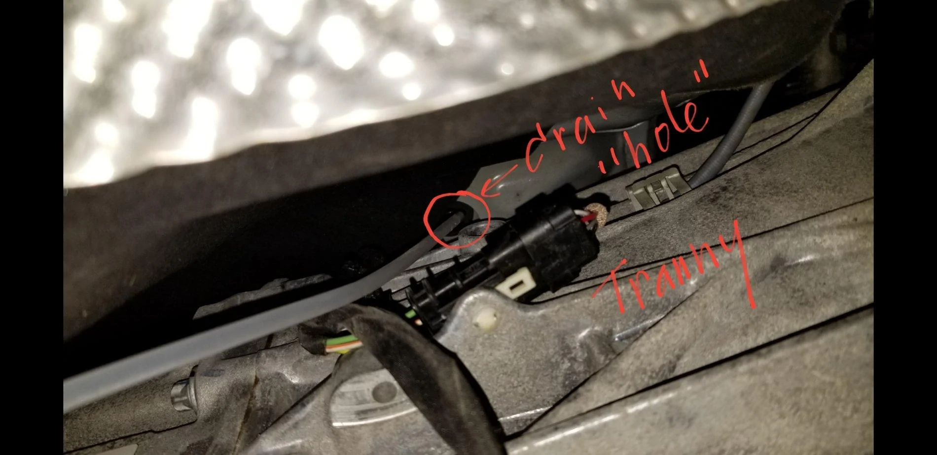

I found it.
It's not near the firewall like some post said on here (and also where it is in most cars)
It is a HOLE (not a tube), on top of the tranny.
I took photos. I'll post when I am done with my oil change, and car wash.

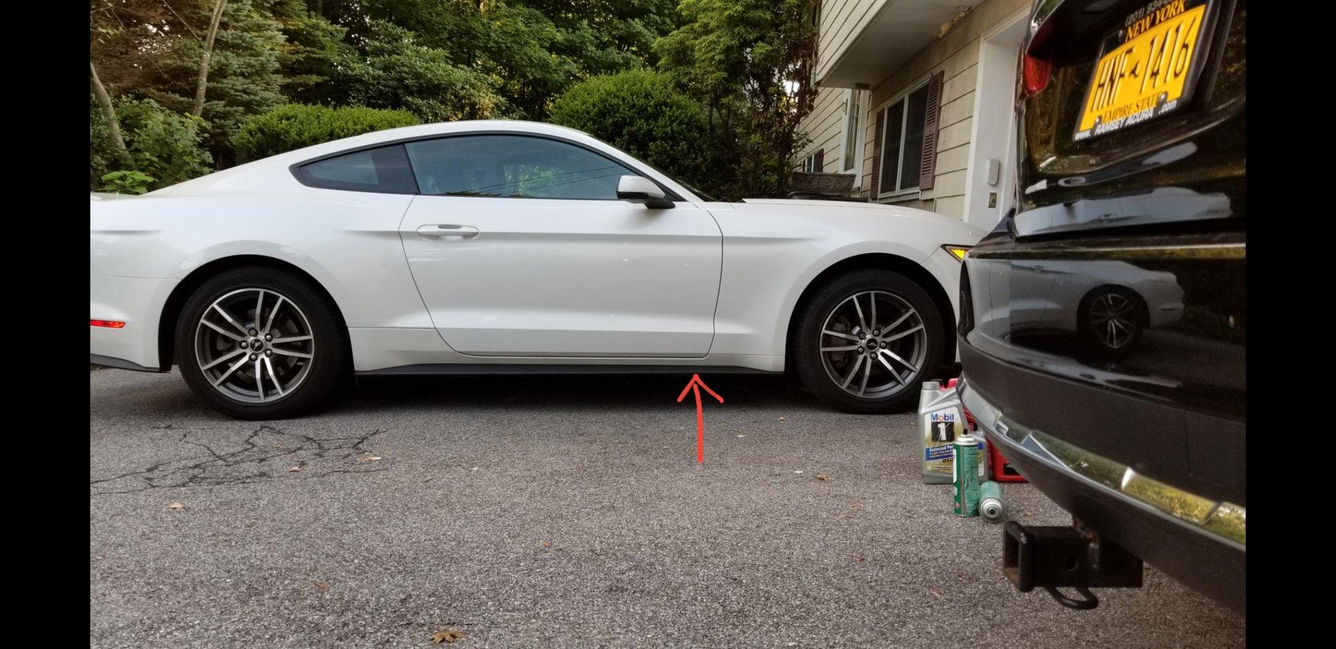

The red arrow shows where I had to place the oil drain pan after hitting it with the kool-it foam.
The first photo is the hole with the kool-it tube in it. The end of the tube is flush to the panel, it is almost exactly in the center of the car. I guess for anyone looking for it, look for the black wire harness plug next to (attached to) the tranny.
And then I remember reading someone saying they wanted to attach a tube, because the water dripping on the wiring probably can't be good.
The hole is deep. The length of tube ran almost entire into it. I had extra tube from the kit I used for my wife's MDX, so I connected the two tubes together.

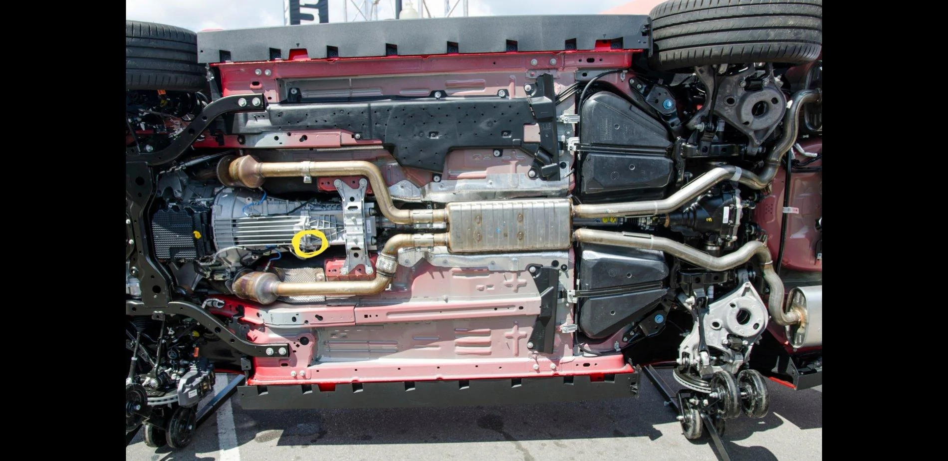

You're right, I did circle the wrong side on the picture.
I have circled in yellow where the drain is. Its above the tranny where the circle is.
Maybe the condensate is supposed to drip onto the tranny housing and evaporate. I think that's why I didn't see water when I drove home and parked it in driveway (engine running) for five minutes.
After my car cooled down, I did an oil change, tranny housing was no longer hot, and when i let the engine idle after the oil change, it created the water spot. I guess the tranny wasn't hot enough to evaporate the water.
Wondering if this means that the wiring connector isn't "safe" from corrosion?
