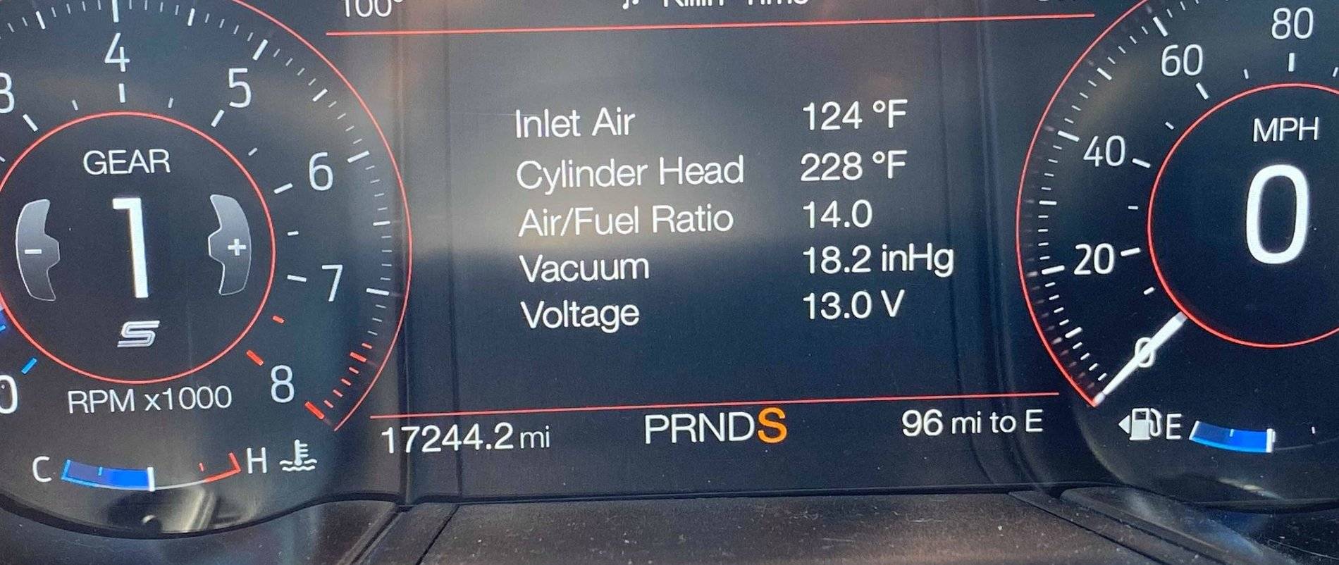

In 100-105º temps in sport mode and pushing it a bit this is about where i sit. I wouldn't worry about it at all. Most people i know with dodge products, their cooling fans do not even come on until mid 220s. Makes you think something is wrong, but i assure you it's fine. The cars are smarter than us when it comes to what they can handle.. and if it were to overheat, it goes into a fail-safe mode to protect itself.
how do you display inlet air, cylinder head, etc. like that? I can't seem to find it . thanks
If you have the digital dash, its under gauges > show gauges when you press the Mustang button on the steering wheel.
I got to the show guages, but it display the 3 guages I selected. where to select to display those listed instead of the guages?
Use the up and down arrow after that.

Actually the DOWN arrow. The up one is for the G-meter, and they don't cycle, so can't go from the G-meter to the numbers.
