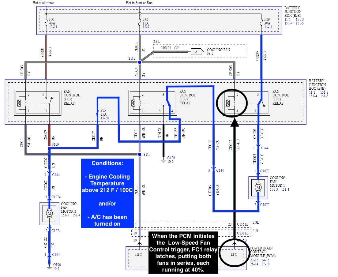

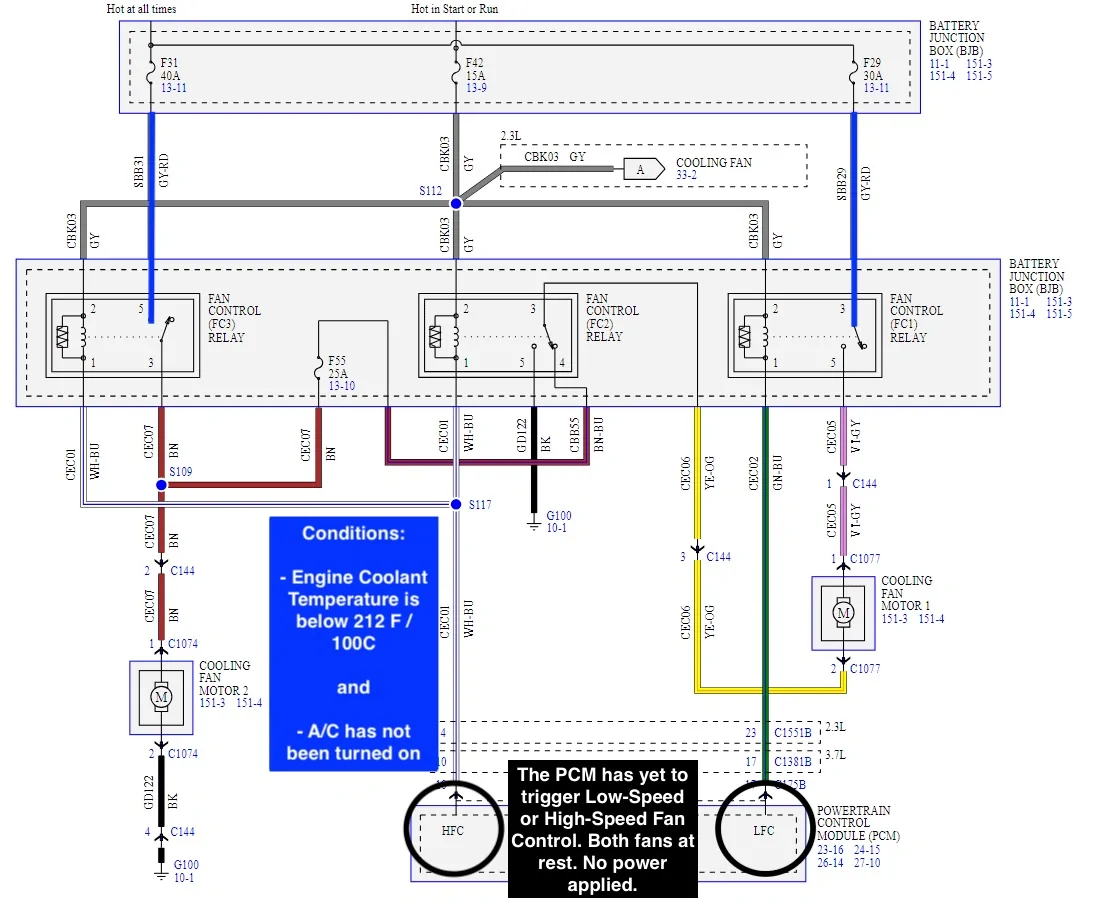

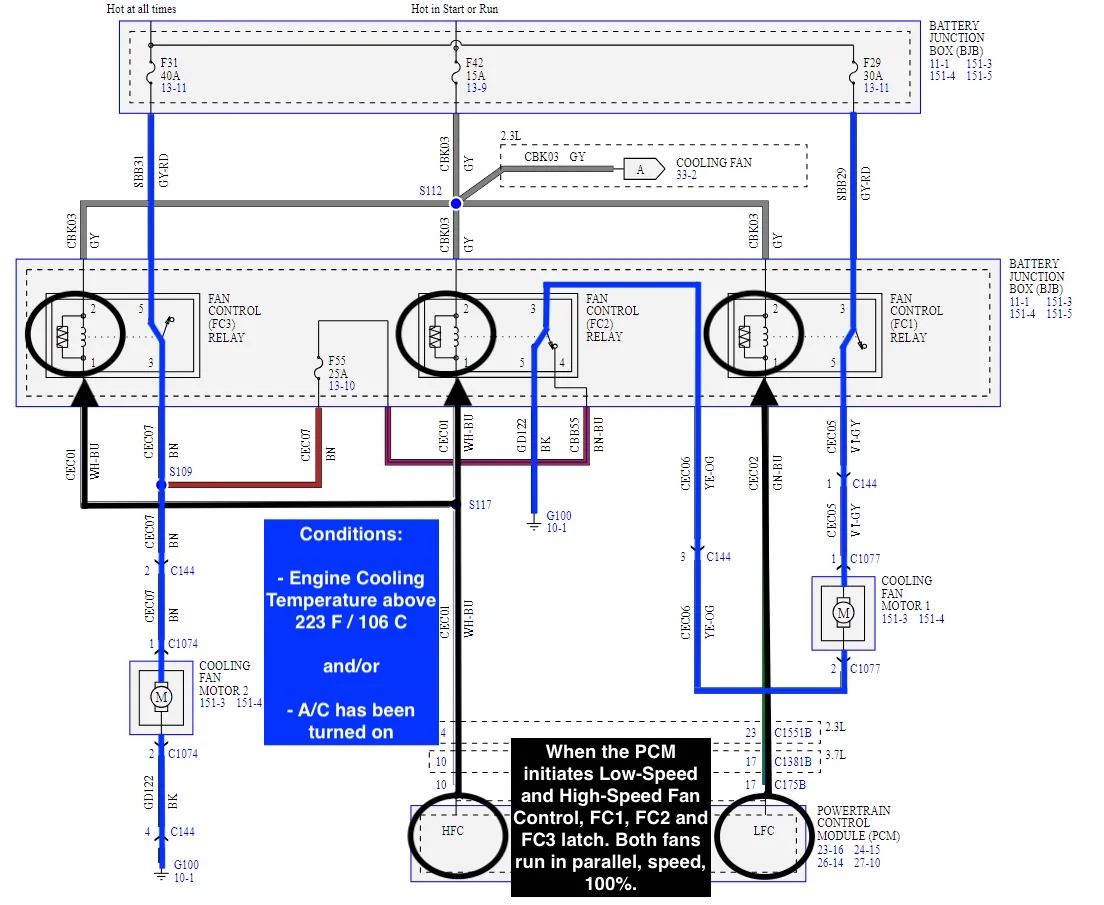

If you're seeing 230 F / 110 C, how are the fans doin'?
What are temps when idle, in traffic?
Temps when driving "regular"?
Temps when driving spirited?
And yes, the nature of the car, how used, its history and physical setup.

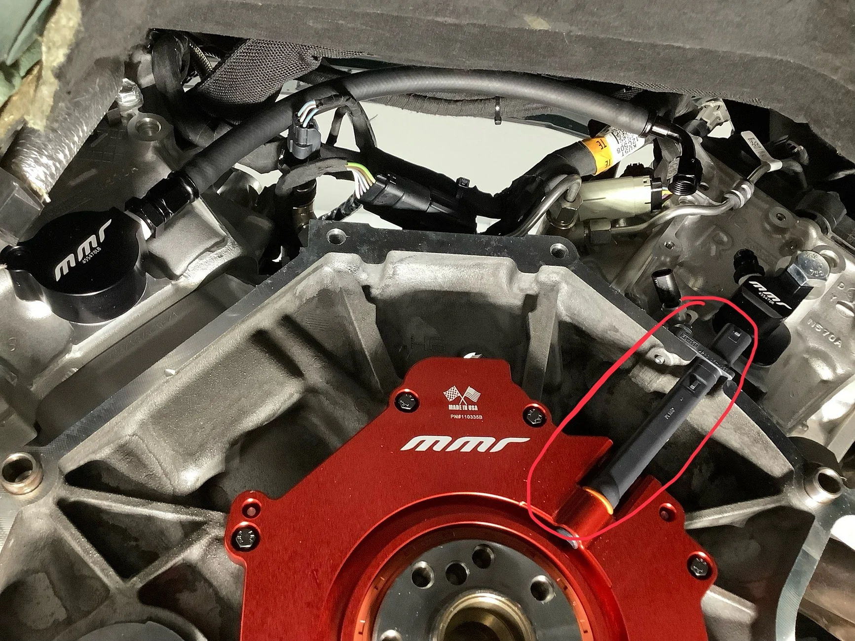

None of the suggestions are going to help. Get a cylinder cooling mod or head crossover kit. The cht sensor is in the wrong head in the back where there is not a lot of coolant flow. The kit fixes it

I also have the head cooling mod too. I haven’t done any testing on it though, but figured it would be good insurance. Something I’d like to point out about this mod is, it would be next to impossible to do with the engine in the car. Either the e fine or the tranny must come out. I took the opportunity to install mine during a tranny build.
