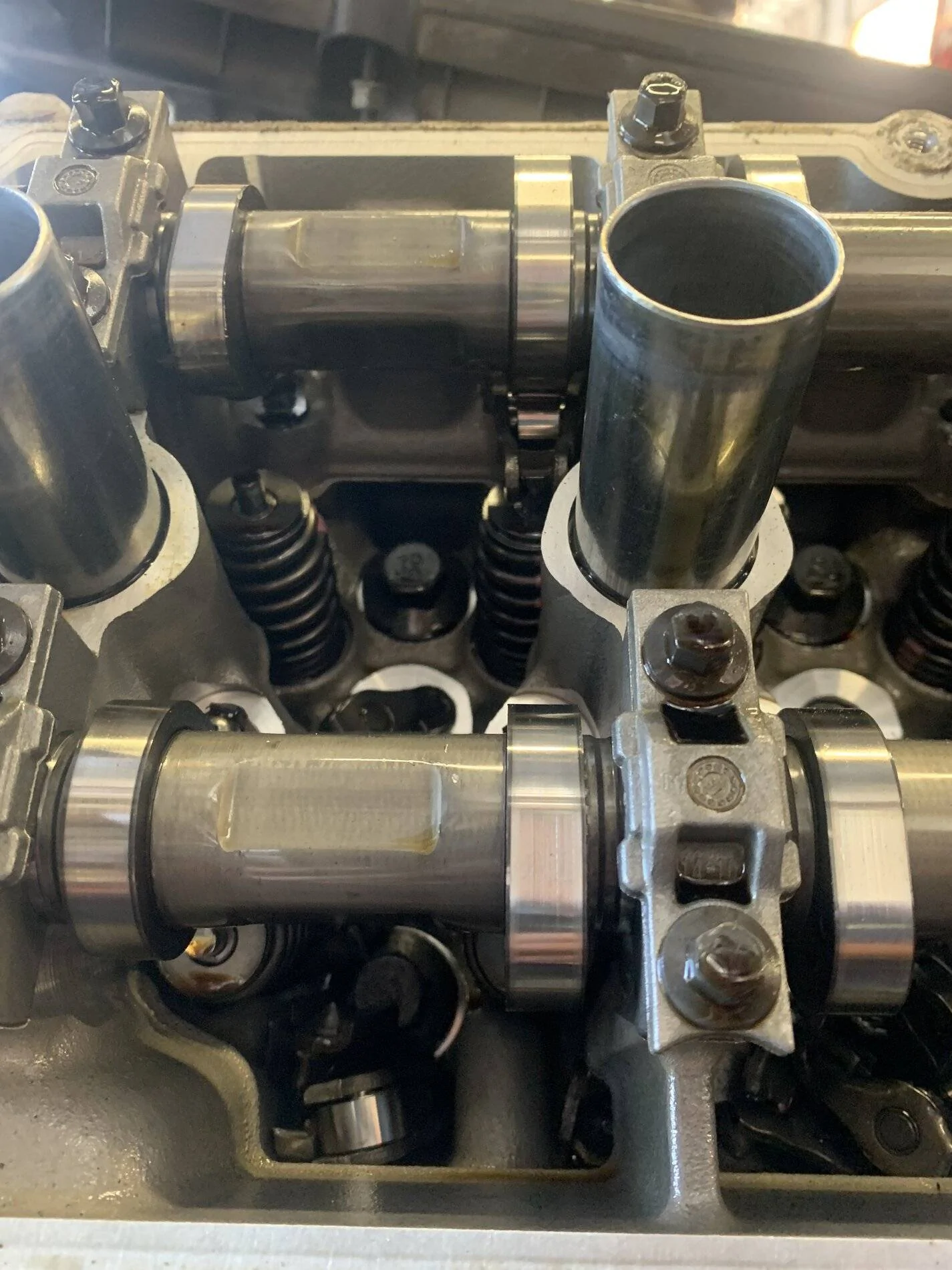

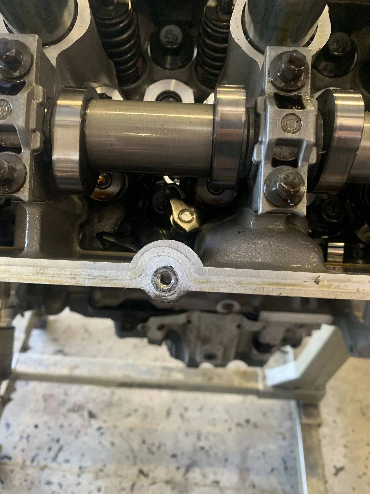

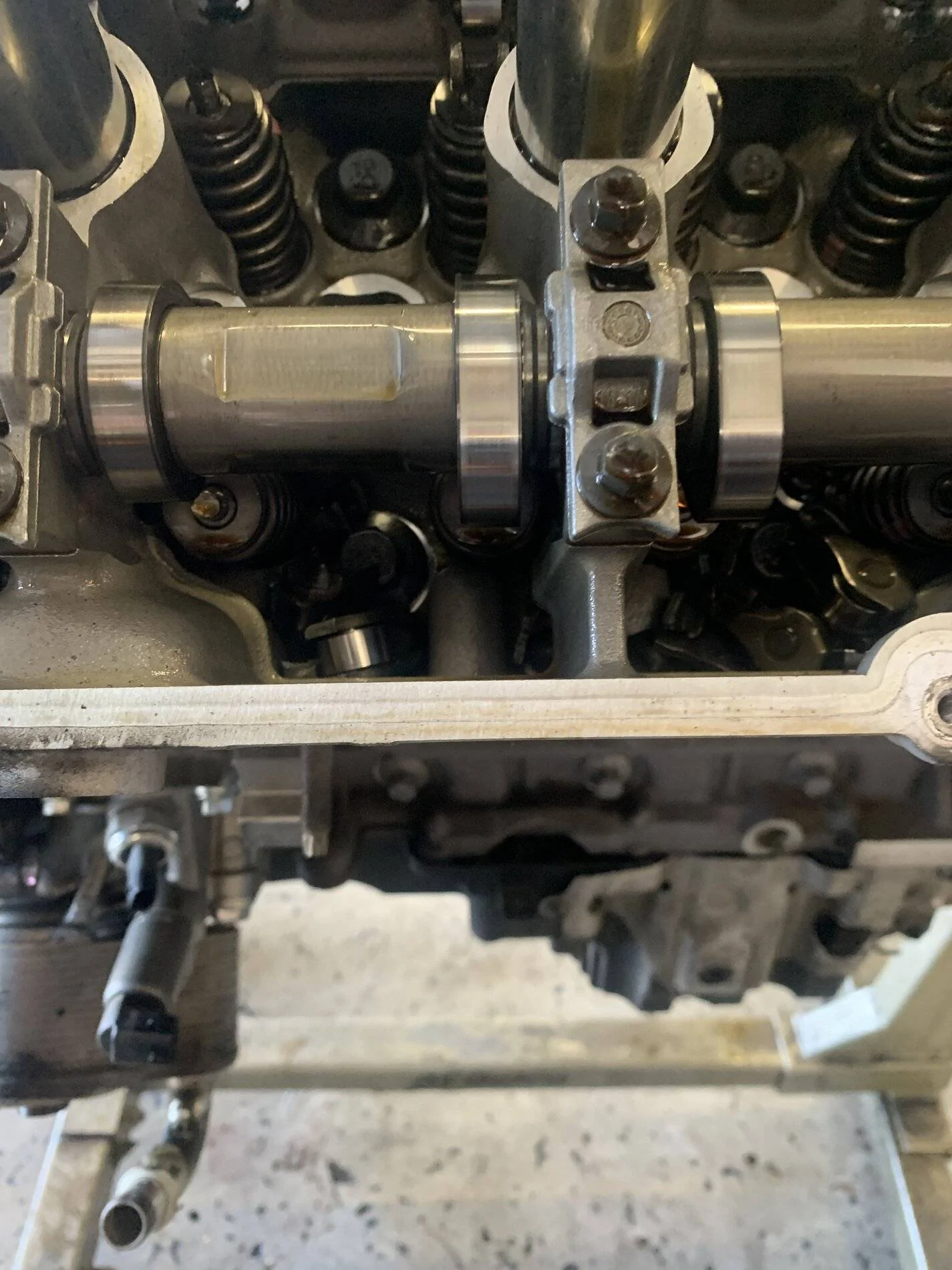

The damage is worse than I thought. I got the motor out today and pulled one of the valve covers to find every rocker arm broken. I’m thinking I may have to get a long block now.
Sorry man .
Been there twice .
first time was my 2012 GT with 2.9 whipple and 20 % OD ATI damper . Heads were trashed .
More recently one of my 15’s -Hellion TT with stock size ATI damper . Expensive GT 350 heads too . Multiple broken rockers and cam caps/bent valves .
MMR could fix them but by the time I shipped /bought new valves decided not worth it .
used GT 350 heads as core for new GT heads .
$850 OTD
Good luck on the rebuild .
