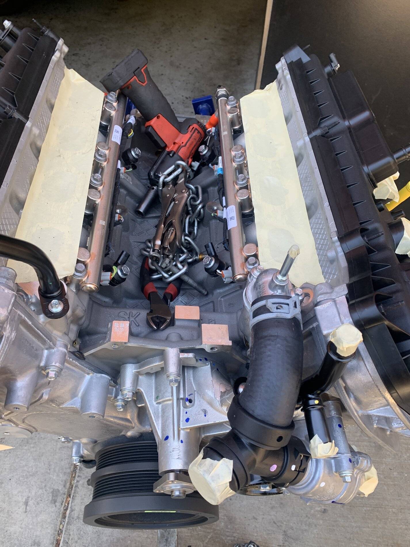

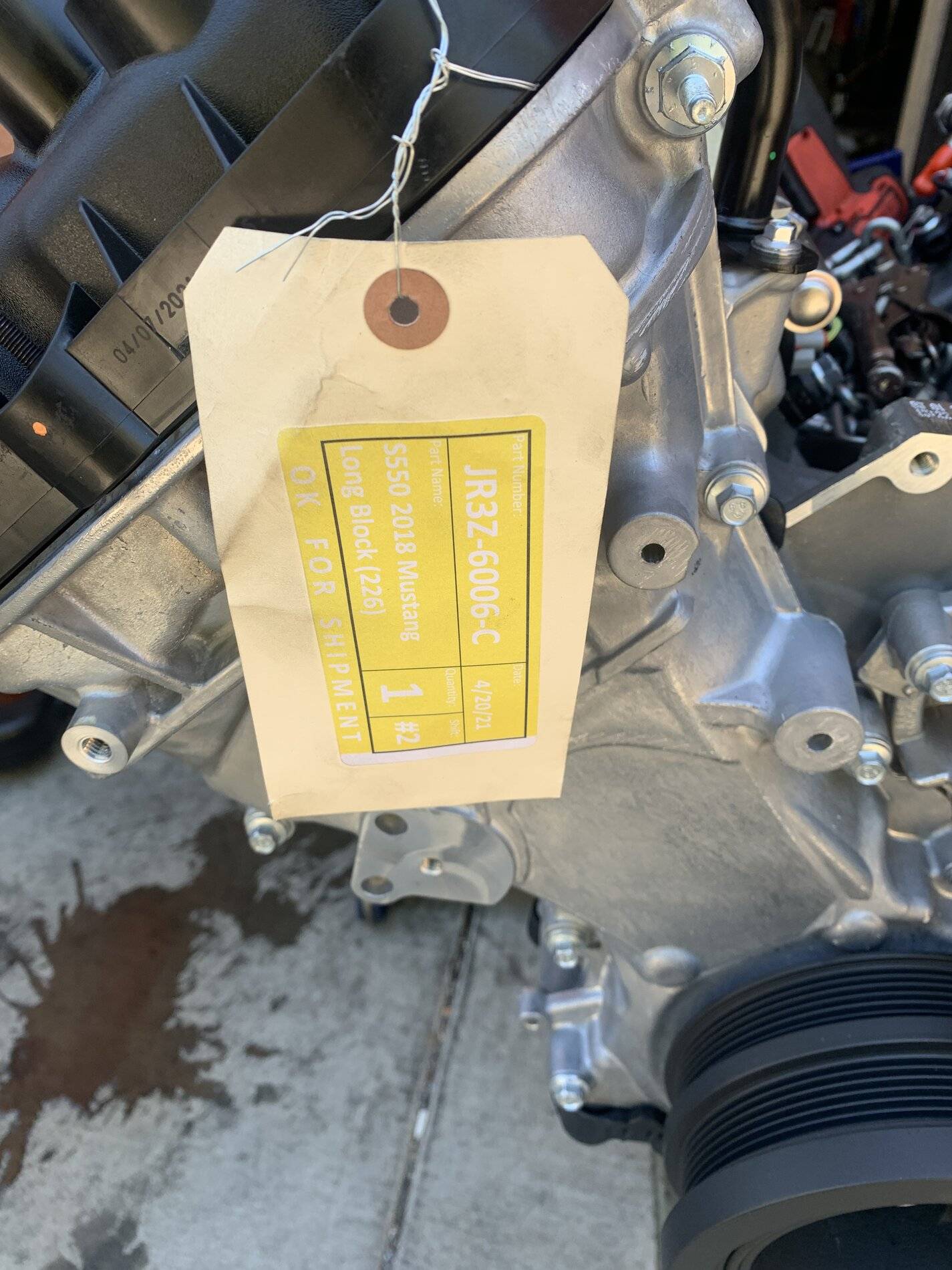

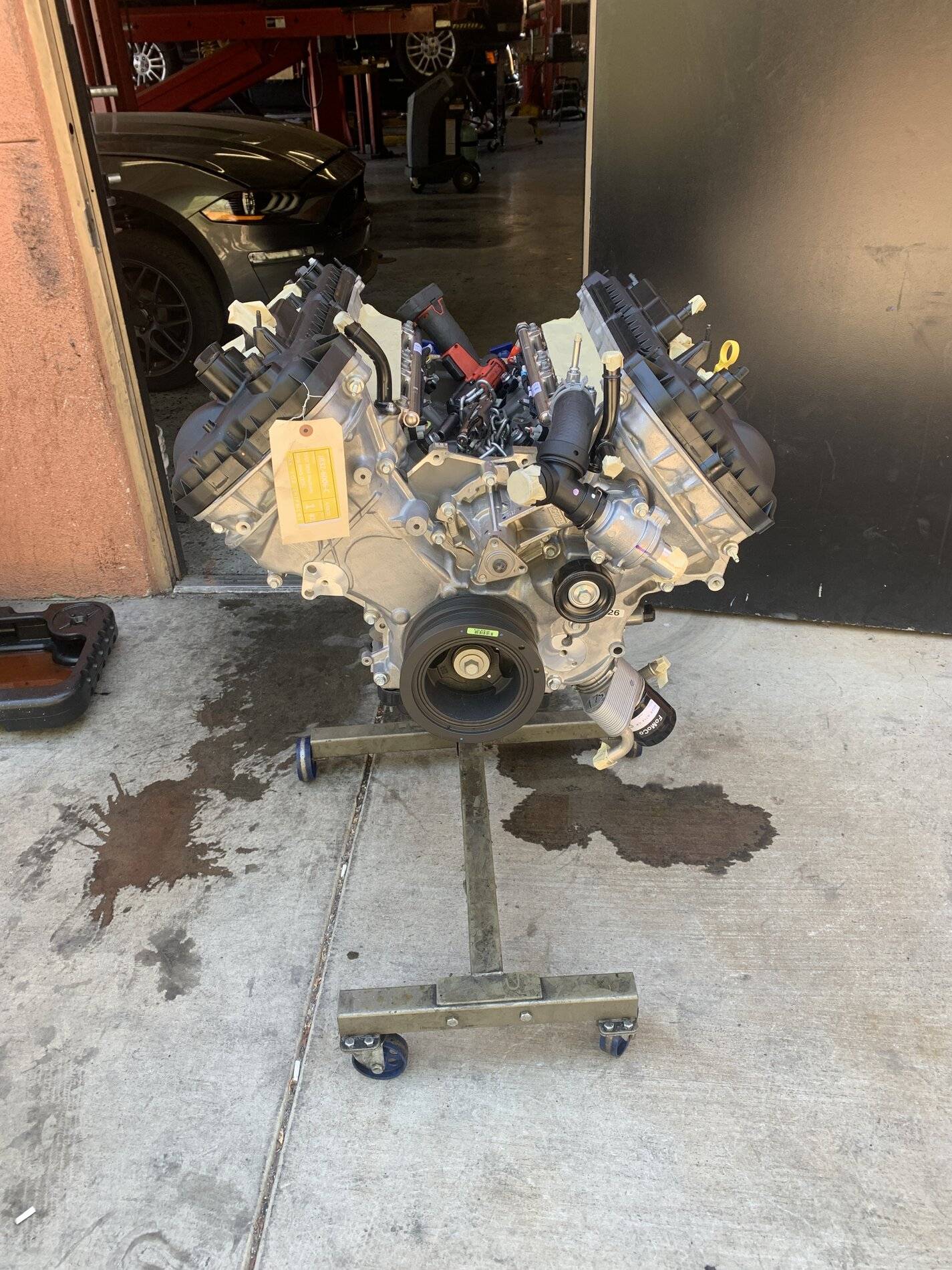

New long block showed up today. I’m surprised that it came with all the sensors and new di injectors. Just waiting on my opg’s to show up and a couple of other goodies and it should be good to go!

$4’600 out of my pocket! It stings a little, but I’ll be glad to have it running again.
