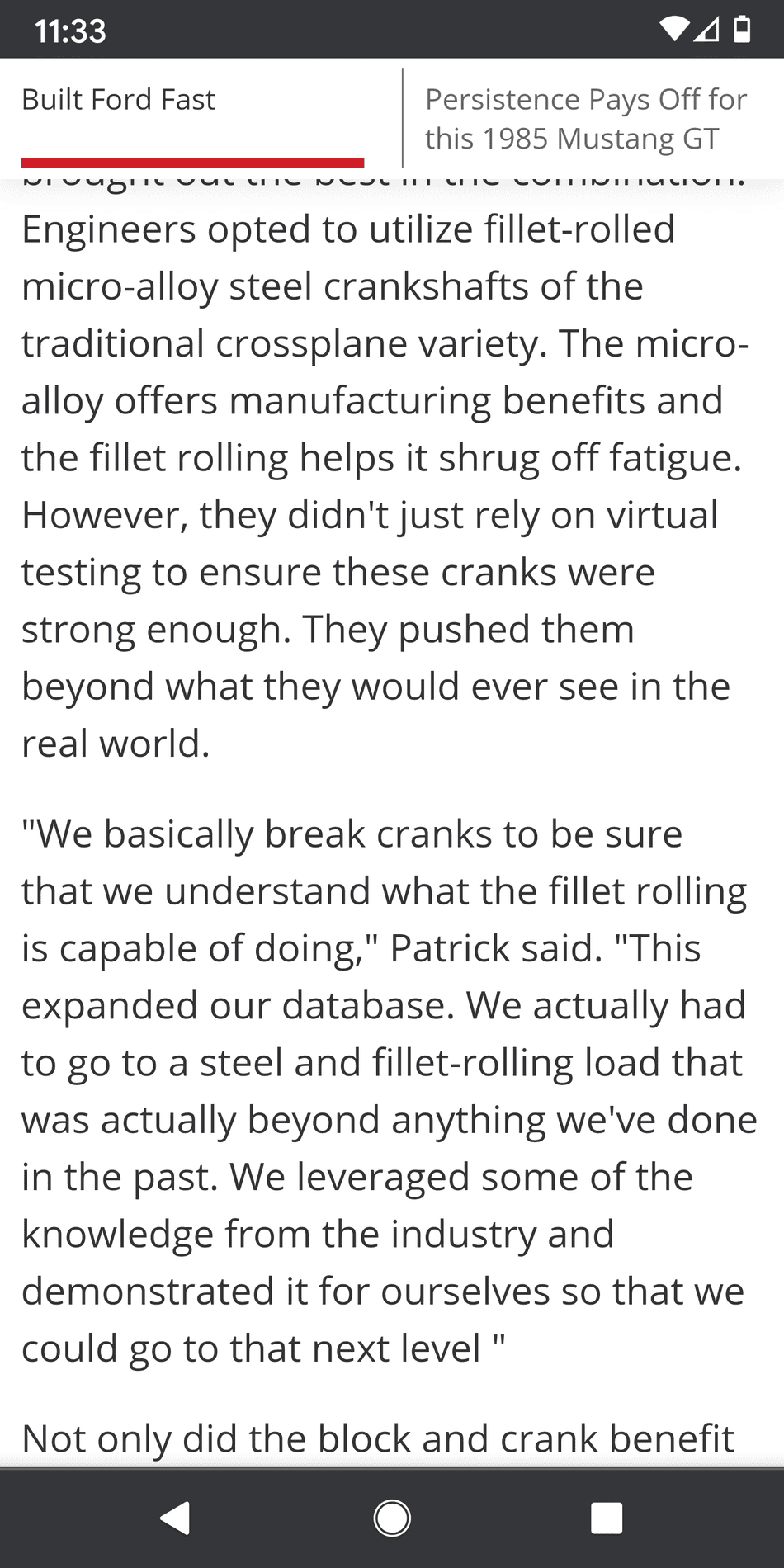

Insider info says Predator crank material is 44MNSIVS6 . This micro alloy is used by other manufacturers in boosted engines.
Thanks . I just increased what I would ask for my predator/5.2 crank short block šŸ˜Ž.... if I ever sold it
Also wonder if the voodoo 5.2 crank is made of the same material ?
I know fewer numbers and even fewer boosted or paired with aftermarket dampers but not heard of any broken voodoo cranks ...(not that means there have not been any )
Article says material has not been used before...

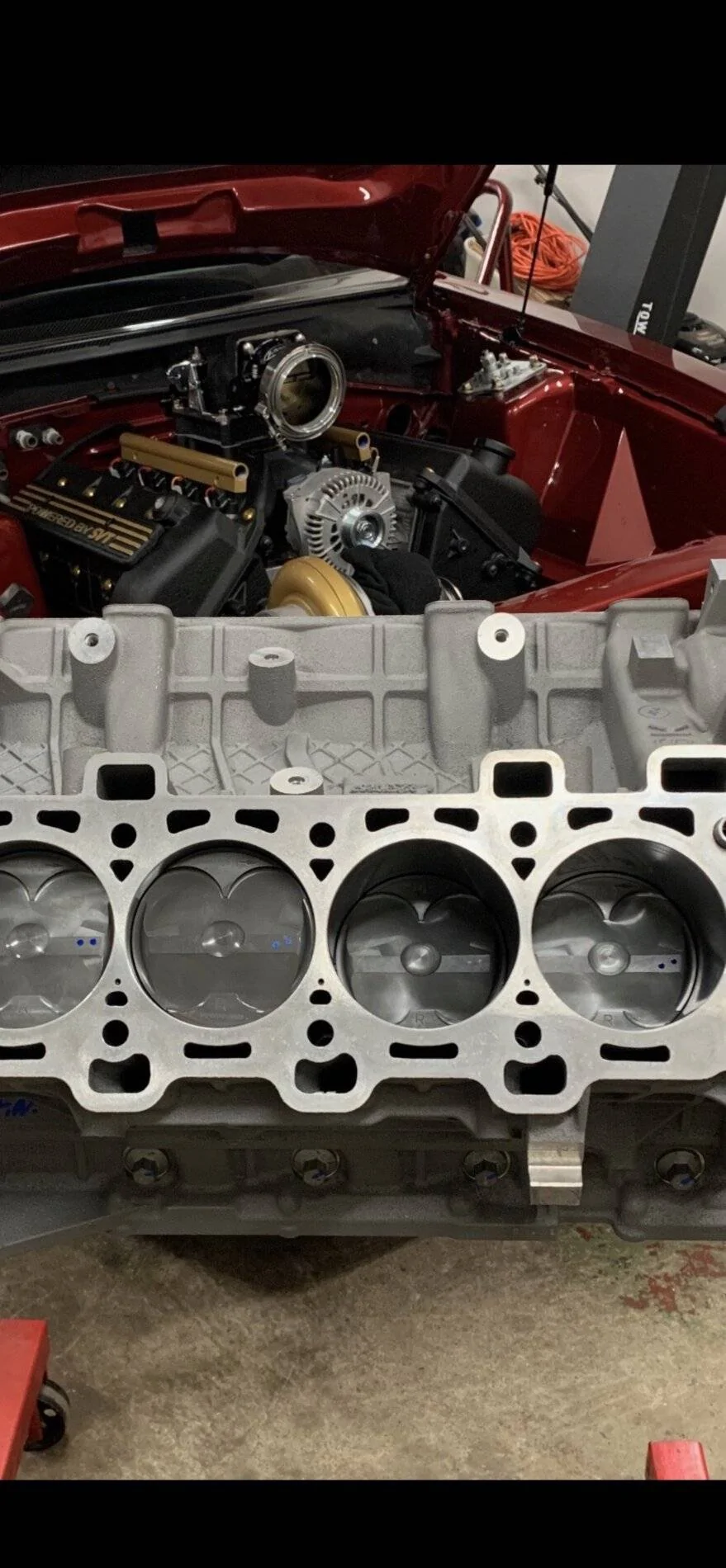

@TKM Conbread what kind of voodoo shortblock failures have you been seeing? Any snout failures?
TGGT
TGGT
Jul 29, 2018
64
915
377
SoCal
2018 mustang gt
Factory short block, crank support, balancer, stg2 pulley and various gaskets are in route. I almost have the motor out so I can further assess the damage. I’m doing it at work so I kind of have to chip away at it as time permits. I’m hoping to have it back in the road in 4-6 weeks
