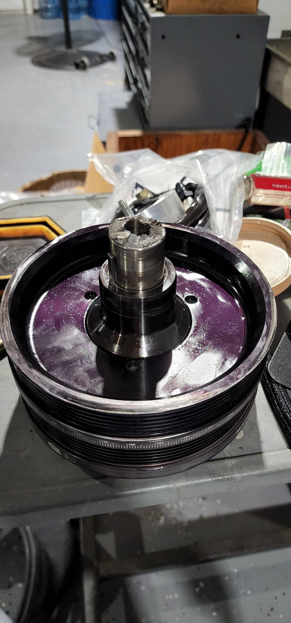

I’m running an ATI with no problems and would recommend it over stock. The key is a proper install.
Yep. People having issues with ati balancer is likely install issue. I've had ati balancer for almost 20k miles. Rev to over 8k. Ati balancers are on everything in motorsports. They are in every nascar car. Think about it.
Yea I never even knew this was an issue until recently. Perhaps I will have the shop that built my motor double check the install of the balancer just to be safe before I get tuned.

I'd imagine 99.9% of engine failures attributed to having an ATI on were due to installation error.
With that being said, I had a lengthy conversation with Ford Performance technicians before ordering my aluminator and was advised the stock aluminator balancer would be fine for my whipple setup spinning to 8,000 rpm.
With that being said, I had a lengthy conversation with Ford Performance technicians before ordering my aluminator and was advised the stock aluminator balancer would be fine for my Whipple setup spinning to 8,000 rpm.
And yet FP runs an ATI balancer on their Cobra Jet. Sure it's fine for you but he may have been just trying save you some money and not trying to imply the ATI was a bad balancer.

ATI balancer requires installer to take measurements of the crank snout, and hone to spec before install. Most people don't do this causing undue stress on the crank snout. Some get away with it, and some loose there crank. It has nothing to due with the quality of ATI balancers really.
