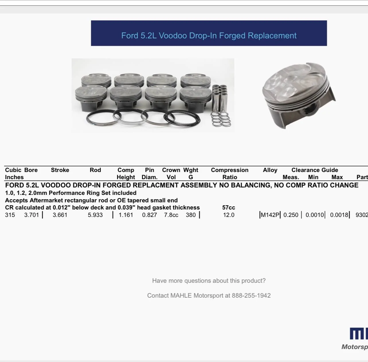

If the stroke on the predator crank is longer doesn't that mean more compression? I'm a bit confused I did tell them It will be using gen 3 heads/stock cams
yes , if you use coyote piston which has a higher CH
compared to the voodoo piston. .
JE/Diamond/Manley make aftermarket 5.2/ voodoo spec pistons - with the shorter CH
If you use those pistons with a boss crank(like i have in my 18GT ) you will have lower CR.
