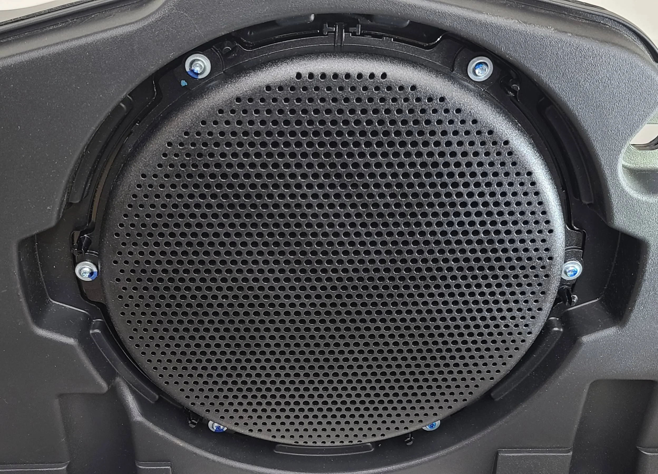

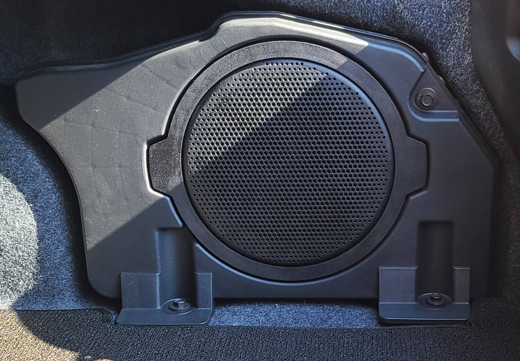

I'm going to preface everything by explicitly stating that I am by no means an audiophile. Years around jet engines and open/racecar exhaust have killed my hearing. That being said, I love music, and after my house and my job, my commuter car is the next place where I spend most of my time. So, after reading through the thread, I decided to upgrade my ride.
Well, here it is...the last time I'll see the stock sub in my ride.
I managed to pop the ring off without breaking any tabs.

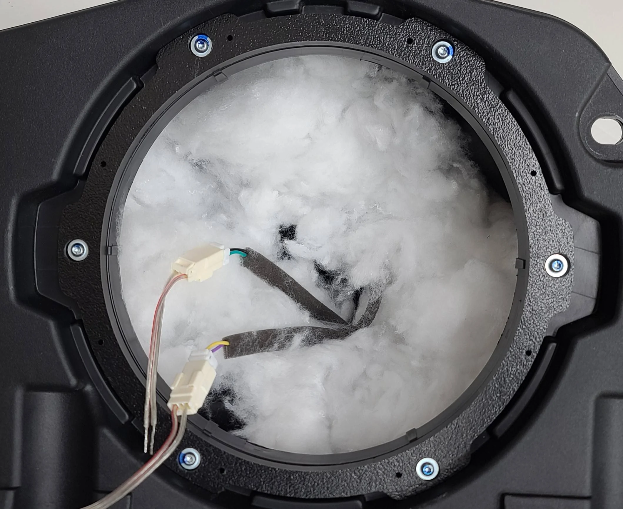

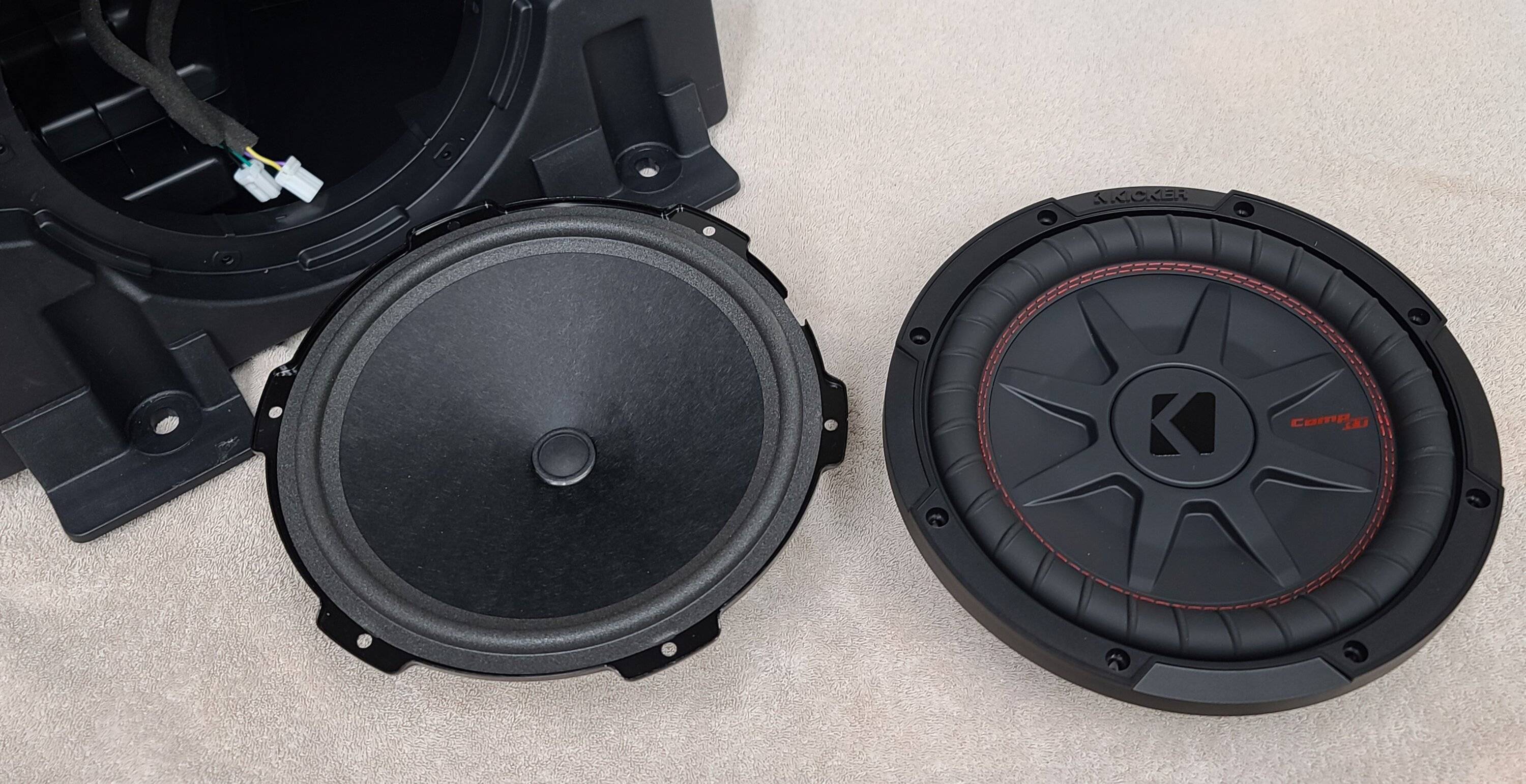

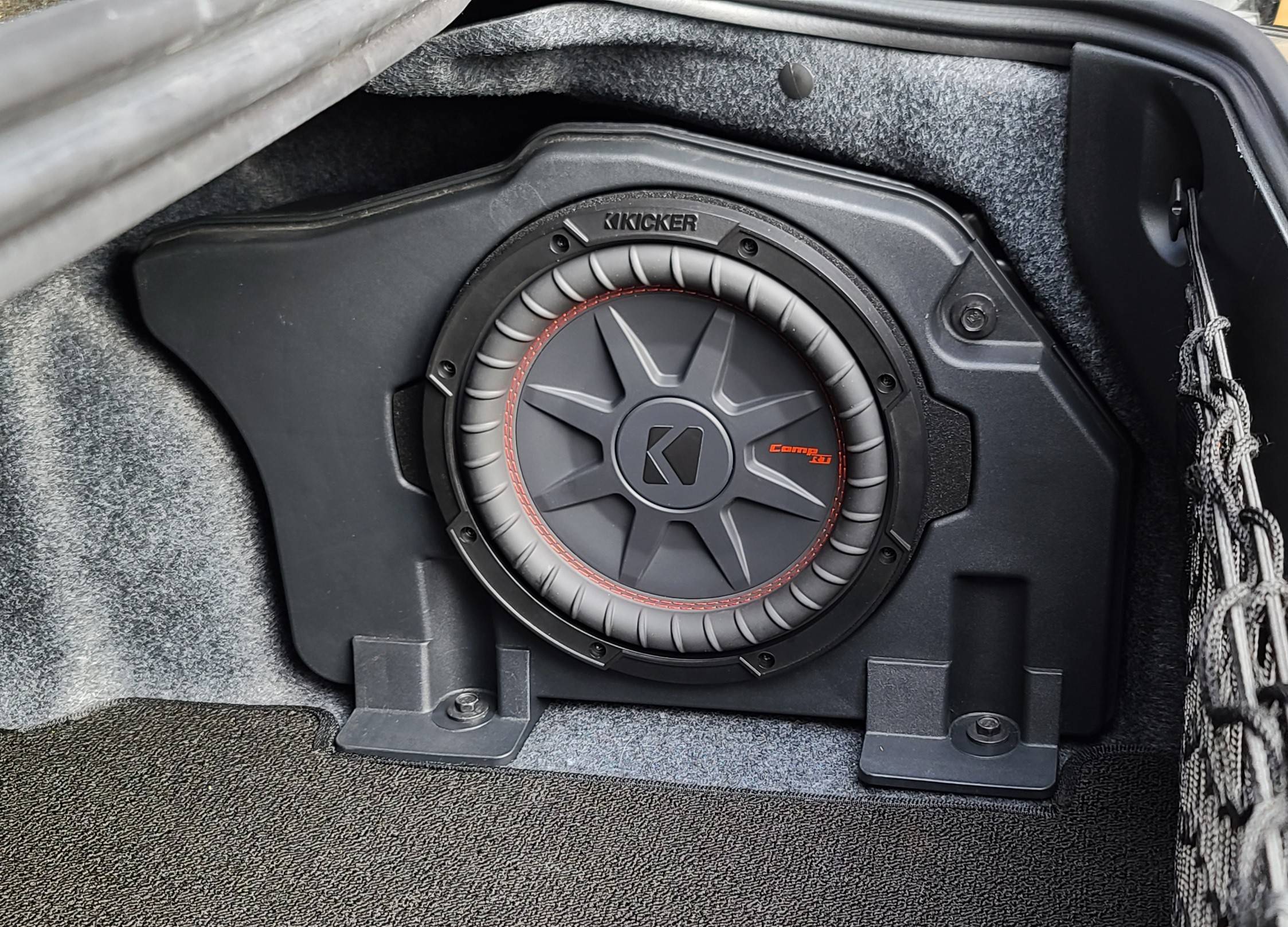

Here's the sub I decided to go with... the Kicker 48CWRT104. It's a 4 ohm dual voice coil but it does not fit without some modifications.

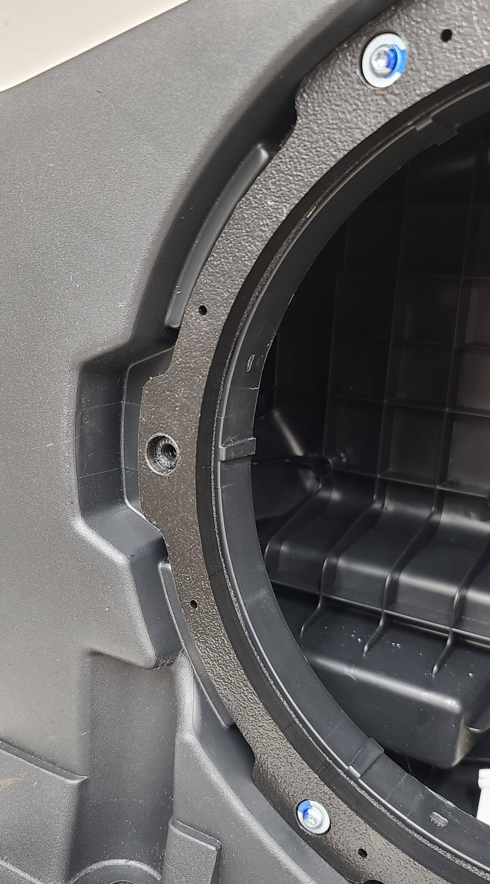

I started by grinding down the tab on the enclosure that is at the 12 o'clock position. Then added some acoustic foam around the edge.
I traced the shape of the stock sub in high density polyethylene (HDPE) which is basically just a 3/8" sheet of black plastic. I countersunk the screw holes for the stock screws to screw into the enclosure in the stock location. (The non countersunk holes are the holes to mount the sub.)
I filled the enclosure with fluff and attached the leads.
I cut out the ring in 1/2" HDPE to fill the gap in the enclosure and here's the end result with the sub mounted.
The bass is so much tighter now. The music is fuller. Before I had the bass eq very low but now I can turn it up and it won't distort.

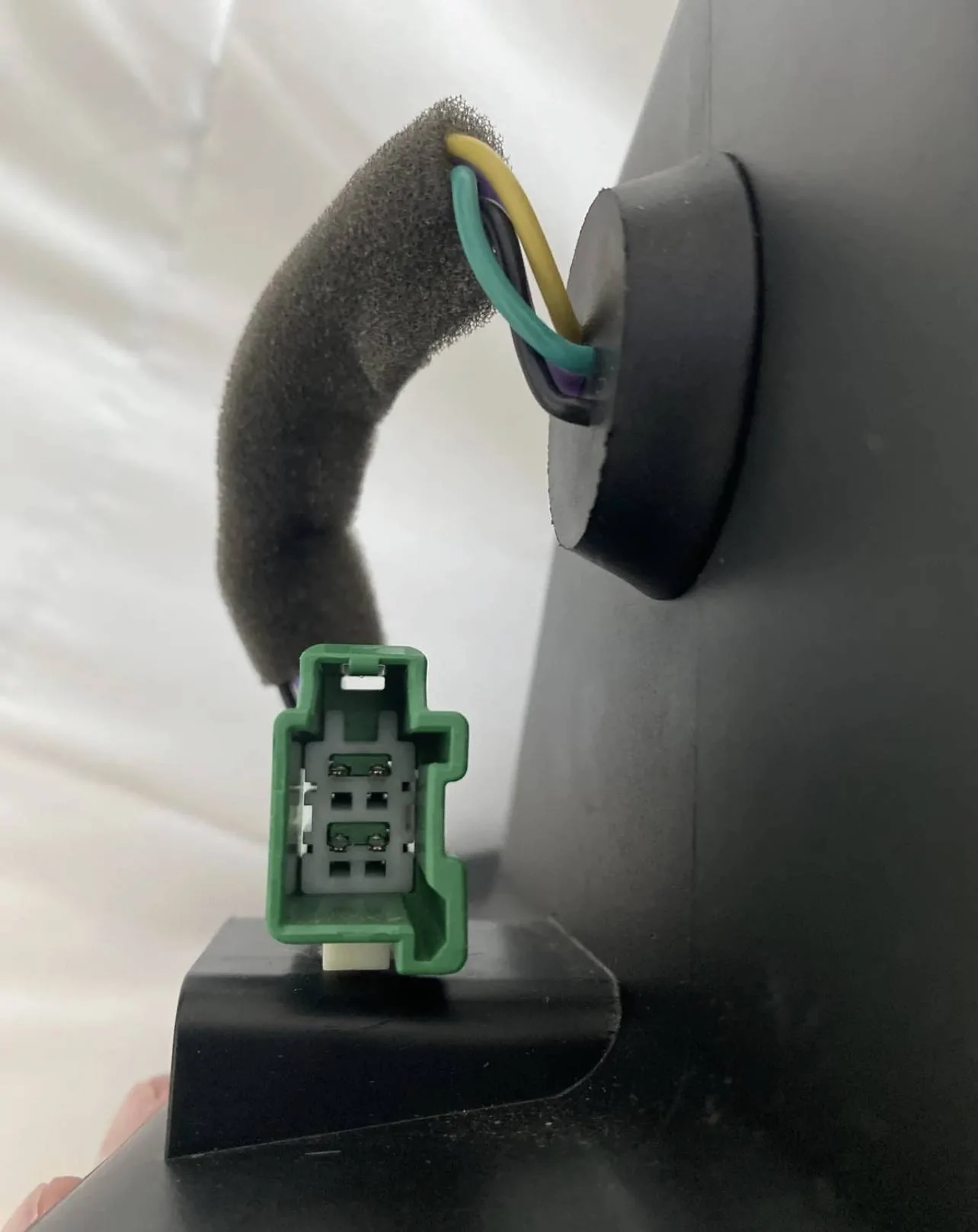

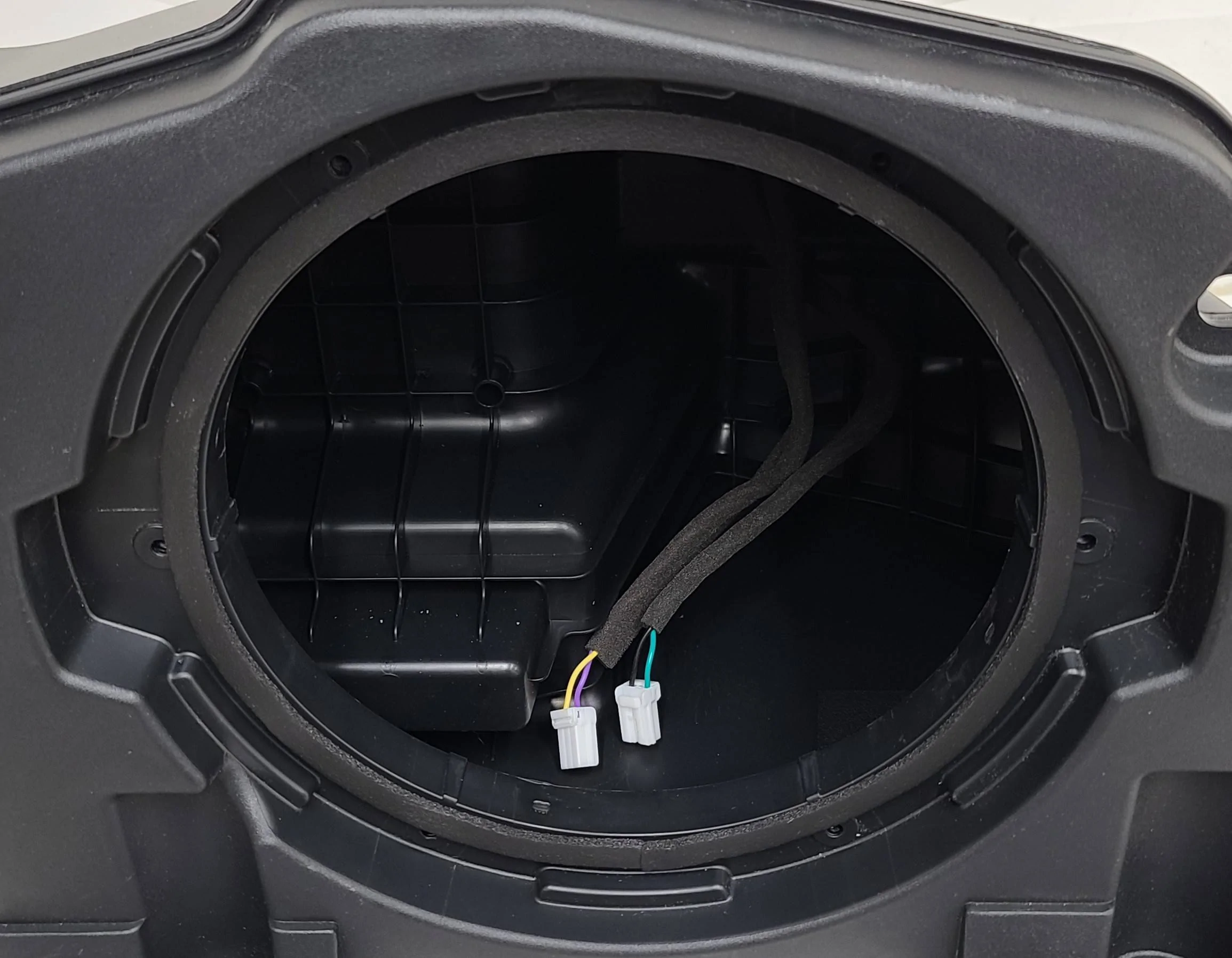

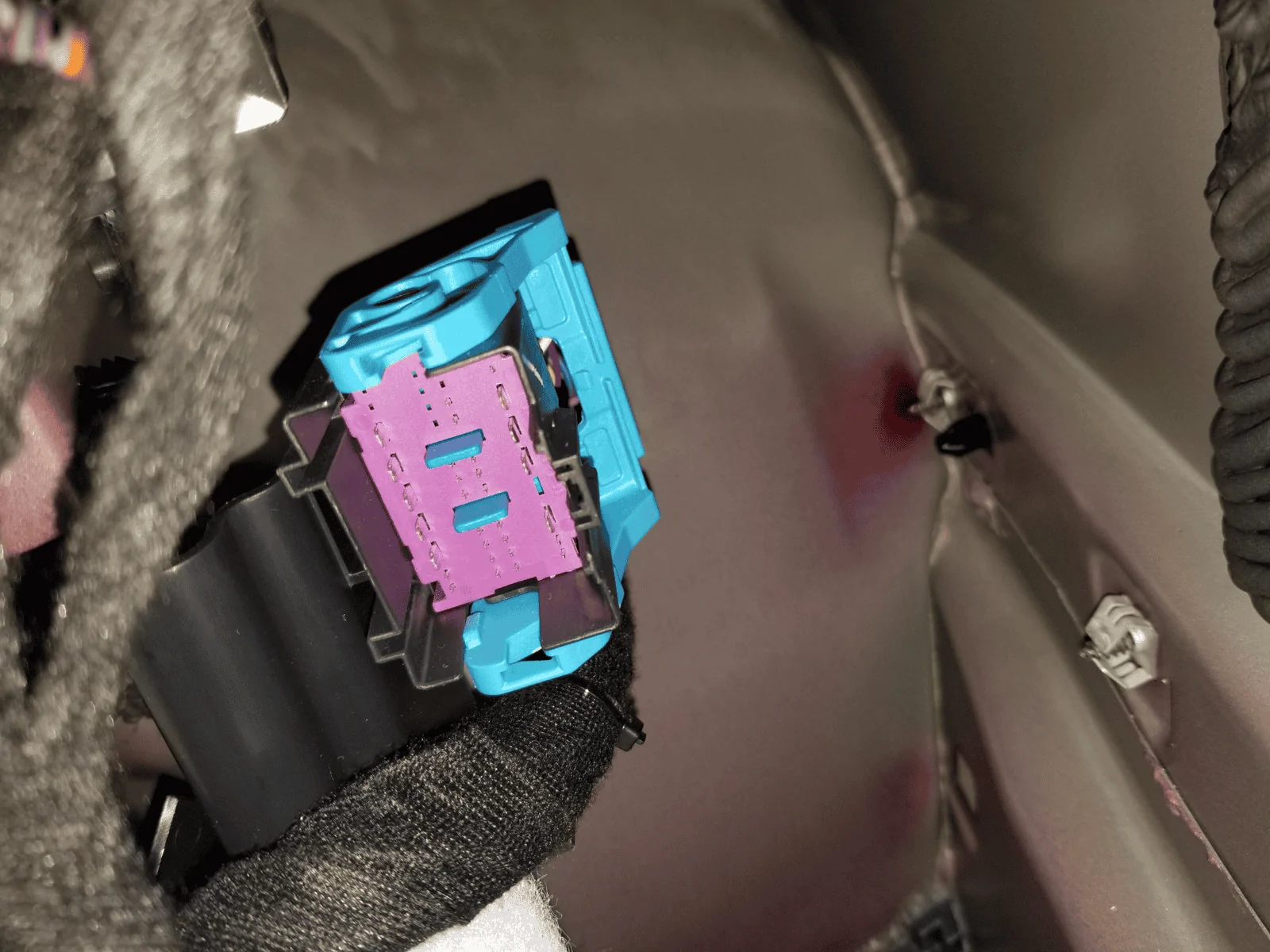

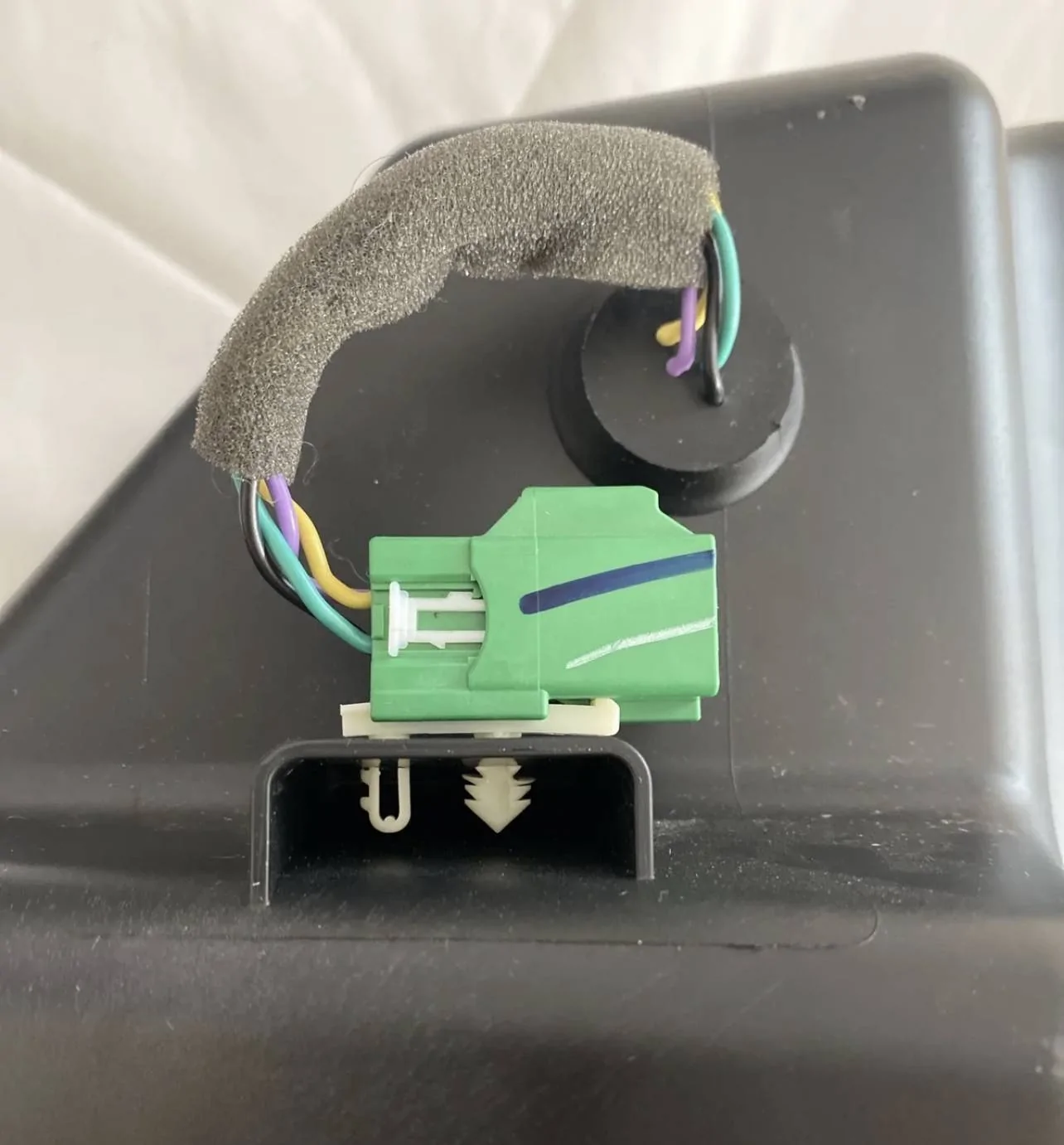

Hey guys,
I have a 2018 Ecoboost Premium that I upgraded with the Shaker Pro Amp to get the sub/bass output and added the shaker sub as I had the wiring harness already from the factory.
I’m now trying to add the B&O 10” sub to increase output and sub upgrade options while keeping a sub enclosure that fits clean in a convertible (sloped trunk).
My issue is this, I found the sub, but the connector that goes from the wiring harness to the sub has changed on the B&O and I absolutely cannot find the new connector. Does anyone know what the part number is so I can order one and connect the sub?
S10blaze92
