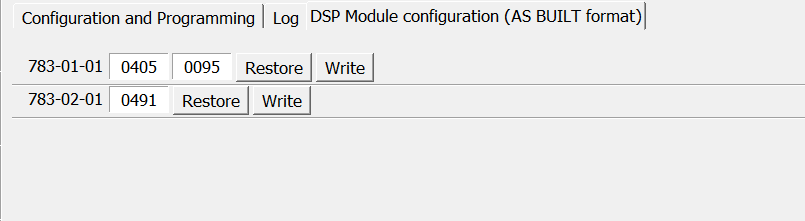

Looking at it in forscan my DSP module as built isnt even the same numbers, unless i have something very wrong. Maybe its different in 2021

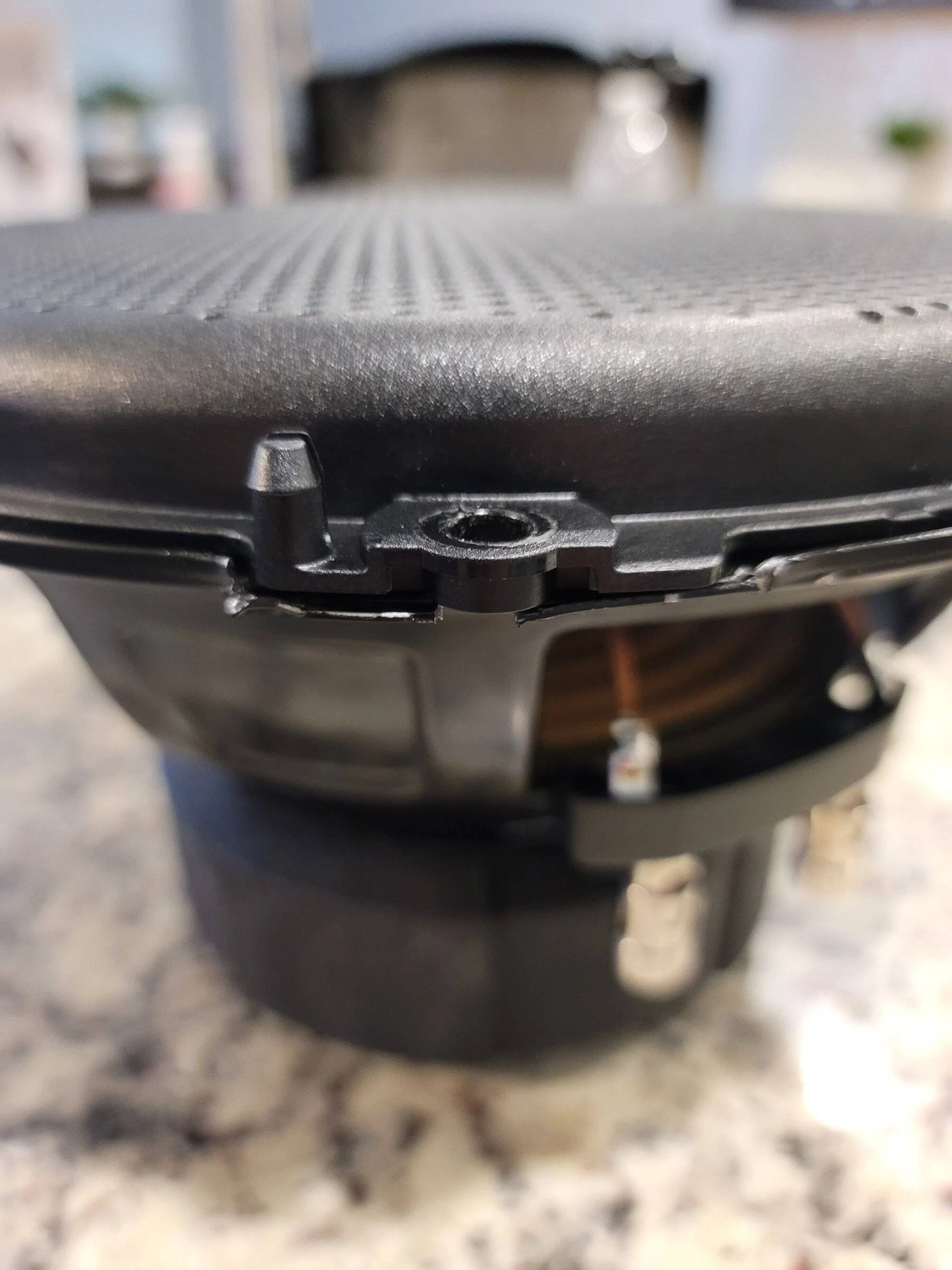

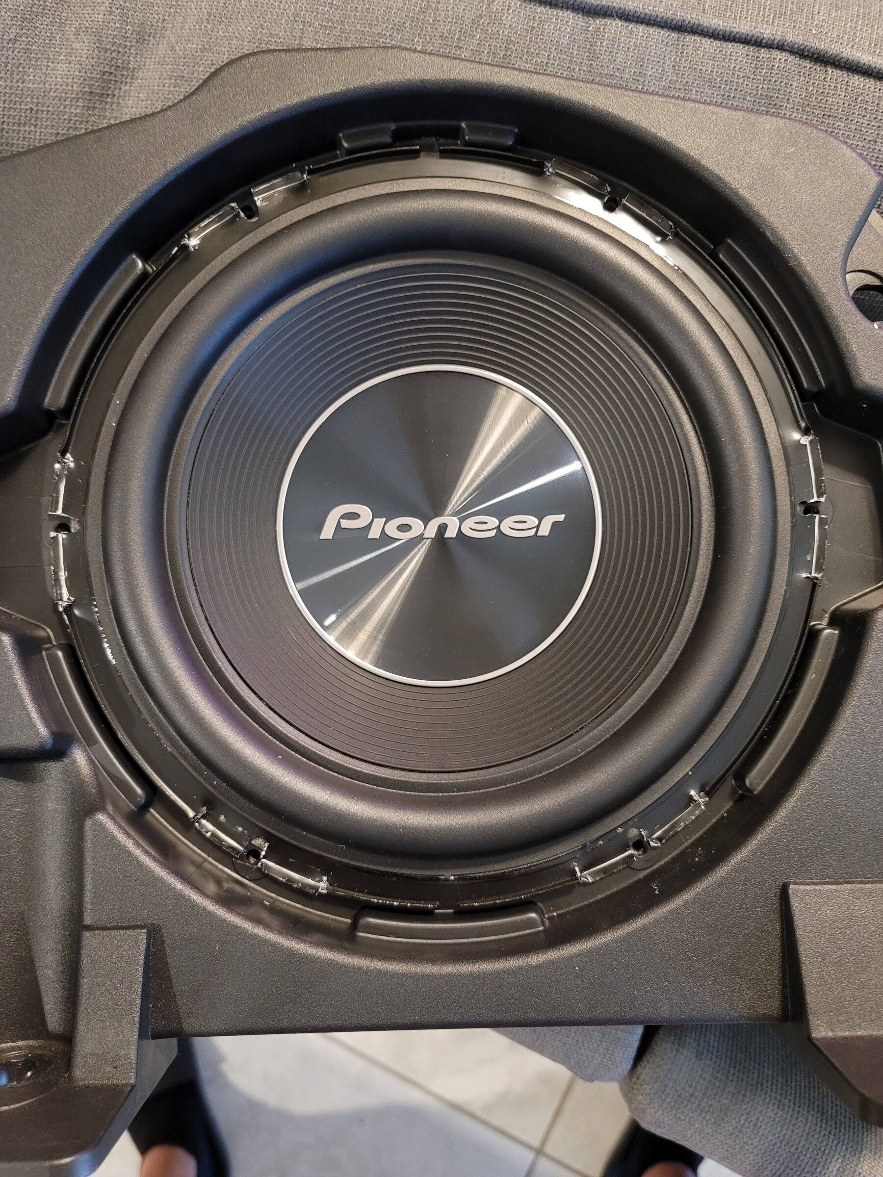

Did this swap today and I really thought it would sound way better based off what everyone has said in posts. 2021 Gt B&O. Broke all but one tab off on the grill but I didn't break the ring at least.
Sound wise I would say it is tighter but not exactly clean. The posts with others wondering about the phase has me thinking maybe I need to pull it out and swap the wires around to see if it would sound better. Right now I have it wired black and purple wires to negative, the green and yellow wires to positive.
You have the correct wiring.
Did you use polyfill?
Have you added additional sound deadening in the boot ?
The bass is actually over compensated on 2019 cars, so backing it off and increasing the volume helps. Not sure about 2021 cars.
Acm
Not dsp
Oh also if anyone changes bass roll off, you need to see chimes to ipc as well or chimes etc super loud
It’s better this way though so no biggie

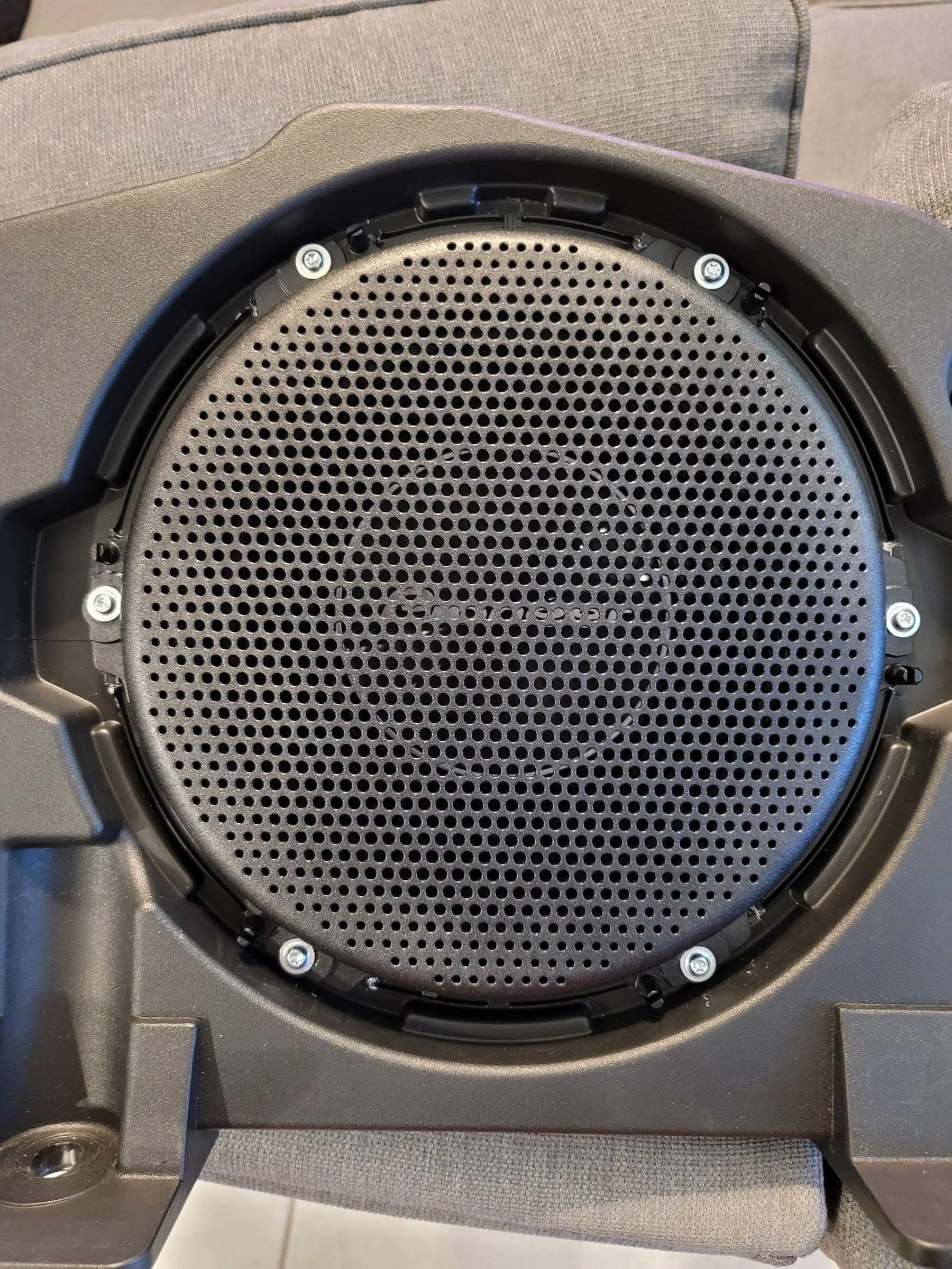

Did post number 1 today in this thread, took about an hour. Was able to order the pioneer sub from amazon and had next day delivery. Decided to drill all new screws rather than try and drill next to the factory ones, this way none of the factory holes get messed up for if i remount the factory sub for a trade in or whatnot. Tip, drill a pilot hole for each screw, the plastic is soft and that way your mounting screws will have something to grab onto when mounting. Not sure i wired it correctly but its working and has a noticably deeper bass and punch than the factory.

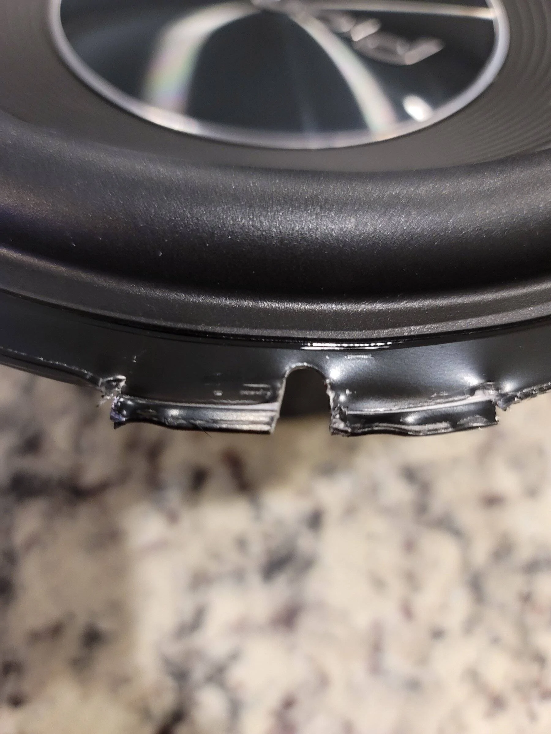

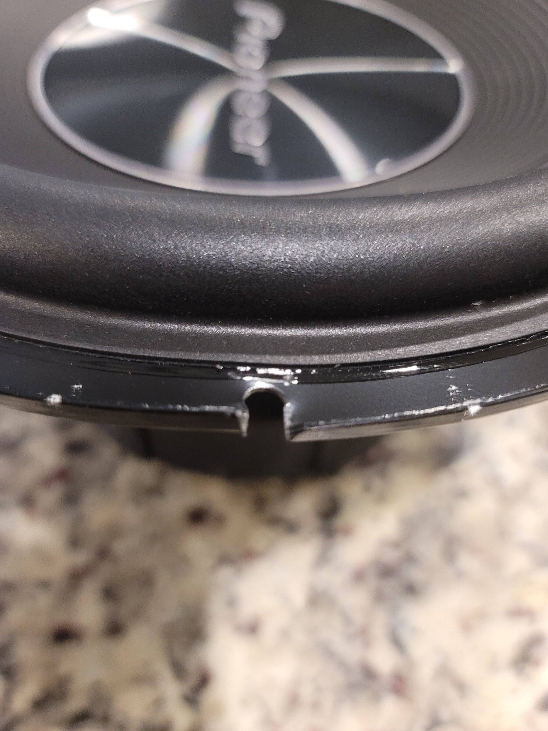

I did this swap last week and should've chimed in. I didn't drill new holes, instead I took tin snips and cut the subs holes. I also laid the the grill on the sub, marked the spots and snipped and folded the lip so the grill would lay flush on the sub. I then used the OEM screws to secure it all back together. Also used 8oz of poly fill and pulled wires from clips. They lock in very good to the pioneer subs spring connectors. Start to finish was about 45 minutes.

It sounds a lot better to me. Definitely tightend things up and I can feel the base in my seat now depending on song. I'm happy I did it and wish I did it sooner.
