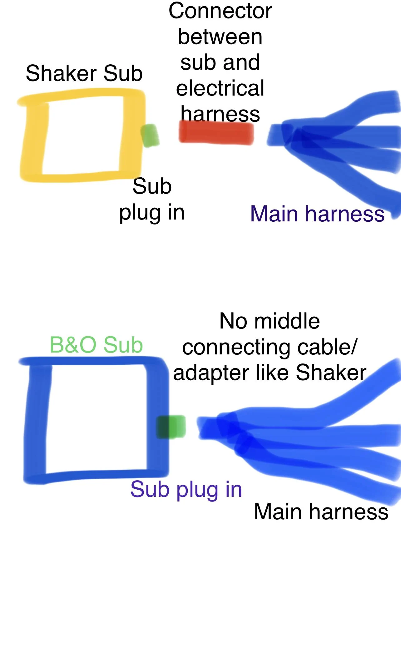

Hey guys, maybe I missed it, but are there any wiring diagrams for the Shaker and B&O subs? Specifically where it wires into the vehicle harness. Need to compare the two for making an adapter.
I have the Shaker 8” installed, and I’m building a convertible GT500 and when taking apart a donor car I found the B&O goes from the sub into the main harness with no separate connector like on the Shaker. So I’m trying to splice the two together to make a harness.
The B&O has a plug on the sub enclosure (assume the Shaker is the same) which connects to the harness.

Hey, yes you’re right. But the Shaker has a short 12” connector that goes from the back of the sub and then to the harness. The B&O goes directly from the sub connector to the harness. I’m cutting off the B&O part of the harness and then wanting to adapt it to the sub end of the shaker sub connector/adapter so it plugs in. I tried making a diagram, when I’ve tried explaining before no one gets it.
