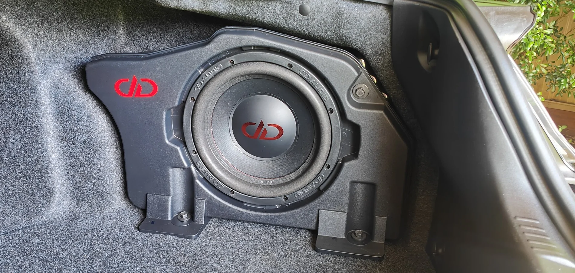

Completed sub upgrade with DD 10" sub ( 4 bar grill ordered ) , stoked with improvement . Onto interior sound next . 🎶👂

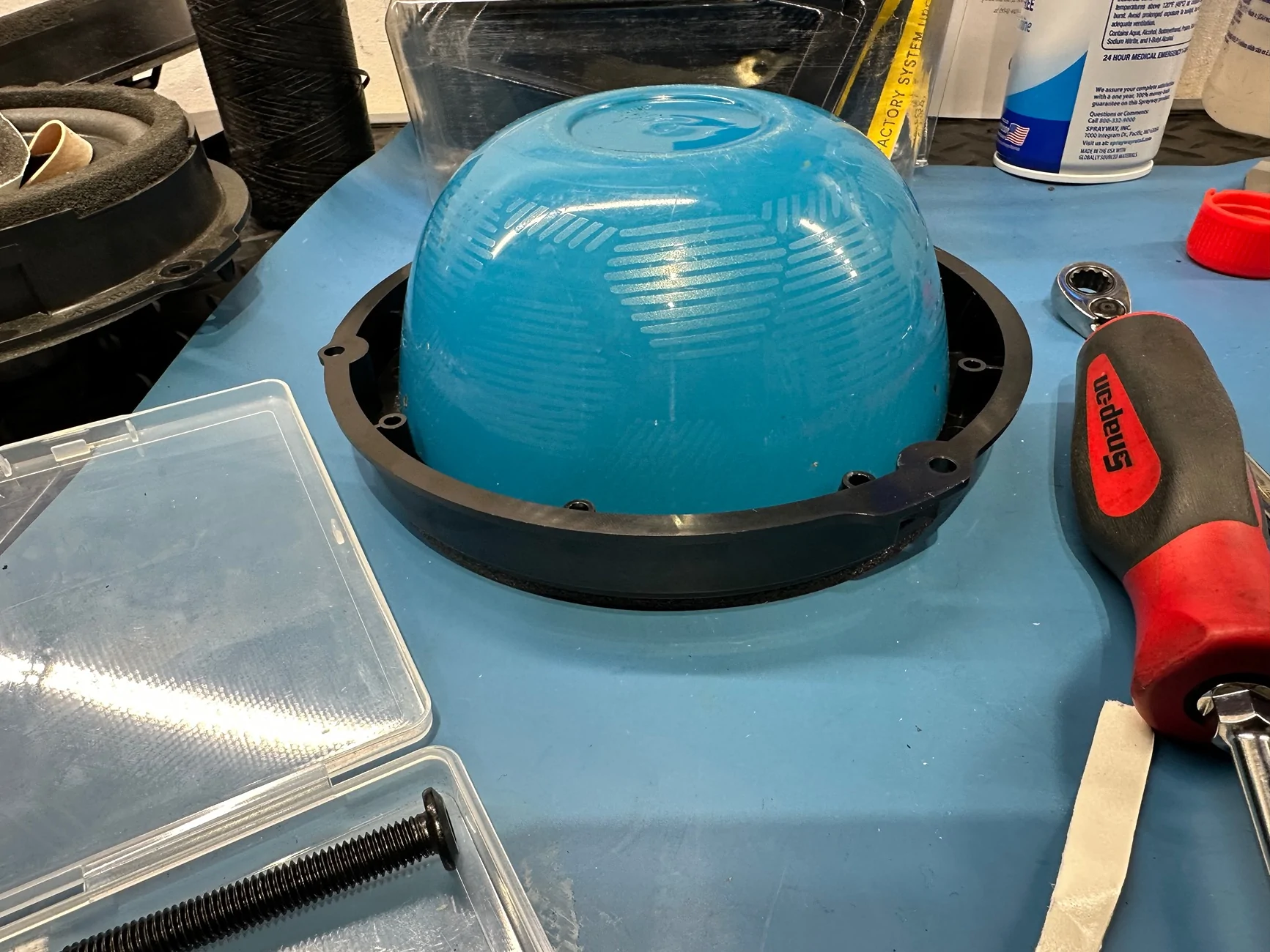

But curious about thoughts on blocking the backside of the deck speakers from the sub so it doesn’t turn them into passive woofers and jack with their output. I was considering Dynamat until I noticed a bowl on the workbench. If fits perfectly around the back of the 6.5” Focal and can easily be hotglued on for a complete seal. I’d punch a hole for the speaker leads and silicone it shut. No brainer or the result of no brains?

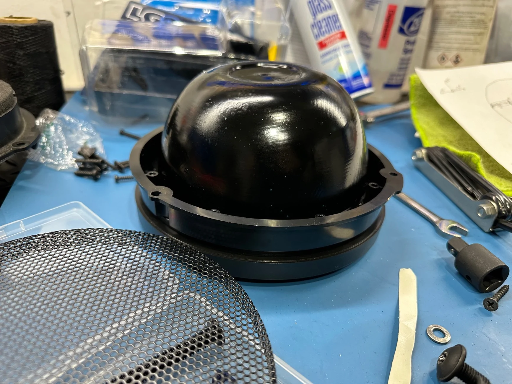

Shot it with some black paint. Prob gonna install it tomm with this on there and see how it does.

That was clever, I would add some poly-fill in there as well. FYI they do make foam sound baffles. Check on Parts Express.
https://www.parts-express.com/car-a...n-accessories/waterproof-foam-speaker-baffles
And yes the sub woofer in the trunk can turn the rear deck speakers into passive radiators. I elected to cover the bottom of the rear deck with some boom mat going right over the speakers essentially blocking them off. I too found it strange that ford upholstered over those speakers. It makes absolutely no sense. Granted bass frequencies can be heard but midrange and especially high frequencies are heavily attenuated. And as a joke they put the B&O logo in the car, like that would improve your perception of the sound quality.

This one here , must be old stock . Sounds solid from the getgo but as 350 says will get better after run in , dramatic difference to stock sub , i also disconnected centre speaker while i was at it . Forum been a great help in getting this junk B&0 to sound acceptable . Deadening , Hertz 3 way component fronts and a Musway DSP/amp next on the list next
I think that's the pedesessor to the unit I used. Also a great sub. I don't understand why DD Audio obsoletes these speakers when they work so well.

Yeah happy with sound progession and yes i did add poly to enclosure . Bass much cleaner now and look forward to more improvement as driver loosens up . The centre channel disconnection is a massive positive as well with a nice sound stage evident now . These 2 mods have turned the B&0 from mediocre to decent in a day . Everyone should unplug that centre channel and turn of surround so you can listen to music like its meant to be heard . I will still add new component 3 ways and a DSP/amp in future but dont feel so pressed to do it immediately now , for the first time the stereo sounds ok . This forum has been a massive help getting things to this level with minimal expense . 🙏🎶👂
