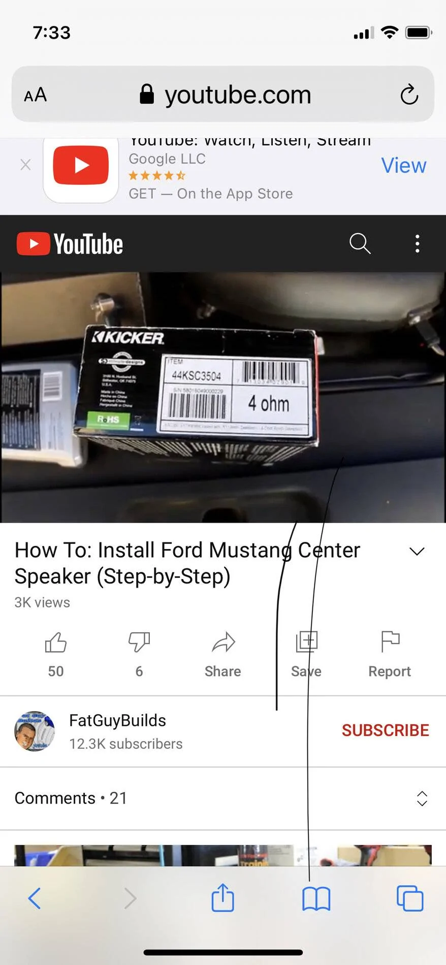

This might help some on an exact replacement coaxial speaker. Kicker makes one the guy shows the Part number in the video, which is a good video on how to remove the cover. I actually used this method to remove mine and drill a hole in it for my nitrous controller cable.

The guy gives his opinion as to how it sounds at the end. He didn’t mention that it brightened the sound any, given that itā€s a 4 ohm speaker.
You missed a crucial detail: His stock speaker was 2 ohms (he even mentioned that on his video), so a 4 ohm one would sound less loud. Our B&O is 8 ohm, so a 4-ohm would be the opposite... and we do not want that :). But yes, I'd prefer a coaxial 3-1/2 8-ohm speaker, and none of the options over PartsExpress has one of those.
Yeah, I just skimmed through it and was focusing more on the protrusion of the tweeter, as I know that was a concern of yours, so I did miss that. Take a look at this article regarding changing impedance of a speaker using a resistor. Maybe this may be a workaround for you.
