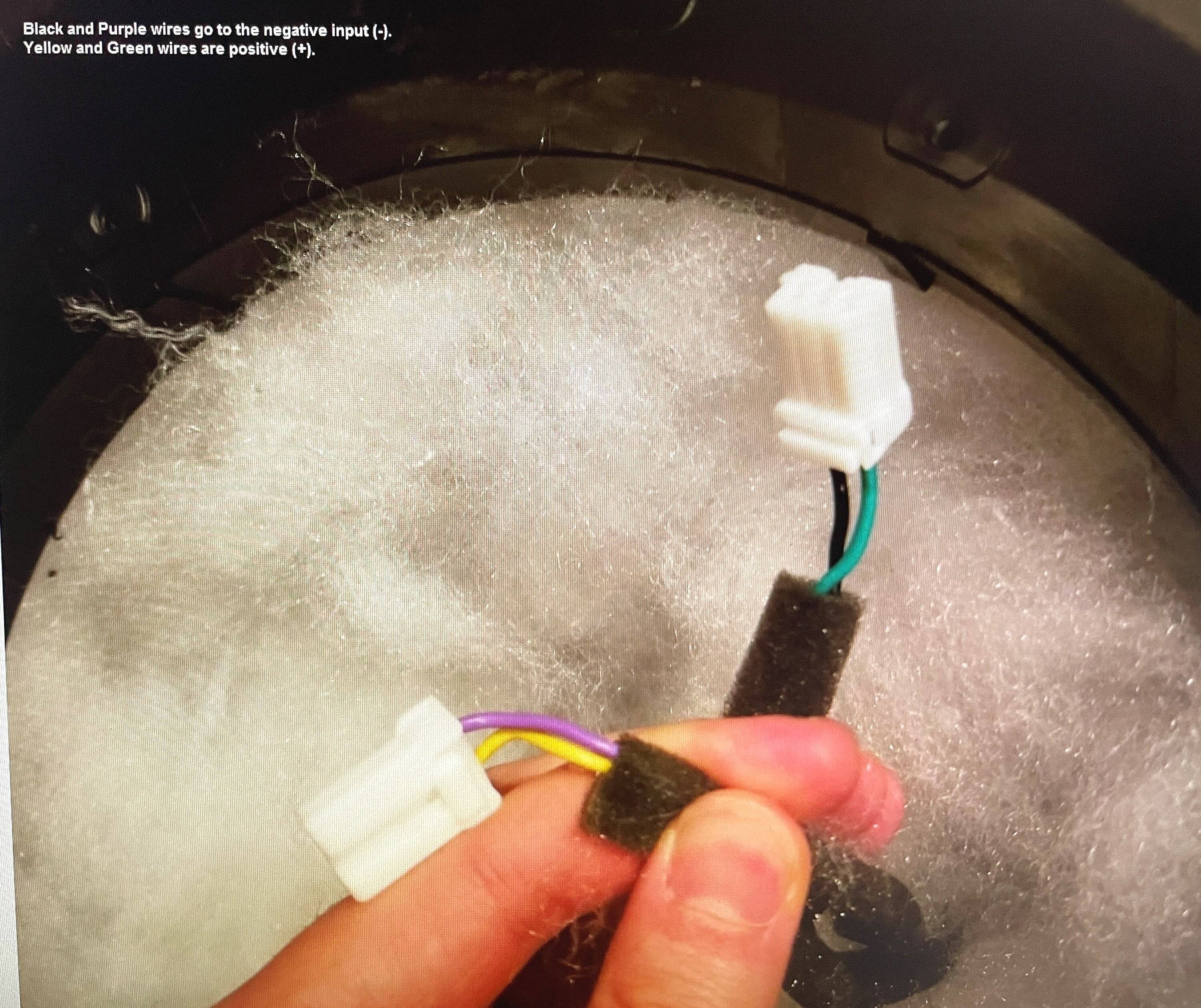

The wiring colours and orientation are in post #1
Black and purple are negative, green and yellow are positive.
Remember this is a properly controlled sub and relatively low sensitivity, so is tight and musical NOT boomy so may sound 'quieter'

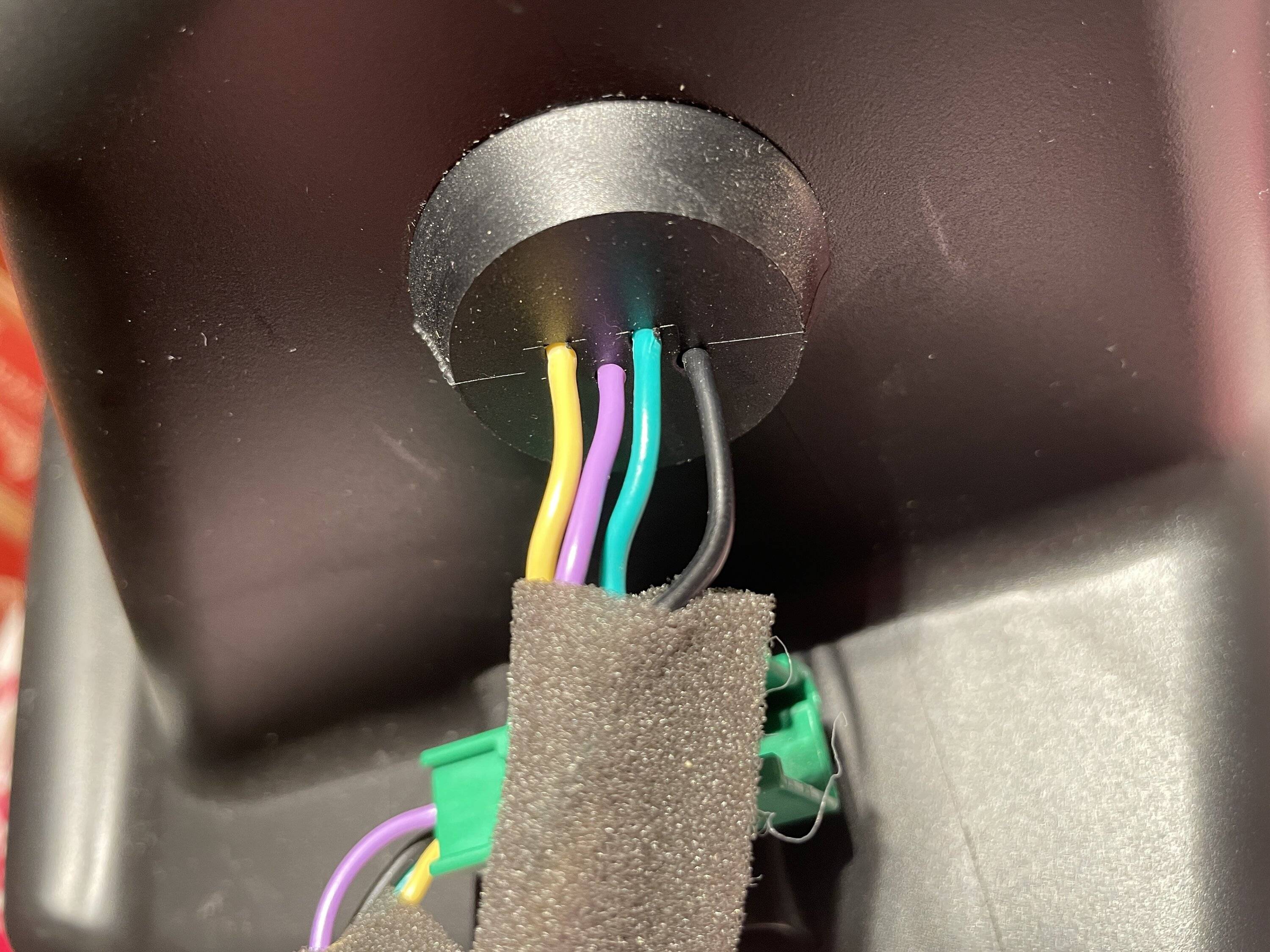

Are they really the colours of the wires feeding your oem sub?. Different to mine if they are.
Yes. These are original wires feeding my OEM sub.
Here are the pictures , taken before anything was changed:

The wire in your pic you’re calling pink is actually purple:)
Pero
Sep 30, 2018
259
183
Slovenia, EU
Pero
2019 Mustang GT Fastback Ingot Silver MT82 MagneRide B&O
Ah - sorry. Lapsus Linguae.
I'm no that much in these "girlish" colors.
Pink, Purple, Violet... pretty same to me. Especially if you can see only one at the time without comparison possibility.
So yes - Purple it is this wire.
