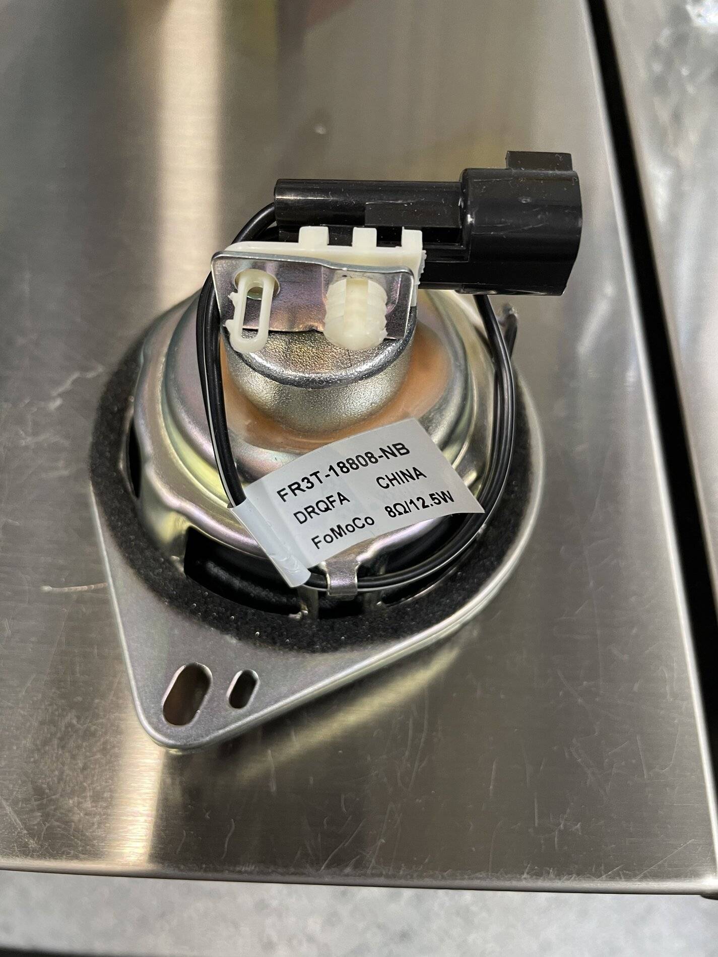

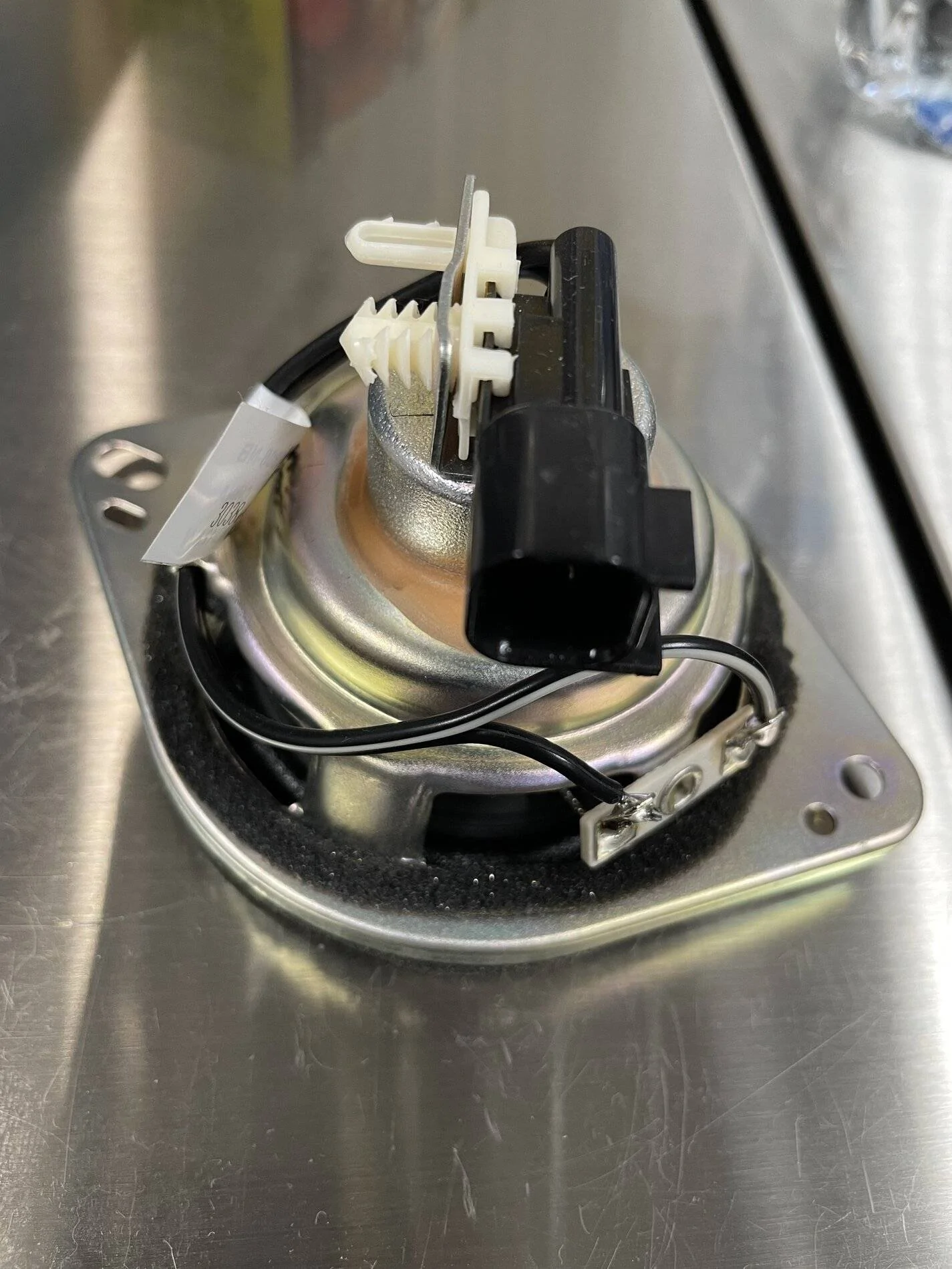

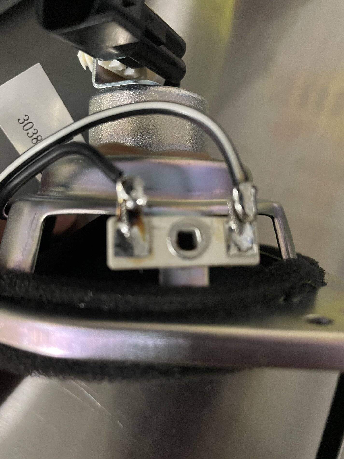

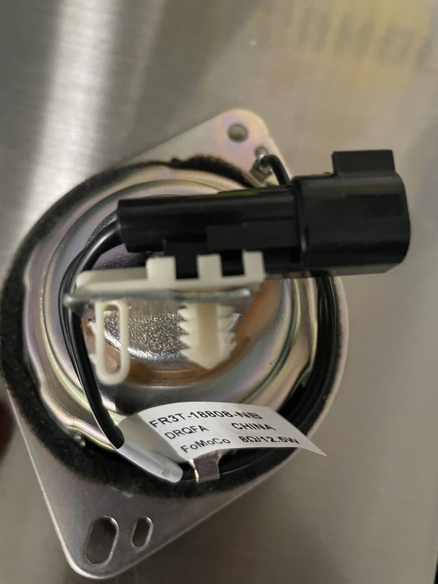

Here you go my friend. Remove the factory center speaker and then clip the two wires at the terminals and install female spade connectors on the leads. Plug the factory speaker connector back into the factory wiring harness, so that you can make it plug and play to your new speaker of choice. This is a pic of my B&O center speaker btw.

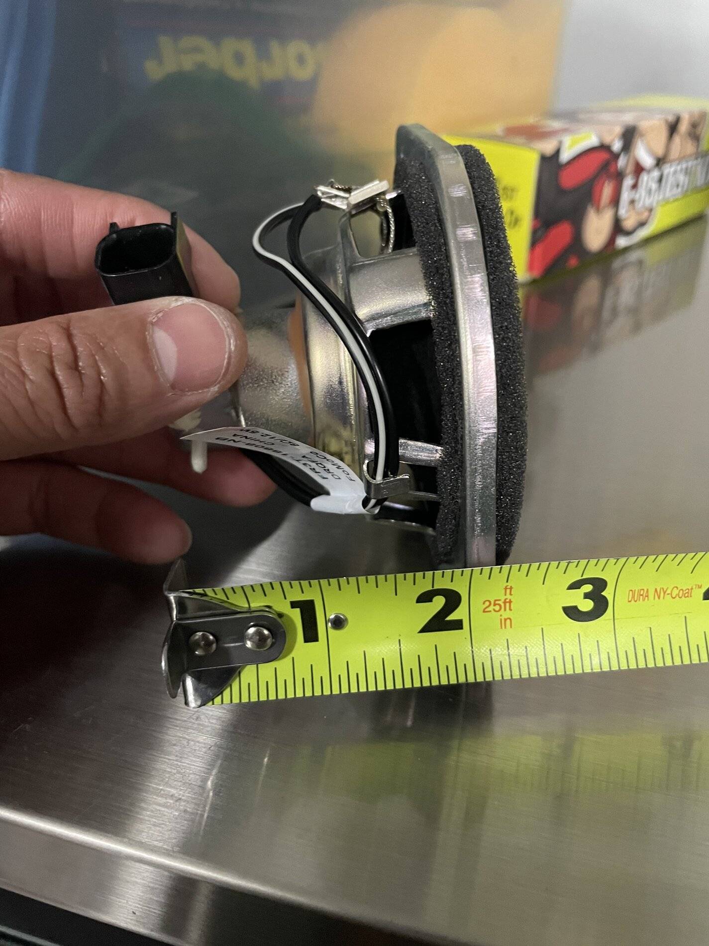

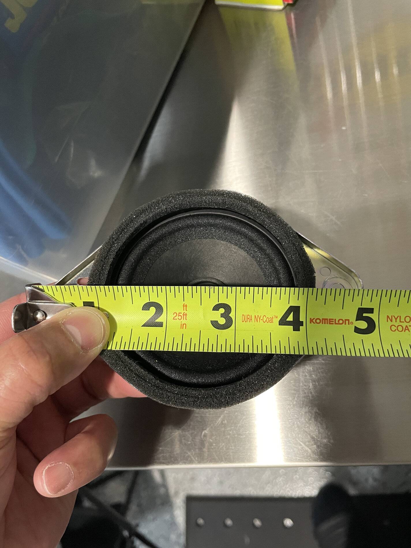

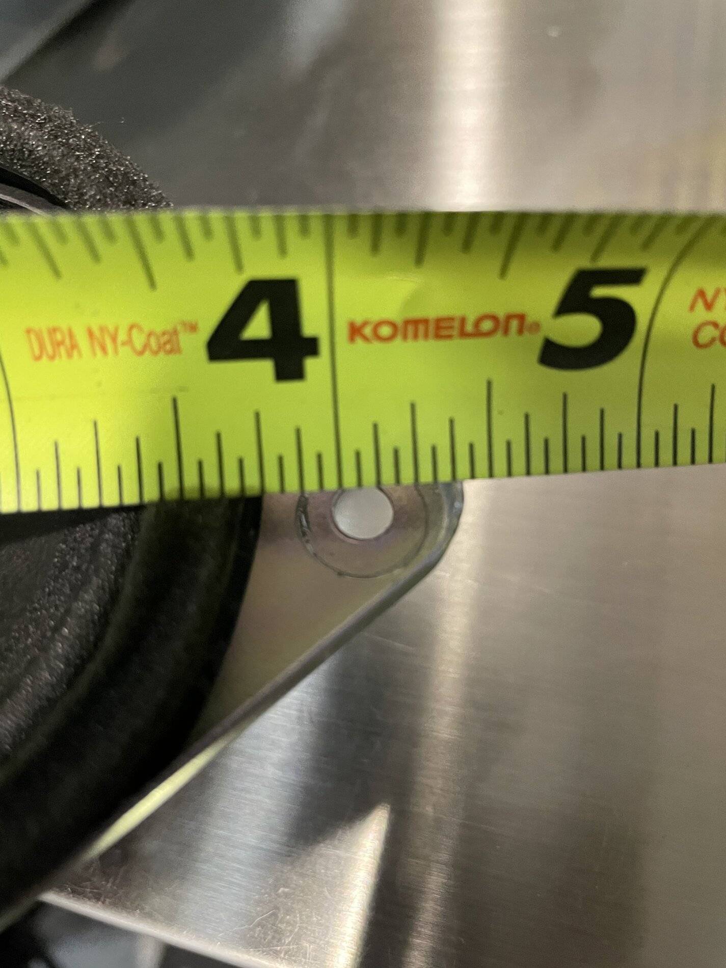

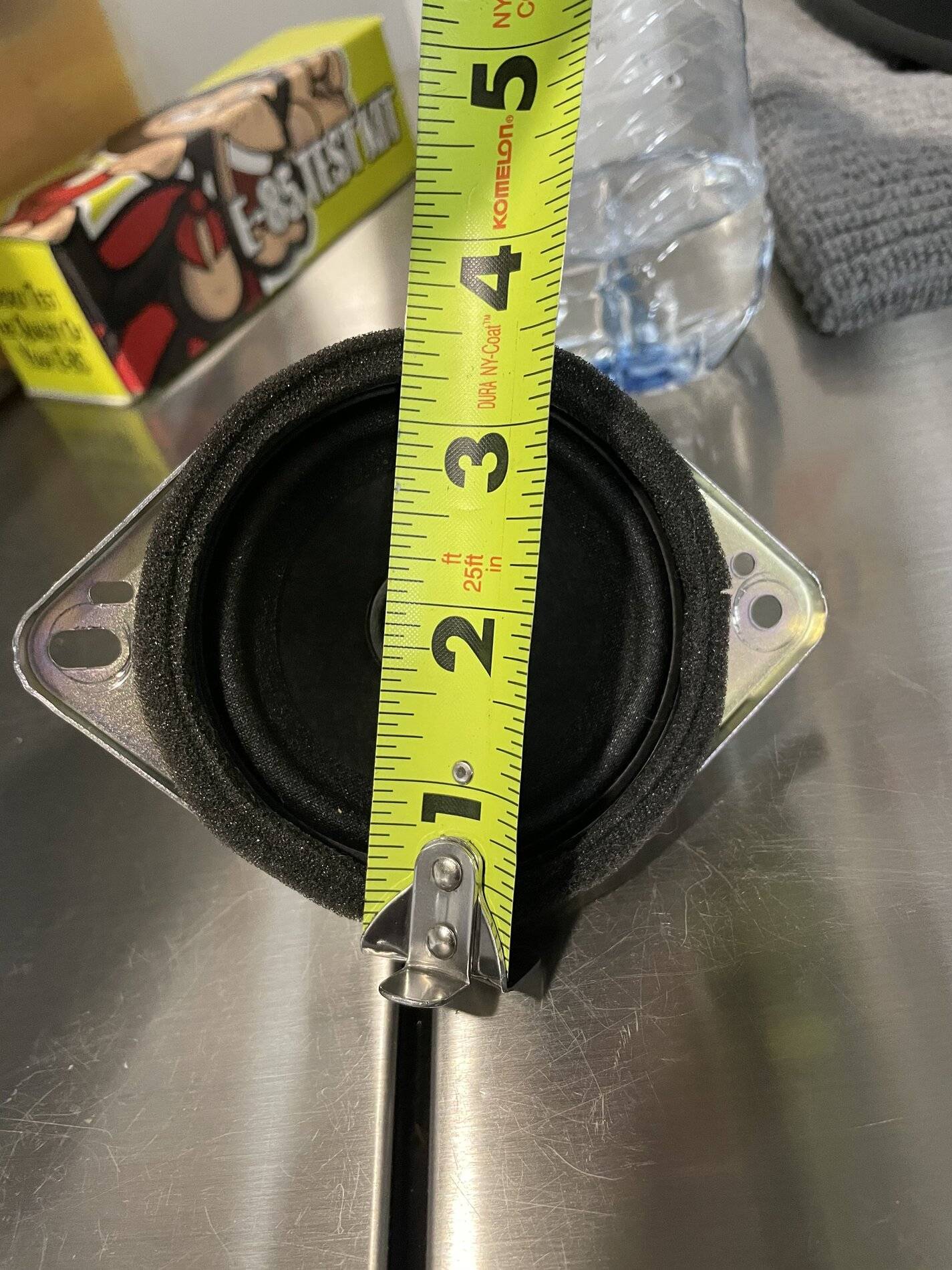

Photo #3 is the center to center
measurement for the mounting holes.
Photos #2 & #3 are what I was describing in an earlier post that you can snip the wires at the terminals, unclip the plug from the speaker and install female spades on the ends of each speaker lead to make it plug and play for your new speaker. Try out a 4 ohm speaker, it won’t hurt anything. If your ears like the sound then I’d roll with that. We’re all different when it comes to the type of sound that we’re looking for.
Let me know if you need anything else
