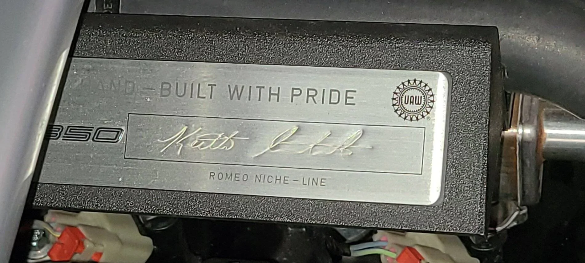

I’m sure it doesn’t make you feel any better but this seems like one of the very very few gen2 engine failures not built by Jason Altadonna - who I’m pretty sure is the builder for many of the “failed tensioner” engine failures.
