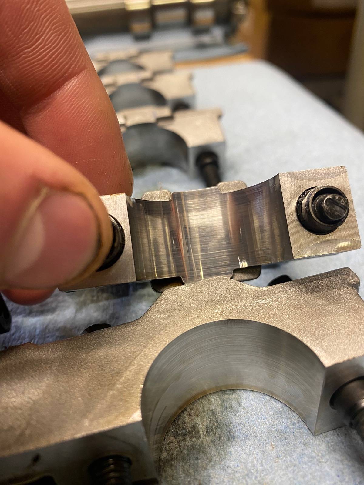

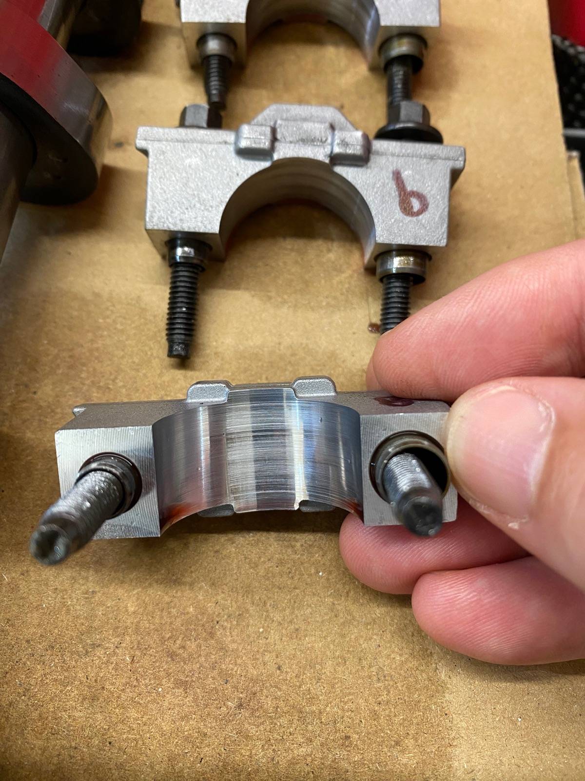

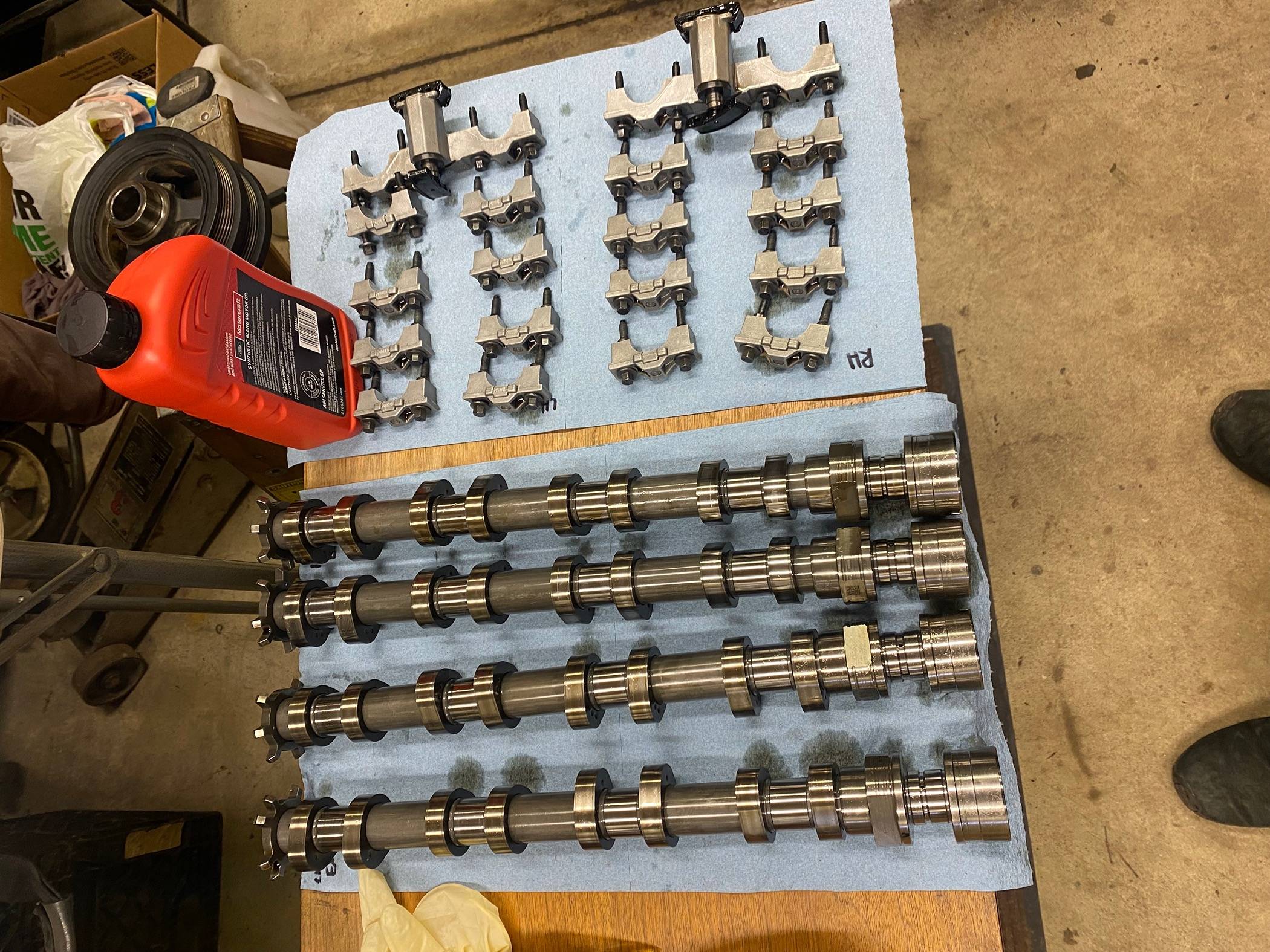

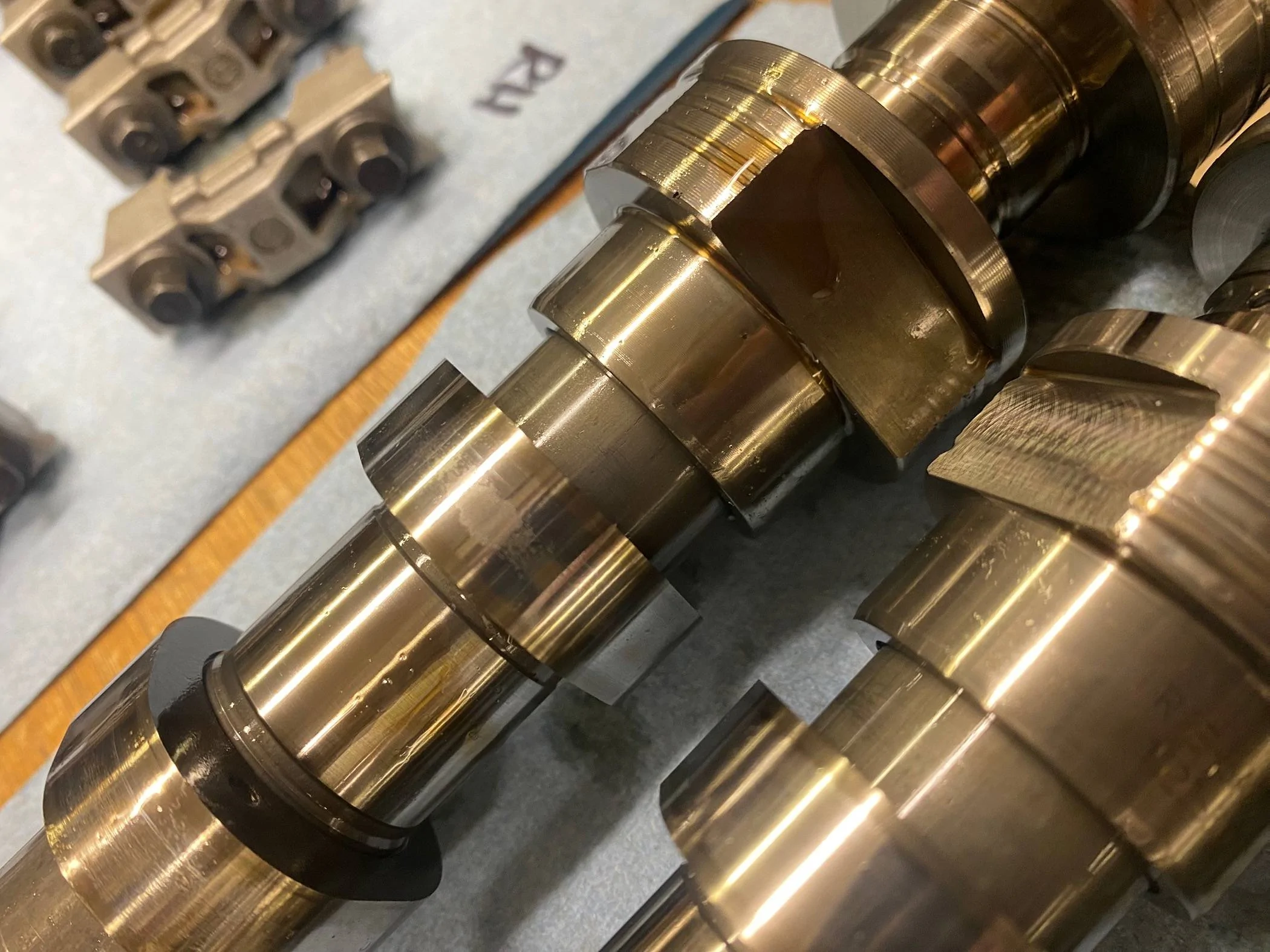

Update:

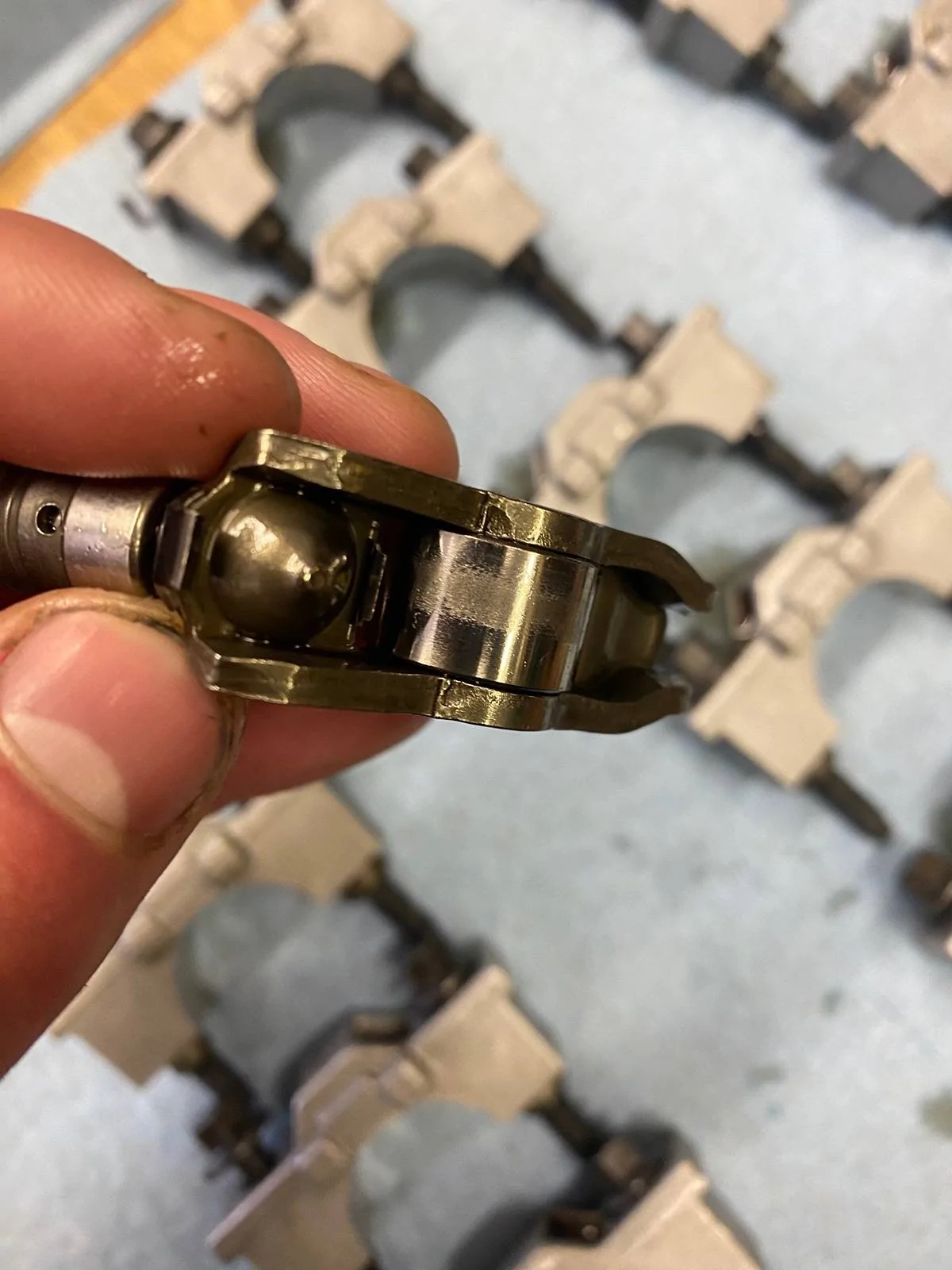

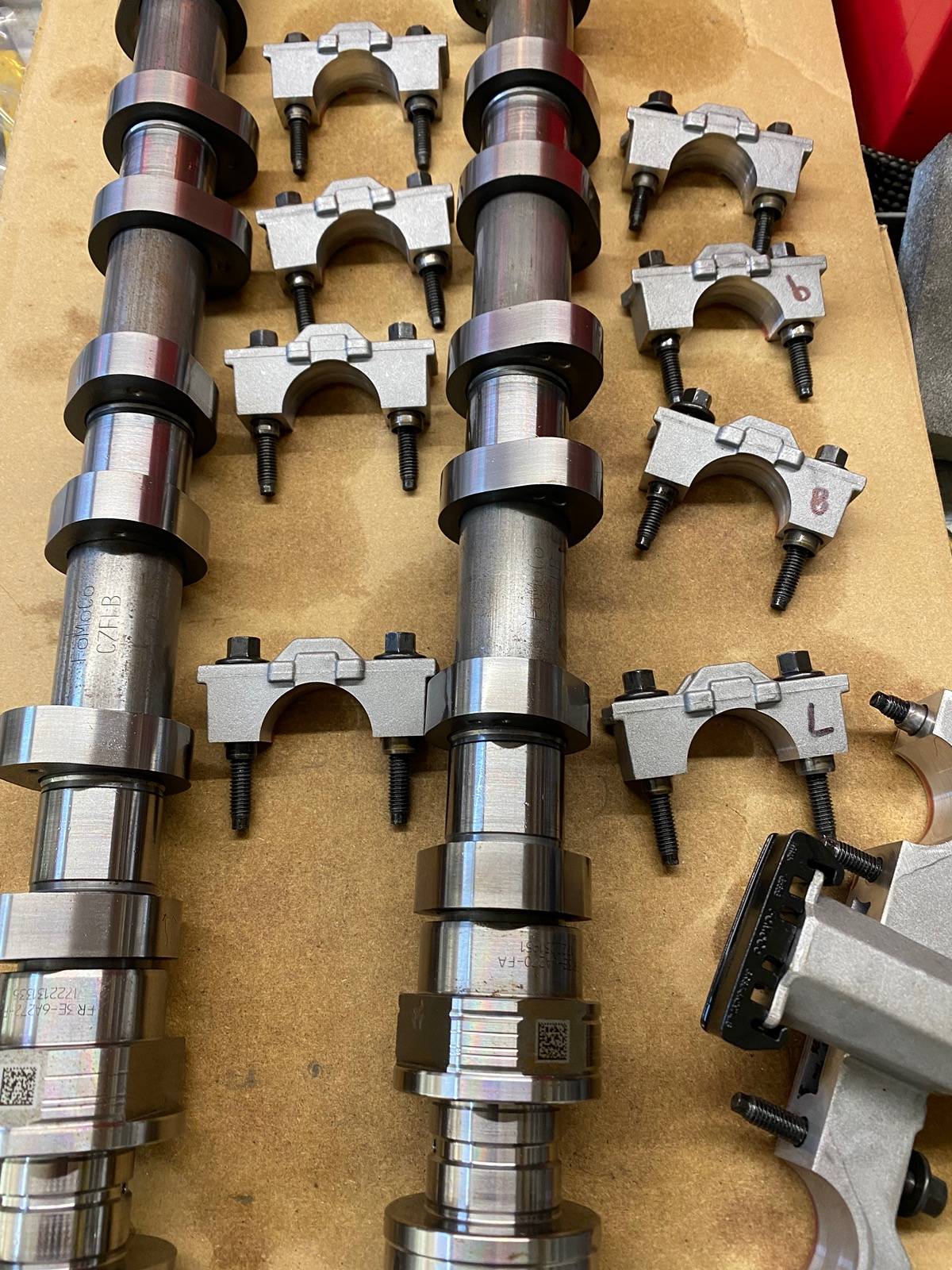

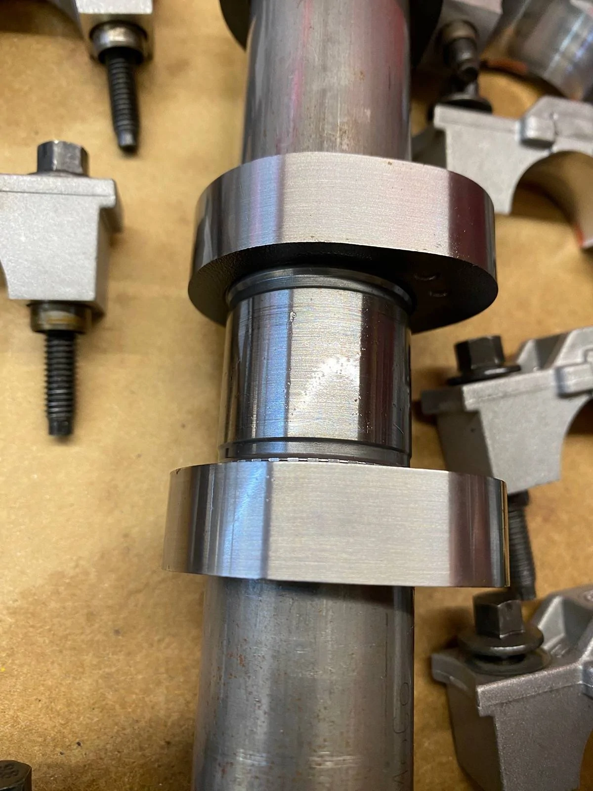

While waiting on the replacement exhaust cam I went ahead and got the cams, rockers and adjusters out.
The worn rocker roller is not seized and I’ve confirmed all the other cam lobes look fine.

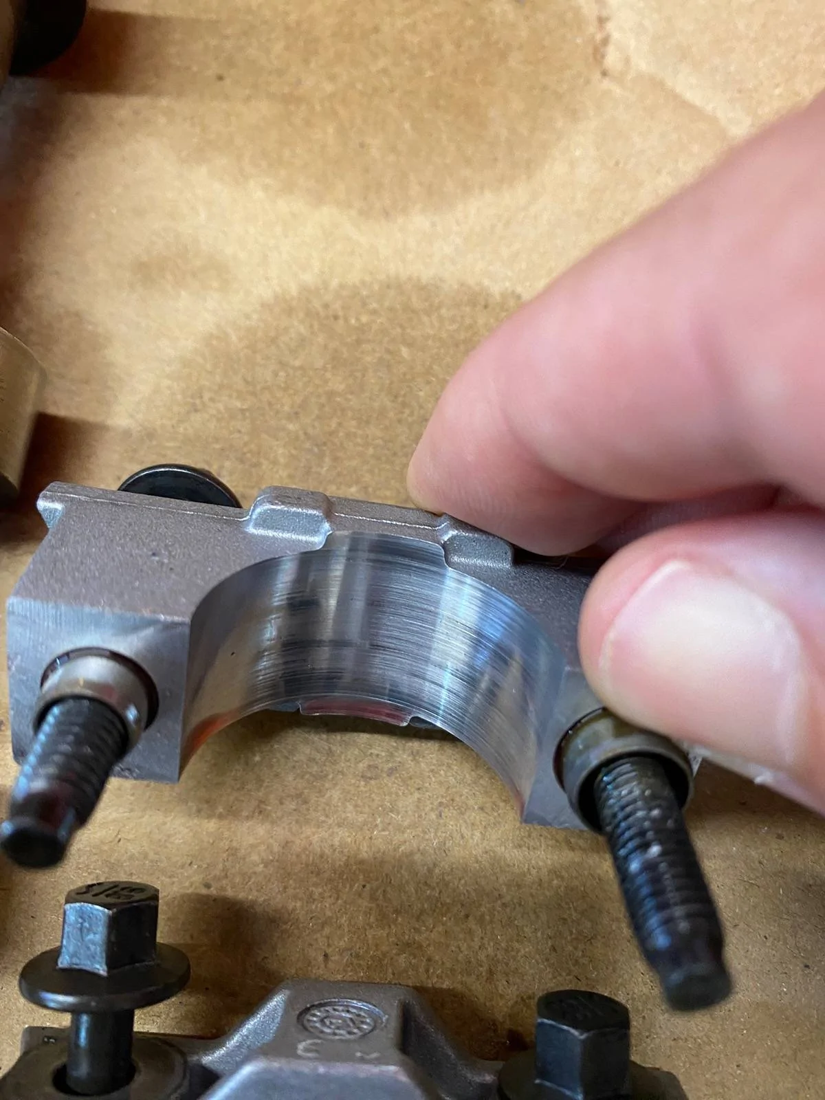

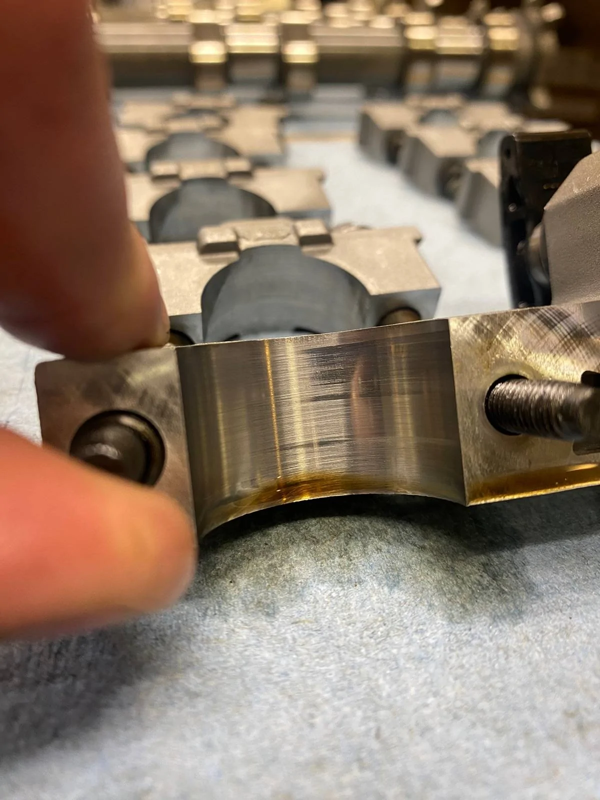

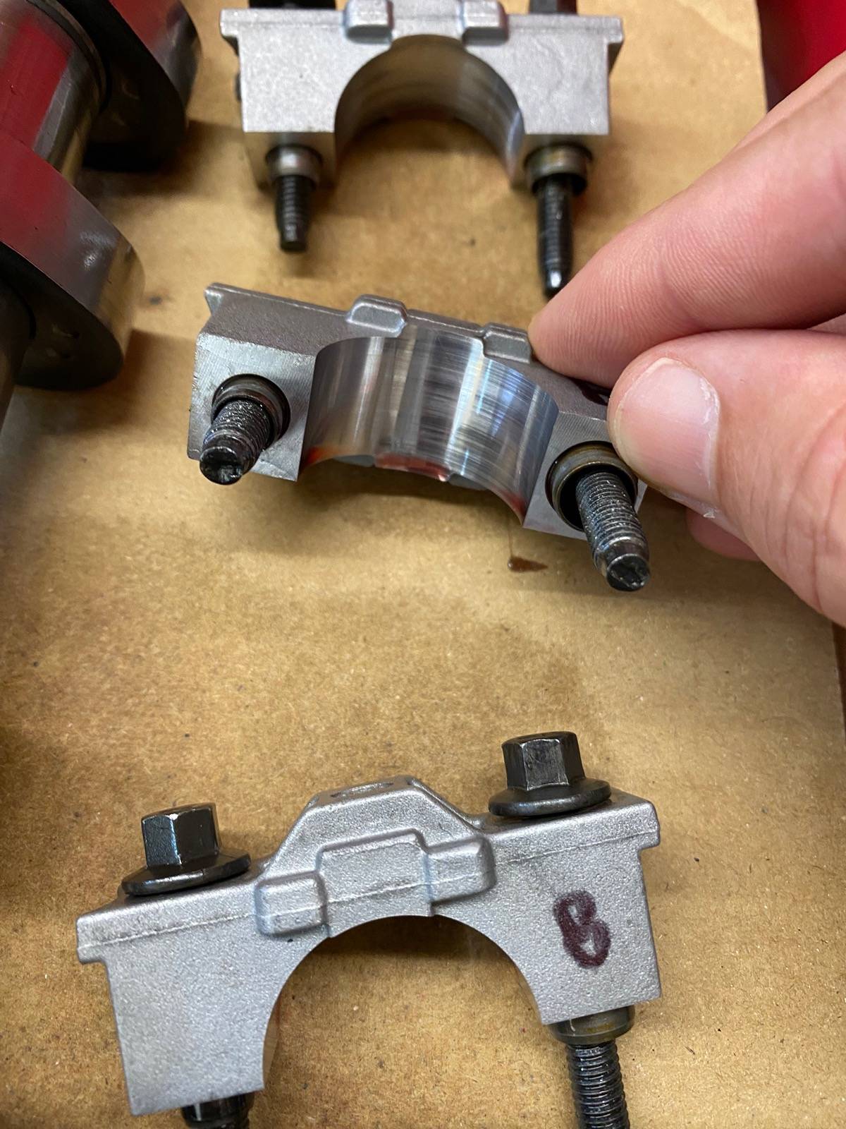

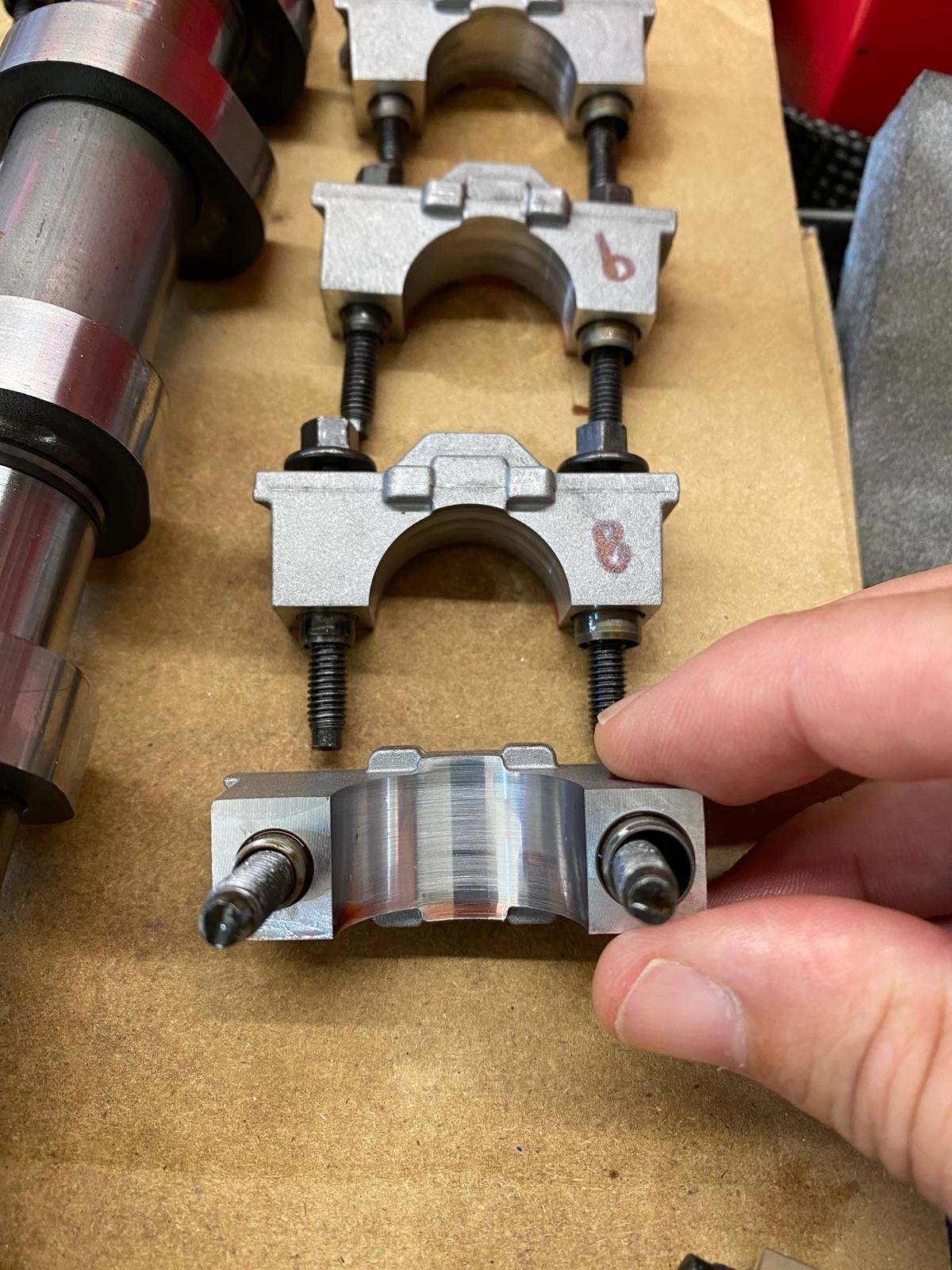

Excuse my ignorance (23 yrs old, first engine tear down) but took a few photos of some of the cam caps that looked a little worn to me but not sure if normal wear or not, would appreciate any feedback.
Another question, would I benefit from doing head studs or anything else while I’m here? Considering to pulley down and max out the P1X, would like it to take the power :thumbsup:
OPG/CS already done. Replacing all rockers and adjusters, primary and secondary chains.

I don't like the way the caps look in the photos. But photos don't tell the whole story. Can you catch your fingernail on any of the caps? If so you need some machining. If not I'd try to have a competent engine builder look at them before I ran them.

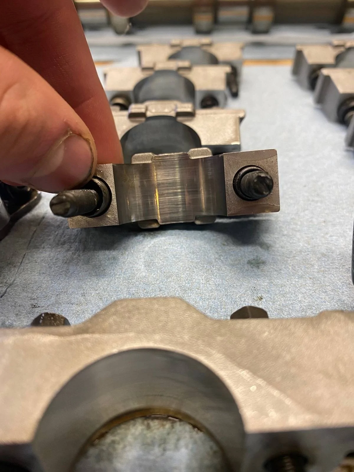

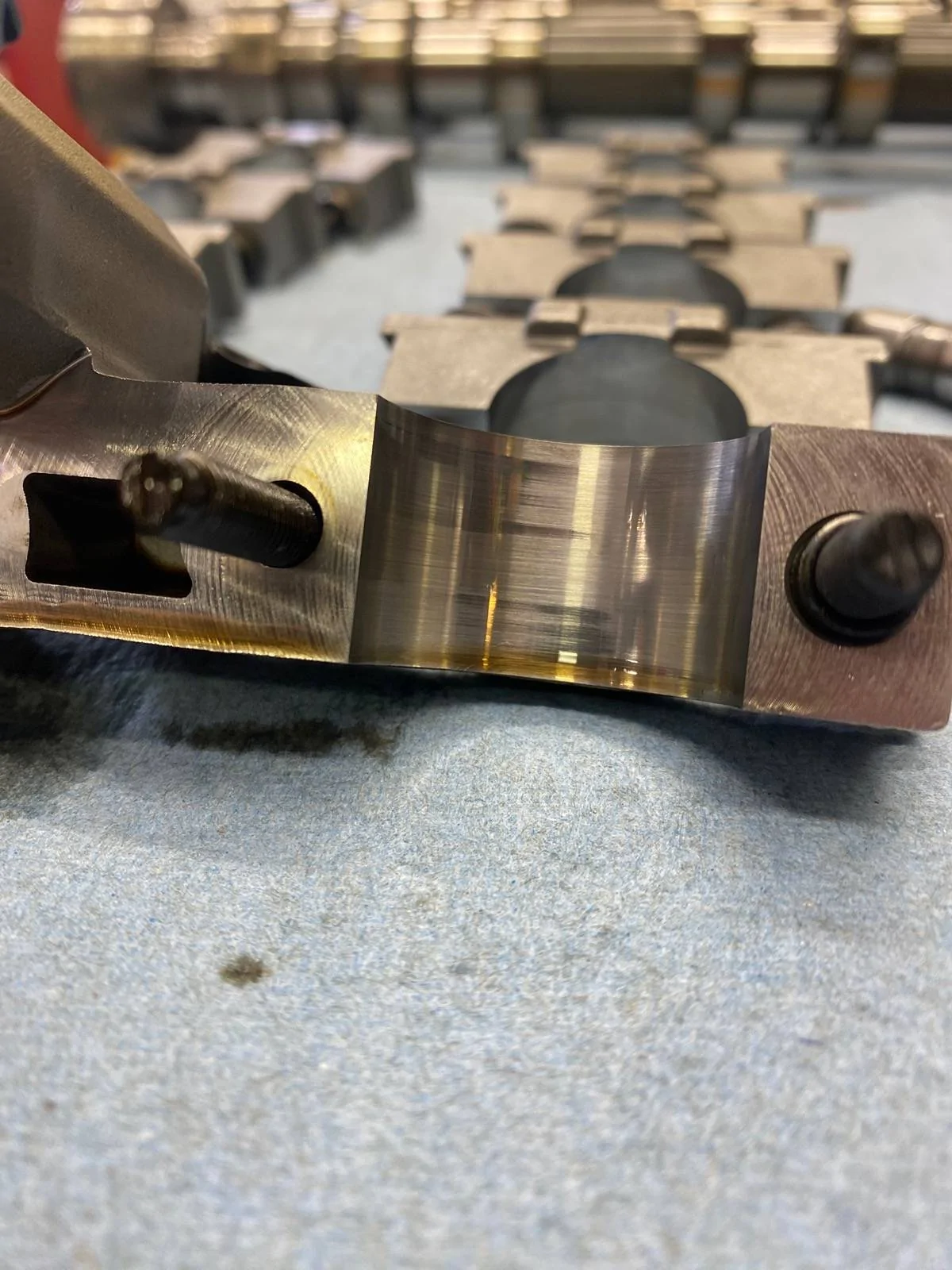

These pics are from my 2017 gen2 , 18,000KMS. (11000miles). You can see , but can not feel Any of the marks. Finger nail test etc.
These are going back into a sleeved and built motor as it’s just normal wear marks On cams seats and caps.
Fingernail test passed, smooth as butter.
I figured as much just wanted to get some confirmation, thank you!
