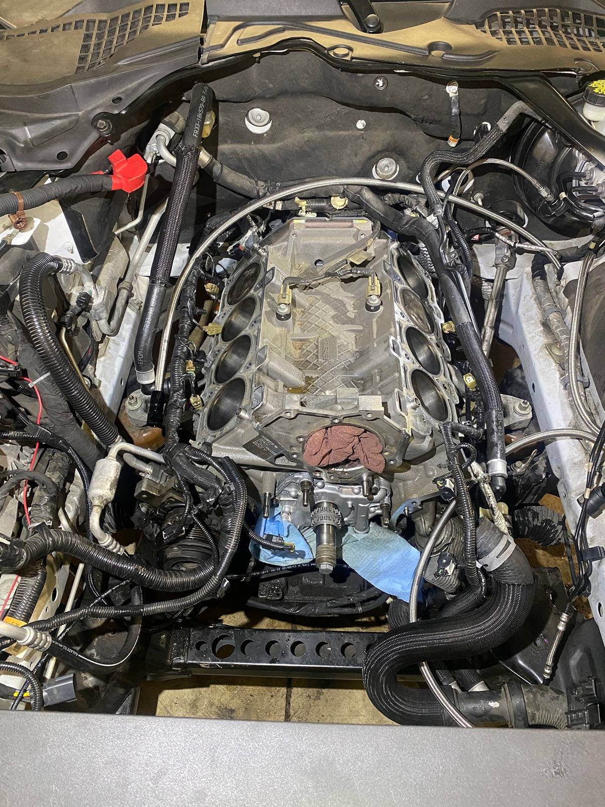

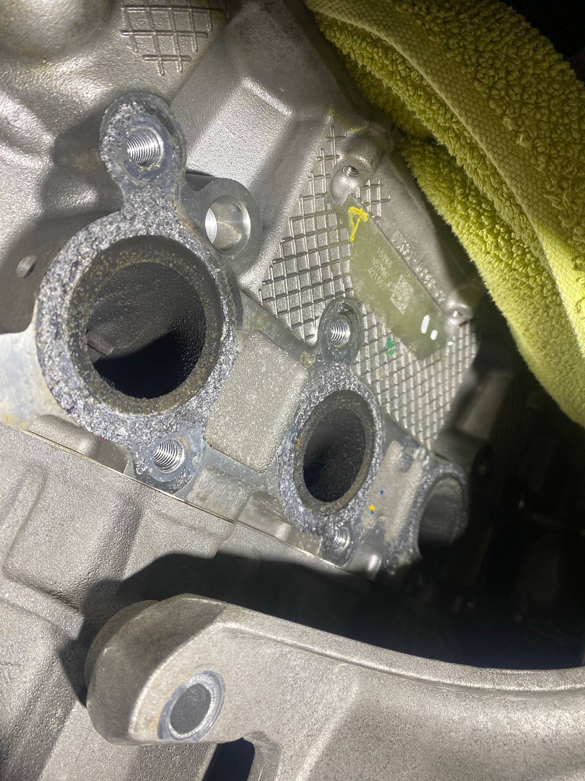

Headers are out, the ARH gaskets left a lot of material behind. Probably going to order oem metal gaskets.

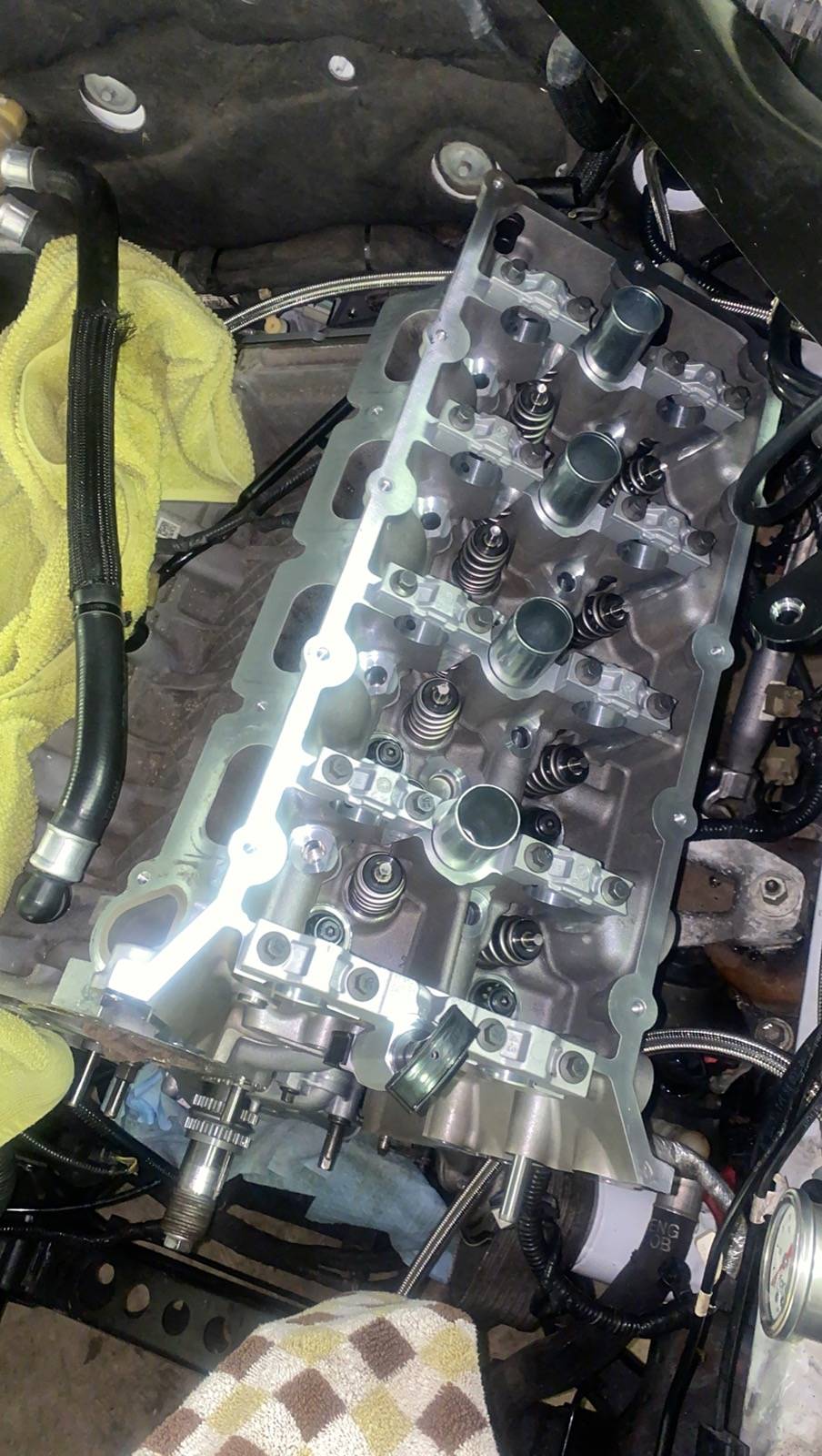

Got the heads tonight.
Looks like very minimal room to get the studs in there when I go to put it back together.
Should I put all the studs in the block before I put the heads back on or just a couple to help align with the dowels?

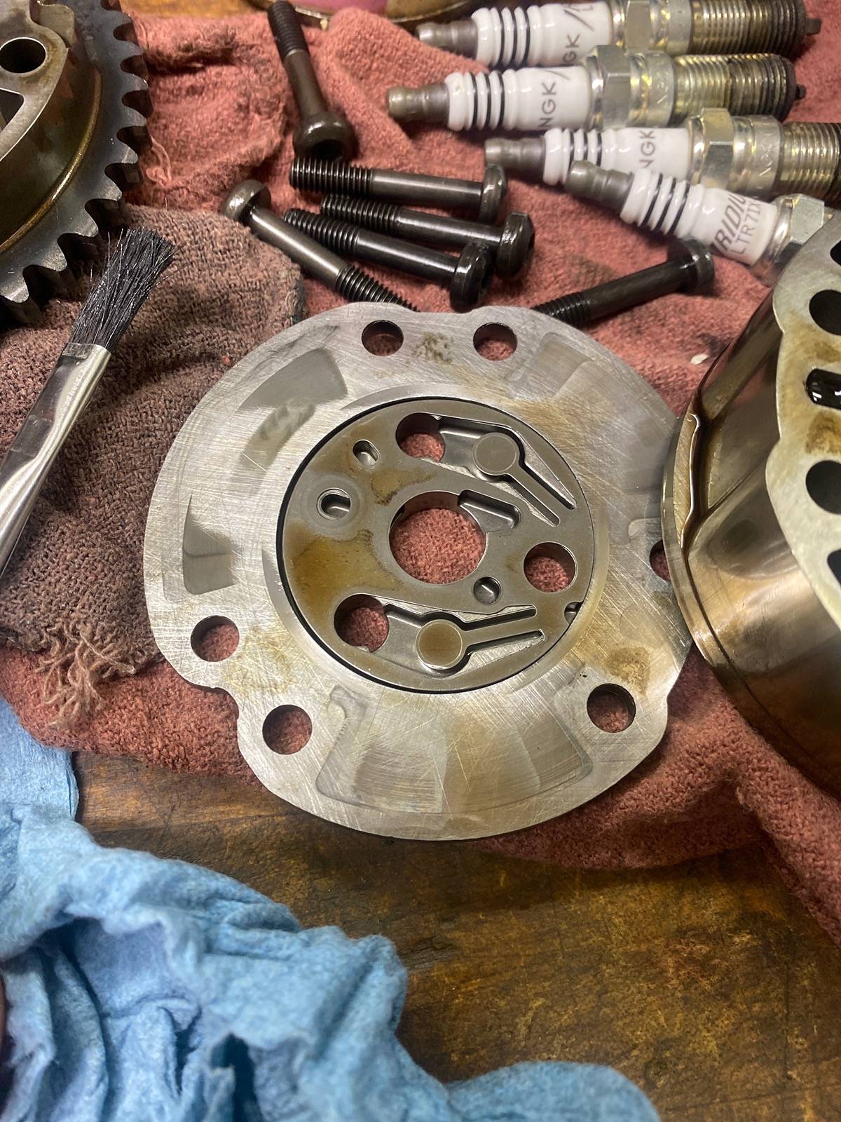

I decided to take my phasers apart to clean and inspect them my exhaust phasers bolts are reverse threaded and the intake phaser Bolts are normal threaded. My ARP bolt kit 156-1006 has no reverse threaded bolts. The phasers look pretty worn so I’m going to upgrade to the GT350 phasers.

did you measure the marked up cam-lobe and compared the height to the rest ? if they are the same, I'd polish the lobe and remeasure. but since you got new cams and nothing to lose might be worth a try if you're bored ha-ha.
