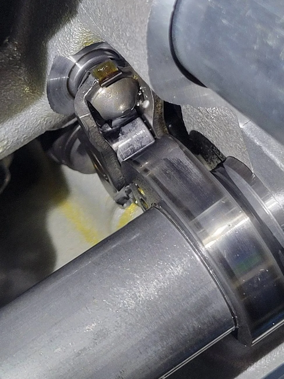

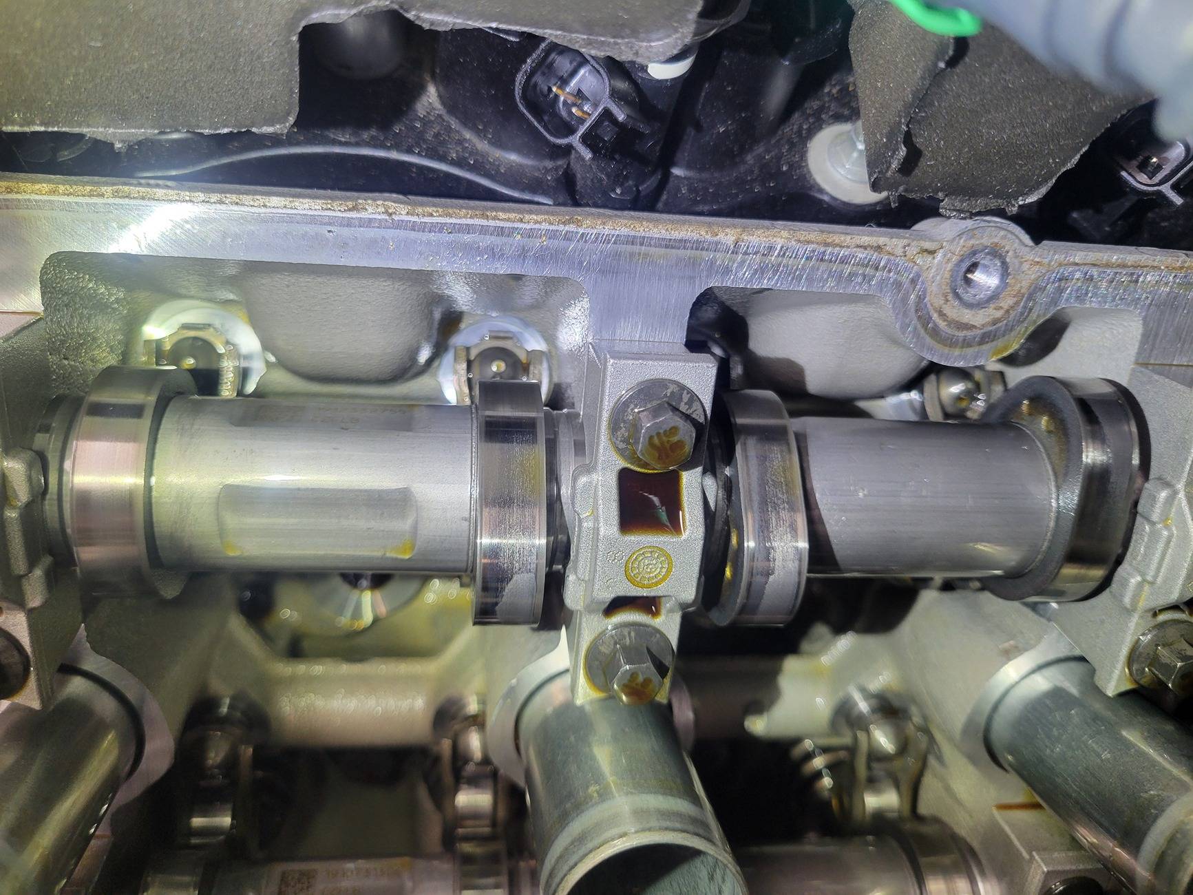

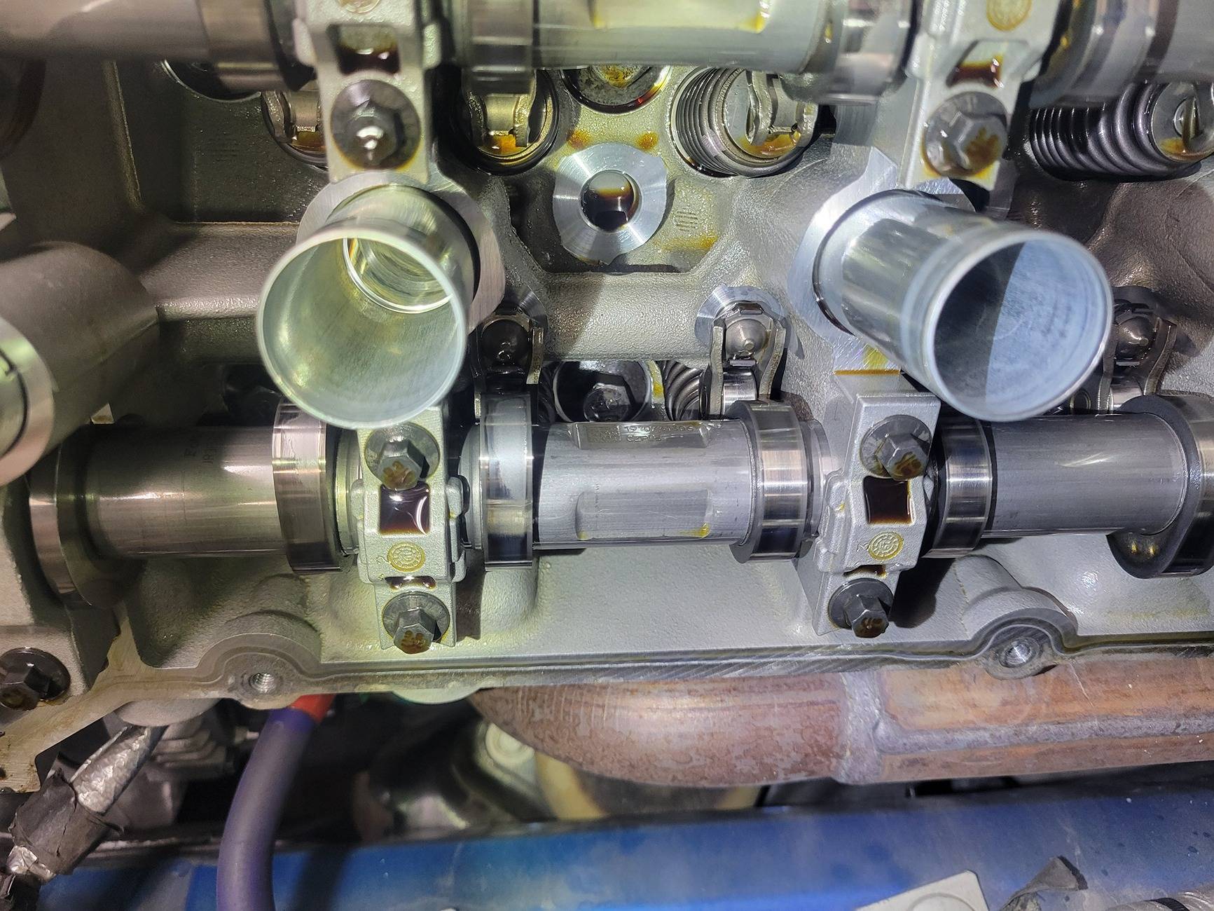

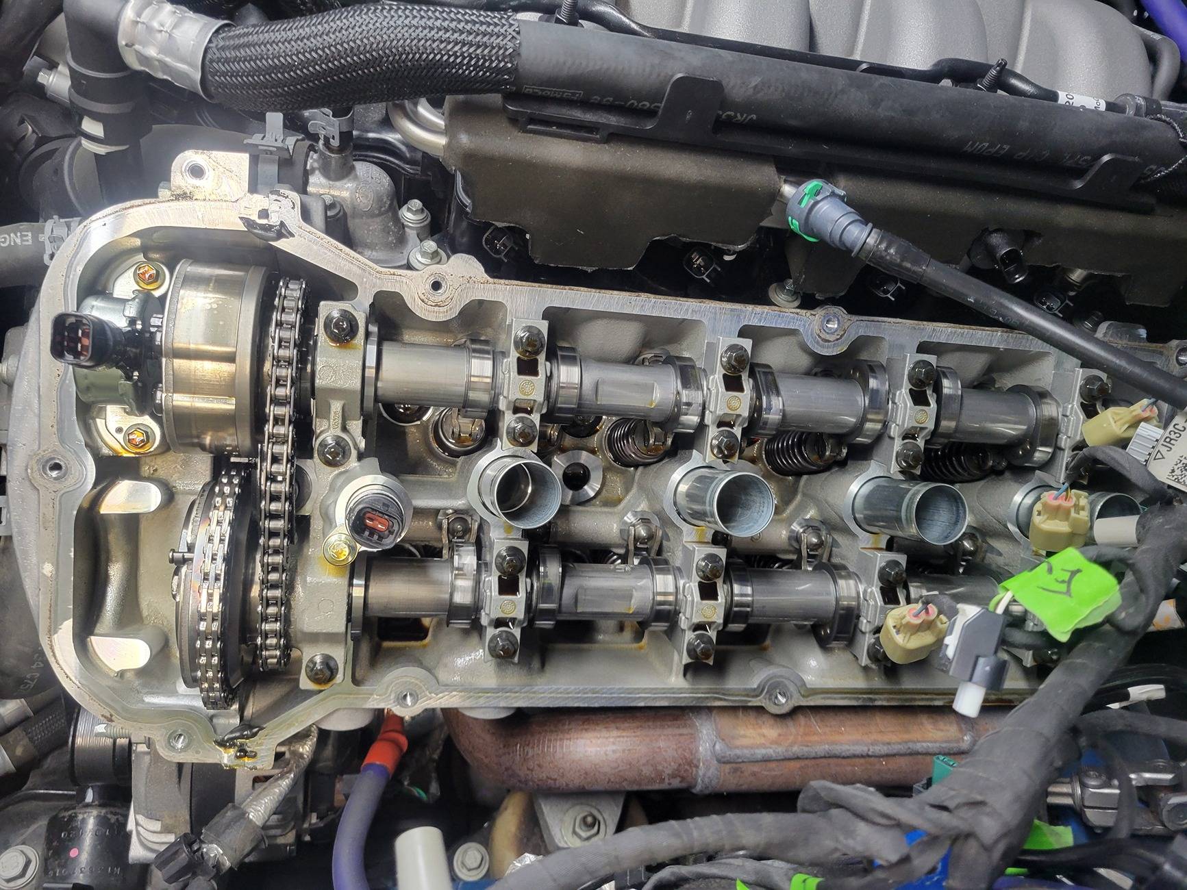

Doing VCT solenoids on my 2019 GT at 41k miles (random rough idle and stalling with sudden timing fluctuations) and noticed my driver side camshafts have abnormal wear patterns. Passenger side cams are perfect.
Engine is completely stock, stock tune.
I bought it at 32k miles, it had regular oil changed based on records and it appears clean on inside. I switched to 5w30 but if it were the oil then the passenger side would look the same.
Based on this damage it appears the cams/followers should be replaced. If it weren't for changing the vct solenoids I would have never known. No noises, no lights, no metal in oil.

How do the rollers on the followers look?

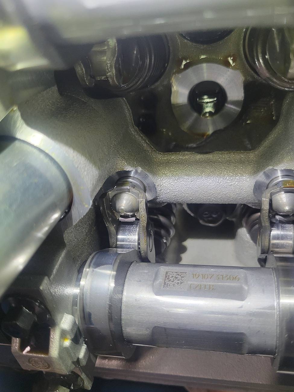

Sadly that's what I'm thinking also. It doesn't make much sense as to why this side is like that and not the other. Perhaps a flaw from factory, yet it appears to be an oilling issue.
The rollers have scarring and pitting that correspond with the lobe marks.
The cam lobes are mostly smooth except for one lobe where I can barely feel it with a finger nail. In that case the cam is basically trash along with the rocker and lash adjuster.
No signs of metal flakes in oil, oil filter appeared clean after 5k miles.

Sadly I believe it's out warranty. As for the cams they're likely toast. As said on one lobe I could slightly feel the wear mark with my finger which is excessive beyond just surface damage, it's wear pattern is exactly like the others.
I attempted to check tolerances with a feeler gauge but even .0012" didn't fit. Rollers have no up/down play, just a little side to side which I'm assuming is normal.
At this point I'm guessing a tear down, new cams/rockers/lifters etc is the best idea. And while I'm there maybe new phasers as they're prone to going bad I heard.
Running it as is would likely just keep wearing the cams down until something breaks and then it'll be too late.
