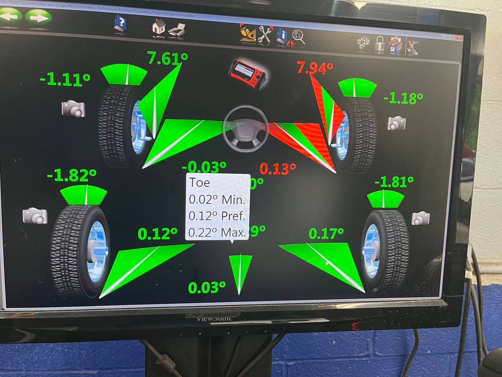

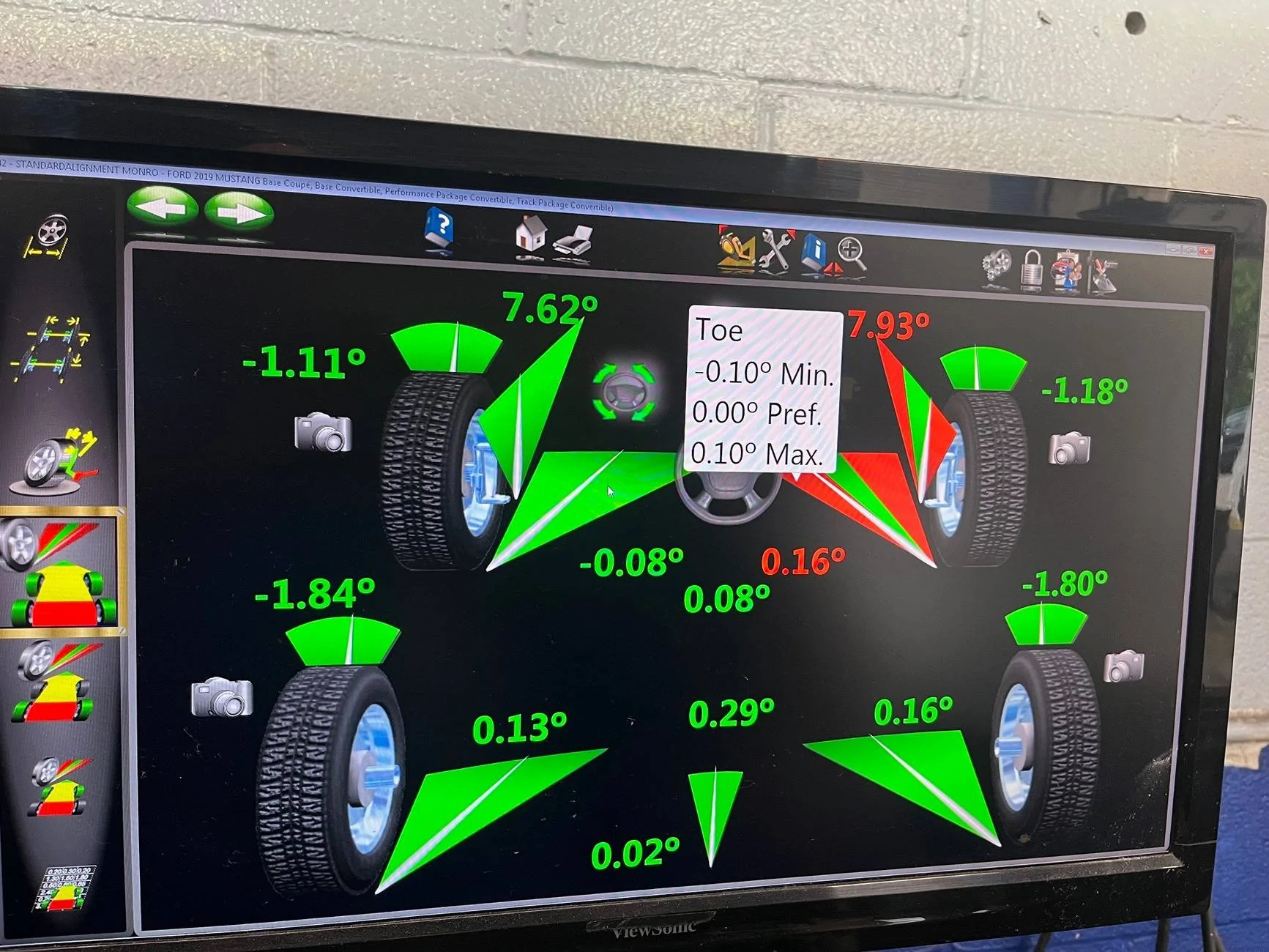

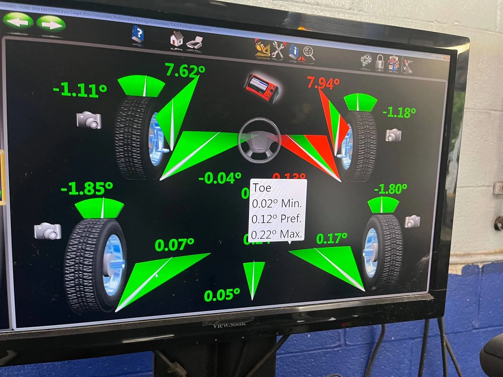

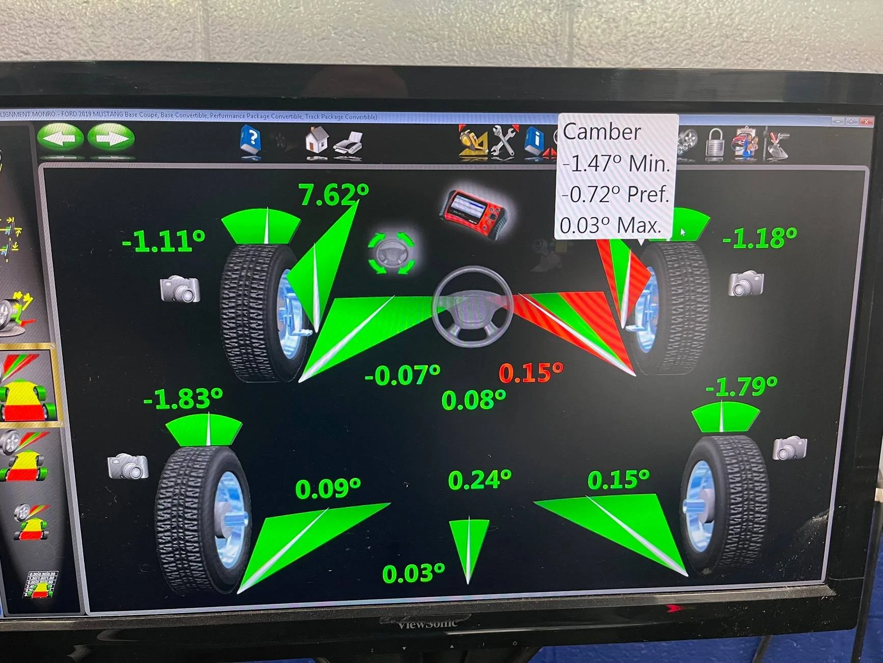

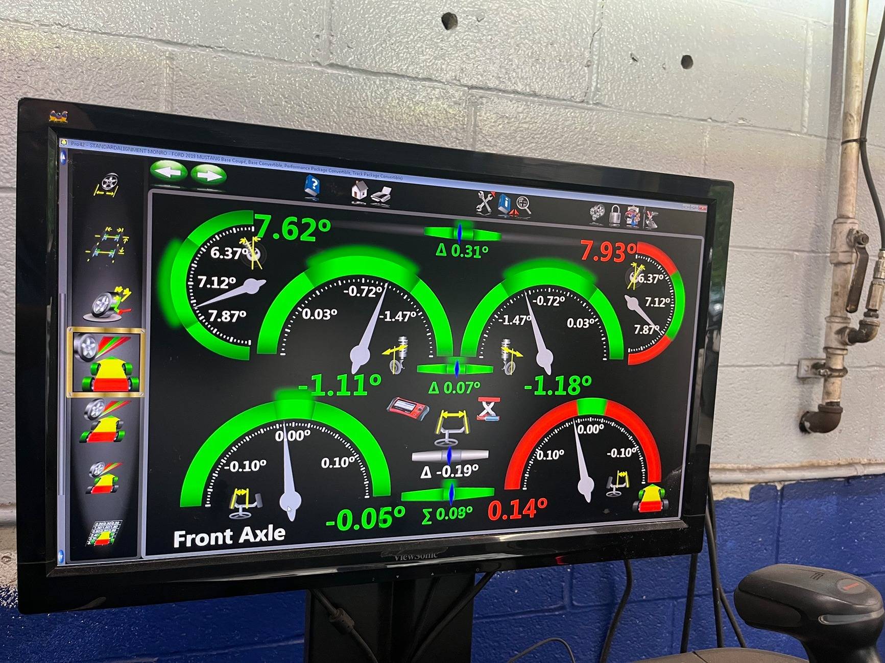

If I remember correctly, the toe was out of spec inwards so the inner shoulder was dragging.
And/Or - it seems like even in-spec toe out on some cars has caused less than preferable tire wear.
When my shop noticed inner front tire wear they recommended an alignment. I opted to go to another recommended front end guy and was told that the factory spec causes this inner tire wear. He adjusted the toe to compensate for it and that has worked pretty well. He would not tell me the spec he used. He looks to be in his 60's and I told him I was concerned that he might not be there when I need another alignment.
I did later go to the local Monro when they offered a free alignment check and got this. They did not offer a printout, so I took some screenshots.
(This was not that long after my alignment, but by then I had hit a tire casing with the right tires while entering I80 at 80MPH although not seeming to have caused any damage.)
Thanks for the input, looks like some toe in was your guys solution.
Did it fix your issue? What tires do you have? What’s the mileage on them?
It’s a lot better.
