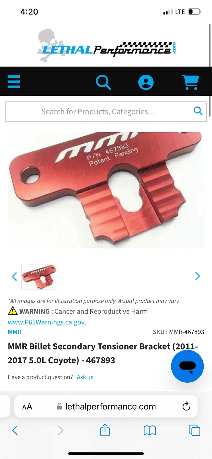

Driver side secondary tensioner flip bracket.
Got a part number by chance?
