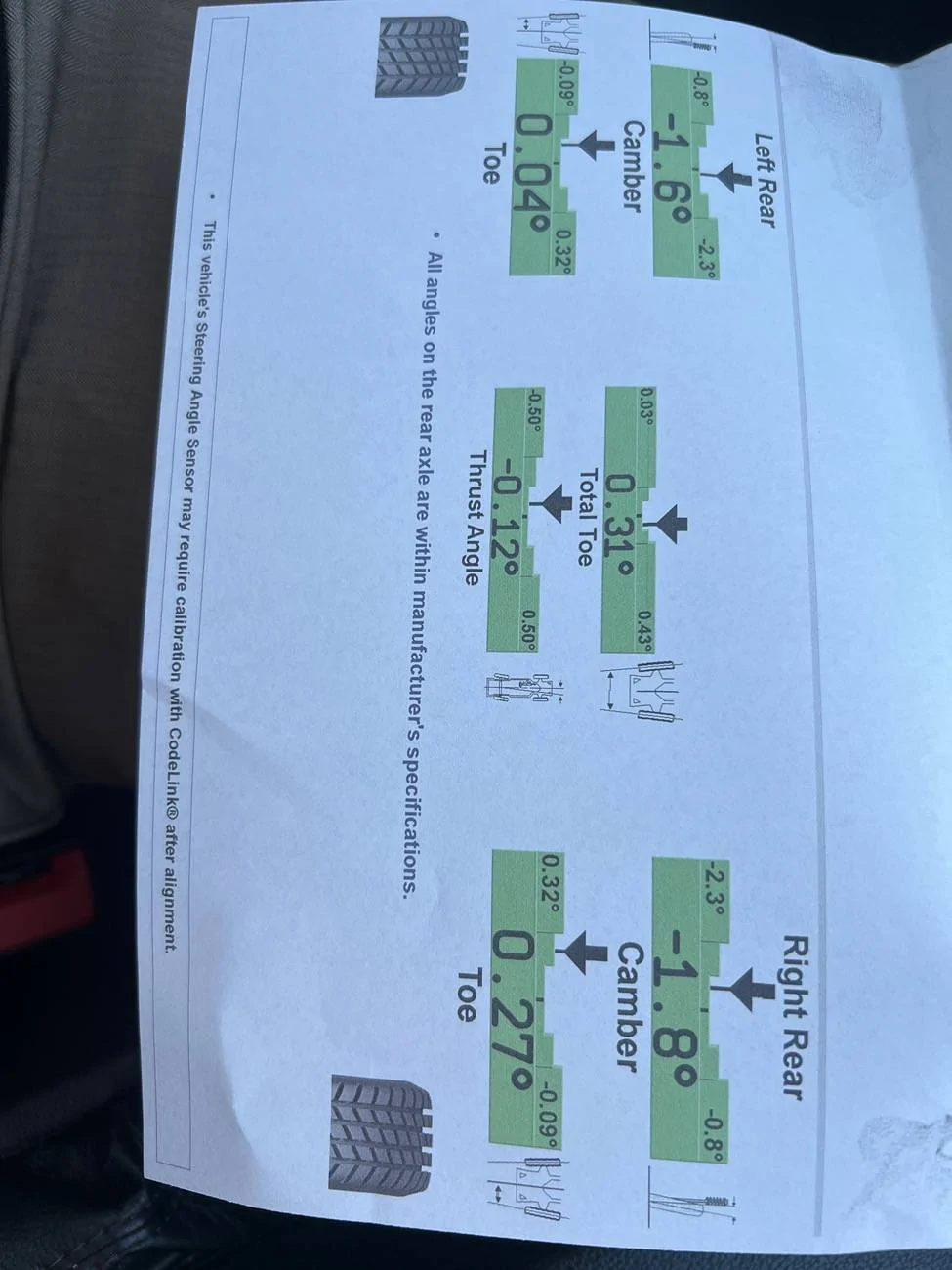

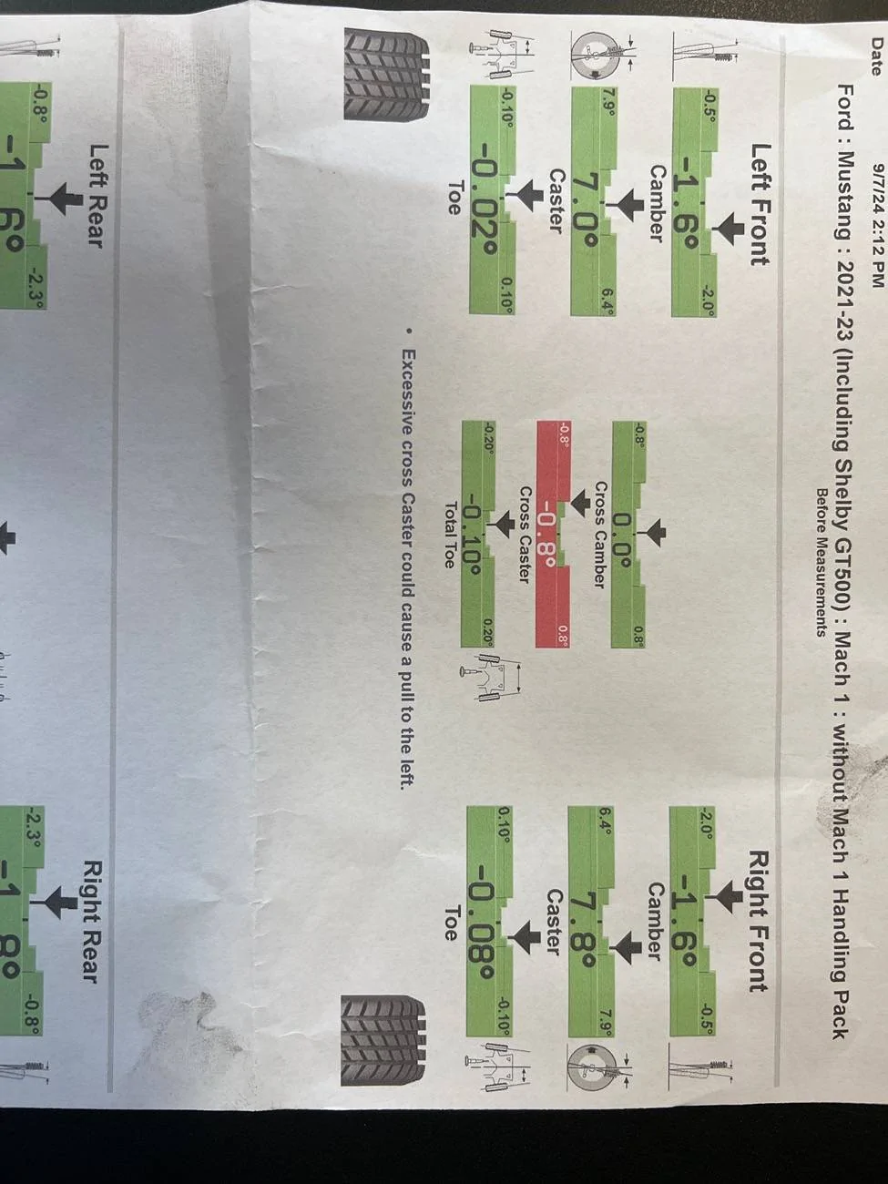

I had to replace my pilot sports at 17k miles on my 2022 Mach one non handling pack due to cords showing on the inner shoulder. Below is a photo of how the alignment was set from the factory. I work at an auto dealer so I have easy access to an alignment rack. I was told by my mechanic that there is no adjustment for camber at the bottom of the strut without tearing the suspension apart and boring out the holes at the bottom of the strut. Has anyone had any experience with the ford performance camber plates ? Will the camber plates allow me to get the camber closer to 0 degrees to save the inside edge of the tire? Or do I just need to live with the fact that I will be replacing tires every 15-18k miles.

My suspicions and the posts above point at your toe as the culprit. Although “green” .27 deg toe in is quite a bit.
Camber does not wear tires, it is the .27 degrees of toe that is causing your trouble.
The only time you want 0 camber is on a drag only car.
Front tow is -.02
I use steeda's camber plates up front for a few degrees of adjustability and BMRs UCA in the rear. Some camber is good for handling.
front two is -.02 drivers side front and -.08 passenger side.

Front tow is -.02
You’ve got some toe out!
go hit a good shop, pay the extra coin, and request slight toe in or 0 toe. That should help your tire wear out.
Your camber matches mine almost exactly. It will bias wear on the inner portion of the wheel but the rapid shoulder wear we are seeing is unusual. That should be toe related.
