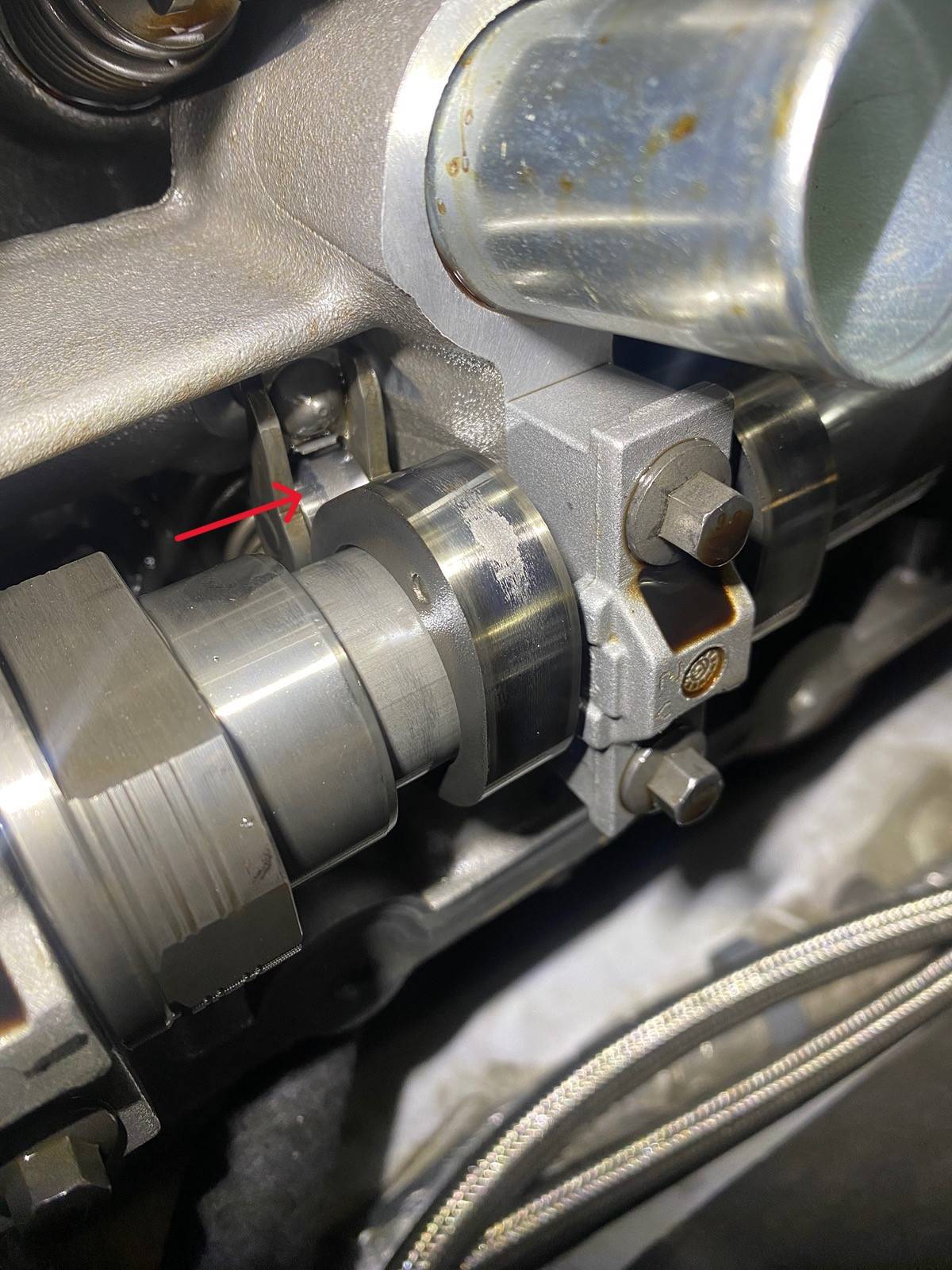

Looks to me like the roller on the rocker arm seized up. Significant wear on that roller
I’m thinking the same, I’ll report back when I dive into it

While I'm no fan of either, before everyone hops on that bandwagon ask yourself why only 1 rocker out of 32 is affected then?
a second cam lobe in those pics looks rough too
Just the glare. Entire cam is getting replaced. All followers and adjusters getting replaced as well. Considering the Ford Performance timing set as well while I’m in there since the car has 61k miles.

The rocker arm retaining clips on these motors come off easy if you rev high. Yours appear to be missing, which isnt bad since they serve no purpose after installation, but may have caused the issue. I had 8 come off mine and had to replace all cams, redo my heads, also had broken piston skirts. My cam cap was broken but IDK if that was from a retaining clip going through, or my prior warranty work done and the dealer re-using torque to yield bolts.
https://www.fordpartsgiant.com/reso...995800ce/85affa7c88e67cb485de2523bda8d32c.jpg the clip on the right side is probably the cause of this.

The rocker arm retaining clips on these motors come off like toys R us security tags in a BLM rally. Yours all appear to be missing, which isnt bad but may have caused the issue. I had 8 come off mine and had to replace all cams, redo my heads, also had broken piston skirts. My cam cap was broken but IDK if that was from a retaining clip going through, or my prior warranty work done and the dealer re-using torque to yield bolts.
Holy f*ck could’ve been a lot worse, glad I caught it when I did.
